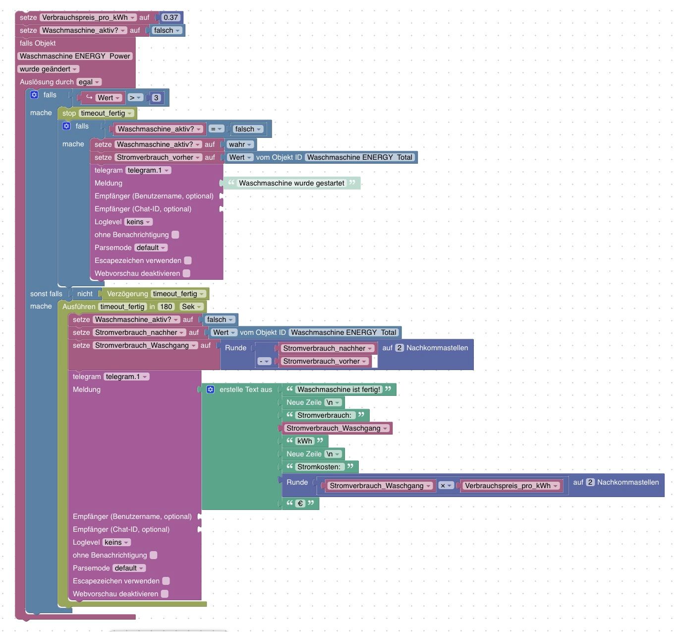

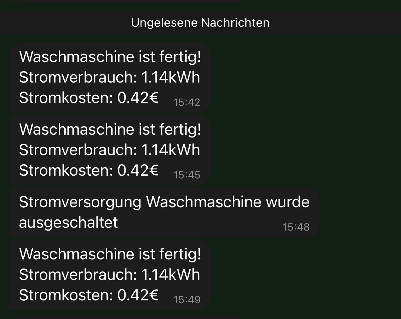

      Hallo zusammen!
      In meinem Blockly habe ich offenbar einen Fehler gemacht.
      Die "Waschmaschine fertig"-Meldung kommt mehrmals.
      Kann jemand helfen?
      Ausgabe:
      Blockly:
        <variables>
          <variable id="=:.rXuJ4F$c]v7ATT-n.">Verbrauchspreis_pro_kWh</variable>
          <variable id="]gFjxFcKE12,mJ=C%_xi">Waschmaschine_aktiv?</variable>
          <variable type="timeout" id="timeout_fertig">timeout_fertig</variable>
          <variable id="-u=T;@YP4M%QBTCUX,qV">Stromverbrauch_nachher</variable>
          <variable id="d+U-gw:uDzMAO@n%z`!O">Stromverbrauch_vorher</variable>
          <variable id="oyQphhzPm1CF}Rie)a9,">Stromverbrauch_Waschgang</variable>
        </variables>
        <block type="variables_set" id="ubgg`a1#=4[;furS(Zhf" x="87" y="-112">
          <field name="VAR" id="=:.rXuJ4F$c]v7ATT-n.">Verbrauchspreis_pro_kWh</field>
            <block type="math_number" id="VT(fO35(]#GN=a`YCWfI">
              <field name="NUM">0.37</field>
            <block type="variables_set" id="vB%/(%QK-.|VB8olH+F+">
              <field name="VAR" id="]gFjxFcKE12,mJ=C%_xi">Waschmaschine_aktiv?</field>
                <block type="logic_boolean" id="Zt3N#kbH0XjK+}5)pbJ^">
                <block type="on" id="Qn2CRF`}__(KPXGK6}S)">
                  <field name="OID">sonoff.0.Waschmaschine.ENERGY_Power</field>
                    <block type="controls_if" id="*bOx]47]yxIByA#qqt3J">
                        <block type="logic_compare" id=".(cUpb9mFzXnI.u`/RGu">
                          <field name="OP">GT</field>
                            <block type="on_source" id="+L|D9(N^L/_9p**AC4Y#">
                            <block type="math_number" id="IRXiQ:Tf}.:}u-F;(J?|">
                              <field name="NUM">3</field>
                        <block type="timeouts_cleartimeout" id="=JSbSA8^An9a5GvpnhX$">
                          <field name="NAME">timeout_fertig</field>
                            <block type="controls_if" id="bo$]}bM|Gn]EOfB}zAUl">
                                <block type="logic_compare" id="!+aTX:f8zpg?koPwXqU9">
                                  <field name="OP">EQ</field>
                                    <block type="variables_get" id="~^+uLCVDphEA1T3csQ;4">
                                    <block type="logic_boolean" id="m9)+OzK@16j;{0FErZe_">
                                <block type="variables_set" id="yj^]v8#=,-=xs,C$1:0m">
                                    <block type="logic_boolean" id="c%J}.8a#0L-%7wEqRPVF">
                                    <block type="variables_set" id="9#YrXdwG5}cOx9Y(@8Wv">
                                      <field name="VAR" id="d+U-gw:uDzMAO@n%z`!O">Stromverbrauch_vorher</field>
                                        <block type="get_value" id="a8TRMLX$e~nl*Y09Y9iB">
                                          <field name="OID">sonoff.0.Waschmaschine.ENERGY_Total</field>
                                        <block type="telegram" id="V79]mw|-s_Wa8itsYZZ^">
                                          <field name="INSTANCE">.1</field>
                                          <field name="LOG"></field>
                                          <field name="ESCAPING">FALSE</field>
                                          <field name="DISABLE_WEB_PAGE_PREVIEW">FALSE</field>
                                          <value name="MESSAGE">
                                            <shadow type="text" id="x#tx~0e1$9f(D`sZ!a=/">
                                              <field name="TEXT">Waschmaschine wurde gestartet</field>
                      <value name="IF1">
                        <block type="logic_negate" id="^G%R_hQtQM7a9-Iy{Zk;">
                          <value name="BOOL">
                            <block type="timeouts_gettimeout" id="vkIn/V(F$NSX#13S7t35">
                      <statement name="DO1">
                        <block type="timeouts_settimeout" id="w`%fEqzXS#K[?$/JZDGc">
                          <field name="DELAY">180</field>
                            <block type="variables_set" id="!31!Yg[A`[Xo.]1qKKn(">
                                <block type="logic_boolean" id="w.hL*w4J:xFJwIfBgdRW">
                                <block type="variables_set" id="yY,)jgdUB2GJR%%irN/r">
                                  <field name="VAR" id="-u=T;@YP4M%QBTCUX,qV">Stromverbrauch_nachher</field>
                                    <block type="get_value" id="GEQguIpsHP,A4/^`nhvw">
                                    <block type="variables_set" id="itWRJGQ7J.:H;#:0pdT)">
                                      <field name="VAR" id="oyQphhzPm1CF}Rie)a9,">Stromverbrauch_Waschgang</field>
                                        <block type="math_rndfixed" id="`CQLoA,hTBeCF^jC$m7o">
                                          <field name="n">2</field>
                                          <value name="x">
                                            <shadow type="math_number" id="K5?[|]UP!f)gh(WB9YlR">
                                              <field name="NUM">3.1234</field>
                                            <block type="math_arithmetic" id="-(/lVRk*3=g:[5qmWUDn" inline="false">
                                                <shadow type="math_number" id="my)c;67df,_rqPUn*7Zw">
                                                  <field name="NUM">1</field>
                                                <block type="variables_get" id="z1D_-h-T3fHL]w@7I8[J">
                                                <shadow type="math_number" id="n]MNz;YDQG/~Z.,SRtR0">
                                                <block type="variables_get" id="$?{4ycoT|{bZNx,tb7vH">
                                        <block type="telegram" id="CQb6Xn]wF:sTrg((4:I/">
                                            <shadow type="text" id="/ol[jFtqydF.de(P.5^p">
                                              <field name="TEXT">Waschmaschine ist fertig!</field>
                                            <block type="text_join" id="H6/ojZvgU{P~Pt6)*5x0">
                                              <mutation items="9"></mutation>
                                              <value name="ADD0">
                                                <block type="text" id="`xB48uoDS?5mFuf~H]Dz">
                                              <value name="ADD1">
                                                <block type="text_newline" id="1{zZXpJ(5O)OaE7:;C+=">
                                                  <field name="Type">\n</field>
                                              <value name="ADD2">
                                                <block type="text" id="po4kBhKs^=Afge7P@+}-">
                                                  <field name="TEXT">Stromverbrauch: </field>
                                              <value name="ADD3">
                                                <block type="variables_get" id="(KJjJ3PKdl32SrGqUe6,">
                                              <value name="ADD4">
                                                <block type="text" id="4P;K$4nY$zo-[Pi%I9XP">
                                                  <field name="TEXT">kWh</field>
                                              <value name="ADD5">
                                                <block type="text_newline" id="3u~EQK:5E13$fc~OVM,D">
                                              <value name="ADD6">
                                                <block type="text" id="h5A}=DuU:Bnkky*=1RC6">
                                                  <field name="TEXT">Stromkosten: </field>
                                              <value name="ADD7">
                                                <block type="math_rndfixed" id="6r0lnE16^V98#!gIbVQO">
                                                  <value name="x">
                                                    <shadow type="math_number" id="#ij|D2Km]s#UhaB`Jdo~">
                                                    <block type="math_arithmetic" id="~FzTOPB^Rwjf6}91Sh(p">
                                                        <shadow type="math_number" id="$YJtcuO%6gF[y4@uO]L`">
                                                        <block type="variables_get" id="`=t.T#B21IW5`.w$T!:0">
                                                        <shadow type="math_number" id=";Q5q@z2EAr]3p=:~jBa%">
                                                          <field name="NUM">0</field>
                                                        <block type="variables_get" id="R2FGlBV^Vr#d(L5GBq{2">
                                              <value name="ADD8">
                                                <block type="text" id="dsx1hx27*8lqAYaqdOuC">
                                                  <field name="TEXT">€</field>

        @invidianer Bitte auch einen Screenshot vom Blockly zeigen.
        I 1 Reply Last reply Reply Quote 1

            @invidianer was soll passieren wenn Timeout fertig und power <3?
            • I
              invidianer @Homoran last edited by
              Ehrlich gesagt, ich habe keine Ahnung.

                @invidianer sagte: Meldung kommt mehrmals.
                Starte mal die Javascript-Instanz neu.
                I 2 Replies Last reply Reply Quote 0

                      Hatte ich neulich nach einem Update schon gemacht, also alles komplett neugestartet (den ganz RaspberryPi).
                      War vorher und eben auch heute so.

                          paul53 @invidianer last edited by paul53
                          @invidianer sagte: War vorher und eben auch heute so.
                          Überprüfe mal die Selektion der Timer-Variablen bei "stop timeout" und bei "nicht Verzögerung timeout". Eigentlich ist es nicht möglich, dass die Meldung ein zweites Mal kommt, bevor der Timer gestoppt wurde.
                          Schau mal in den erzeugten Javascript-Code, ob sich irgendwo ein Block versteckt hat.

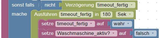

                                  @invidianer sagte: versteckten Block, den man über Java-Skript sehen kann?
                                  Ich habe mal importiert: In Zeile 20 Javascript-Code steht
                                        timeout_fertig = null;
                                  Der ist falsch und für dieses Verhalten verantwortlich.
                                      @invidianer sagte: wie bekomme ich den aus dem Blockly raus?
                                      Es ist offenbar eine fehlerhafte Implementation des Timeout-Blocks in neueren Javascript-Adapter-Versionen (ab 29.5.2023).
                                      Workaraound:

                                        invidianer @paul53 last edited by
                                        Okay, danke, ich habe den "setze timeout_fertig auf wahr" ergänzt.
                                        Krass, dann habe ich quasi einen Fehler aufgedeckt? Dann hatte es ja vielleicht was Gutes 😉
