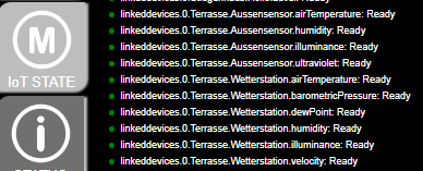

      nachdem ich immer nur mitlese, mal was sinnvoll zu Teilendes:
      Falls jemand auch linkeddevices verwendet und gerne in VIS eine Übersicht hätte ob irgendwelche verlinkten Geräte aus zwave2, sonoff oder shelly Probleme machen, kann gerne mein Script verwenden.
      Der Output sieht dann so aus:
      var StatusHTMLzwave = 'javascript.0.zwave2NodeStatus';
      var StatusHTMLshelly = 'javascript.0.shellyNodeStatus';
      var StatusHTMLsonoff = 'javascript.0.sonoffNodeStatus';
      var StatusHTMLlinkeddevices = 'javascript.0.linkeddeviceNodeStatus';

      function checkIoT(){
          /////////////////////ZWAVE
          // Get a list of all nodes under the Z-Wave2 root
          var nodes = $('zwave2.0.*.ready');
          // Initialize the HTML string
          let itemListHTML = '<h1>Z-Wave2 Node Status</h1>';
          nodes.each(function (id, i) {
              const nodeReady = getState(id);
              // Determine the circle color based on the "ready" state
              const circleClass = nodeReady.val ? 'green' : 'red';
              // Add the item to the HTML list
              itemListHTML += `
                  <div class="item">
                      <div class="circle ${circleClass}"></div>
                      <span>${id}: ${nodeReady.val ? 'Ready' : 'Not Ready'}</span>
                  </div>
          // Create or update an HTML state in ioBroker to display the list
          setState(StatusHTMLzwave, itemListHTML, true);
          /////////////////////SONOFF
          nodes = $('sonoff.0.*.alive');
          itemListHTML = '<h1>SONOFF Node Status</h1>';
              itemListHTML += `
                  <div class="item">
                  </div>
          setState(StatusHTMLsonoff, itemListHTML, true);
          /////////////////////SHELLY
          nodes = $('shelly.0.*.online');
          itemListHTML = '<h1>SHELLY Node Status</h1>';
              itemListHTML += `
                  <div class="item">
                  </div>
          setState(StatusHTMLshelly, itemListHTML, true);
          /////////////////////LINKED DEVICES
          nodes = $('linkeddevices.0.*');
          itemListHTML = '';
              var dPoint = getObject(id,"true");
              if (dPoint && dPoint.common) {
                  var settings = dPoint.common.custom;
                  //check if it is a linkeddevice
                  var dpCustom = false;
                  if(settings)
                      if(settings['linkeddevices.0'])
                          if(settings['linkeddevices.0'].enabled)
                              dpCustom = settings['linkeddevices.0'].enabled;
                  if(dpCustom) {
                      //explode the parentid
                      var parentid = settings['linkeddevices.0'].parentId ? settings['linkeddevices.0'].parentId : "";
                      if(parentid == "")
                          return;
                      const parts = parentid.split('.');
                      if (parts.length >= 3) {
                          //extract the parentState
                          const parentState = parts.slice(0, 3).join('.');
                          if(parts[0] == 'zwave2')
                              const nodeReady = getState(parentState + '.ready');
                              itemListHTML += `
                                  <div class="item">
                                  </div>
          setState(StatusHTMLlinkeddevices, itemListHTML, true);
      checkIoT();
      schedule('* * * * *',checkIoT);
