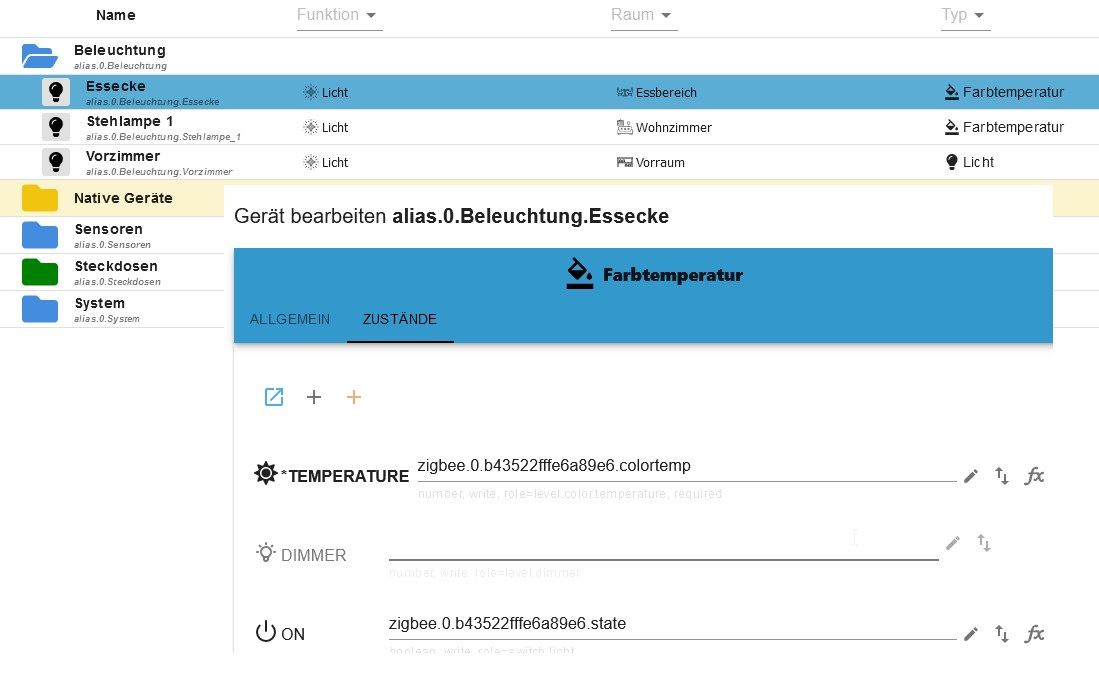

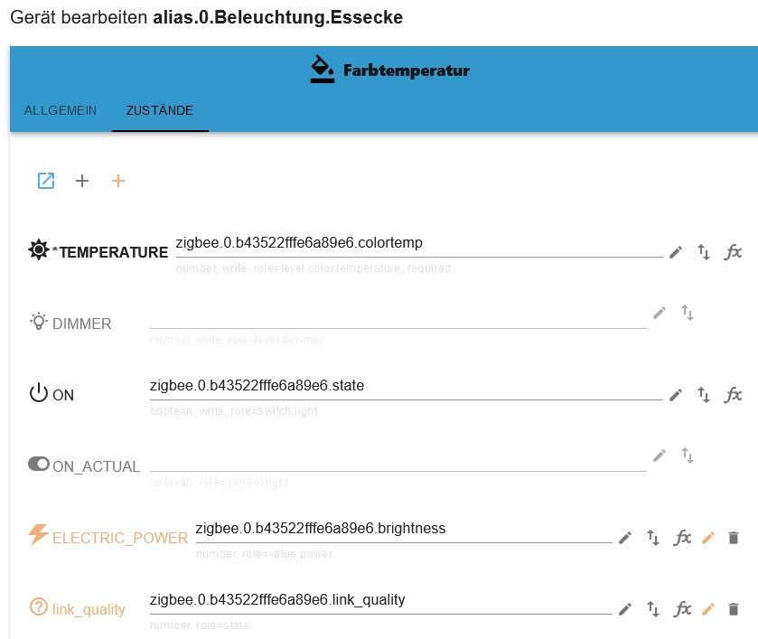

      Ich habe 3 Lampen eingebunden. Eine ohne und zwei mit der Möglichkeit die Farbtemperatur einzubinden. Ist es normal, dass bei den Lampen mit Farbtemperatur-Datenpunkt der Typ geändert wird?
      Zweite Frage
      Ich bekomme nach Neustart (der Adapter) immer folgende Fehler, die Funktion ist aber zu 100% gegeben.
      Alias subscription error. Please check your alias definitions: sourceId=zigbee.0.b43522fffe9b547b.link_quality, sourceObj={"type":"state","common":{"name":"Link quality","type":"number","read":true,"write":false,"role":"state","min":0,"max":255},"native":{},"from":"system.adapter.zigbee.0","user":"system.user.admin","ts":1700037884442,"_id":"zigbee.0.b43522fffe9b547b.link_quality","acl":{"object":1636,"state":1636,"owner":"system.user.admin","ownerGroup":"system.group.administrator"}}
      Alias subscription error. Please check your alias definitions: sourceId=zigbee.0.b43522fffe9b547b.colortemp, sourceObj={"type":"state","common":{"name":"Color temperature","type":"number","read":true,"write":true,"role":"level.color.temperature"},"native":{},"from":"system.adapter.zigbee.0","user":"system.user.admin","ts":1700037884445,"_id":"zigbee.0.b43522fffe9b547b.colortemp","acl":{"object":1636,"state":1636,"owner":"system.user.admin","ownerGroup":"system.group.administrator"}}
      Alias subscription error. Please check your alias definitions: sourceId=zigbee.0.b43522fffe9b547b.state, sourceObj={"type":"state","common":{"name":"Switch state","type":"boolean","read":true,"write":true,"role":"switch","custom":{"linkeddevices.0":{"enabled":true,"number_convertTo":"","number_to_duration_format":"dd[T] hh[h] mm[m]","number_to_datetime_format":"dd[T] hh[h] mm[m]","boolean_convertTo":"","string_convertTo":"","colorCie_convertTo":"","linkedId":"Stehlampe1.state","name":"Stehlampe1","expertSettings":false}}},"native":{},"_id":"zigbee.0.b43522fffe9b547b.state","acl":{"object":1636,"state":1636,"owner":"system.user.admin","ownerGroup":"system.group.administrator"},"from":"system.adapter.admin.0","user":"system.user.admin","ts":1700051686428}
      Alias subscription error. Please check your alias definitions: sourceId=zigbee.0.b43522fffe9b547b.brightness, sourceObj={"type":"state","common":{"name":"Brightness","type":"number","read":true,"write":true,"role":"level.dimmer","min":0,"max":100},"native":{},"from":"system.adapter.zigbee.0","user":"system.user.admin","ts":1700037884444,"_id":"zigbee.0.b43522fffe9b547b.brightness","acl":{"object":1636,"state":1636,"owner":"system.user.admin","ownerGroup":"system.group.administrator"}}
      Die Fehler kommen auch bei den anderen Lampen
      Die Datenpunkte sind analog dem folgenden Beispiel eingebunden.
      Anbei die Objektdaten, Zuerst "echter Datenpunkt", dann der Alias

        "_id": "alias.0.Beleuchtung.Stehlampe_1.SET",
        "common": {
          "name": "SET",
          "role": "switch.light",
          "type": "boolean",
          "read": true,
          "write": true,
          "alias": {
            "id": "zigbee.0.b43522fffe9b547b.state"
        "native": {},
        "type": "state",
        "acl": {
          "object": 1636,
          "state": 1636,
          "owner": "system.user.admin",
        "user": "system.user.admin",
        "ts": 1700042724530
        "_id": "alias.0.Beleuchtung.Stehlampe_1.ELECTRIC_POWER",
        "native": {},
        "type": "state",
        "common": {
          "alias": {
            "id": "zigbee.0.b43522fffe9b547b.brightness"
          "name": "ELECTRIC_POWER",
          "role": "value.power",
          "write": false,
          "type": "number",
          "unit": "W"
        "ts": 1700042724552,
        "acl": {
          "object": 1636,
          "state": 1636,
        "type": "state",
        "common": {
          "name": "colortemp",
          "type": "number",
          "read": true,
          "write": true,
          "role": "level.color.temperature",
          "alias": {
            "id": "zigbee.0.b43522fffe9b547b.colortemp"
        "native": {},
        "_id": "alias.0.Beleuchtung.Stehlampe_1.colortemp",
        "acl": {
          "object": 1636,
          "state": 1636,
        "ts": 1700042724587
      Könnt ihr mir bitte weiterhelfen? 👏
        Stefan_NK @Stefan_NK last edited by
        Niemand ein ähnliches Problem? 🙇‍♂️
