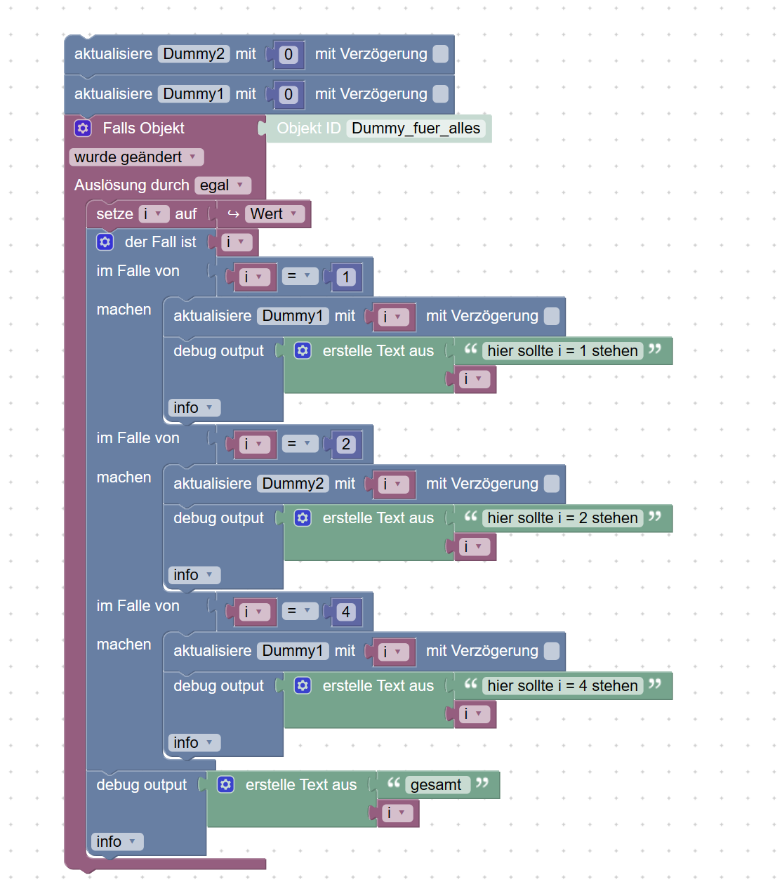

      denke ich falsch oder funktioniert der Block switch/ case nicht.
      Blockly:
      JS:
      var i;
      setState('javascript.0.Dummy2' /* Dummy2 */, 0, true);
      setState('0_userdata.0.Dummy1' /* Dummy1 */, 0, true);
      on({ id: [].concat(['javascript.0.Dummy_fuer_alles']), change: 'ne' }, async (obj) => {
        let value = obj.state.val;
        i = (obj.state ? obj.state.val : "");
        switch (i) {
        	case i == 1:
          setState('0_userdata.0.Dummy1' /* Dummy1 */, i, true);
          console.log(('hier sollte i = 1 stehen' + String(i)));
        		break;
        	case i == 2:
          setState('javascript.0.Dummy2' /* Dummy2 */, i, true);
          console.log(('hier sollte i = 2 stehen' + String(i)));
        		break;
        	case i == 4:
          console.log(('hier sollte i = 4 stehen' + String(i)));
        		break;
        console.log(('gesamt ' + String(i)));
      Debug Output:
      27.12.2023, 22:29:44.505	[info ]: javascript.0 (1670) Stop script script.js.Tests.zum_test
      27.12.2023, 22:29:44.554	[info ]: javascript.0 (1670) Start javascript script.js.Tests.zum_test
      27.12.2023, 22:29:44.557	[info ]: javascript.0 (1670) script.js.Tests.zum_test: registered 1 subscription, 0 schedules, 0 messages, 0 logs and 0 file subscriptions
      27.12.2023, 22:29:52.035	[info ]: javascript.0 (1670) script.js.Tests.zum_test: gesamt 1
      27.12.2023, 22:29:53.301	[info ]: javascript.0 (1670) script.js.Tests.zum_test: gesamt 2
      27.12.2023, 22:29:54.515	[info ]: javascript.0 (1670) script.js.Tests.zum_test: gesamt 3
      27.12.2023, 22:29:55.515	[info ]: javascript.0 (1670) script.js.Tests.zum_test: gesamt 4
      Versionen:
      Used repository: stable
      Adapter    "admin"        : 6.12.0   , installed 6.12.0
      Adapter    "backitup"     : 2.8.7    , installed 2.8.7
      Adapter    "broadlink2"   : 2.1.5    , installed 2.1.5
      Adapter    "email"        : 1.2.0    , installed 1.2.0
      Adapter    "hm-rega"      : 4.0.0    , installed 4.0.0
      Adapter    "hm-rpc"       : 1.15.19  , installed 1.15.19
      Adapter    "icons-material-svg": 0.1.0, installed 0.1.0
      Adapter    "javascript"   : 7.1.6    , installed 7.1.6
      Controller "js-controller": 5.0.17   , installed 5.0.17
      Adapter    "vis"          : 1.5.4    , installed 1.4.16 [Updatable]
      Adapter    "web"          : 6.1.10   , installed 6.1.10
      Adapter    "ws"           : 2.5.8    , installed 2.5.8
      /usr/bin/nodejs 	v18.19.0
      /usr/bin/node 		v18.19.0
      /usr/bin/npm 		10.2.3
      /usr/bin/npx 		10.2.3
      /usr/bin/corepack 	0.22.0

          @codierknecht das wäre schön.
          i ist auf dem Wert von dem Trigger. ist eine Zahl. Ich kann auch die Zahl direkt in "i" schreiben. geht trotzdem nicht.

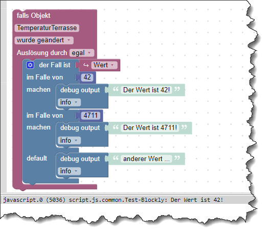

            @ubecker
            Funktioniert einwandfrei!
            https://www.w3schools.com/js/js_switch.asp
            ubecker 1 Reply Last reply Reply Quote 0

              @codierknecht
              ahhh, da darf kein Vergleich stehen.
              Könnt ihr das als Hinweis in Blockly für dummy aufnehmen.

                    @ubecker
                    Das Beispiel im "Dummy-Thread" zeigt auch bereits die korrekte Verwendung.
                    Ich habe trotzdem mal einen Hinweistext spendiert.
