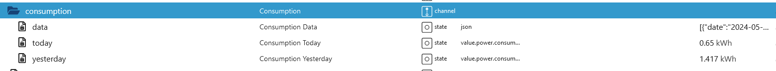

        Aber was ich jetzt trotz Suche nicht herausgefunden habe: bekomm ich monatliche Verbrauchswerte nur über externe Klimmzüge?

            warp735 @apollon77 last edited by
            @apollon77
            #85 verstehe ich eigentlich so, aber ich hab nur "heute" und "gestern", keine Monatswerte.
            Soll ich einen neuen aufmachen?
                    @apollon77
                    Bitte:
                    [{"date":"2024-05-31","time":1717192683,"value":1878},{"date":"2024-06-01","time":1717279088,"value":1447},{"date":"2024-06-02","time":1717365483,"value":1417},{"date":"2024-06-03","time":1717404856,"value":650},{"date":"2024-05-04","time":1714859888,"value":0},{"date":"2024-05-05","time":1714946282,"value":0},{"date":"2024-05-06","time":1715032688,"value":0},{"date":"2024-05-07","time":1715119084,"value":0},{"date":"2024-05-08","time":1715205489,"value":0},{"date":"2024-05-09","time":1715291884,"value":0},{"date":"2024-05-10","time":1715378289,"value":0},{"date":"2024-05-11","time":1715464684,"value":0},{"date":"2024-05-12","time":1715551089,"value":0},{"date":"2024-05-13","time":1715637484,"value":0},{"date":"2024-05-14","time":1715723889,"value":0},{"date":"2024-05-15","time":1715810285,"value":0},{"date":"2024-05-16","time":1715896680,"value":0},{"date":"2024-05-17","time":1715983086,"value":0},{"date":"2024-05-18","time":1716069482,"value":0},{"date":"2024-05-19","time":1716155888,"value":0},{"date":"2024-05-20","time":1716242283,"value":0},{"date":"2024-05-21","time":1716328689,"value":0},{"date":"2024-05-22","time":1716415085,"value":0},{"date":"2024-05-23","time":1716501480,"value":0},{"date":"2024-05-24","time":1716587885,"value":0},{"date":"2024-05-25","time":1716674280,"value":0},{"date":"2024-05-26","time":1716760686,"value":0},{"date":"2024-05-27","time":1716847081,"value":0},{"date":"2024-05-28","time":1716933487,"value":0},{"date":"2024-05-29","time":1717019882,"value":0},{"date":"2024-05-30","time":1717106286,"value":269}]
                    • apollon77
                      apollon77 @warp735 last edited by
                      @warp735 Ahh jetzt erinnere ich mich. Am Ende war unklar wie man das in eine Objektstruktur bringen sollte und damit war die Idee es genau hier in das State zu schreiben. Es kann wich also jeder mit einem kleinen JavaScriptchen was schreiben um es auszuwerten
