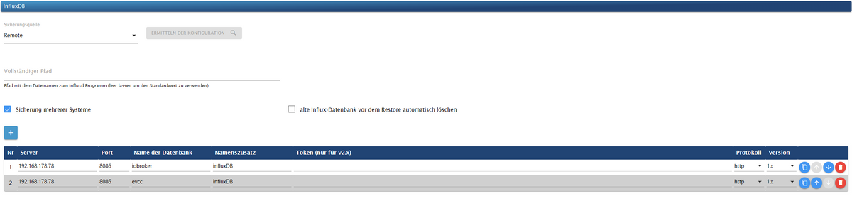

      kann mir vielleicht einer ein Tipp geben was diese Meldung ist :
      [DEBUG] [iobroker] - done
      [DEBUG] [influxDB] - InfluxDB-Backup for influxDB is started ...
      [DEBUG] [influxDB] - Start InfluxDB Backup ...
      [DEBUG] [influxDB] - InfluxDB Backup tmp directory created
      [DEBUG] [influxDB] - Try deleting the InfluxDB tmp directory: "/opt/iobroker/backups/influxDB_2024_01_19-17_47_08_influxDB_backupiobroker"
      [DEBUG] [influxDB] - InfluxDB tmp directory "/opt/iobroker/backups/influxDB_2024_01_19-17_47_08_influxDB_backupiobroker" successfully deleted
      [ERROR] [influxDB] - Error: Command failed: "/var/lib/influxdb/data" backup -portable -database iobroker -host 192.168.178.78:8086 "/opt/iobroker/backups/influxDB_2024_01_19-17_47_08_influxDB_backupiobroker"
      /bin/sh: 1: /var/lib/influxdb/data: not found

        • MichaelF
          MichaelF last edited by
          Das war ein Versuch weil ich nicht mehr so richtig weiter wusste, wenn es leer bleibt kommt die gleiche Meldung.
          [DEBUG] [influxDB] - Try deleting the InfluxDB tmp directory: "/opt/iobroker/backups/influxDB_2024_01_19-18_07_44_influxDB_backupiobroker"
          [DEBUG] [influxDB] - InfluxDB tmp directory "/opt/iobroker/backups/influxDB_2024_01_19-18_07_44_influxDB_backupiobroker" successfully deleted
          [ERROR] [influxDB] - Error: Command failed: influxd backup -portable -database iobroker -host 192.168.178.78:8086 "/opt/iobroker/backups/influxDB_2024_01_19-18_07_44_influxDB_backupiobroker"
          /bin/sh: 1: influxd: not found

                                Hab ich den Falschen Port ? 8086 nicht Richtig ::
                                [DEBUG] [influxDB] - Try deleting the InfluxDB tmp directory: "/opt/iobroker/backups/influxDB_2024_01_19-19_56_11_influxDB_backupiobroker"
                                [DEBUG] [influxDB] - InfluxDB tmp directory "/opt/iobroker/backups/influxDB_2024_01_19-19_56_11_influxDB_backupiobroker" successfully deleted
                                [DEBUG] [influxDB] - 2024/01/19 19:56:11 backing up metastore to /opt/iobroker/backups/influxDB_2024_01_19-19_56_11_influxDB_backupiobroker/meta.00
                                [ERROR] [influxDB] - Error: Command failed: influxd backup -portable -database iobroker -host 192.168.178.78:8086 "/opt/iobroker/backups/influxDB_2024_01_19-19_56_11_influxDB_backupiobroker"
                                2024/01/19 19:56:11 Invalid metadata blob, ensure the metadata service is running (default port 8088)
                                backup: invalid metadata received
                                Thomas Braun Marc Berg 2 Replies Last reply Reply Quote 0
