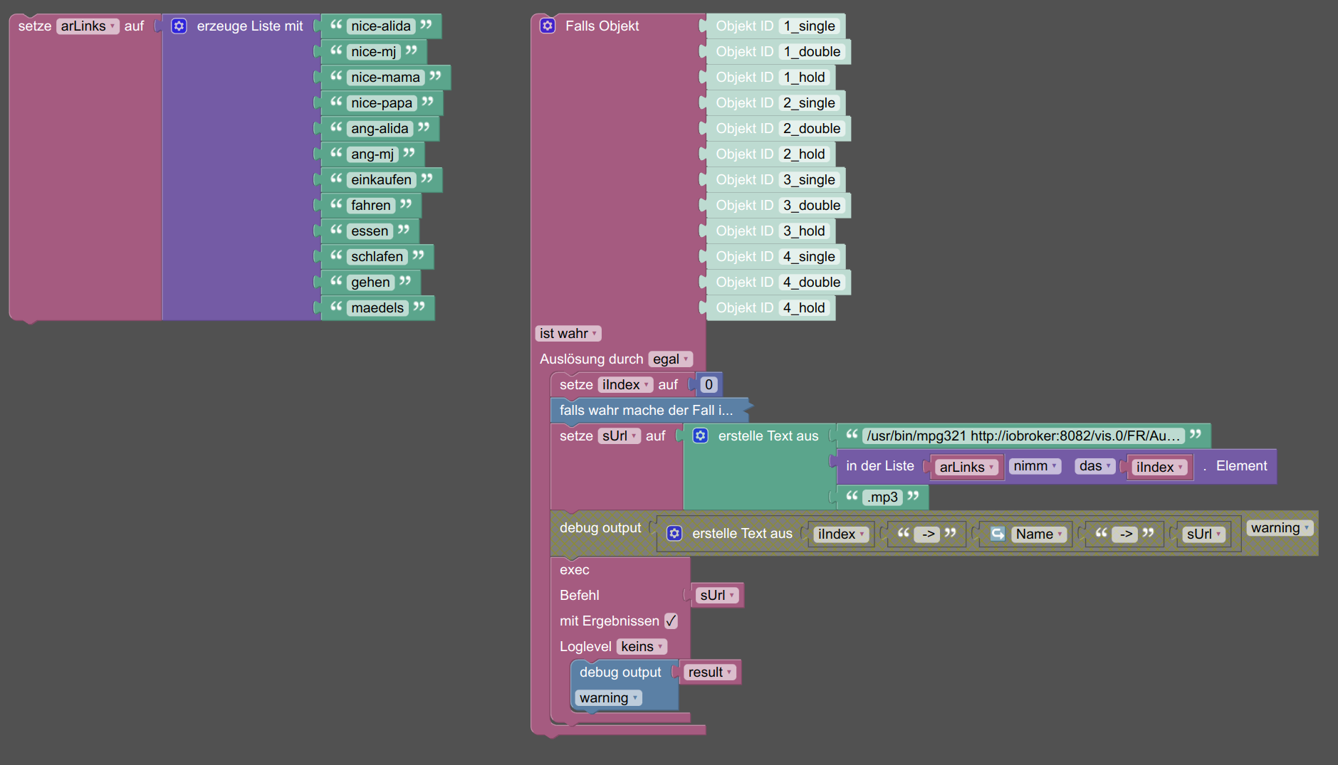

      Folgend das javascript aus blockly. Bitte nicht am überflüssigen "if" in Zeile 7 aufhalten, das ist nur der Optik im blockly halber:
      var arLinks, iIndex, sUrl, result;
      arLinks = ['nice-alida', 'nice-mj', 'nice-mama', 'nice-papa', 'ang-alida', 'ang-mj', 'einkaufen', 'fahren', 'essen', 'schlafen', 'gehen', 'maedels'];
      on({ id: [].concat(['alias.0.4fach_#1.1_single']).concat(['alias.0.4fach_#1.1_double']).concat(['alias.0.4fach_#1.1_hold']).concat(['alias.0.4fach_#1.2_single']).concat(['alias.0.4fach_#1.2_double']).concat(['alias.0.4fach_#1.2_hold']).concat(['alias.0.4fach_#1.3_single']).concat(['alias.0.4fach_#1.3_double']).concat(['alias.0.4fach_#1.3_hold']).concat(['alias.0.4fach_#1.4_single']).concat(['alias.0.4fach_#1.4_double']).concat(['alias.0.4fach_#1.4_hold']), val: true }, async (obj) => {
        iIndex = 0;
        if (true) {
          switch (true) {
            case (obj.common ? obj.common.name : "") == '1_single': iIndex = 1;break;
            case (obj.common ? obj.common.name : "") == '2_single': iIndex = 2;break;
            case (obj.common ? obj.common.name : "") == '3_single': iIndex = 3;break;
            case (obj.common ? obj.common.name : "") == '4_single': iIndex = 4;break;
            case (obj.common ? obj.common.name : "") == '1_double': iIndex = 5;break;
            case (obj.common ? obj.common.name : "") == '2_double': iIndex = 6;break;
            case (obj.common ? obj.common.name : "") == '3_double': iIndex = 7;break;
            case (obj.common ? obj.common.name : "") == '4_double': iIndex = 8;break;
            case (obj.common ? obj.common.name : "") == '1_hold': iIndex = 9;break;
            case (obj.common ? obj.common.name : "") == '2_hold': iIndex = 10;break;
            case (obj.common ? obj.common.name : "") == '3_hold': iIndex = 11;break;
            case (obj.common ? obj.common.name : "") == '4_hold': iIndex = 12;break;
        sUrl = ['/usr/bin/mpg321 http://iobroker:8082/vis.0/FR/Audio/',arLinks[(iIndex - 1)],'.mp3'].join('');
        exec(sUrl, async (error, result, stderr) => {
          console.warn(result);
        console.warn("exec: " + sUrl);
      Das ganze Thema Payload verstehe ich noch nicht, was ist das? Ein Rückgabewert bei Klick?

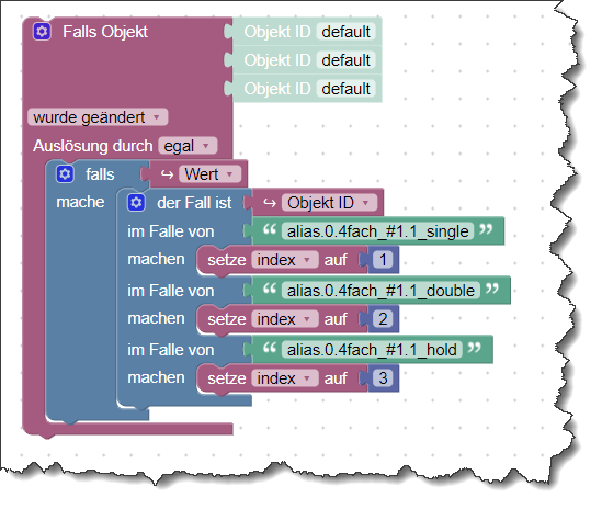

      • Codierknecht
        Codierknecht Developer Most Active @IobNordlicht last edited by Codierknecht
        @iobnordlicht
        Super - den interessanten Teil hast Du weggeschnitten.
        Was soll ein switch(true) machen?
        true ist und bleibt true - da switcht nix.
        Kann man zwar auch so einsetzen, liest sich aber kacke.
        Versuch's mal so:
        • I
          IobNordlicht @Codierknecht last edited by
          @codierknecht sagte in Mehrfachauslösung von Schalter: wo kommt's her?:
          @iobnordlicht
          Versuch's mal so:
          Stimmt, das habe ich zu kompliziert gedacht. Sollte aber trotzdem gehen, oder nicht?
          Ich teste das gleich mal morgen und mach es clean...
          • I
            IobNordlicht @IobNordlicht last edited by
            Wie zu erwarten, die Verzweigungslogik war umständlich, aber funktionierte ja bereits.
            Interessanterweise ist dadurch aber trotzdem mein erstes Problem gelöst, keine Doppelauslösung, warum auch immer...
            Also zurück zu den weiteren Fragen:
            @iobnordlicht sagte in Mehrfachauslösung von Schalter: wo kommt's her?:
            Außerdem bekomme ich vom Shellcommando den Output vermittels Variable result nicht geliefert, warum auch immer?
            Könnt ihr mir hier bittte weiterhelfen?

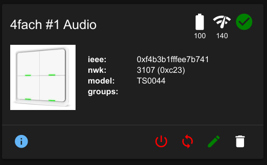

                  Hast du mal geschaut ob am Zigbee Adapter (davon ist anscheinend die Kachel in deinem 1. Post) eine Reaktion kommt, so das der Trigger überhaupt aktiv wird ?
                  Das mit dem Payload wird nur erklärbar wenn du mal mehr dazu zeigst.
                  A.

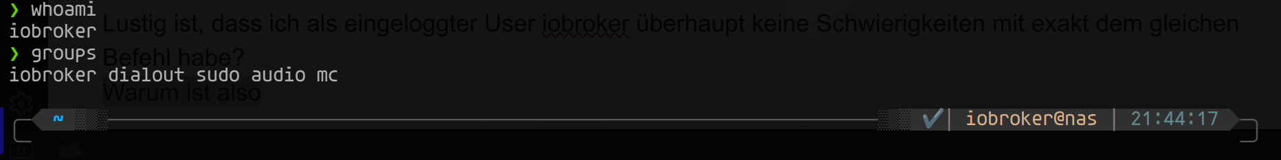

                    Lustig ist, dass ich als eingeloggter User iobroker überhaupt keine Schwierigkeiten mit exakt dem gleichen Befehl habe?
                    Der User und die Gruppen passt auch:
                    Und bitte geflissentlich jetztet die Gruppe sudo ignorieren, hat wohlüberlegte debugging Gründe, wie z.B. genau jetzt.
                    Warum gibt es einen Unterschied zwischen der Ausführung in exec und lokaler user shell? Beide laufen unter dem gleichen User, den gleichen Gruppen...
