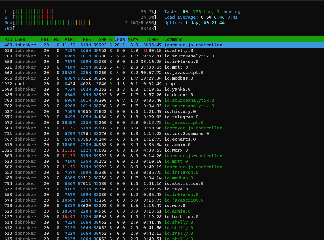

      Mein ioBroker ist ziemlich träge und langsam... jeder klick dauert.
      htop sieht meiner Meinung nach nicht besondersschlimm aus:
      iobroker läuft in einer VM über Proxmox mit 6gb Ram und 2 CPU Kernen..
      Gruss Raphi

        Thomas Braun Most Active @cainam last edited by Thomas Braun
        @cainam
        Bitte die Langfassung von
        iob diag
        bekannt machen.
        Und NIE als root herumkaspern.

                      influxdb.0
                      2024-01-26 22:40:06.402	warn	Error on writePoint("{"value":754,"time":"2024-01-26T21:39:36.394Z","from":"system.adapter.javascript.0","q":0,"ack":true}): RequestTimedOutError: Request timed out / "Request timed out""
                      influxdb.0
                      2024-01-26 22:40:06.401	warn	Point could not be written to database: iobroker
                      influxdb.0
                      2024-01-26 22:40:06.397	warn	Error on writePoint("{"value":-754,"time":"2024-01-26T21:39:36.389Z","from":"system.adapter.javascript.0","q":0,"ack":true}): RequestTimedOutError: Request timed out / "Request timed out""
                      influxdb.0
                      2024-01-26 22:40:06.396	warn	Point could not be written to database: iobroker
                      influxdb.0
                      2024-01-26 22:40:06.338	warn	Error on writePoint("{"value":6.008,"time":"2024-01-26T21:39:36.329Z","from":"system.adapter.javascript.0","q":0,"ack":true}): RequestTimedOutError: Request timed out / "Request timed out""
                      influxdb.0
                      2024-01-26 22:40:06.337	warn	Point could not be written to database: iobroker
                      influxdb.0
                      2024-01-26 22:40:06.266	warn	Error on writePoint("{"value":-752,"time":"2024-01-26T21:39:06.250Z","from":"system.adapter.javascript.0","q":0,"ack":true}): RequestTimedOutError: Request timed out / "Request timed out""
                      influxdb.0
                      2024-01-26 22:40:06.263	warn	Point could not be written to database: iobroker
                      influxdb.0
                      2024-01-26 22:40:05.221	warn	Error on writePoint("{"value":753,"time":"2024-01-26T21:39:35.213Z","from":"system.adapter.javascript.0","q":0,"ack":true}): RequestTimedOutError: Request timed out / "Request timed out""
                      influxdb.0
                      2024-01-26 22:40:05.221	warn	Point could not be written to database: iobroker
                      influxdb.0
                      2024-01-26 22:40:05.216	warn	Error on writePoint("{"value":-753,"time":"2024-01-26T21:39:35.208Z","from":"system.adapter.javascript.0","q":0,"ack":true}): RequestTimedOutError: Request timed out / "Request timed out""
                      • Glasfaser
                        Glasfaser @cainam last edited by
                        @cainam sagte in ioBroker sehr träg und langsam:
                        Error: getaddrinfo EAI_AGAIN api.telegram.org
                        2024-01-26 22:44:02.892 warn script.js.Informationen.Influx_offline: telegram: InfluxDB hat einen Fehler und ist OFFLINE!!!!!
                        influxdb.1
                        2024-01-26 22:41:01.250 error RequestTimedOutError: Request timed out
                        influxdb.0
                        2024-01-26 22:40:37.533 error RequestTimedOutError: Request timed out
                        eher ein Netzwerkproblem
