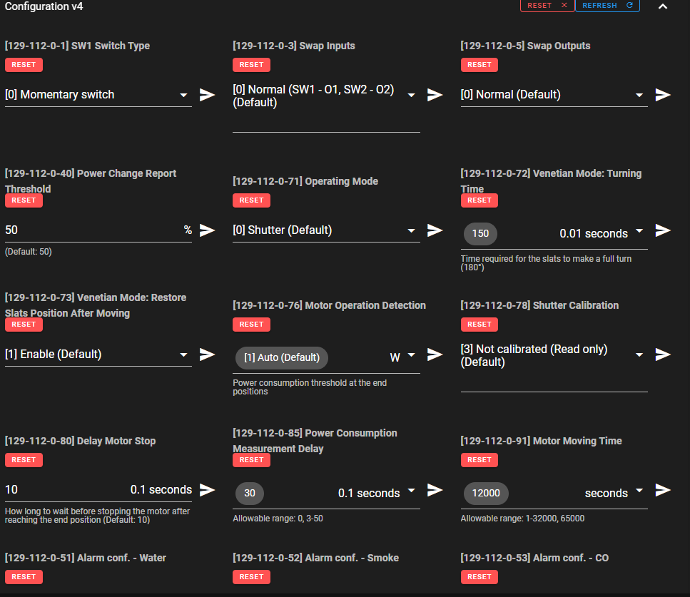

      Ich konnte diesen zwar problemlos einbinden aber dass was mir der z-wave Adapter aber schaffe ich es nicht, einfach nur die Ausgänge zu schalten.
      1. Parameter No. 54 - ???
        zwave2.0:
          "zwave2.0.Node_002.Configuration.alarmConf-Co": {
              "common": {
                "name": "Alarm conf. - CO",
                "desc": " 0 no action 1 open blinds 2 close blinds",
              "native": {
                "valueId": {
                  "commandClass": 112,
                  "property": 53,
      2. Parameter No. 40 - Power Consumption Reporting
        zwave2.0:
          "zwave2.0.Node_002.Configuration.powerReportThreshold": {
                      "common": {
                        "name": "Power report threshold",
                        "desc": "0-100 percentage"
                            "native": {
                              "valueId": {
                                "property": 40,
      3. Parameter No. 71 - Operating modes
        zwave2.0:
          "zwave2.0.Node_002.Configuration.operatingMode": {
                      "common": {
                        "name": "Operating mode",
                        "desc": "0 Shutter, 1 Venetian"
                            "native": {
                              "valueId": {
                                "property": 71,
      4. Parameter No. 72 - Venetian blind slats turning time
        zwave2.0:
          "zwave2.0.Node_002.Configuration.slatsTiltingTime": {
                      "common": {
                        "name": "Slats tilting time",
                        "desc": "0 - 32000, 0.01 s units"
                            "native": {
                              "valueId": {
                                "property": 72,
      5. Parameter No. 73 - Slats position after moving
        zwave2.0:
          "zwave2.0.Node_002.Configuration.slatsPosition": {
                      "common": {
                        "name": "Slats position",
                        "desc": "0 disable, 1 previous"
                            "native": {
                              "valueId": {
                                "property": 73,
      6. Parameter No. 76 - Motor operation detection
        zwave2.0:
          "zwave2.0.Node_002.Configuration.motorMovePowerThreshold": {
            "common": {
              "name": "Motor move power threshold",
              "desc": "0 disable, 1 auto, 2 - 255 W"
                  "native": {
                    "valueId": {
                      "property": 76,
      7. Parameter No. 78 – Forced shutter calibration
        zwave2.0:
          "zwave2.0.Node_002.Configuration.calibration": {
                      "common": {
                        "name": "Calibration",
                        "desc": "1 Start, 2 Cal, 3 Uncal, 4 Error",
                            "native": {
                              "valueId": {
                                "property": 78,
      8. Parameter No. 80 – Motor stop delay after limit switch detection
        zwave2.0:
          "zwave2.0.Node_002.Configuration.delayStopAtEndpoint": {
                      "common": {
                        "name": "Delay stop at endpoint",
                        "desc": "0 - 255, 0.1 s units"
                            "native": {
                              "valueId": {
                                "property": 80,

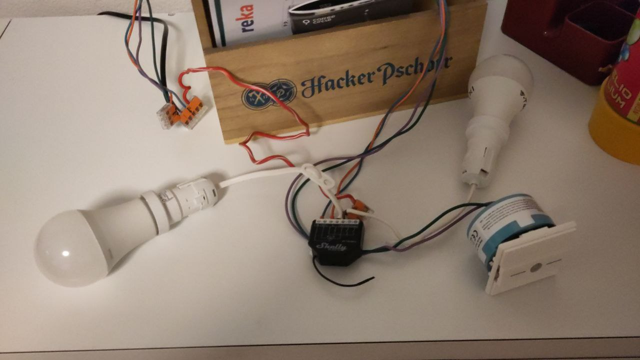

      Zumindest wurden bei zwave2.0.Node_002.Configuration.ouputOrientation beide Ausgänge nacheinander geschaltet, sprich physisch scheint das Gerät in Ordnung zu sein.

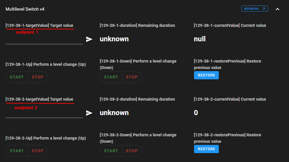

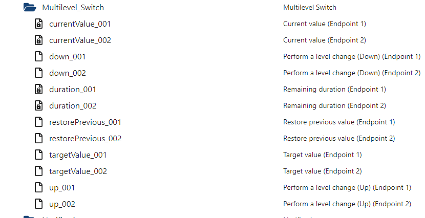

      Mit den Commands unter zwave2.0.Node_002.Multilevel_Switch war ich weniger erfolgreich, wenn überhaupt. Abhängig von zwave2.0.Node_002.Configuration.inputOrientation kann ich entweder O1 oder O2 kurz setzen über je nachdem zwave2.0.Node_002.Multilevel_Switch.restorePrevious_001 oder zwave2.0.Node_002.Multilevel_Switch.restorePrevious_002.

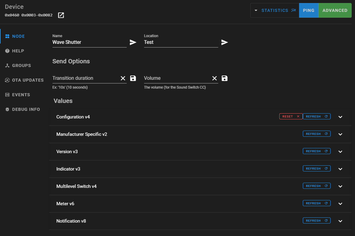

      Der komplette Objektbaum ist hier: zwave2.0.Node_002.json
      Zudem finde ich es merkwüridg, dass der Shutter nicht in Z-Wave Product Catalog - Search for shelly gelistet ist und hier ist er unvollständig Z-Wave JS Config DB Browser - 0x0082
      Bei HA scheint es schon ein paar Leute zu geben mit dem Gerät, das ist bisher meine Hoffnung darüber mehr Einsicht zu erhalten.
      Was ich bestätigen kann ( nach Rückmeldung vom Shelly Support):
      1. Endpoint 1: Blenden hoch und runter (Rolladenmodus)
      2. Endpoint 2: Blenden drehen (extra Endpoint für Jalousienmodus)
