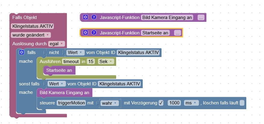

            Mein Blockly sieht dann so aus
              <variables>
              </variables>
              <block type="on" id="mB8U4~enKq{inDA}C=9Z" x="-612" y="-287">
                <field name="OID">alias.0.Flur.Klingelstatus.ACTUAL</field>
                  <block type="controls_if" id="R17Tu(_+g5V7Y@X[3I4q">
                      <block type="logic_negate" id="5:rBm7?ek205^Y_EpBNx">
                        <value name="BOOL">
                          <block type="get_value" id="lb|Pb~V0jx^s-vI{Mdw,">
                      <block type="timeouts_settimeout" id="{=r^fq`cVYKBP$zRjb|;">
                        <field name="DELAY">15</field>
                          <block type="procedures_callcustomnoreturn" id="J^7h5R~=dUOOB3$X?E#7">
                            <mutation name="Startseite an"></mutation>
                    <value name="IF1">
                      <block type="get_value" id="ad[ek;%W_jM),X(c#Q0j">
                    <statement name="DO1">
                      <block type="procedures_callcustomnoreturn" id="9bTJ07cel.ON7gr7Uzi?">
                        <mutation name="Bild Kamera Eingang an"></mutation>
                          <block type="control" id="L%YrHlJRwVxq!^-w;{`=">
                            <field name="OID">fully-tablet-control.0.device.wandtablet.commands.triggerMotion</field>
                            <field name="DELAY_MS">1000</field>
                            <field name="UNIT">ms</field>
                              <block type="logic_boolean" id="=;kFsK40T-![zW6N]*tD">
              <block type="procedures_defcustomnoreturn" id="An;{RLE$}|QcMD]a,bL_" x="-387" y="-287">
                <mutation statements="false"></mutation>
                <field name="NAME">Bild Kamera Eingang an</field>
                <field name="SCRIPT">IHNldFN0YXRlKCJ2aXMuMC5jb250cm9sLmNvbW1hbmQiLCAneyJpbnN0YW5jZSI6ICIqIiwgImNvbW1hbmQiOiAiY2hhbmdlVmlldyIsICJkYXRhIjogIm1haW4vS2FtZXJhRWluZ2FuZ1dhbmRUYWJsZXQifScpOw==</field>
              <block type="procedures_defcustomnoreturn" id="^PMwI:/Z/Ox*et`e7BUS" x="-387" y="-238">
                <field name="NAME">Startseite an</field>
                <field name="SCRIPT">IHNldFN0YXRlKCJ2aXMuMC5jb250cm9sLmNvbW1hbmQiLCAneyJpbnN0YW5jZSI6ICIqIiwgImNvbW1hbmQiOiAiY2hhbmdlVmlldyIsICJkYXRhIjogIm1haW4vU3RhcnRzZWl0ZSJ9Jyk7</field>
            Inhalt javascript Funktion
             setState("vis.0.control.command", '{"instance": "*", "command": "changeView", "data": "main/KameraEingangWandTablet"}');
             setState("vis.0.control.command", '{"instance": "*", "command": "changeView", "data": "main/Startseite"}');
