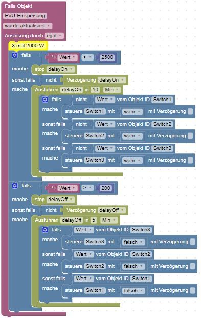

          paul53 @maik5066 last edited by paul53
          @maik5066 sagte: Könnt ihr mir weiterhelfen ?
          Prinzip 3-stufige Ansteuerung mit Prüfung der Mindestdauer von Grenzwertüber(unter)schreitung.
          Voraussetzung: JS-Adapter Version >= 7.0.5.

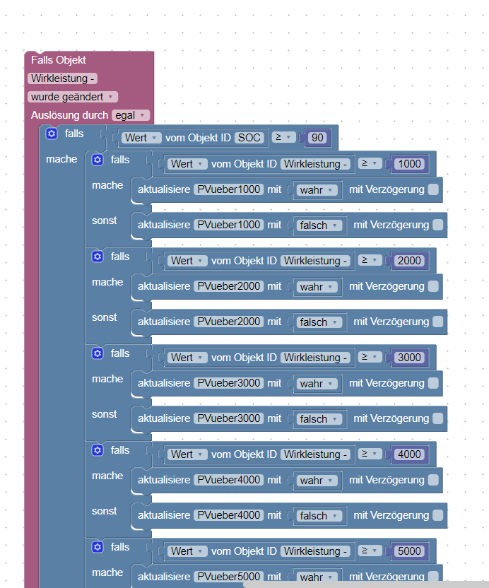

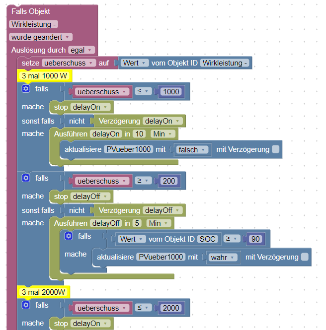

            maik5066 @paul53 last edited by
            @paul53 Vielen Dank, kannst du mir das per XML zusenden ?
            Hier noch der Screenshot meines Skriptes :
              @maik5066 sagte: per XML zusenden ?
               <variables>
                 <variable type="timeout" id="delayOn">delayOn</variable>
                 <variable type="timeout" id="delayOff">delayOff</variable>
               </variables>
               <block type="on" id="!Qbb5{lAFMZT#M$Q2P%P" x="87" y="12">
                 <field name="OID">0_userdata.0.Blockly.EVU-Einspeisung</field>
                   <block type="comment" id="9X:XKXRgH!xZ!=zZbThm">
                     <field name="COMMENT">3 mal 2000 W</field>
                       <block type="controls_if" id="?{[99~rn+X@-!776Gil$">
                           <block type="logic_compare" id="d%IZlzT50i(a7nefKk6]">
                             <field name="OP">LT</field>
                               <block type="on_source" id="XUIHKI9ro9*6gU8Y~cuh">
                               <block type="math_number" id="vP_iZf?M;`@RCY1gD^i:">
                                 <field name="NUM">2500</field>
                           <block type="timeouts_cleartimeout" id="|#WysqWLOkMz:?pQ*-CZ">
                             <field name="NAME">delayOn</field>
                         <value name="IF1">
                           <block type="logic_negate" id="dch2(fx(/ykyn#X-R`9x">
                             <value name="BOOL">
                               <block type="timeouts_gettimeout" id="xJVx:Mi5[U_(t*bw(Yq$">
                         <statement name="DO1">
                           <block type="timeouts_settimeout" id="=EI:`22NaF],y?uV^b1B">
                             <field name="DELAY">10</field>
                               <block type="controls_if" id="i.:l;5vs?$}^L}N-R(^T">
                                 <mutation elseif="2"></mutation>
                                   <block type="logic_negate" id="R(_3jAG`Md_w[,(|^wr/">
                                     <value name="BOOL">
                                       <block type="get_value" id="NG3*!?gfl8{k3cP;uW1`">
                                         <field name="OID">0_userdata.0.Blockly.Switch1</field>
                                   <block type="control" id="qYesRpdij9z`93JQ2~w%">
                                       <block type="logic_boolean" id="ndh[{X~M{gFV,0p.u?49">
                                 <value name="IF1">
                                   <block type="logic_negate" id="r:ak[AbR=(fM06(!MiNq">
                                     <value name="BOOL">
                                       <block type="get_value" id="Wk#V-l{Fi[!?`_6`Qj_b">
                                         <field name="OID">0_userdata.0.Blockly.Switch2</field>
                                   <block type="control" id="S(zYFzv^}$AcCYB-`Q`e">

              Wird der Zeitstempel noch regelmäßig aktualisiert, wenn der Überschuss 0 ist?
              Falls nicht, muss man den Trigger erweitern:
                Danke dir,
                Ist der Delay, der Abfrage bzw. Änderungsntervall oder stehe ich gerade auf dem Schlauch
                ich habe es jetzt so umgesetzt :
                paul53 Codierknecht 3 Replies Last reply Reply Quote 0

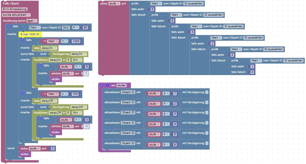

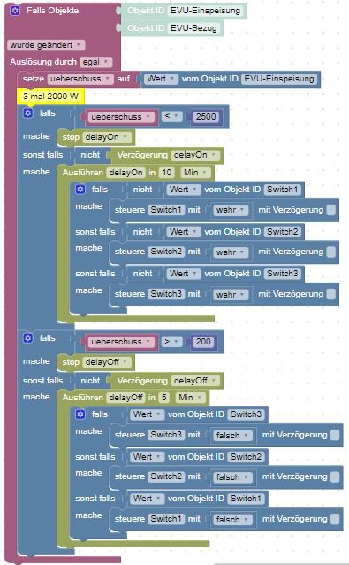

                  @maik5066 sagte: ich habe es jetzt so umgesetzt :
                  So wird es nichts. Sind es 3 Stufen mit je 2000 W oder 6 Stufen mit je 1000 W?
                  Beispiel mit 6 Stufen
                  • Codierknecht
                    Codierknecht Developer Most Active @maik5066 last edited by Codierknecht
                    @maik5066 sagte in PV Überschuss SMA Toogle vermeiden:
                    Trigger reagieren auf Ereignisse - nicht auf Intervalle.
                    Das "delay" trägt Deiner Anforderung Rechnung
                    ich möchte aber nicht, das sofort der Datenpunkt Bsp. Stufe 1 auf false gesetzt wird
                    Erst wenn der Zustand länger als X-Minuten ansteht, wird geschaltet bzw. geschrieben.
                    Fällt er währenddessen aus den Grenzen, wird das "delay" gestoppt und es passiert ... nix.
                      @maik5066
                      Du hast 6 Datenpunkte für jeweils eine 1000-W-Stufe?
                      Vorschlag:
                      Bei PV-Überschuss muss die Hysterese etwas größer sein als die Leistungsaufnahme einer Stufe.
                      Das Skript funktioniert so nur, wenn auch tatsächlich in jeder Stufe 1000 W Verbrauch zugeschaltet werden.
                      Ohne das Zuschalten von Verbrauchern machen Stufen keinen Sinn, denn dann ist der Überschuss in W ausreichend aussagekräftig.
                        @paul53 Danke dir, 2 kleine Fragen habe ich noch, welche Objekt ID soll ich in der Funktion wie in der oben rechten Prüfung einsetzten ? Gibt es nur einen Datenpunkt der dann Zahlen von 1-6 beinhaltet ?
                          @maik5066 sagte: Gibt es nur einen Datenpunkt der dann Zahlen von 1-6 beinhaltet ?
                          Nein, es sind 6 DP vom Typ "boolean", die jeweils einen 1000 W Verbraucher zuschalten.

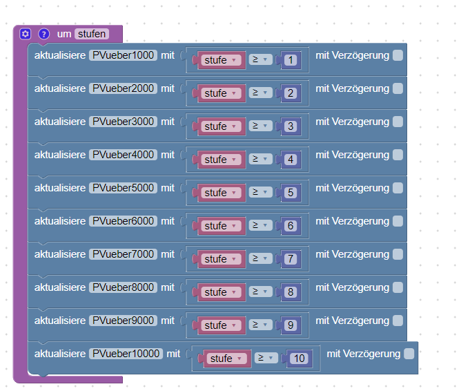

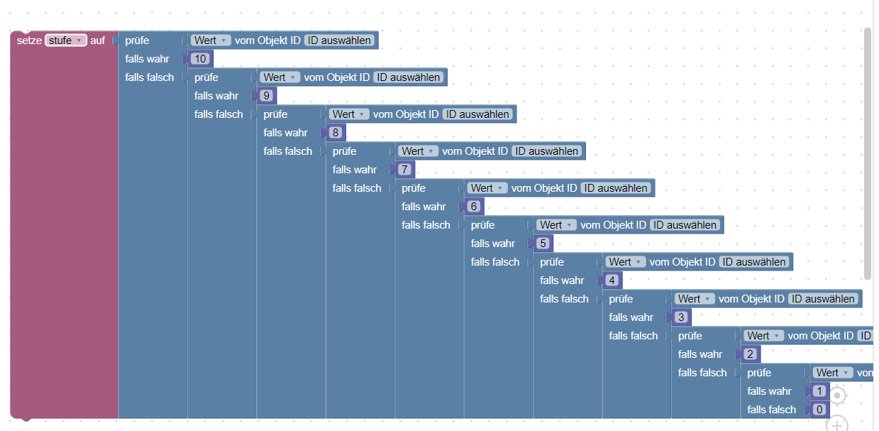

                            @paul53 danke dir, ich habe es jetzt mit 10 Stufen so umgesetzt , was soll ich auf den Abfragen ob rechts eintragen
                              @maik5066 sagte: was soll ich auf den Abfragen ob rechts eintragen
                              Oben beginnend mit "PVueber10000" abwärts.
                              Mit den User-Datenpunkten wird es nicht funktionieren, da damit keine Verbraucher geschaltet werden. Das Zu- und Abschalten von Verbrauchern hat Rückwirkung auf den PV-Überschuss, was im Skript vorausgesetzt wird.
                                @paul53 Entschuldige ich verstehe es leider nicht :
                                der Block setze Stufe auf , kannst mir diesen beschreiben
                                Die Funktion "um Stufen" , kannst du mir diesen auch beschreiben
                                Danke dir für deine Hilfe.
