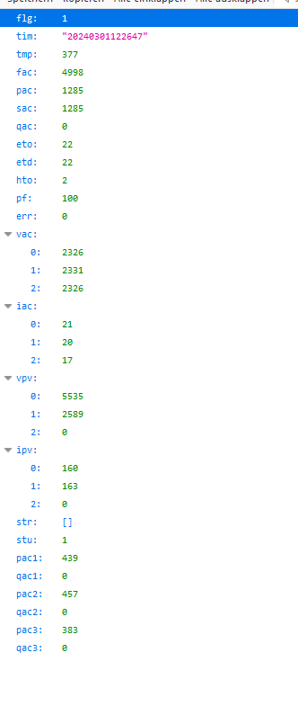

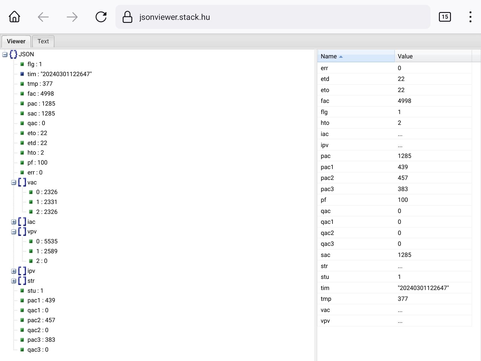

          JSON Rohdaten:
          {"flg":1,"tim":"20240301122647","tmp":377,"fac":4998,"pac":1285,"sac":1285,"qac":0,"eto":22,"etd":22,"hto":2,"pf":100,"err":0,"vac":[2326,2331,2326],"iac":[21,20,17],"vpv":[5535,2589,0],"ipv":[160,163,0],"str":[],"stu":1,"pac1":439,"qac1":0,"pac2":457,"qac2":0,"pac3":383,"qac3":0}
