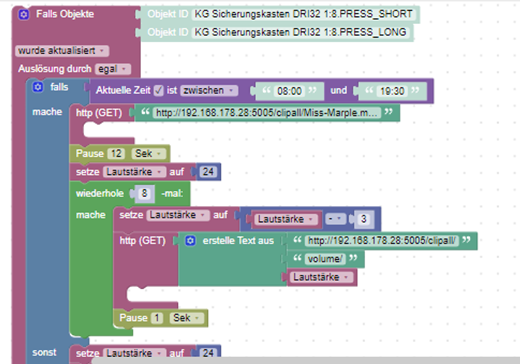

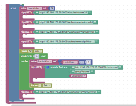

      Hallo, ich habe folgendes Blockly erstellt.
      <block xmlns="https://developers.google.com/blockly/xml" type="on_ext" id="kc5hA8s]SzYlk[h=5CUF" x="13" y="63">
        <value name="OID0">
          <shadow type="field_oid" id="#Q2c:{hd~*/lrCttSF:w">
            <field name="oid">hm-rpc.1.00171BE9A4E37C.8.PRESS_SHORT</field>
        <value name="OID1">
          <shadow type="field_oid" id="hEV`dU[o,H+w#+U#2zRs">
            <field name="oid">hm-rpc.1.00171BE9A4E37C.8.PRESS_LONG</field>
          <block type="controls_if" id="DSogTIK`#vruS^KCon!a">
              <block type="time_compare_ex" id="_X-t6OAT{LkOTW7_9eqp">
                <mutation xmlns="http://www.w3.org/1999/xhtml" end_time="true" actual_time="true"></mutation>
                <value name="START_TIME">
                  <shadow type="text" id="{RXUSqb821_vY.W#|klU">
                    <field name="TEXT">08:00</field>
                <value name="END_TIME">
                  <shadow type="text" id="WtCCDqL;g={e,eNE,|ch">
                    <field name="TEXT">19:30</field>
              <block type="http_get" id="#rGli9QJae`|yN|9-F(H">
                <value name="URL">
                  <shadow type="text" id="jI~|A)U=o^X1qb+~|8uR">
                    <field name="TEXT">http://</field>
                  <block type="text" id="y,WX5F,z_e{z8*py6y80">
                    <field name="TEXT">http://192.168.178.28:5005/clipall/Miss-Marple.mp3/24</field>
                  <block type="timeouts_wait" id="Z*$9pyFp!%bK#sHKAQ^L">
                    <field name="DELAY">12</field>
                      <block type="variables_set" id="uEv]M:CwW|{L4Id(|7,u">
                        <field name="VAR" id="qF^Dv{8_res2E03z3U@Y">Lautstärke</field>
                          <block type="math_number" id="/AKmeY={fGj?|@wu5lj%">
                            <field name="NUM">24</field>
                          <block type="controls_repeat_ext" id="-_pA=Wi7:9!3aP,KY67H">
                            <value name="TIMES">
                              <shadow type="math_number" id="6ar6?`^OUL@no8Tw~x9V">
                                <field name="NUM">8</field>
                            <statement name="DO">
                              <block type="variables_set" id="w.lPzP3b=?.Cn-.Np!A?">
                                  <block type="math_arithmetic" id=":FC/6IM8q}t-z*g%2^.j">
                                      <shadow type="math_number" id="w$n2??9k1FK8i*=Peet_">
                                        <field name="NUM">1</field>
                                      <block type="variables_get" id="`!{L^1wQ,G}_.@2LH/s+">
                                      <shadow type="math_number" id="`1O6QUZA-xcFx[n}]5R(">
                                        <field name="NUM">3</field>
                                  <block type="http_get" id="{mXmgCGP{_Go3tYnqQ78">
                                    <value name="URL">
                                      <block type="text_join" id="9X0%IV_#gw1us4$oWdeA">
                                        <value name="ADD0">
                                          <block type="text" id="T[^f#uGR{Mz/`33uf[__">
                                            <field name="TEXT">http://192.168.178.28:5005/clipall/</field>
                                        <value name="ADD1">
                                          <block type="text" id="k{#z8D2!fN-|S1u8fw6=">
                                            <field name="TEXT">volume/</field>
                                        <value name="ADD2">
                                          <block type="variables_get" id="f#S=?Pj5bWhYZBlnlrj*">
                                      <block type="timeouts_wait" id="1W(QO_yH8j?rgA.5@D7d">
                                        <field name="DELAY">1</field>
            <statement name="ELSE">
              <block type="variables_set" id=",[._kN9yTpY6#-;cX+H;">
                  <block type="math_number" id="S~IPfRBm{qcN(xwka5JA">
                  <block type="http_get" id="*wtQ|k?p;|M1AK8Dx_!I">
                    <value name="URL">
                      <shadow type="text" id="xJ}6pLSg%zoJda$C_0d`">
                      <block type="text" id="xh]W/O)u@f8R@T)p#~WP">
                        <field name="TEXT">http://192.168.178.28:5005/Kueche/volume/24</field>
                      <block type="http_get" id="6?9~gFe*P1R#PXOz`A~7">
                        <value name="URL">
                          <block type="text" id="$nuq(}%RPmSujZ/:o0_T">
                            <field name="TEXT">http://192.168.178.28:5005/Wohnzimmer/volume/24</field>
                          <block type="http_get" id="!!}_Yf.k.4`((d?Q8EVg">
                            <value name="URL">
                              <block type="text" id="uZq=9R7F72ufrSi-HnNW">
                                <field name="TEXT">http://192.168.178.28:5005/Kueche/join/Wohnzimmer</field>
                              <block type="http_get" id="FZUnV{nni0+wPXzK}Sg,">
                                <value name="URL">
                                  <block type="text" id="+x)tTA[F(].)X:p#wR^R">
                                    <field name="TEXT">http://192.168.178.28:5005/Wohnzimmer/clip/Miss-Marple.mp3/24</field>
                                  <block type="timeouts_wait" id="qf_9rwoDlFtqlkIPj}^J">
                                      <block type="controls_repeat_ext" id="s6S[DsT;.n30Wh*uy.IZ">
                                          <shadow type="math_number" id="BzSh,yOe47]rmU)zG,2=">
                                          <block type="variables_set" id="Q2`N%ie6NFN2U+g1/=U(">
                                              <block type="math_arithmetic" id="8~?!=c`EQ0`.Yi67v.]B">
                                                  <block type="variables_get" id="`9s7~mXXjubYhhONJ9ik">
                                                  <shadow type="math_number" id="UiVP(ivvX@}*KFd]PaM*">
                                              <block type="http_get" id="Jr;ed4uD*kHBWD3fr|B*">
                                                <value name="URL">
                                                  <shadow type="text" id="x[n8x(-[Dz}O|#z4lT3+">
                                                  <block type="text_join" id="YEI4fPgK47vDh4%KLYQ:">
                                                    <value name="ADD0">
                                                      <block type="text" id=",OpjB!,VbZHh808iGM@O">
                                                        <field name="TEXT">http://192.168.178.28:5005/Wohnzimmer/</field>
                                                    <value name="ADD1">
                                                      <block type="text" id="bx!zlgz8mh+#mSK}[F?g">
                                                        <field name="TEXT">groupVolume/</field>
                                                    <value name="ADD2">
                                                      <block type="variables_get" id="Bnmr8G~u}AMAf1k@w7Te">
                                                  <block type="timeouts_wait" id=",EFe1GLv?rOX.saLJ;18">
                                          <block type="http_get" id=")OC#sAK.]@jcZ2!^xyf5">
                                            <value name="URL">
                                              <shadow type="text" id="3$Q)wE346FqSN9eI@a,!">
                                              <block type="text" id="oYa|6?3[IL=9I[9^5F/#">
                                                <field name="TEXT">http://192.168.178.28:5005/Kueche/leave/Wohnzimmer</field>
      Dieses ging mit request ohne Fehler. Auch mit dem Block http get funktioniert das Skript so wie ich es möchte, ich bekomme aber folgenden Fehler:

            @jwerlsdf und was erwartest Du in den ganzen GET Bausteinen als Ergebnis ? Da steht ja nix drin 😉
              jwerlsdf @DJMarc75 last edited by jwerlsdf
              @djmarc75
              Das ist ja meine Frage, was muss da rein?
              Wie gesagt, die Funktion ist für mich bereits gegeben und das skript funktioniert so wie es sein soll (so wie vorher mit request). Aber es kommt dieser Fehler.

                  ich will nur diesen Fehler
                  script.js.EG_Tuerklingel: timeout of 2000ms exceeded
                  rausbekommen, alles andere schiebe ich erst einmal auf.

                      ich vermute, dass es mit dem http get block zu tun haben muss. In Javascript wird dies deutlich:
                      on({ id: [].concat(['hm-rpc.1.00171BE9A4E37C.8.PRESS_SHORT']).concat(['hm-rpc.1.00171BE9A4E37C.8.PRESS_LONG']), change: 'any' }, async (obj) => {
                        if (compareTime('08:00', '19:30', 'between', null)) {
                          httpGet('http://192.168.178.28:5005/clipall/Miss-Marple.mp3/24', { timeout: 2000 }, async (err, response) => {
                            if (err) {
                              console.error(err);
                        Homoran Global Moderator Administrators @jwerlsdf last edited by
                        @jwerlsdf sagte in Umstellung request auf http get:
                        Na super!
                        danach hatte ich scjon im XML gesucht.
                        Dann solltest du im Tester Thread fragen, wie diese Bausteine zu verwenden sind.
                        von irgendeinem (ohne debug Bausteine nicht einzugrenzen) kommt wohl nichts zurück.
