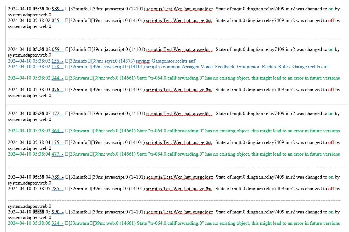

      Im iob log finde zu den Zeitpunkten diese Einträge:
      2024-04-05 01:48:56.956  - info: javascript.0 (924038) script.js.common.Tablet_Steuerung.Display_ON_Flur_OG: VIS OG ON
      2024-04-05 01:48:56.963  - info: linux-control.0 (1101693) state linux-control.0.VIS-OG.VIS_OG_ScreenOn changed: true (ack = false)
      2024-04-05 01:49:02.551  - info: sayit.0 (924984) saying: Garagentor rechts auf
      2024-04-05 20:02:48.616  - info: javascript.0 (924038) script.js.common.Tablet_Steuerung.Display_ON_Flur_EG_Ubuntu_neu: VIS EG OFF
      2024-04-05 20:02:48.619  - info: linux-control.0 (1101693) state linux-control.0.VIS-EG.VIS_EG_ScreenOff changed: true (ack = false)
      2024-04-05 20:04:01.460  - info: sayit.0 (924984) saying: Garagentor links auf

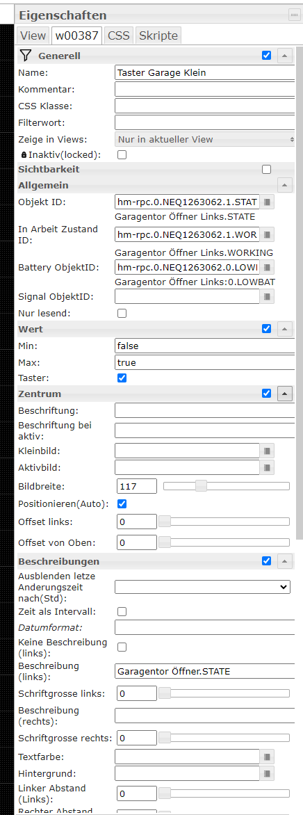

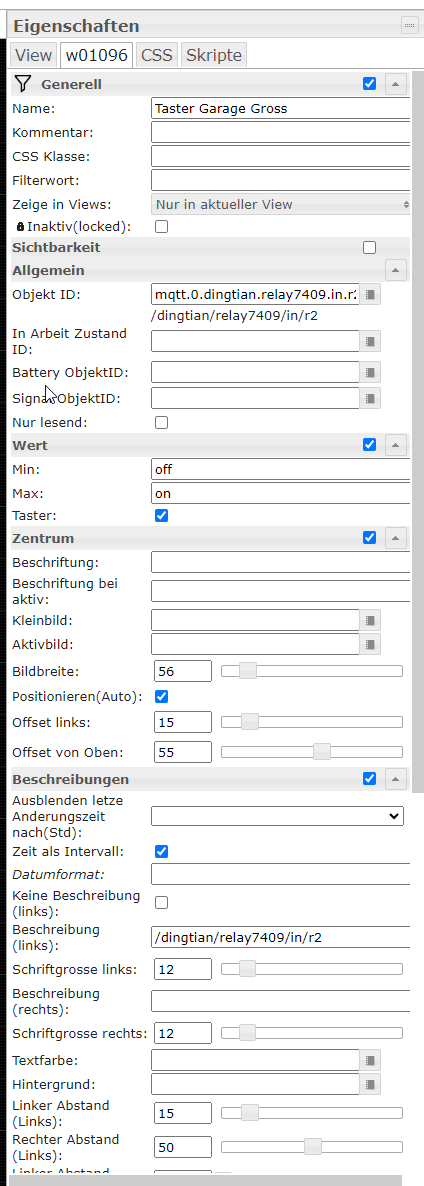

      In VIS sehen die Widgets so aus:
      Das sind die Widgets dazu:
      Garage klein (links):
      Widget Export:
      [{"tpl":"tplHqButton","data":{"g_fixed":true,"g_visibility":false,"g_css_font_text":true,"g_css_background":false,"g_css_shadow_padding":false,"g_css_border":true,"g_gestures":false,"g_signals":true,"g_last_change":false,"visibility-cond":"==","visibility-val":1,"visibility-groups-action":"hide","oid":"hm-rpc.0.NEQ1263062.1.STATE","min":"false","max":"true","iconName":"","btIconWidth":"117","offsetAuto":true,"leftOffset":"0","topOffset":"0","signals-cond-0":"==","signals-val-0":true,"signals-icon-0":"/icons-mfd-png/fts_garage_door_10.png","signals-icon-size-0":"120","signals-blink-0":true,"signals-horz-0":"4","signals-vert-0":0,"signals-hide-edit-0":false,"signals-cond-1":"==","signals-val-1":"false","signals-icon-1":"/icons-mfd-png/fts_garage_door_100.png","signals-icon-size-1":"120","signals-blink-1":false,"signals-horz-1":"4","signals-vert-1":0,"signals-hide-edit-1":false,"signals-cond-2":"==","signals-val-2":true,"signals-icon-2":"/vis/signals/lowbattery.png","signals-icon-size-2":0,"signals-blink-2":false,"signals-horz-2":0,"signals-vert-2":0,"signals-hide-edit-2":false,"lc-type":"last-change","lc-is-interval":true,"lc-is-moment":false,"lc-format":"","lc-position-vert":"top","lc-position-horz":"right","lc-offset-vert":0,"lc-offset-horz":0,"lc-font-size":"12px","lc-font-family":"","lc-font-style":"","lc-bkg-color":"","lc-color":"","lc-border-width":"0","lc-border-style":"","lc-border-color":"","lc-border-radius":10,"lc-zindex":0,"pushButton":true,"g_styles":true,"g_leftRight":true,"timeAsInterval":false,"infoLeftFontSize":"0","infoFontRightSize":"0","infoLeftPaddingLeft":"0","infoLeftPaddingRight":"0","infoRightPaddingRight":"0","usejQueryStyle":true,"oid-working":"hm-rpc.0.NEQ1263062.1.WORKING","oid-battery":"hm-rpc.0.NEQ1263062.0.LOWBAT","descriptionLeft":"Garagentor Öffner.STATE","name":"Taster Garage Klein","caption":"","styleNormal":"","styleActive":"","changeEffect":"","testActive":true,"signals-oid-1":"hm-rpc.0.NEQ0529675.3.STATE","signals-oid-0":"hm-rpc.0.NEQ0529675.3.STATE"},"style":{"left":"366px","top":"570px","z-index":"5","opacity":"","width":"130px","height":"122px","border-width":"1px","color":"#ffffff","border-style":"solid","border-color":"#FFFFFF","border-radius":"6px"},"widgetSet":"hqwidgets"}]
      Garage Gross (Rechts):
      Widget Export:
      [{"tpl":"tplHqButton","data":{"g_fixed":true,"g_visibility":false,"g_css_font_text":true,"g_css_background":false,"g_css_shadow_padding":false,"g_css_border":true,"g_gestures":false,"g_signals":true,"g_last_change":false,"visibility-cond":"==","visibility-val":1,"visibility-groups-action":"hide","oid":"mqtt.0.dingtian.relay7409.in.r2","min":"off","max":"on","lc-type":"last-change","lc-is-interval":true,"lc-is-moment":false,"lc-format":"","lc-position-vert":"top","lc-position-horz":"right","lc-offset-vert":0,"lc-offset-horz":0,"lc-font-size":"12px","lc-font-family":"","lc-font-style":"","lc-bkg-color":"","lc-color":"","lc-border-width":"0","lc-border-style":"","lc-border-color":"","lc-border-radius":10,"lc-zindex":0,"pushButton":true,"g_styles":true,"g_leftRight":true,"usejQueryStyle":true,"oid-working":"","oid-battery":"","name":"Taster Garage Gross","styleNormal":"","styleActive":"","changeEffect":"","testActive":true,"g_center":true,"iconName":"","btIconWidth":"56","offsetAuto":"true","leftOffset":"15","topOffset":"55","timeAsInterval":true,"infoLeftFontSize":"12","infoFontRightSize":"12","infoLeftPaddingLeft":"15","infoLeftPaddingRight":"50","infoRightPaddingRight":"15","descriptionLeft":"/dingtian/relay7409/in/r2","signals-cond-0":"==","signals-val-0":true,"signals-icon-0":"/icons-mfd-png/fts_garage_door_10.png","signals-icon-size-0":"120","signals-blink-0":true,"signals-horz-0":"4","signals-vert-0":0,"signals-hide-edit-0":false,"signals-cond-1":"==","signals-val-1":"false","signals-icon-1":"/icons-mfd-png/fts_garage_door_100.png","signals-icon-size-1":"120","signals-blink-1":false,"signals-horz-1":"4","signals-vert-1":0,"signals-hide-edit-1":false,"signals-cond-2":"==","signals-val-2":true,"signals-icon-2":"/vis/signals/lowbattery.png","signals-icon-size-2":"120","signals-blink-2":false,"signals-horz-2":"4","signals-vert-2":0,"signals-hide-edit-2":false,"signals-oid-0":"hm-rpc.0.NEQ0529935.3.STATE","signals-oid-1":"hm-rpc.0.NEQ0529935.3.STATE"},"style":{"left":"504px","top":"570px","z-index":"5","opacity":"","width":"130px","height":"122px","border-width":"1px","color":"#ffffff","border-style":"solid","border-color":"#FFFFFF","border-radius":"6px"},"widgetSet":"hqwidgets"}]

      Ich bin für jeden Hinweis mehr als Dankbar weil ein öffnen der Tore definitiv nicht beim Einschalten des Monitors passieren sollte.
      Iob ist nicht per Portfreigabe aus dem I-Net erreichbar. War er auch noch nie und ich nutze keine Cloud.
      Sonniges Wochenende

                  So,
                  habe das Script von @Asgothian zur Ursachen Forschung jetzt laufen und wie der Teufel es will kommt auch prompt der Fehler:
                  2024-04-10 05:38:00.989  - info: javascript.0 (14101) script.js.Test.Wer_hat_ausgelöst:  State of mqtt.0.dingtian.relay7409.in.r2 was changed to on by system.adapter.web.0
                  2024-04-10 05:38:02.055  - info: javascript.0 (14101) script.js.Test.Wer_hat_ausgelöst:  State of mqtt.0.dingtian.relay7409.in.r2 was changed to off by system.adapter.web.0
                  2024-04-10 05:38:02.059  - info: javascript.0 (14101) script.js.Test.Wer_hat_ausgelöst:  State of mqtt.0.dingtian.relay7409.in.r2 was changed to on by system.adapter.web.0
                  2024-04-10 05:38:02.156  - info: sayit.0 (14573) saying: Garagentor rechts auf
                  2024-04-10 05:38:02.158  - info: javascript.0 (14101) script.js.common.Ansagen.Voice_Feedback_Garagentor_Rechts_Rules: Garage rechts auf
                  2024-04-10 05:38:02.344  - warn: web.0 (14661) State "tr-064.0.callForwarding.0" has no existing object, this might lead to an error in future versions
                  2024-04-10 05:38:03.076  - info: javascript.0 (14101) script.js.Test.Wer_hat_ausgelöst:  State of mqtt.0.dingtian.relay7409.in.r2 was changed to off by system.adapter.web.0
                  2024-04-10 05:38:03.172  - info: javascript.0 (14101) script.js.Test.Wer_hat_ausgelöst:  State of mqtt.0.dingtian.relay7409.in.r2 was changed to on by system.adapter.web.0
                  2024-04-10 05:38:03.364  - warn: web.0 (14661) State "tr-064.0.callForwarding.0" has no existing object, this might lead to an error in future versions
                  2024-04-10 05:38:04.175  - info: javascript.0 (14101) script.js.Test.Wer_hat_ausgelöst:  State of mqtt.0.dingtian.relay7409.in.r2 was changed to off by system.adapter.web.0
                  2024-04-10 05:38:04.477  - warn: web.0 (14661) State "tr-064.0.callForwarding.0" has no existing object, this might lead to an error in future versions
                  2024-04-10 05:38:04.789  - info: javascript.0 (14101) script.js.Test.Wer_hat_ausgelöst:  State of mqtt.0.dingtian.relay7409.in.r2 was changed to on by system.adapter.web.0
                  2024-04-10 05:38:05.785  - info: javascript.0 (14101) script.js.Test.Wer_hat_ausgelöst:  State of mqtt.0.dingtian.relay7409.in.r2 was changed to off by system.adapter.web.0
                  2024-04-10 05:38:05.990  - info: javascript.0 (14101) script.js.Test.Wer_hat_ausgelöst:  State of mqtt.0.dingtian.relay7409.in.r2 was changed to on by system.adapter.web.0
                  2024-04-10 05:38:06.324  - warn: web.0 (14661) State "tr-064.0.callForwarding.0" has no existing object, this might lead to an error in future versions
                  2024-04-10 05:38:07.172  - info: javascript.0 (14101) script.js.Test.Wer_hat_ausgelöst:  State of mqtt.0.dingtian.relay7409.in.r2 was changed to off by system.adapter.web.0
                  2024-04-10 05:38:07.324  - warn: web.0 (14661) State "tr-064.0.callForwarding.0" has no existing object, this might lead to an error in future versions
                  2024-04-10 05:38:07.781  - warn: web.0 (14661) State "tr-064.0.callForwarding.0" has no existing object, this might lead to an error in future versions
                  2024-04-10 05:38:08.443  - info: javascript.0 (14101) script.js.Test.Wer_hat_ausgelöst:  State of mqtt.0.dingtian.relay7409.in.r2 was changed to on by system.adapter.web.0
                  2024-04-10 05:38:08.780  - warn: web.0 (14661) State "tr-064.0.callForwarding.0" has no existing object, this might lead to an error in future versions
                  2024-04-10 05:38:09.460  - info: javascript.0 (14101) script.js.Test.Wer_hat_ausgelöst:  State of mqtt.0.dingtian.relay7409.in.r2 was changed to off by system.adapter.web.0
                  2024-04-10 05:38:13.072  - info: javascript.0 (14101) script.js.common.Tablet_Steuerung.Display_ON_Flur_EG_Ubuntu_neu: VIS EG ON
                  2024-04-10 05:38:13.076  - info: linux-control.0 (14768) state linux-control.0.VIS-EG.VIS_EG_ScreenOn changed: true (ack = false)
                  2024-04-10 05:38:16.600  - info: javascript.0 (14101) script.js.Test.Wer_hat_ausgelöst:  State of mqtt.0.dingtian.relay7409.in.r2 was changed to on by system.adapter.web.0
                  2024-04-10 05:38:17.708  - info: javascript.0 (14101) script.js.Test.Wer_hat_ausgelöst:  State of mqtt.0.dingtian.relay7409.in.r2 was changed to off by system.adapter.web.0
                  2024-04-10 05:38:19.219  - info: javascript.0 (14101) script.js.Test.Wer_hat_ausgelöst:  State of mqtt.0.dingtian.relay7409.in.r2 was changed to on by system.adapter.web.0
                  2024-04-10 05:38:20.145  - info: javascript.0 (14101) script.js.Test.Wer_hat_ausgelöst:  State of mqtt.0.dingtian.relay7409.in.r2 was changed to off by system.adapter.web.0
                  2024-04-10 05:38:26.911  - info: sayit.0 (14573) saying: Garagentor rechts zu
                  2024-04-10 05:38:26.911  - info: javascript.0 (14101) script.js.common.Ansagen.Voice_Feedback_Garagentor_Rechts_Rules: Garage rechts zu
                  Allerdings dieses mal ohne das ein Display aufgeweckt wird. Kann man das noch weiter eingrenzen oder jemand ne Idee was das verursachen kann?
                  Interressant das auch der Button für TR.064 aktiviert wird.
                  Ralla66 1 Reply Last reply Reply Quote 0
                  • Ralla66
                    Ralla66 Most Active @wendy2702 last edited by Ralla66
                    @wendy2702
                    Alles schön bunt hier,
                    changed to on / off by system.adapter.web.0 scheint eher der Trigger selbst über web.0 zu sein.
                    Würde eine Selbstschaltung vom Relais ausschließen.
                    Jede ca. 1 Sec getriggert , Visu Widget Aktuallisierung ?
                    Der Off Befehl kommt ja Automatisch da die Stellung des Tores ja ZU ist.
                    TR.064 würde ich ausschließen da die Warnung nicht zwischen 05:38:04.789 und 05:38:05.785 kommt.
                    • wendy2702
                      wendy2702 @Ralla66 last edited by wendy2702
                      @ralla66 Über "Web" bedeutet ja über VIS, richtig?
                      Das Relais schließe ich auch aus da heute morgen dann auch mal das andere Garagentor geöffnet wurde. Dafür ist ein HM Device zuständig.
                      Die VIS Aktualisierung hatte ich zu Anfang in Verdacht wenn der Bildschirm am PI aktiviert wird. Das war dieses mal aber nicht der Fall und alle Screens waren "Off"
                      Was meinst du mit Widget Aktualisierung?
                      Habe jetzt mal eine weitere WEB Instanz hinzugefügt damit jede Anzeige über eine eigene läuft. Vielleicht bekomme ich so raus welches Endgerät da eventuell merkwürdige sachen macht.
                      Erklären kann ich mir das dann aber trotzdem nicht.
