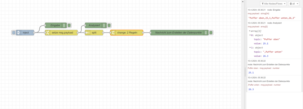

            @maximinus Das ist kein Problem - da Du das topic frei definieren kannst. Wenn Du weißt, dass Deezimalzahlen immer vorhanden sind, kannst Du ggf. mit RegEx vorher das ganze aufdröseln. Den Bufferparser kannst Du nutzen, wenn die Daten eine fixe Länge haben. Diese Node musst Du einfach nachinstallieren.
            [{"id":"0da106c34cc125cf","type":"inject","z":"289f539dcc33814e","name":"","props":[{"p":"payload"}],"repeat":"","crontab":"","once":false,"onceDelay":0.1,"topic":"","payload":"Puffer oben,25,1,Puffer unten,26,3","payloadType":"str","x":210,"y":6680,"wires":[["5bd61d6bf907ae9f","f623c13912d2afed"]]},{"id":"5bd61d6bf907ae9f","type":"debug","z":"289f539dcc33814e","name":"Eingabe","active":true,"tosidebar":true,"console":false,"tostatus":false,"complete":"payload","targetType":"msg","statusVal":"","statusType":"auto","x":380,"y":6640,"wires":[]},{"id":"f623c13912d2afed","type":"change","z":"289f539dcc33814e","name":"","rules":[{"t":"set","p":"payload","pt":"msg","to":"$match(payload,/(.*?),(\\d+,\\d)/).{\"topic\":groups[0],\"value\":$replace(groups[1],\",\",\".\")~>$number()}","tot":"jsonata"}],"action":"","property":"","from":"","to":"","reg":false,"x":410,"y":6680,"wires":[["bb3195e5f26bd2fb","5245e98ae72f6c6e"]]},{"id":"bb3195e5f26bd2fb","type":"debug","z":"289f539dcc33814e","name":"Analysiert","active":true,"tosidebar":true,"console":false,"tostatus":false,"complete":"payload","targetType":"msg","statusVal":"","statusType":"auto","x":600,"y":6640,"wires":[]},{"id":"5245e98ae72f6c6e","type":"split","z":"289f539dcc33814e","name":"","splt":"\\n","spltType":"str","arraySplt":1,"arraySpltType":"len","stream":false,"addname":"","x":590,"y":6680,"wires":[["8ef7b1db51dec044"]]},{"id":"8ef7b1db51dec044","type":"change","z":"289f539dcc33814e","name":"","rules":[{"t":"set","p":"topic","pt":"msg","to":"payload.topic","tot":"msg"},{"t":"set","p":"payload","pt":"msg","to":"payload.value","tot":"msg"}],"action":"","property":"","from":"","to":"","reg":false,"x":770,"y":6680,"wires":[["f30327f180ac5604"]]},{"id":"f30327f180ac5604","type":"debug","z":"289f539dcc33814e","name":"Nachricht zum Erstellen der Datenpunkte","active":true,"tosidebar":true,"console":false,"tostatus":false,"complete":"payload","targetType":"msg","statusVal":"","statusType":"auto","x":1060,"y":6680,"wires":[]}]

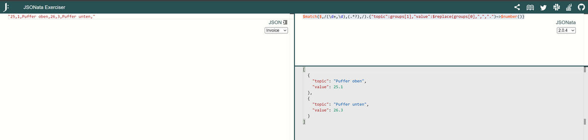

              Trotz Suche finde ich nicht die Bedeutung der nachstehenden Zeichen mit denen das ganze bewerkstelligt wird.
              $match(payload,/(.*?),(\d+,\d)/).{"topic":groups[0],"value":$replace(groups[1],",",".")~>$number()}
              Hast du da einen link auf eine Erkärung?

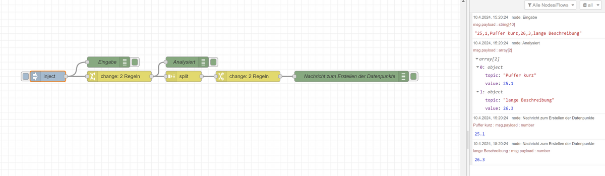

                Hier der Flow:

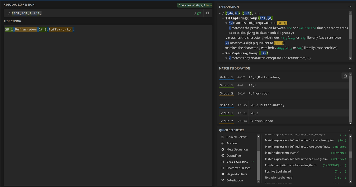

                [{"id":"0da106c34cc125cf","type":"inject","z":"289f539dcc33814e","name":"","props":[{"p":"payload"}],"repeat":"","crontab":"","once":false,"onceDelay":0.1,"topic":"","payload":"25,1,Puffer kurz,26,3,lange Beschreibung","payloadType":"str","x":170,"y":6820,"wires":[["5bd61d6bf907ae9f","f623c13912d2afed"]]},{"id":"5bd61d6bf907ae9f","type":"debug","z":"289f539dcc33814e","name":"Eingabe","active":true,"tosidebar":true,"console":false,"tostatus":false,"complete":"payload","targetType":"msg","statusVal":"","statusType":"auto","x":340,"y":6780,"wires":[]},{"id":"f623c13912d2afed","type":"change","z":"289f539dcc33814e","name":"","rules":[{"t":"set","p":"payload","pt":"msg","to":"payload & \",\"","tot":"jsonata"},{"t":"set","p":"payload","pt":"msg","to":"$match(payload,/(\\d+,\\d),(.*?),/).{\"topic\":groups[1],\"value\":$replace(groups[0],\",\",\".\")~>$number()}","tot":"jsonata"}],"action":"","property":"","from":"","to":"","reg":false,"x":370,"y":6820,"wires":[["bb3195e5f26bd2fb","5245e98ae72f6c6e"]]},{"id":"bb3195e5f26bd2fb","type":"debug","z":"289f539dcc33814e","name":"Analysiert","active":true,"tosidebar":true,"console":false,"tostatus":false,"complete":"payload","targetType":"msg","statusVal":"","statusType":"auto","x":560,"y":6780,"wires":[]},{"id":"5245e98ae72f6c6e","type":"split","z":"289f539dcc33814e","name":"","splt":"\\n","spltType":"str","arraySplt":1,"arraySpltType":"len","stream":false,"addname":"","x":550,"y":6820,"wires":[["8ef7b1db51dec044"]]},{"id":"8ef7b1db51dec044","type":"change","z":"289f539dcc33814e","name":"","rules":[{"t":"set","p":"topic","pt":"msg","to":"payload.topic","tot":"msg"},{"t":"set","p":"payload","pt":"msg","to":"payload.value","tot":"msg"}],"action":"","property":"","from":"","to":"","reg":false,"x":730,"y":6820,"wires":[["f30327f180ac5604"]]},{"id":"f30327f180ac5604","type":"debug","z":"289f539dcc33814e","name":"Nachricht zum Erstellen der Datenpunkte","active":true,"tosidebar":true,"console":false,"tostatus":false,"complete":"payload","targetType":"msg","statusVal":"","statusType":"auto","x":1020,"y":6820,"wires":[]}]
                Hier der reguläre Ausdruck zum Testen und spielen - Du musst schauen, dass jeder Match in die richtigen Gruppen kommt (die Beschreibung der regulären Ausdrücke und die Erklärung findest Du rechts oben bzw. unten):
                Hier der Link zum Testen der regulären Ausdrücke: https://regex101.com/r/2LMTDt/1
                Hier der entsprechende JSONATA Code:
                und ebenfalls der Link zum Testen: https://try.jsonata.org/7M9gehmLH
                  maximinus @mickym last edited by
                  @mickym
                  Vorerst vielen Dank. Ich muss das jetzt alles studieren und melde mich später
                    @mickym
                    Das hat jetzt etwas länger gedauert. Nachdem ich den Flow importiert und den inject durch UDP in ersetzt, sowie einen ioBroker out angefügt hatte sah ich im debug dass die Bearbeitung des payloads korrekt war - bis auf das führende blank und das dahinterliegende Komma - aber es kam auch die alte Fehlermeldung über das fehlende topic des ioBroker out. Ich habe dann versucht etwas zu ändern. Das ließ sich nicht mehr deployen. Da kommt immer die Meldung keine Antwort vom Server. In der Annahme dass die als Demo importierten Flows damit etwas zu tun haben, habe ich die alle gelöscht um von vorne zu beginnen. Jetzt sind alle weg. Wenn ich deinen Flow jetzt importiere ohne etwas daran zu ändern lässt er sich auch nicht mehr deployen. Ein kleiner selbst erstellter aus inject und debug aber schon. Den Adapter habe ich neu gestartet und den Import nochmals versucht, aber es geht nicht mehr.
                    Ich habe hier noch eine andere iobroker Installation. Auf der klappt das deplay. Soll ich den Adapter auf dem RasPi auf dem das laufen soll neu installieren? Könnte das helfen?
                    Ein große Bitte hätte ich noch. Könntest du deinen Flow um den ioBroker Out ergänzen so dass die Objekte mit Bezeichnung und Wert angelegt werden. Ich schaffe das nicht.
                    LG Gerhard

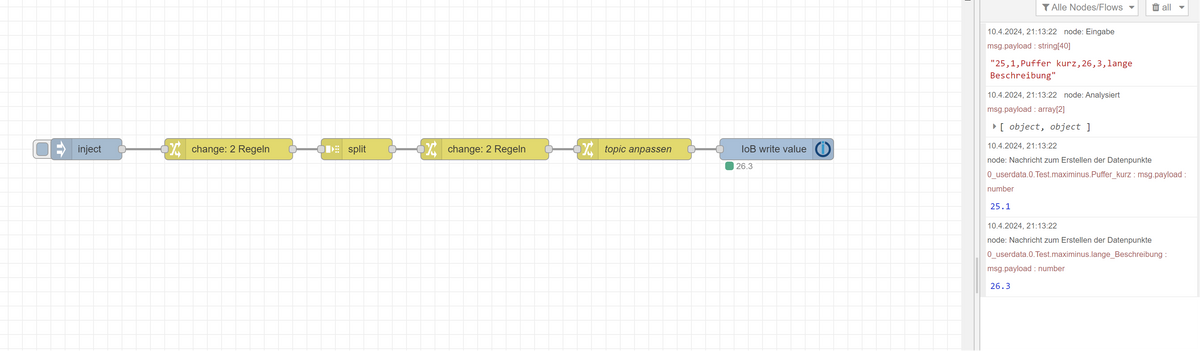

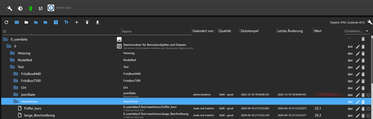

                    • mickym
                      mickym Most Active last edited by mickym
                      Na man sollte keine Leerzeichen in Datenpunktnamen haben - ich hab sie mal durch Unterstriche ersetzt.
                      [{"id":"0da106c34cc125cf","type":"inject","z":"289f539dcc33814e","name":"","props":[{"p":"payload"}],"repeat":"","crontab":"","once":false,"onceDelay":0.1,"topic":"","payload":"25,1,Puffer kurz,26,3,lange Beschreibung","payloadType":"str","x":170,"y":6820,"wires":[["f623c13912d2afed"]]},{"id":"f623c13912d2afed","type":"change","z":"289f539dcc33814e","name":"","rules":[{"t":"set","p":"payload","pt":"msg","to":"payload & \",\"","tot":"jsonata"},{"t":"set","p":"payload","pt":"msg","to":"$match(payload,/(\\d+,\\d),(.*?),/).{\"topic\":groups[1],\"value\":$replace(groups[0],\",\",\".\")~>$number()}","tot":"jsonata"}],"action":"","property":"","from":"","to":"","reg":false,"x":370,"y":6820,"wires":[["5245e98ae72f6c6e"]]},{"id":"5245e98ae72f6c6e","type":"split","z":"289f539dcc33814e","name":"","splt":"\\n","spltType":"str","arraySplt":1,"arraySpltType":"len","stream":false,"addname":"","x":550,"y":6820,"wires":[["8ef7b1db51dec044"]]},{"id":"8ef7b1db51dec044","type":"change","z":"289f539dcc33814e","name":"","rules":[{"t":"set","p":"topic","pt":"msg","to":"payload.topic","tot":"msg"},{"t":"set","p":"payload","pt":"msg","to":"payload.value","tot":"msg"}],"action":"","property":"","from":"","to":"","reg":false,"x":730,"y":6820,"wires":[["effa0a9ed1b6a8b0"]]},{"id":"effa0a9ed1b6a8b0","type":"change","z":"289f539dcc33814e","name":"topic anpassen","rules":[{"t":"change","p":"topic","pt":"msg","from":" ","fromt":"str","to":"_","tot":"str"},{"t":"set","p":"topic","pt":"msg","to":"\"0_userdata.0.Test.maximinus.\" & topic","tot":"jsonata"}],"action":"","property":"","from":"","to":"","reg":false,"x":940,"y":6820,"wires":[["e7c12bf23dcb8d44"]]},{"id":"e7c12bf23dcb8d44","type":"ioBroker out","z":"289f539dcc33814e","name":"","topic":"","ack":"true","autoCreate":"true","stateName":"","role":"","payloadType":"","readonly":"false","stateUnit":"","stateMin":"","stateMax":"","x":1140,"y":6820,"wires":[]}]
                      Es geht aber auch mit Leerzeichen - hast dann halt vielleicht später Probleme aber Du kannst die Regel mit dem Ersetzen der Leerzeichen auch rausschmeissen.
                        maximinus @mickym last edited by maximinus

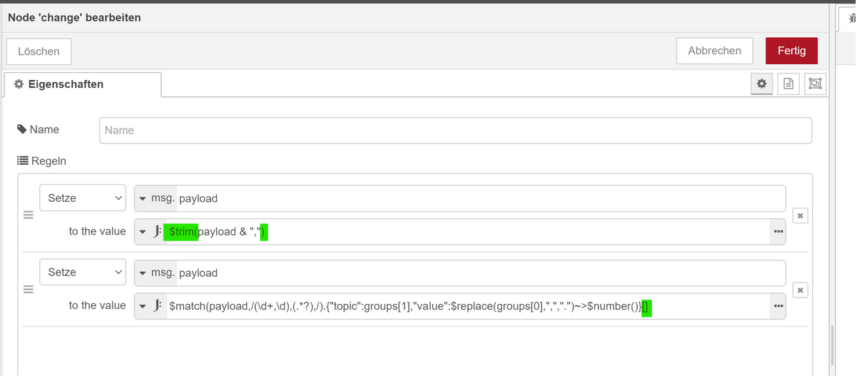

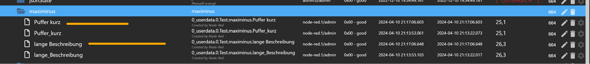

                        • mickym
                          mickym Most Active @maximinus last edited by mickym
                          @maximinus Hier die Lösung - um auch einzelne Datenpunkte zu schreiben.
                          Oben setzt Du den String in eine trim Funktion - damit Zeilenvorschübe und führende Leerzeichen zu entfernen.
                          Und ob auch einzelne Werte zu schreiben, einfach in der 2. Regel ein paar eckige Klammern hinten dran machen.
                          Ja das Fremdobjekte erstellt werden dürfen in der Instanzeinstellung habe ich vorausgesetzt.
                          Hier der Import:
                          [{"id":"0da106c34cc125cf","type":"inject","z":"289f539dcc33814e","name":"","props":[{"p":"payload"}],"repeat":"","crontab":"","once":false,"onceDelay":0.1,"topic":"","payload":"25,1,Puffer kurz,25,2,Puffer lang","payloadType":"str","x":130,"y":7140,"wires":[["f623c13912d2afed"]]},{"id":"f623c13912d2afed","type":"change","z":"289f539dcc33814e","name":"","rules":[{"t":"set","p":"payload","pt":"msg","to":"$trim(payload & \",\")","tot":"jsonata"},{"t":"set","p":"payload","pt":"msg","to":"$match(payload,/(\\d+,\\d),(.*?),/).{\"topic\":groups[1],\"value\":$replace(groups[0],\",\",\".\")~>$number()}[]","tot":"jsonata"}],"action":"","property":"","from":"","to":"","reg":false,"x":370,"y":7140,"wires":[["5245e98ae72f6c6e"]]},{"id":"5245e98ae72f6c6e","type":"split","z":"289f539dcc33814e","name":"","splt":"\\n","spltType":"str","arraySplt":1,"arraySpltType":"len","stream":false,"addname":"","x":550,"y":7140,"wires":[["8ef7b1db51dec044"]]},{"id":"8ef7b1db51dec044","type":"change","z":"289f539dcc33814e","name":"","rules":[{"t":"set","p":"topic","pt":"msg","to":"payload.topic","tot":"msg"},{"t":"set","p":"payload","pt":"msg","to":"payload.value","tot":"msg"}],"action":"","property":"","from":"","to":"","reg":false,"x":730,"y":7140,"wires":[["effa0a9ed1b6a8b0"]]},{"id":"effa0a9ed1b6a8b0","type":"change","z":"289f539dcc33814e","name":"topic anpassen","rules":[{"t":"change","p":"topic","pt":"msg","from":" ","fromt":"str","to":"_","tot":"str"},{"t":"set","p":"topic","pt":"msg","to":"\"0_userdata.0.Test.maximinus.\" & topic","tot":"jsonata"}],"action":"","property":"","from":"","to":"","reg":false,"x":940,"y":7140,"wires":[["e7c12bf23dcb8d44"]]},{"id":"e7c12bf23dcb8d44","type":"ioBroker out","z":"289f539dcc33814e","name":"","topic":"","ack":"true","autoCreate":"true","stateName":"","role":"","payloadType":"","readonly":"false","stateUnit":"","stateMin":"","stateMax":"","x":1140,"y":7140,"wires":[]}]
