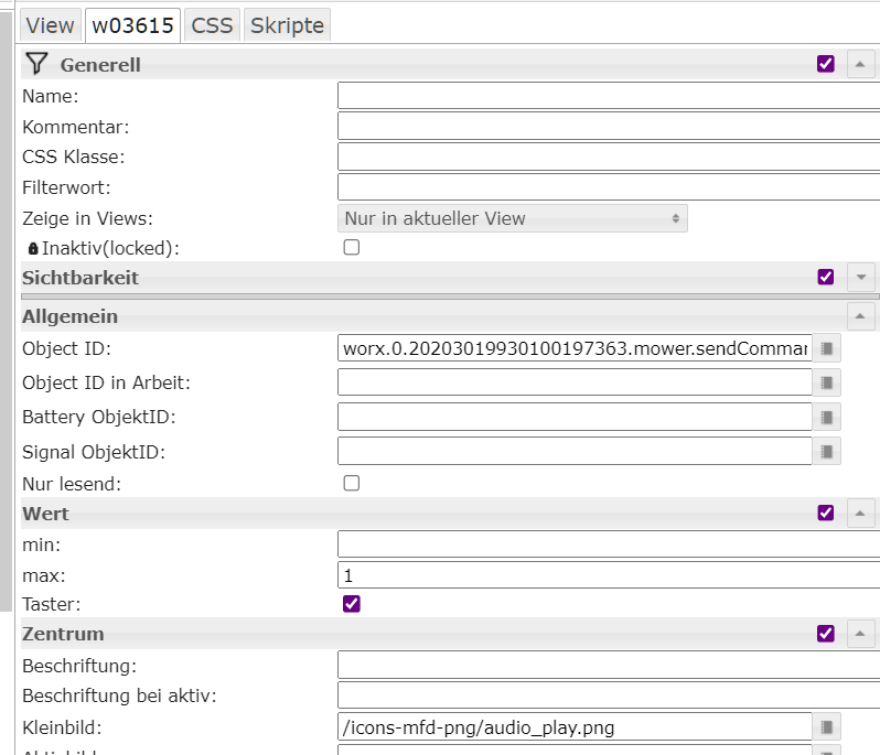

                                    Habe es gefunden. Und zwar war es wieder der "Mouse-Over" Effekt bei hqwidgets on/off.
                                    Das Widget is wie folgt definiert:
                                    Wenn ich mit der Mouse nur drüberfahre kommt folgendes:
                                    2025-08-14 07:39:39.785  - info: web.0 (3122) State value to set for "worx.0.20203019930100197363.mower.sendCommand" has to be type "number" but received type "boolean"
                                    2025-08-14 07:39:39.789  - info: worx.0 (1019813) Request Counter: 2
                                    2025-08-14 07:39:40.943  - info: web.0 (3122) State value to set for "worx.0.20203019930100197363.mower.sendCommand" has to be type "number" but received type "boolean"
                                    2025-08-14 07:39:41.222  - info: worx.0 (1019813) Request Counter: 3
                                    2025-08-14 07:39:42.268  - info: web.0 (3122) State value to set for "worx.0.20203019930100197363.mower.sendCommand" has to be type "number" but received type "boolean"
                                    2025-08-14 07:39:42.308  - info: worx.0 (1019813) Request Counter: 4
                                    2025-08-14 07:39:43.237  - info: web.0 (3122) State value to set for "worx.0.20203019930100197363.mower.sendCommand" has to be type "number" but received type "boolean"
                                    2025-08-14 07:39:43.245  - info: worx.0 (1019813) Min Time between requests is 1000ms. The time between commands was 938 ms. Request worx.0.20203019930100197363.mower.sendCommand with value false was not sended
                                    2025-08-14 07:39:43.568  - info: web.0 (3122) State value to set for "worx.0.20203019930100197363.mower.sendCommand" has to be type "number" but received type "boolean"
                                    2025-08-14 07:39:43.578  - info: worx.0 (1019813) Request Counter: 5
                                    2025-08-14 07:39:44.483  - info: smartmeter.0 (2880) Received 10 values, 3 updated
                                    2025-08-14 07:39:44.497  - info: mqtt.2 (2752) send2Server mqtt.2.openWB.set.counter.11.get.power[openWB/set/counter/11/get/power]
                                    2025-08-14 07:39:44.499  - info: mqtt.2 (2752) send2Server mqtt.2.openWB.set.counter.11.get.exported[openWB/set/counter/11/get/exported]
                                    2025-08-14 07:39:44.555  - info: web.0 (3122) State value to set for "worx.0.20203019930100197363.mower.sendCommand" has to be type "number" but received type "boolean"
                                    2025-08-14 07:39:44.567  - info: worx.0 (1019813) Min Time between requests is 1000ms. The time between commands was 990 ms. Request worx.0.20203019930100197363.mower.sendCommand with value false was not sended
                                    2025-08-14 07:39:45.120  - info: web.0 (3122) State value to set for "worx.0.20203019930100197363.mower.sendCommand" has to be type "number" but received type "boolean"
                                    2025-08-14 07:39:45.125  - info: worx.0 (1019813) Request Counter: 6
                                    2025-08-14 07:39:46.120  - info: web.0 (3122) State value to set for "worx.0.20203019930100197363.mower.sendCommand" has to be type "number" but received type "boolean"
                                    2025-08-14 07:39:46.124  - info: worx.0 (1019813) Min Time between requests is 1000ms. The time between commands was 999 ms. Request worx.0.20203019930100197363.mower.sendCommand with value false was not sended
                                    Das hqwidget on/off ist wohl eigentlich nur für boolean gedacht, übergibt aber trotzdem eine Zahl beim Auslösen, denn generell funktioniert es.
                                      Homoran Global Moderator Administrators @hg6806 last edited by Homoran
                                      @hg6806 sagte in Adapter Worx Landroid v3.x.x:
                                      im Sinne von 0=false / 1=true!
                                      Das ist keine Zahl!
                                      steht auch genauso im log
                                      Der Datenpunkt ist vom typ Zahl, bekommt eine Wert Bool:
                                      hg6806 1 Reply Last reply Reply Quote 0
                                      • hg6806
                                        hg6806 Most Active @Homoran last edited by
                                        Genau - aber wie schon geschrieben, wird bei Tastendruck trotzdem eine Zahl übergeben, denn es funktioniert ja, bis auf dieses Mouseover und eben der Fehler im Log.
                                        Jetzt die Frage - auch wenn es off-topic ist - welchen Button nimmt man um eine Zahl zu übergeben?
                                          NEIN!
                                          es wird ein Bool übergeben, der noch akzeptiert und als Zahl interpretiert wird.
