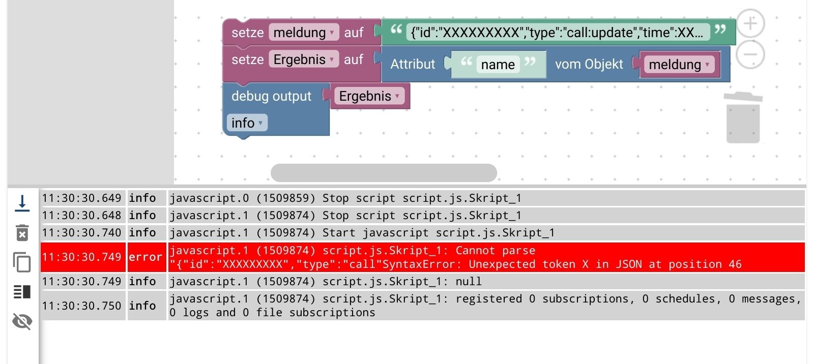

        @darkdevil mit dem Baustein "Atrribut von..." name bzw. status

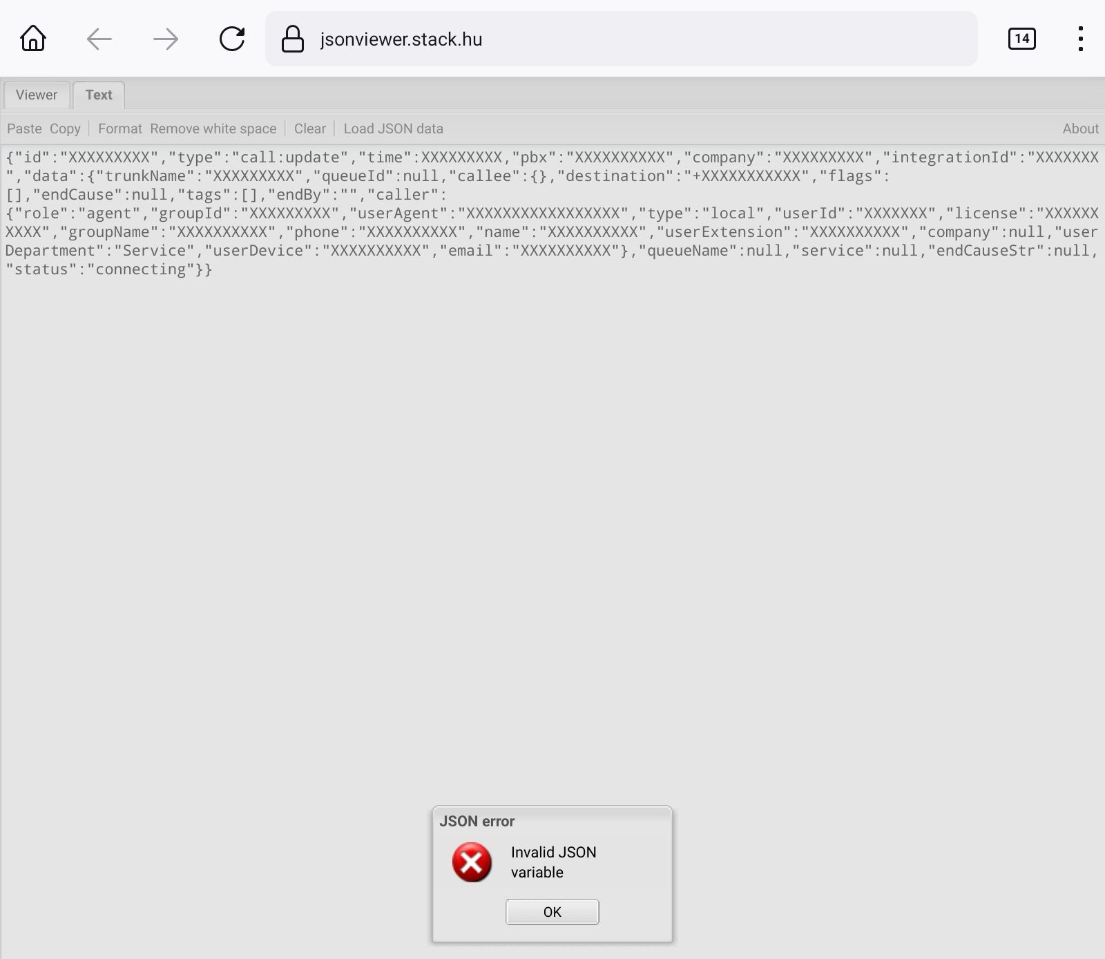

        allerdings scheint das JSON defekt zu sein.

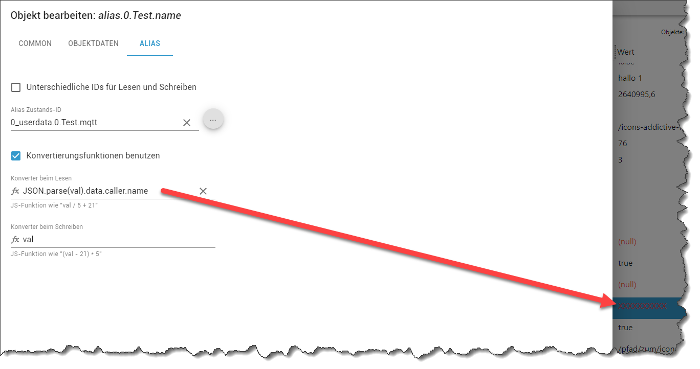

          Codierknecht Developer Most Active @DarkDevil last edited by
          @darkdevil
          Alternativ mit einem Alias und der passenden Konvertierung
          JSON.parse(val).data.caller.name
          JSON.parse(val).data.status

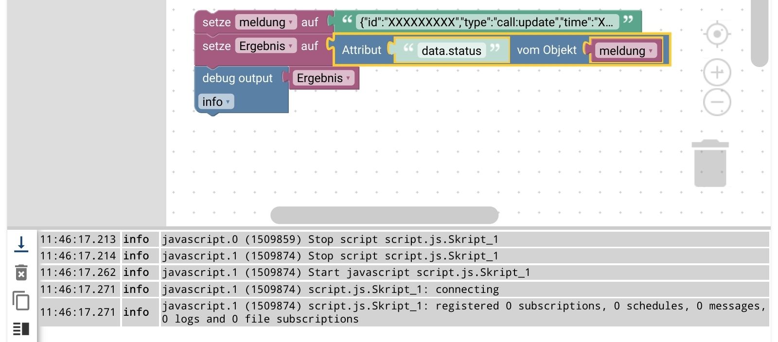

            Homoran Global Moderator Administrators @DarkDevil last edited by Homoran

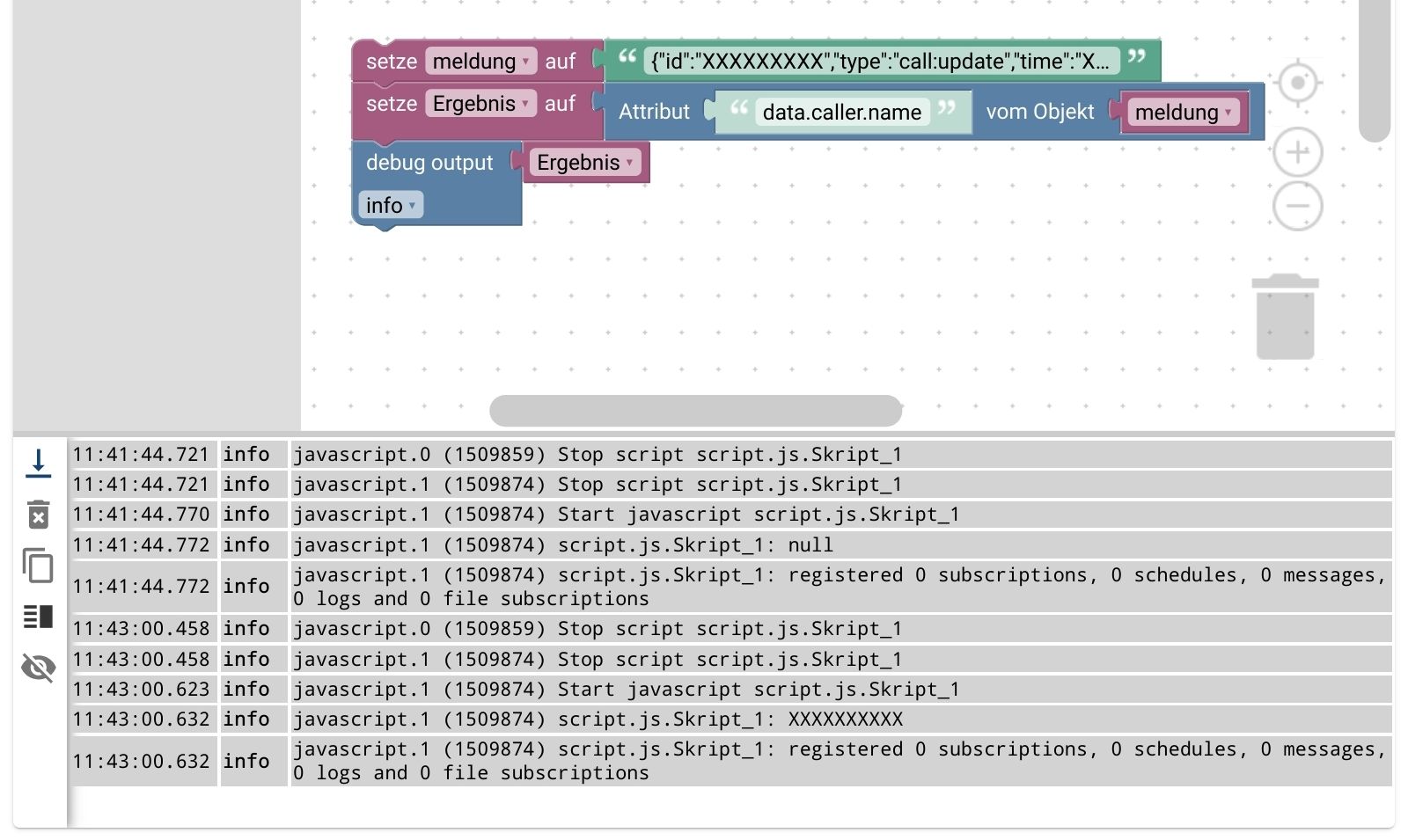

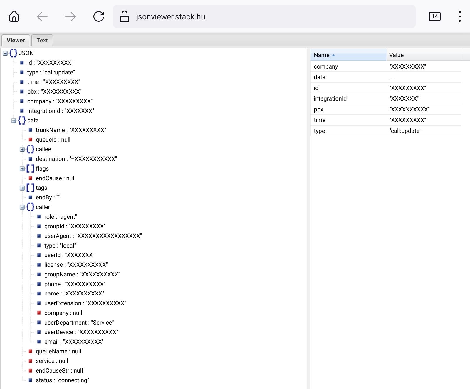

            @darkdevil Nach Korrektur des jsons (du hast beim Xen auch 2 " gelöscht!
            {"id":"XXXXXXXXX","type":"call:update","time":"XXXXXXXXX","pbx":"XXXXXXXXXX","company":"XXXXXXXXX","integrationId":"XXXXXXX","data":{"trunkName":"XXXXXXXXX","queueId":null,"callee":{},"destination":"+XXXXXXXXXXX","flags":[],"endCause":null,"tags":[],"endBy":"","caller":{"role":"agent","groupId":"XXXXXXXXX","userAgent":"XXXXXXXXXXXXXXXXX","type":"local","userId":"XXXXXXX","license":"XXXXXXXXXX","groupName":"XXXXXXXXXX","phone":"XXXXXXXXXX","name":"XXXXXXXXXX","userExtension":"XXXXXXXXXX","company":null,"userDepartment":"Service","userDevice":"XXXXXXXXXX","email":"XXXXXXXXXX"},"queueName":null,"service":null,"endCauseStr":null,"status":"connecting"}}
            klappt das auch
            dann muss es heissen
            und für den Status
                @darkdevil
                Hier die Alternative über einen Alias. Da spart man sich das Script.
