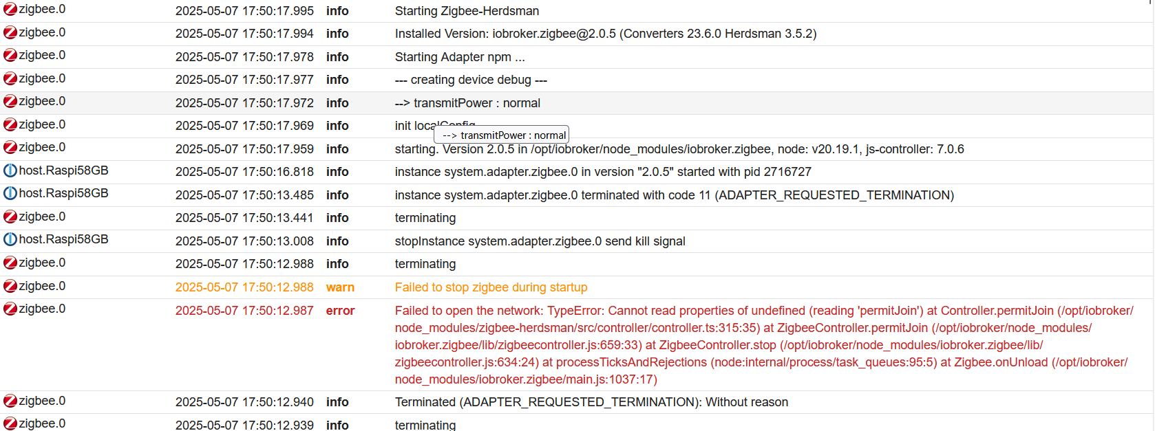

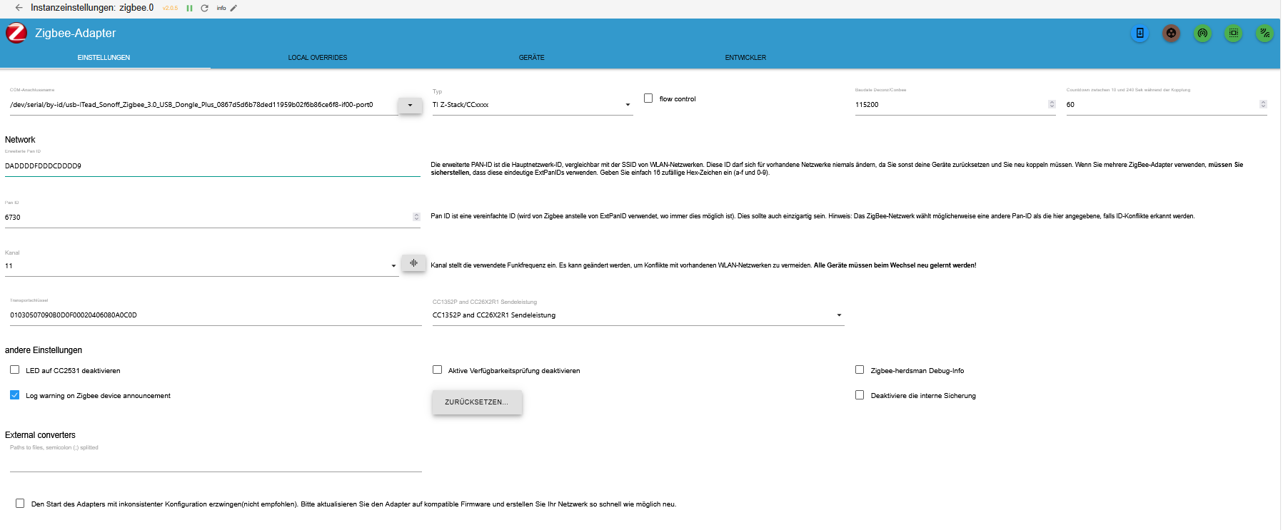

      Ok, das habe ich missverstanden!
      Der Koordinator ist im Raspi 5 und der Zigbee Adapter installiert.
      Hier das Protokoll:
      und hier das iob diag:

      2025-05-07 17:50:12.936  - info: zigbee.0 (2716711) cleaned everything up...
      2025-05-07 17:50:12.937  - info: zigbee.0 (2716711) local config saved
      2025-05-07 17:50:12.938  - info: zigbee.0 (2716711) Saved local configuration data
      2025-05-07 17:50:12.939  - info: zigbee.0 (2716711) terminating
      2025-05-07 17:50:12.940  - info: zigbee.0 (2716711) Terminated (ADAPTER_REQUESTED_TERMINATION): Without reason
      2025-05-07 17:50:12.987  - error: zigbee.0 (2716711) Failed to open the network: TypeError: Cannot read properties of undefined (reading 'permitJoin')
          at Controller.permitJoin (/opt/iobroker/node_modules/zigbee-herdsman/src/controller/controller.ts:315:35)
          at ZigbeeController.permitJoin (/opt/iobroker/node_modules/iobroker.zigbee/lib/zigbeecontroller.js:659:33)
          at ZigbeeController.stop (/opt/iobroker/node_modules/iobroker.zigbee/lib/zigbeecontroller.js:634:24)
          at processTicksAndRejections (node:internal/process/task_queues:95:5)
          at Zigbee.onUnload (/opt/iobroker/node_modules/iobroker.zigbee/main.js:1037:17)
      2025-05-07 17:50:12.988  - warn: zigbee.0 (2716711) Failed to stop zigbee during startup
      2025-05-07 17:50:12.988  - info: zigbee.0 (2716711) terminating
      2025-05-07 17:50:13.008  - info: host.Raspi58GB stopInstance system.adapter.zigbee.0 send kill signal
      2025-05-07 17:50:13.441  - info: zigbee.0 (2716711) terminating
      2025-05-07 17:50:13.485  - info: host.Raspi58GB instance system.adapter.zigbee.0 terminated with code 11 (ADAPTER_REQUESTED_TERMINATION)
      2025-05-07 17:50:16.818  - info: host.Raspi58GB instance system.adapter.zigbee.0 in version "2.0.5" started with pid 2716727
      2025-05-07 17:50:17.959  - info: zigbee.0 (2716727) starting. Version 2.0.5 in /opt/iobroker/node_modules/iobroker.zigbee, node: v20.19.1, js-controller: 7.0.6
      2025-05-07 17:50:17.969  - info: zigbee.0 (2716727) init localConfig
      2025-05-07 17:50:17.972  - info: zigbee.0 (2716727)   --> transmitPower : normal
      2025-05-07 17:50:17.977  - info: zigbee.0 (2716727) --- creating device debug ---
      2025-05-07 17:50:17.978  - info: zigbee.0 (2716727) Starting Adapter npm ...
      2025-05-07 17:50:17.994  - info: zigbee.0 (2716727) Installed Version: iobroker.zigbee@2.0.5 (Converters 23.6.0 Herdsman 3.5.2)
      2025-05-07 17:50:17.995  - info: zigbee.0 (2716727) Starting Zigbee-Herdsman
      2025-05-07 17:53:36.342  - info: smartmeter.0 (2716443) Received 13 values, 6 updated
        Homoran Global Moderator Administrators @searcher57 last edited by
        @searcher57 sagte in FritzBox Zigbee Antenne in ioBroker einbinden?:
        Hier das Protokoll:
        bitte keinen Screenshot!
        als Text in code-tags posten.
          searcher57 @Homoran last edited by
          @homoran said in FritzBox Zigbee Antenne in ioBroker einbinden?:
          Hier das Protokoll:
          Bitte erkläre das!
          Homoran S 2 Replies Last reply Reply Quote 0
            Bitte erkläre das!
            Jetzt bin ich überfordert, was genau bedarf zusätzlicher Erklärung?

              zigbee.0
              	2025-05-07 17:48:45.452	info	Starting Zigbee-Herdsman
              zigbee.0
              	2025-05-07 17:48:45.451	info	Installed Version: iobroker.zigbee@2.0.5 (Converters 23.6.0 Herdsman 3.5.2)
              zigbee.0
              	2025-05-07 17:48:45.436	info	Starting Adapter npm ...
              zigbee.0
              	2025-05-07 17:48:45.435	info	--- creating device debug ---
              zigbee.0
              	2025-05-07 17:48:45.430	info	--> transmitPower : normal
              zigbee.0
              	2025-05-07 17:48:45.427	info	init localConfig
              zigbee.0
              	2025-05-07 17:48:45.418	info	starting. Version 2.0.5 in /opt/iobroker/node_modules/iobroker.zigbee, node: v20.19.1, js-controller: 7.0.6
              host.Raspi58GB
              	2025-05-07 17:48:44.243	info	instance system.adapter.zigbee.0 in version "2.0.5" started with pid 2716503

                @searcher57 Dein Log zeigt das du den Adapter angehalten hast bevor das Zigbee-Subsystem vollständig gestartet war. Besagter Start kann insbesondere bei einem ersten Start mit 'neuer' Konifiguration bis zu 5 Minuten dauern.
                Bitte folgendes machen:
                • Zigbee Adapter anhalten.
                • 60 s Warten
                • Log löschen
                • Zigbee Adapter starten
                • Umschalten auf die Log-Ansicht
                • Abwarten bis einer von 2 Events eintritt:
                  -- Fehlermeldung das der Adapter nicht gestartet werden kann
                  -- Meldung das der Adapter erfolgreich gestartet wurde.
                Besagte Meldungen dann hier posten.
                A.

                  Ich hoffe, dass ich nicht wieder zu ungeduldig war!

                    Asgothian Developer @searcher57 last edited by
                    @searcher57 Im Log steht nichts drin. Bitte mal die Einstellungen des Zigbee Adapters zeigen.
                    Anscheinend wird versucht den Herdsman zu starten, aber der kommt nicht zurück.
                    A.

                      Zigbee-Adapter
                          Einstellungen
                          Local Overrides
                          Geräte
                          Entwickler
                      COM-Anschlussname
                      arrow_drop_down
                      Typ
                      Baudate Deconz/Conbee
                      Countdown zwischen 10 und 240 Sek während der Kopplung
                      Network
                      Erweiterte Pan ID
                      Die erweiterte PAN-ID ist die Hauptnetzwerk-ID, vergleichbar mit der SSID von WLAN-Netzwerken. Diese ID darf sich für vorhandene Netzwerke niemals ändern, da Sie sonst deine Geräte zurücksetzen und Sie neu koppeln müssen. Wenn Sie mehrere ZigBee-Adapter verwenden, müssen Sie sicherstellen, dass diese eindeutige ExtPanIDs verwenden. Geben Sie einfach 16 zufällige Hex-Zeichen ein (a-f und 0-9).
                      Pan ID
                      Pan ID ist eine vereinfachte ID (wird von Zigbee anstelle von ExtPanID verwendet, wo immer dies möglich ist). Dies sollte auch einzigartig sein. Hinweis: Das ZigBee-Netzwerk wählt möglicherweise eine andere Pan-ID als die hier angegebene, falls ID-Konflikte erkannt werden.
                      Kanal
                      graphic_eq
                      Kanal stellt die verwendete Funkfrequenz ein. Es kann geändert werden, um Konflikte mit vorhandenen WLAN-Netzwerken zu vermeiden. Alle Geräte müssen beim Wechsel neu gelernt werden!
                      Transportschlüssel
                      CC1352P and CC26X2R1 Sendeleistung
                      andere Einstellungen
                      External converters
                      Paths to files, semicolon (;) splitted
                      save
                      Speichern
                      save
                      close
                      Speichern und schließen
                      close
                      Schließen
                        searcher57 @Asgothian last edited by
