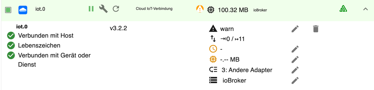

      Ich nutze die aktuelle Version des iot Adapters 3.2.2 und habe eine aktive ioBroker Pro Lizenz
      seit drei Tagen erhalte ich alle 6 Stunden, so ungefähr auf die Minute genau, folgende Fehlermeldung im Log angezeigt:
      56
      Log-Größe: 42.7 KB
      Zeit
      warn
      Nachricht
      host.ioBroker
      2024-05-29 23:37:56.402	error	Caught by controller[0]: at TLSSocket.emit (node:events:529:35)
      host.ioBroker
      2024-05-29 23:37:56.402	error	Caught by controller[0]: at TLSSocket.<anonymous> (/opt/iobroker/node_modules/aws-iot-device-sdk/node_modules/mqtt/lib/client.js:360:10)
      host.ioBroker
      2024-05-29 23:37:56.402	error	Caught by controller[0]: at MqttClient.emit (node:domain:489:12)
      host.ioBroker
      2024-05-29 23:37:56.402	error	Caught by controller[0]: at MqttClient.emit (node:events:529:35)
      host.ioBroker
      2024-05-29 23:37:56.402	error	Caught by controller[0]: at MqttClient.<anonymous> (/opt/iobroker/node_modules/aws-iot-device-sdk/device/index.js:797:12)
      host.ioBroker
      2024-05-29 23:37:56.402	error	Caught by controller[0]: at DeviceClient.emit (node:domain:489:12)
      host.ioBroker
      2024-05-29 23:37:56.402	error	Caught by controller[0]: at DeviceClient.emit (node:events:517:28)
      host.ioBroker
      2024-05-29 23:37:56.402	error	Caught by controller[0]: at DeviceClient.onDisconnect (/opt/iobroker/node_modules/iobroker.iot/main.js:564:22)
      host.ioBroker
      2024-05-29 23:37:56.402	error	Caught by controller[0]: at RemoteAccess.onCloudDisconnect (/opt/iobroker/node_modules/iobroker.iot/lib/remote.js:720:29)
      host.ioBroker
      2024-05-29 23:37:56.402	error	Caught by controller[0]: at Function.keys (<anonymous>)
      host.ioBroker
      2024-05-29 23:37:56.402	error	Caught by controller[0]: TypeError: Cannot convert undefined or null to object
      iot.0
      2024-05-29 23:37:56.139	error	Cannot convert undefined or null to object
      iot.0
      2024-05-29 23:37:56.139	error	TypeError: Cannot convert undefined or null to object at Function.keys (<anonymous>) at RemoteAccess.onCloudDisconnect (/opt/iobroker/node_modules/iobroker.iot/lib/remote.js:720:29) at DeviceClient.onDisconnect (/opt/iobroker/node_modules/iobroker.iot/main.js:564:22) at DeviceClient.emit (node:events:517:28) at DeviceClient.emit (node:domain:489:12) at MqttClient.<anonymous> (/opt/iobroker/node_modules/aws-iot-device-sdk/device/index.js:797:12) at MqttClient.emit (node:events:529:35) at MqttClient.emit (node:domain:489:12) at TLSSocket.<anonymous> (/opt/iobroker/node_modules/aws-iot-device-sdk/node_modules/mqtt/lib/client.js:360:10) at TLSSocket.emit (node:events:529:35)
      iot.0
      2024-05-29 23:37:56.139	error	uncaught exception: Cannot convert undefined or null to object
      Ich habe zum Test den ioT Adapter einfach mal neugestartet und damit lässt sich bei jedem Neustart exakt der Fehler reproduzieren. Auch nach dem Neustart des kompletten ioB dasselbe...
      Daraufhin habe ich versucht die Zertifikate zu erneuern im ioT dapter.
      Nun meldet meine Alexa App auf dem Handy, dass ich mich im iobroker.iot Adapter neu anmelden muss...
      Aber das geht nicht, der Skill behauptet "User does not excist". Habe auch versucht, mich über die Amazon Website anzumelden... gleiche Fehlermeldung
      Adapter sind grün und laufen:
      Hat jemand eine gute Erklärung für mich, wie ich das wieder zum Laufen bekomme?

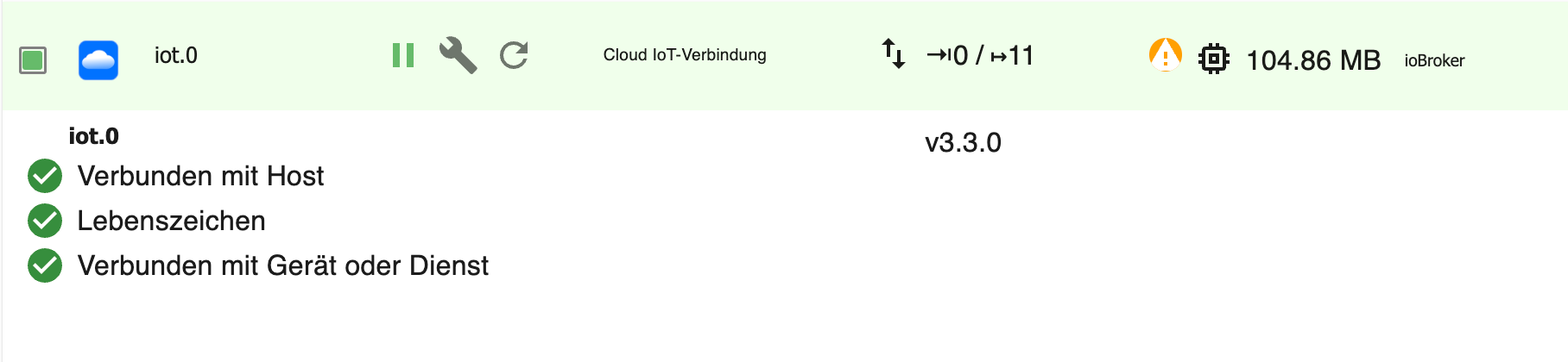

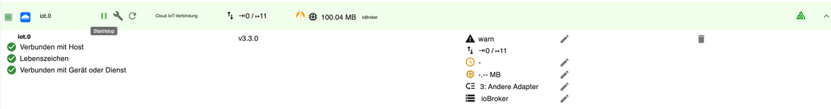

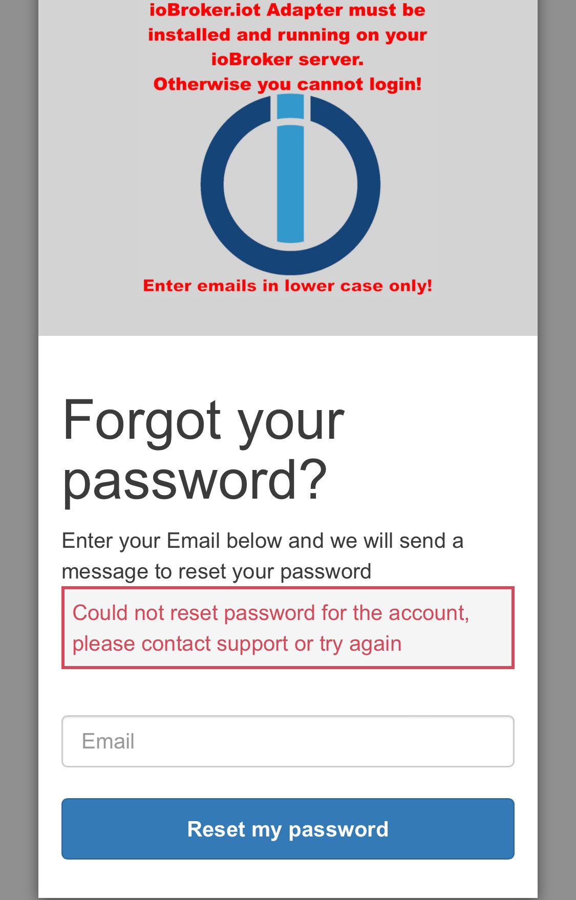

                ich habe die aktuelle Version 3.3.0 installiert, danach den Adapter neu gestartet. Aber Alexa sagt immer noch "User does not exist". Ich komme leider nicht weiter...

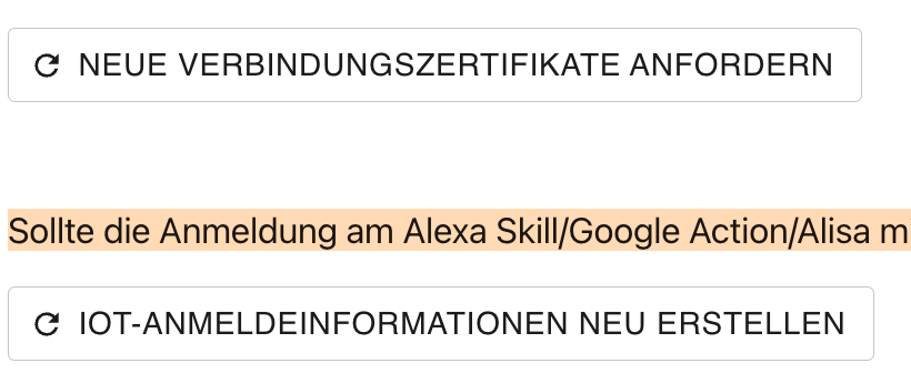

                Danach habe ich die beiden Anmeldeinformationen neu angefordert (nacheinander) und immer den Adapter jeweils neugestartet...
                Auch kann ich bei Alexa bei "Passwort vergessen" kein neues Passwort anfordern...
                Ich bin mir sicher, ich mache etwas verkehrt... aber wie mache ich es richtig??
                Danke Dir
                LEM

                  @lemonbiter Und du gibst die korrekten credentials ein, die von https://iobroker.pro ??! Bitte verifizieren das du dich mit denen dort einloggen kannst UND der iot Adapter läuft und auch dort diese credentials angegeben sind

                    HAT SICH ERLEDIGT.

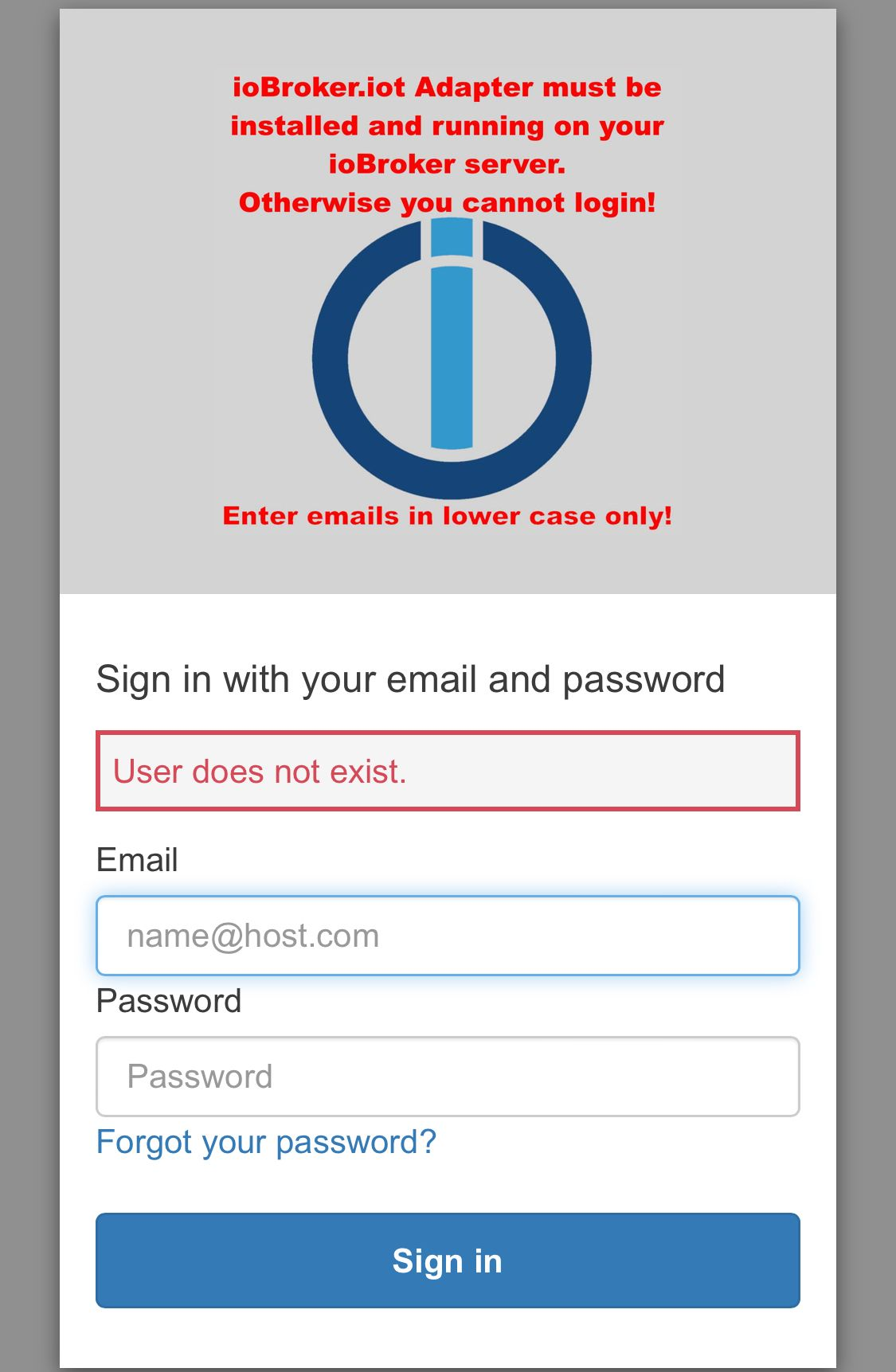

                    .. Habe es gerade noch einmal versucht die Verknüpfung auf dem iPhone wieder herzustellen. Alexa app sagt: "Kann nicht aktiviert werden, Deine App muss aktualisiert werden". ... Habe ich dann gemacht und ZACK... geht. Warum es über die Amazon Website auch nicht ging und warum mir vorher nicht angezeigt wurde, das die App auf dem iPhone aktuailsiert werden muss.. KEINE AHNUNG...
                    DANKE DIR für den super Adapter. Bin so froh, dass er wieder funktioniert!
                    ja, ... meine emailadresse, mit der ich mich bei iobroker.pro anmelde nutze ich, um den skill von iobroker.iot entweder in der alexa app auf meinem iphone oder bei amazon (webaktivierung des Skills) zu nutzen. Beim Versuch den Skill zu aktivieren nutze ich definitiv dieselben credentials, die ich auch für den weblogin bei iobroker.pro verwende.
                    Als Antwort bekomme ich dann

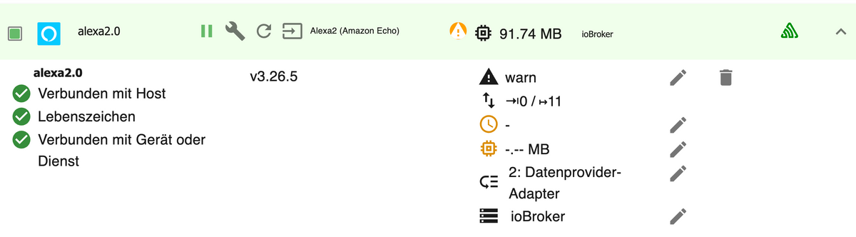

                    und der Adapter läuft:
                    Danke für Deine Unterstützung
