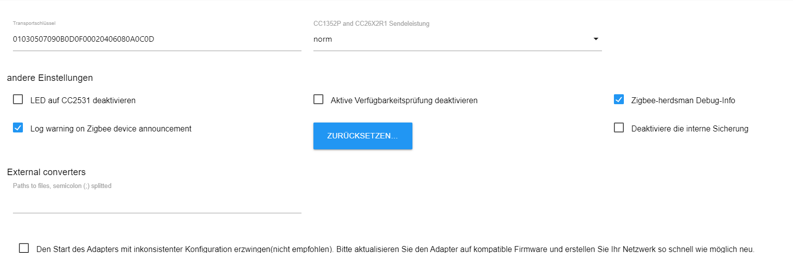

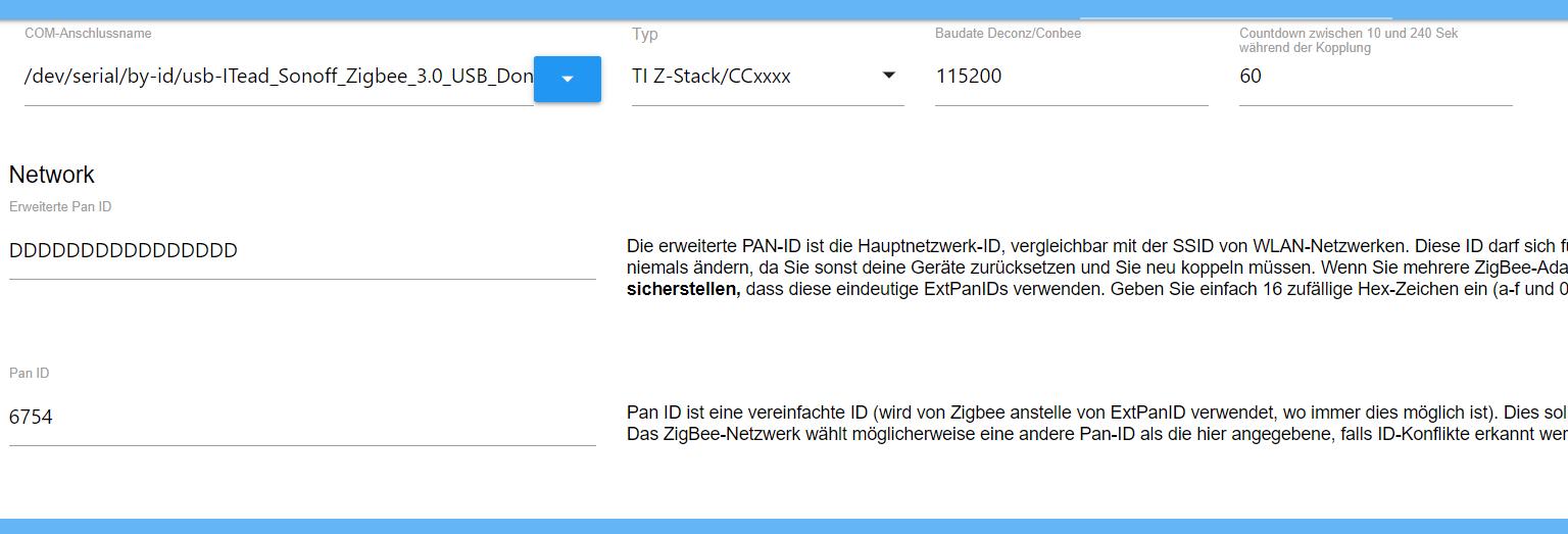

        @jan-lange sagte in Hilfe beim Zigbee Controller mit Sonoff Zigbee 3.0:
        configuration-adapter mismatch
        wie sieht die denn aus

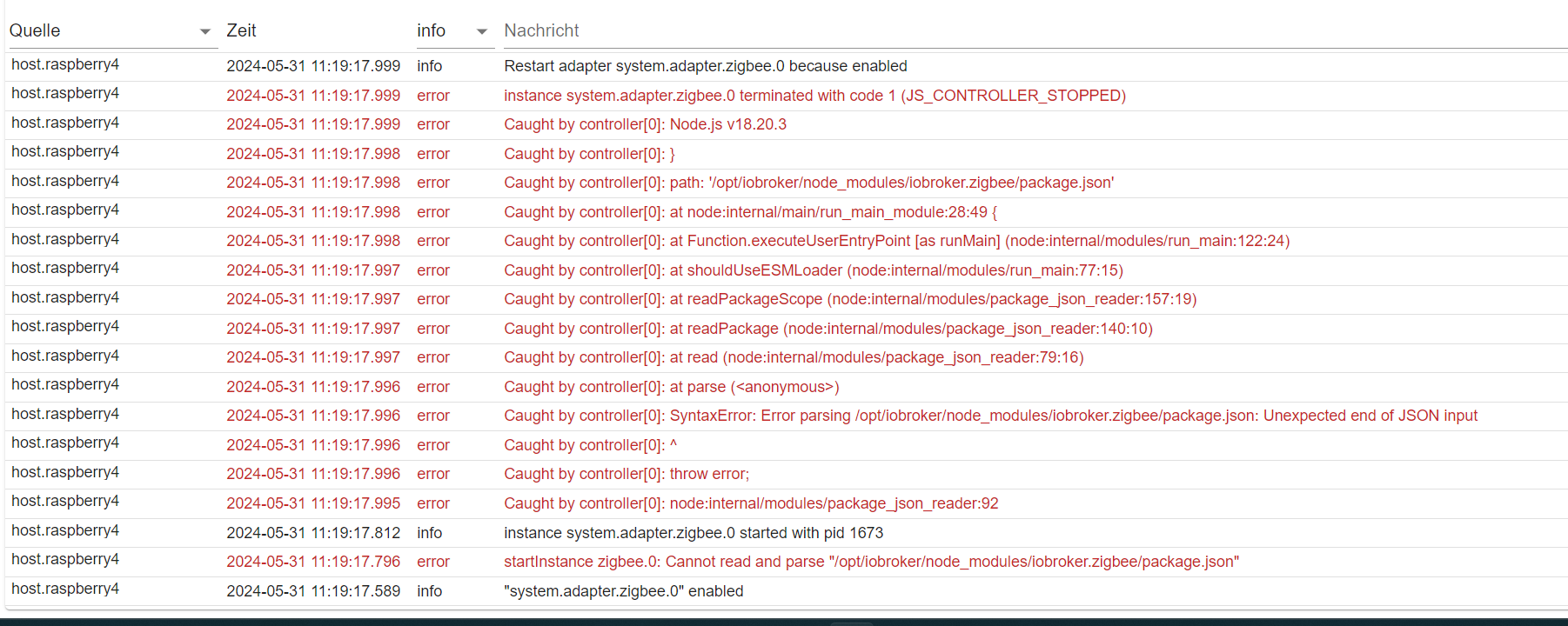

                  2024-05-31 12:41:19.943  - error: host.raspberry4 startInstance zigbee.0: Cannot read and parse "/opt/iobroker/node_modules/iobroker.zigbee/package.json"
                  2024-05-31 12:41:19.960  - info: host.raspberry4 instance system.adapter.zigbee.0 started with pid 5067
                  2024-05-31 12:41:20.120  - error: host.raspberry4 Caught by controller[0]: node:internal/modules/package_json_reader:93
                  2024-05-31 12:41:20.121  - error: host.raspberry4 Caught by controller[0]:         throw error;
                  2024-05-31 12:41:20.121  - error: host.raspberry4 Caught by controller[0]:         ^
                  2024-05-31 12:41:20.121  - error: host.raspberry4 Caught by controller[0]: SyntaxError: Error parsing /opt/iobroker/node_modules/iobroker.zigbee/package.json: Unexpected end of JSON input
                  2024-05-31 12:41:20.121  - error: host.raspberry4 Caught by controller[0]:     at parse (<anonymous>)
                  2024-05-31 12:41:20.121  - error: host.raspberry4 Caught by controller[0]:     at read (node:internal/modules/package_json_reader:80:16)
                  2024-05-31 12:41:20.122  - error: host.raspberry4 Caught by controller[0]:     at readPackage (node:internal/modules/package_json_reader:141:10)
                  2024-05-31 12:41:20.122  - error: host.raspberry4 Caught by controller[0]:     at readPackageScope (node:internal/modules/package_json_reader:164:19)
                  2024-05-31 12:41:20.122  - error: host.raspberry4 Caught by controller[0]:     at shouldUseESMLoader (node:internal/modules/run_main:81:15)
                  2024-05-31 12:41:20.122  - error: host.raspberry4 Caught by controller[0]:     at Function.executeUserEntryPoint [as runMain] (node:internal/modules/run_main:161:24)
                  2024-05-31 12:41:20.122  - error: host.raspberry4 Caught by controller[0]:     at node:internal/main/run_main_module:28:49 {
                  2024-05-31 12:41:20.122  - error: host.raspberry4 Caught by controller[0]:   path: '/opt/iobroker/node_modules/iobroker.zigbee/package.json'
                  2024-05-31 12:41:20.122  - error: host.raspberry4 Caught by controller[0]: }
                  2024-05-31 12:41:20.123  - error: host.raspberry4 Caught by controller[0]: Node.js v20.14.0
                  2024-05-31 12:41:20.123  - error: host.raspberry4 instance system.adapter.zigbee.0 terminated with code 1 (JS_CONTROLLER_STOPPED)
                  2024-05-31 12:41:20.123  - info: host.raspberry4 Restart adapter system.adapter.zigbee.0 because enabled

                    • crunchip
                      Cannot read or parse /opt/iobroker/node_modules/@iobroker/js-controller-common/build/lib/common/../node_modules/iobroker.zigbee/io-package.json: /opt/iobroker/node_modules/iobroker.zigbee/package.json: Unexpected end of JSON input
                      installier den nochmal drüber, falls iob upload all nicht geholfen hat
                        Thomas Braun Most Active @Jan Lange last edited by Thomas Braun
                        Sind wieder mal so grundlegende Dinge falsch.
                        Leg dir einen user an und spring mit dem durch das System. Der user iobroker ist eigentlich als Systemuser vorgesehen.
                        Display-Server: true
                        Im Serverbetrieb falsch. Schalt das aus.
                        Bzw. installier das System von vorneherein ohne Desktop. Dann läuft auch sowas wie cupsd da nicht mit.
                        sudo systemctl set-default multi-user.target
                        Mit dem zigbee-Adapter stimmt auch was nicht.
                        Installier den nochmal neu.
                                    dass er sich sich nicht verbinden kann.
                                    /dev/serial/by-id hast du ja korrekt (?) drin!
                                    was sagt jetzt das debug-log beim Start der Instanz?

                                        Jan Lange @Thomas Braun last edited by Jan Lange
                                        @thomas-braun
                                        als COM Id habe ich hinterlegt "/dev/serial/by-id/usb-ITEAD_SONOFF_Zigbee_3.0_USB_Dongle_Plus_V2_20240124092219-if00"
                                        total 0
                                        drwxr-xr-x 2 root root 60 May 31 13:08 .
                                        drwxr-xr-x 4 root root 80 May 31 13:08 ..
                                        lrwxrwxrwx 1 root root 13 May 31 13:08 usb-ITEAD_SONOFF_Zigbee_3.0_USB_Dongle_Plus_V2_20240124092219-if00 -> ../../ttyACM0
                                        Hier der Log aus der Console
