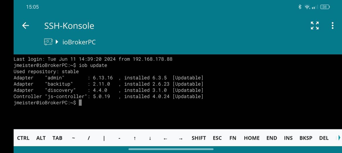

                    • jmeister79
                      jmeister79 @Thomas Braun last edited by
                      @thomas-braun Screenshot_2024-06-11-15-05-25-65_e36872cd03453bb5e33ec96ae2d9a765.jpg
                      wie eben gesagt.
                      ich will eigentlich nicht mehr updaten, da das system für mich läuft unt hatte nur gezielt einige adapter upgedated, scheinbar war das ne doofe idee.
                      jmeister79 Thomas Braun Ro75 3 Replies Last reply Reply Quote 0

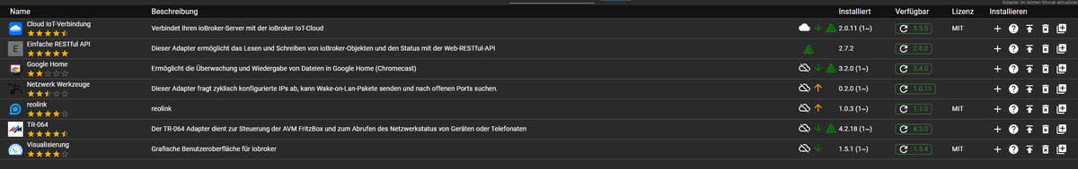

                      • jmeister79
                        jmeister79 @jmeister79 last edited by
                        dagegen das GUI
                          Thomas Braun Most Active @jmeister79 last edited by
                          @jmeister79 sagte in Cannot download and install adapter "telegram@3.2.1":
                          Ja, so handelt man sich nämlich Inkonsistenzen ein.

                              • jmeister79
                                iob update:
                                pi@iobrokerpi:~ $ iob update
                                node:internal/modules/cjs/loader:1143
                                  throw err;
                                Error: Cannot find module 'axios'
                                Require stack:
                                - /opt/iobroker/node_modules/@iobroker/js-controller-common/build/lib/common/tools.js
                                - /opt/iobroker/node_modules/@iobroker/js-controller-common/build/index.js
                                - /opt/iobroker/node_modules/@iobroker/js-controller-cli/build/lib/setup.js
                                - /opt/iobroker/node_modules/@iobroker/js-controller-cli/build/index.js
                                - /opt/iobroker/node_modules/iobroker.js-controller/iobroker.js
                                    at Module._resolveFilename (node:internal/modules/cjs/loader:1140:15)
                                    at Module._load (node:internal/modules/cjs/loader:981:27)
                                    at Module.require (node:internal/modules/cjs/loader:1231:19)
                                    at require (node:internal/modules/helpers:177:18)
                                    at Object.<anonymous> (/opt/iobroker/node_modules/@iobroker/js-controller-common/build/lib/common/tools.js:36:33)
                                    at Module._compile (node:internal/modules/cjs/loader:1364:14)
                                    at Module._extensions..js (node:internal/modules/cjs/loader:1422:10)
                                    at Module.load (node:internal/modules/cjs/loader:1203:32)
                                    at Module._load (node:internal/modules/cjs/loader:1019:12)
                                    at Module.require (node:internal/modules/cjs/loader:1231:19) {
                                  code: 'MODULE_NOT_FOUND',
                                  requireStack: [
                                    '/opt/iobroker/node_modules/@iobroker/js-controller-common/build/lib/common/tools.js',
                                    '/opt/iobroker/node_modules/@iobroker/js-controller-common/build/index.js',
                                    '/opt/iobroker/node_modules/@iobroker/js-controller-cli/build/lib/setup.js',
                                    '/opt/iobroker/node_modules/@iobroker/js-controller-cli/build/index.js',
                                    '/opt/iobroker/node_modules/iobroker.js-controller/iobroker.js'
                                Node.js v18.20.2
                                pi@iobrokerpi:~ $
                                • jmeister79
                                  jmeister79 last edited by jmeister79
                                  spannend, das putty hier die ganzen Fehler schmeisst und die ssh Console auf dem handy nicht
                                  war ja auch der andere iobroker.... IDIOT
