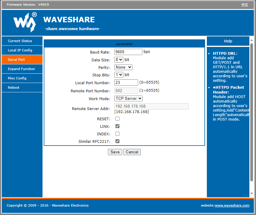

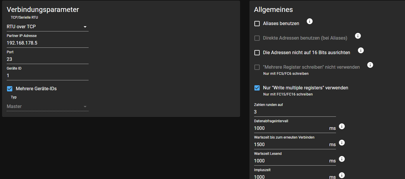

      Konfiguration:
      Modbus Konverter:
      Modbus Adapter Konfiguration:

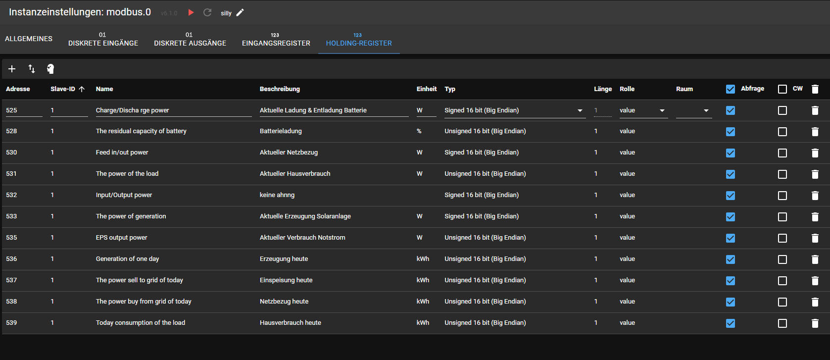

      2024-06-17 08:08:49.739 - debug: modbus.0 (76061) Initialize Objects for holdingRegs: [{"_address":525,"deviceId":1,"name":"Charge/Discha rge power","description":"Aktuelle Ladung & Entladung Batterie","unit":"W","type":"int16be","len":1,"factor":1,"offset":0,"formula":"x * 10","role":"value","room":"","poll":true,"wp":"","cw":"","isScale":"","address":525,"id":"holdingRegisters.1.525_Charge/Discha_rge_power"},{"_address":528,"deviceId":1,"name":"The residual capacity of battery","description":"Batterieladung","unit":"%","type":"uint16be","len":1,"factor":1,"offset":0,"formula":"","role":"value","room":"","poll":true,"wp":"","cw":false,"isScale":"","address":528,"id":"holdingRegisters.1.528_The_residual_capacity_of_battery"},{"_address":530,"deviceId":1,"name":"Feed in/out power","description":"Aktueller Netzbezug","unit":"W","type":"int16be","len":1,"factor":1,"offset":0,"formula":"x * -10","role":"value","room":"","poll":true,"wp":"","cw":"","isScale":"","address":530,"id":"holdingRegisters.1.530_Feed_in/out_power"},{"_address":531,"deviceId":1,"name":"The power of the load","description":"Aktueller Hausverbrauch","unit":"W","type":"uint16be","len":1,"factor":1,"offset":0,"formula":"x * 10","role":"value","room":"","poll":true,"wp":"","cw":"","isScale":"","address":531,"id":"holdingRegisters.1.531_The_power_of_the_load"},{"_address":532,"deviceId":1,"name":"Input/Output power","description":"keine ahnng","unit":"","type":"int16be","len":1,"factor":1,"offset":0,"formula":"","role":"value","room":"","poll":true,"wp":"","cw":"","isScale":"","address":532,"id":"holdingRegisters.1.532_Input/Output_power"},{"_address":533,"deviceId":1,"name":"The power of generation","description":"Aktuelle Erzeugung Solaranlage","unit":"W","type":"int16be","len":1,"factor":1,"offset":0,"formula":"x *-10","role":"value","room":"","poll":true,"wp":"","cw":"","isScale":"","address":533,"id":"holdingRegisters.1.533_The_power_of_generation"},{"_address":535,"deviceId":1,"name":"EPS output power","description":"Aktueller Verbrauch Notstrom","unit":"W","type":"uint16be","len":1,"factor":1,"offset":0,"formula":"x / 10","role":"value","room":"","poll":true,"wp":"","cw":"","isScale":"","address":535,"id":"holdingRegisters.1.535_EPS_output_power"},{"_address":536,"deviceId":1,"name":"Generation of one day","description":"Erzeugung heute","unit":"kWh","type":"uint16be","len":1,"factor":1,"offset":0,"formula":"x / 100","role":"value","room":"","poll":true,"wp":"","cw":"","isScale":"","address":536,"id":"holdingRegisters.1.536_Generation_of_one_day"},{"_address":537,"deviceId":1,"name":"The power sell to grid of today","description":"Einspeisung heute","unit":"kWh","type":"uint16be","len":1,"factor":1,"offset":0,"formula":"x / 100","role":"value","room":"","poll":true,"wp":"","cw":"","isScale":"","address":537,"id":"holdingRegisters.1.537_The_power_sell_to_grid_of_today"},{"_address":538,"deviceId":1,"name":"The power buy from grid of today","description":"Netzbezug heute","unit":"kWh","type":"uint16be","len":1,"factor":1,"offset":0,"formula":"x / 100","role":"value","room":"","poll":true,"wp":"","cw":"","isScale":"","address":538,"id":"holdingRegisters.1.538_The_power_buy_from_grid_of_today"},{"_address":539,"deviceId":1,"name":"Today consumption of the load","description":"Hausverbrauch heute","unit":"kWh","type":"uint16be","len":1,"factor":1,"offset":0,"formula":"x / 100","role":"value","room":"","poll":true,"wp":"","cw":"","isScale":"","address":539,"id":"holdingRegisters.1.539_Today_consumption_of_the_load"}]
      2024-06-17 08:08:49.740 - debug: modbus.0 (76061) Add holdingRegisters.1.525_Charge/Discha_rge_power: {"_id":"holdingRegisters.1.525_Charge/Discha_rge_power","type":"state","common":{"name":"Aktuelle Ladung & Entladung Batterie","role":"value","type":"number","read":true,"write":true,"def":0,"unit":"W"},"native":{"regType":"holdingRegs","address":525,"deviceId":1,"type":"int16be","len":1,"offset":0,"factor":1,"poll":true}}
      2024-06-17 08:08:49.740 - debug: modbus.0 (76061) Add holdingRegisters.1.528_The_residual_capacity_of_battery: {"_id":"holdingRegisters.1.528_The_residual_capacity_of_battery","type":"state","common":{"name":"Batterieladung","role":"value","type":"number","read":true,"write":true,"def":0,"unit":"%"},"native":{"regType":"holdingRegs","address":528,"deviceId":1,"type":"uint16be","len":1,"offset":0,"factor":1,"poll":true}}
      2024-06-17 08:08:49.740 - debug: modbus.0 (76061) Add holdingRegisters.1.530_Feed_in/out_power: {"_id":"holdingRegisters.1.530_Feed_in/out_power","type":"state","common":{"name":"Aktueller Netzbezug","role":"value","type":"number","read":true,"write":true,"def":0,"unit":"W"},"native":{"regType":"holdingRegs","address":530,"deviceId":1,"type":"int16be","len":1,"offset":0,"factor":1,"poll":true}}
      2024-06-17 08:08:49.740 - debug: modbus.0 (76061) Add holdingRegisters.1.531_The_power_of_the_load: {"_id":"holdingRegisters.1.531_The_power_of_the_load","type":"state","common":{"name":"Aktueller Hausverbrauch","role":"value","type":"number","read":true,"write":true,"def":0,"unit":"W"},"native":{"regType":"holdingRegs","address":531,"deviceId":1,"type":"uint16be","len":1,"offset":0,"factor":1,"poll":true}}
      2024-06-17 08:08:49.740 - debug: modbus.0 (76061) Add holdingRegisters.1.532_Input/Output_power: {"_id":"holdingRegisters.1.532_Input/Output_power","type":"state","common":{"name":"keine ahnng","role":"value","type":"number","read":true,"write":true,"def":0,"unit":""},"native":{"regType":"holdingRegs","address":532,"deviceId":1,"type":"int16be","len":1,"offset":0,"factor":1,"poll":true}}
      2024-06-17 08:08:49.740 - debug: modbus.0 (76061) Add holdingRegisters.1.533_The_power_of_generation: {"_id":"holdingRegisters.1.533_The_power_of_generation","type":"state","common":{"name":"Aktuelle Erzeugung Solaranlage","role":"value","type":"number","read":true,"write":true,"def":0,"unit":"W"},"native":{"regType":"holdingRegs","address":533,"deviceId":1,"type":"int16be","len":1,"offset":0,"factor":1,"poll":true}}
      2024-06-17 08:08:49.740 - debug: modbus.0 (76061) Add holdingRegisters.1.535_EPS_output_power: {"_id":"holdingRegisters.1.535_EPS_output_power","type":"state","common":{"name":"Aktueller Verbrauch Notstrom","role":"value","type":"number","read":true,"write":true,"def":0,"unit":"W"},"native":{"regType":"holdingRegs","address":535,"deviceId":1,"type":"uint16be","len":1,"offset":0,"factor":1,"poll":true}}
      2024-06-17 08:08:49.740 - debug: modbus.0 (76061) Add holdingRegisters.1.536_Generation_of_one_day: {"_id":"holdingRegisters.1.536_Generation_of_one_day","type":"state","common":{"name":"Erzeugung heute","role":"value","type":"number","read":true,"write":true,"def":0,"unit":"kWh"},"native":{"regType":"holdingRegs","address":536,"deviceId":1,"type":"uint16be","len":1,"offset":0,"factor":1,"poll":true}}
      2024-06-17 08:08:49.740 - debug: modbus.0 (76061) Add holdingRegisters.1.537_The_power_sell_to_grid_of_today: {"_id":"holdingRegisters.1.537_The_power_sell_to_grid_of_today","type":"state","common":{"name":"Einspeisung heute","role":"value","type":"number","read":true,"write":true,"def":0,"unit":"kWh"},"native":{"regType":"holdingRegs","address":537,"deviceId":1,"type":"uint16be","len":1,"offset":0,"factor":1,"poll":true}}
      2024-06-17 08:08:49.740 - debug: modbus.0 (76061) Add holdingRegisters.1.538_The_power_buy_from_grid_of_today: {"_id":"holdingRegisters.1.538_The_power_buy_from_grid_of_today","type":"state","common":{"name":"Netzbezug heute","role":"value","type":"number","read":true,"write":true,"def":0,"unit":"kWh"},"native":{"regType":"holdingRegs","address":538,"deviceId":1,"type":"uint16be","len":1,"offset":0,"factor":1,"poll":true}}
      2024-06-17 08:08:49.740 - debug: modbus.0 (76061) Add holdingRegisters.1.539_Today_consumption_of_the_load: {"_id":"holdingRegisters.1.539_Today_consumption_of_the_load","type":"state","common":{"name":"Hausverbrauch heute","role":"value","type":"number","read":true,"write":true,"def":0,"unit":"kWh"},"native":{"regType":"holdingRegs","address":539,"deviceId":1,"type":"uint16be","len":1,"offset":0,"factor":1,"poll":true}}

          Um für mich die Fehlerquellen "außerhalb vom ioBroker" zu definieren, folgendes wären Punkte:
          • Konfiguration des Konverters und Adapters fehlerhaft (kann ich das ausschließen, da es bereits funktioniert hat!?)
          • Hardwaredefekt des Konverters
          • Hardwaredefekt am Kabel zwischen Konverter und Switch (kann ich das ausschließen, da ich via IP noch auf den Konverter komme?)
          • Hardwaredefekt am Kabel zwischen Wechselrichter und Konverter
          Gibt es noch weitere Punkte die ich checken sollte?
          Danke!

          • Latzi
            Latzi @n3ucr0n last edited by
            @n3ucr0n
            timeout vom Modbus-Adapter höher stellen, 1 sek ist sportlich 😉
            • N
              n3ucr0n @Latzi last edited by
              @latzi Habe die Zeiten mal auf 10 Sekunden erhöht.
              Selbige Fehler nur eben nicht mehr im Sekundentakt 😊
              Latzi 1 Reply Last reply Reply Quote 0
              • Latzi
                @n3ucr0n
                schade, Versuch war´s wert.
