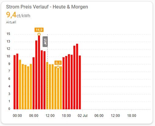

        • fhainz
          fhainz @paul53 last edited by
          Super, vielen Dank! Jetzt funktioniert es natürlich.
          type: custom:apexcharts-card
          experimental:
            color_threshold: true
          graph_span: 2day
          update_interval: 2m
          now:
            show: true
            label: Jetzt
            color: gray
          span:
            offset: +0day
            start: day
          yaxis:
            - id: primary
              decimals: 0
              min: 0
          header:
            show: true
            title: Strom Preis Verlauf - Heute & Morgen
            show_states: true
            colorize_states: true
          all_series_config:
            color_threshold:
              - value: -100
                color: green
              - value: 5
                color: orange
              - value: 10
                color: red
            unit: ct/kWh
            type: line
            stroke_width: 0
            show:
              legend_value: false
              in_header: true
              header_color_threshold: true
          series:
            - entity: sensor.awattar_full
              type: column
              show:
                extremas: true
                in_header: before_now
              data_generator: |
                var data = [];
                var formattedJSON = JSON.parse(entity.state).data;
                console.log(formattedJSON);
                formattedJSON.forEach(obj => {
                  data.push([obj.start_timestamp, (obj.marketprice/10*1.2)])
                return data;
