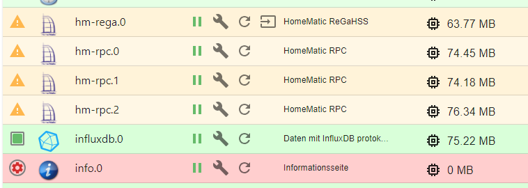

      Wie man sieht, zeigt auch info einen Fehler.

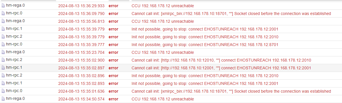

      Es werden permanent neue Logs geschrieben:
      Was ist da schief gelaufen und wie kann ich es jetzt beheben?
      Danke Euch im Voraus und Grüße

                Die IP von pivCCU ist 192.168.178.12.
                Init not possible, going to stop: connect EHOSTUNREACH 192.168.178.12:2001
                Cannot call init: [http://192.168.178.10:12001, ""] connect EHOSTUNREACH 192.168.178.12:2001
                CCU 192.168.178.12 unreachable
                setTimeout called, but adapter is shutting down
                Bitte welche Daten zu meinem System fehlen noch?

                    > *** Log File - Last 25 Lines ***
                    > 2024-08-13 15:51:30.782  - info: hm-rpc.2 (6575) xmlrpc client is trying to connect to 192.168.178.12:2010/ with ["http://192.168.178.10:12010","iobroker-pi:hm-rpc.2:325a5da9b9959b38a1d02500f5dff733"]
                    > 2024-08-13 15:51:30.849  - info: hm-rpc.1 (6586) xmlrpc server is trying to listen on 192.168.178.10:12001
                    > 2024-08-13 15:51:30.850  - info: hm-rpc.1 (6586) xmlrpc client is trying to connect to 192.168.178.12:2001/ with ["http://192.168.178.10:12001","iobroker-pi:hm-rpc.1:77e7296879feb3366411ef62aab861bd"]
                    > 2024-08-13 15:51:33.949  - error: hm-rpc.2 (6575) Init not possible, going to stop: connect EHOSTUNREACH 192.168.178.12:2010
                    > 2024-08-13 15:51:33.957  - error: hm-rpc.1 (6586) Init not possible, going to stop: connect EHOSTUNREACH 192.168.178.12:2001
                    > 2024-08-13 15:51:49.143  - info: hm-rpc.0 (6422) binrpc -> 192.168.178.12:8701/ init ["xmlrpc_bin://192.168.178.10:18701",""]
                    > 2024-08-13 15:51:49.160  - error: hm-rpc.0 (6422) Cannot call init: [xmlrpc_bin://192.168.178.10:18701, ""] Socket closed before the connection was established
                    > 2024-08-13 15:51:49.232  - info: hm-rpc.0 (6422) terminating
                    > 2024-08-13 15:51:49.234  - info: hm-rpc.0 (6422) Terminated (NO_ERROR): Without reason
                    > 2024-08-13 15:51:49.835  - info: host.iobroker-pi instance system.adapter.hm-rpc.0 terminated with code 0 (NO_ERROR)
                    > 2024-08-13 15:51:49.836  - info: host.iobroker-pi Restart adapter system.adapter.hm-rpc.0 because enabled
                    > 2024-08-13 15:51:52.253  - error: hm-rega.0 (2659) CCU 192.168.178.12 unreachable
                    > 2024-08-13 15:52:03.933  - error: hm-rpc.2 (6575) Init not possible, going to stop: connect EHOSTUNREACH 192.168.178.12:2010
                    > 2024-08-13 15:52:03.935  - error: hm-rpc.1 (6586) Init not possible, going to stop: connect EHOSTUNREACH 192.168.178.12:2001
                    > 2024-08-13 15:52:03.960  - info: hm-rpc.1 (6586) xmlrpc -> 192.168.178.12:2001/ init ["http://192.168.178.10:12001",""]
                    > 2024-08-13 15:52:03.964  - info: hm-rpc.2 (6575) xmlrpc -> 192.168.178.12:2010/ init ["http://192.168.178.10:12010",""]
                    > 2024-08-13 15:52:04.969  - info: hm-rpc.1 (6586) terminating
                    > 2024-08-13 15:52:04.971  - info: hm-rpc.1 (6586) Terminated (NO_ERROR): Without reason
                    > 2024-08-13 15:52:04.978  - info: hm-rpc.2 (6575) terminating
                    > 2024-08-13 15:52:04.980  - info: hm-rpc.2 (6575) Terminated (NO_ERROR): Without reason
                    > 2024-08-13 15:52:05.572  - info: host.iobroker-pi instance system.adapter.hm-rpc.1 terminated with code 0 (NO_ERROR)
                    > 2024-08-13 15:52:05.573  - info: host.iobroker-pi Restart adapter system.adapter.hm-rpc.1 because enabled
                    > 2024-08-13 15:52:05.618  - info: host.iobroker-pi instance system.adapter.hm-rpc.2 terminated with code 0 (NO_ERROR)
                    > 2024-08-13 15:52:05.619  - info: host.iobroker-pi Restart adapter system.adapter.hm-rpc.2 because enabled
                    > 2024-08-13 15:52:19.916  - info: host.iobroker-pi instance system.adapter.hm-rpc.0 started with pid 7348

                            2024-08-13 16:11:23.334  - error: hm-rega.0 (1231) CCU 192.168.178.12 unreachable
                            Meister Mopper Thomas Braun 2 Replies Last reply Reply Quote 0

                                Da klemmt es. Hat aber nix mit nodejs oder dem ioBroker zu tun, da werden die pivCCU Module nicht geladen.
                                Und wo du einmal dran bist:
                                Controller "js-controller": 6.0.9 , installed 5.0.19 [Updatable]
                                iob stop
                                iob update
                                iob upgrade self
                                iob start

                                      2024-08-13 16:21:48.384  - info: hm-rpc.2 (4770) Terminated (NO_ERROR): Without reason
                                      2024-08-13 16:21:49.099  - info: host.iobroker-pi instance system.adapter.hm-rpc.1 terminated with code 0 (NO_ERROR)
                                      2024-08-13 16:21:49.099  - info: host.iobroker-pi Restart adapter system.adapter.hm-rpc.1 because enabled
                                      2024-08-13 16:21:49.099  - info: host.iobroker-pi instance system.adapter.hm-rpc.2 terminated with code 0 (NO_ERROR)
                                      2024-08-13 16:21:49.100  - info: host.iobroker-pi Restart adapter system.adapter.hm-rpc.2 because enabled
                                      2024-08-13 16:21:49.884  - info: hm-rpc.0 (5004) starting. Version 1.17.0 in /opt/iobroker/node_modules/iobroker.hm-rpc, node: v20.16.0, js-controller: 5.0.19
                                      2024-08-13 16:21:50.185  - info: hm-rpc.0 (5004) binrpc server is trying to listen on 192.168.178.10:18701
                                      2024-08-13 16:21:50.187  - info: hm-rpc.0 (5004) binrpc client is trying to connect to 192.168.178.12:8701/ with ["xmlrpc_bin://192.168.178.10:18701","iobroker-pi:hm-rpc.0:586ced57dee52ef270bfb61be9f07a73"]
                                      2024-08-13 16:21:50.457  - error: hm-rpc.0 (5004) Init not possible, going to stop: connect EHOSTUNREACH 192.168.178.12:8701
                                      2024-08-13 16:21:50.461  - error: hm-rega.0 (1231) CCU 192.168.178.12 unreachable
                                      2024-08-13 16:22:19.230  - info: host.iobroker-pi instance system.adapter.hm-rpc.1 started with pid 5590
                                      2024-08-13 16:22:19.243  - info: host.iobroker-pi instance system.adapter.hm-rpc.2 started with pid 5591
                                      2024-08-13 16:22:20.462  - info: hm-rpc.0 (5004) binrpc -> 192.168.178.12:8701/ init ["xmlrpc_bin://192.168.178.10:18701",""]
                                      2024-08-13 16:22:20.481  - error: hm-rpc.0 (5004) Cannot call init: [xmlrpc_bin://192.168.178.10:18701, ""] Socket closed before the connection was established
                                      2024-08-13 16:22:20.542  - info: hm-rpc.0 (5004) terminating
                                      2024-08-13 16:22:20.544  - info: hm-rpc.0 (5004) Terminated (NO_ERROR): Without reason
                                      2024-08-13 16:22:21.115  - info: host.iobroker-pi instance system.adapter.hm-rpc.0 terminated with code 0 (NO_ERROR)
                                      2024-08-13 16:22:23.573  - error: hm-rega.0 (1231) CCU 192.168.178.12 unreachable
                                      2024-08-13 16:22:21.116  - info: host.iobroker-pi Restart adapter system.adapter.hm-rpc.0 because enabled
                                      2024-08-13 16:22:25.483  - info: hm-rpc.1 (5590) starting. Version 1.17.0 in /opt/iobroker/node_modules/iobroker.hm-rpc, node: v20.16.0, js-controller: 5.0.19
                                      2024-08-13 16:22:25.516  - info: hm-rpc.2 (5591) starting. Version 1.17.0 in /opt/iobroker/node_modules/iobroker.hm-rpc, node: v20.16.0, js-controller: 5.0.19
                                      2024-08-13 16:22:25.834  - info: hm-rpc.1 (5590) xmlrpc server is trying to listen on 192.168.178.10:12001
                                      2024-08-13 16:22:25.835  - info: hm-rpc.1 (5590) xmlrpc client is trying to connect to 192.168.178.12:2001/ with ["http://192.168.178.10:12001","iobroker-pi:hm-rpc.1:b7e0bbb00b214da627cd2ac33e1e6a94"]
                                      2024-08-13 16:22:25.863  - info: hm-rpc.2 (5591) xmlrpc server is trying to listen on 192.168.178.10:12010
                                      2024-08-13 16:22:25.865  - info: hm-rpc.2 (5591) xmlrpc client is trying to connect to 192.168.178.12:2010/ with ["http://192.168.178.10:12010","iobroker-pi:hm-rpc.2:53dc961ed27d3c18a140cba29ed780cc"]
