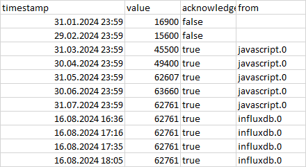

      > select * from "0_userdata.0.NousVerbrauch.PV-Anlage.SENSOR.letzter_monat"
      time                ack  from                        q value
      1706741940000000000                                    16900
      1709247540000000000                                    15600
      1711922340114000000 true system.adapter.javascript.0 0 45500
      1714514340094000000 true system.adapter.javascript.0 0 49400
      1717192740126000000 true system.adapter.javascript.0 0 62607
      1719784740077000000 true system.adapter.javascript.0 0 63660
      1722463140125000000 true system.adapter.javascript.0 0 62761
      1723818985923000000 true system.adapter.influxdb.0   0 62761
      1723821403204000000 true system.adapter.influxdb.0   0 62761
      1723822504917000000 true system.adapter.influxdb.0   0 62761
      1723824336097000000 true system.adapter.influxdb.0   0 62761

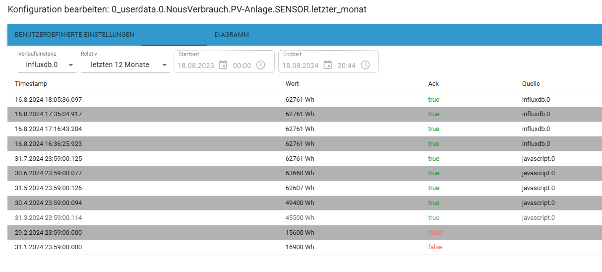

            • O
              opöl @Homoran last edited by
              @homoran ,
              reicht das so als Screenshot?
              O Homoran 2 Replies Last reply Reply Quote 0
              • O
                opöl @opöl last edited by
                  Homoran Global Moderator Administrators @opöl last edited by
