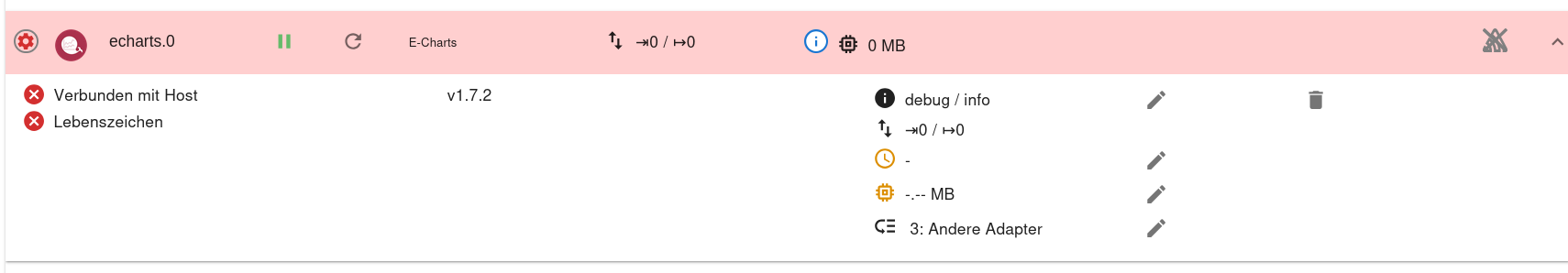

    4. Nach Update js-controller macht host.raspberrypi Fehler
    • spicer
      spicer last edited by
      Nach Update des js-controller von @6.0.9 nach @6.0.11 macht host.raspberrypi folgende Fehler:
      host.raspberrypi
      	2024-08-28 22:44:01.596	error	instance system.adapter.echarts.0 terminated with code 1 (JS_CONTROLLER_STOPPED)
      host.raspberrypi
      	2024-08-28 22:44:01.595	error	Caught by controller[0]: Node.js v18.20.4
      host.raspberrypi
      	2024-08-28 22:44:01.595	error	Caught by controller[0]: }
      host.raspberrypi
      	2024-08-28 22:44:01.595	error	Caught by controller[0]: requireStack: [ '/opt/iobroker/node_modules/iobroker.echarts/main.js' ]
      host.raspberrypi
      	2024-08-28 22:44:01.595	error	Caught by controller[0]: code: 'MODULE_NOT_FOUND',
      host.raspberrypi
      	2024-08-28 22:44:01.594	error	Caught by controller[0]: at Function.executeUserEntryPoint [as runMain] (node:internal/modules/run_main:128:12) {
      host.raspberrypi
      	2024-08-28 22:44:01.594	error	Caught by controller[0]: at Module._load (node:internal/modules/cjs/loader:1019:12)
      host.raspberrypi
      	2024-08-28 22:44:01.594	error	Caught by controller[0]: at Module.load (node:internal/modules/cjs/loader:1203:32)
      host.raspberrypi
      	2024-08-28 22:44:01.594	error	Caught by controller[0]: at Module._extensions..js (node:internal/modules/cjs/loader:1422:10)
      host.raspberrypi
      	2024-08-28 22:44:01.593	error	Caught by controller[0]: at Module._compile (node:internal/modules/cjs/loader:1364:14)
      host.raspberrypi
      	2024-08-28 22:44:01.592	error	Caught by controller[0]: at Object.<anonymous> (/opt/iobroker/node_modules/iobroker.echarts/main.js:12:21)
      host.raspberrypi
      	2024-08-28 22:44:01.592	error	Caught by controller[0]: at require (node:internal/modules/helpers:177:18)
      host.raspberrypi
      	2024-08-28 22:44:01.591	error	Caught by controller[0]: at Module.require (node:internal/modules/cjs/loader:1231:19)
      host.raspberrypi
      	2024-08-28 22:44:01.591	error	Caught by controller[0]: at Module._load (node:internal/modules/cjs/loader:981:27)
      host.raspberrypi
      	2024-08-28 22:44:01.591	error	Caught by controller[0]: at Module._resolveFilename (node:internal/modules/cjs/loader:1140:15)
      host.raspberrypi
      	2024-08-28 22:44:01.591	error	Caught by controller[0]: - /opt/iobroker/node_modules/iobroker.echarts/main.js
      host.raspberrypi
      	2024-08-28 22:44:01.590	error	Caught by controller[0]: Require stack:
      host.raspberrypi
      	2024-08-28 22:44:01.590	error	Caught by controller[0]: Error: Cannot find module '@iobroker/adapter-core'
      host.raspberrypi
      	2024-08-28 22:44:01.590	error	Caught by controller[0]: ^
      host.raspberrypi
      	2024-08-28 22:44:01.589	error	Caught by controller[0]: throw err;
      host.raspberrypi
      	2024-08-28 22:44:01.588	error	Caught by controller[0]: node:internal/modules/cjs/loader:1143
      Echarts läuft so auch nicht mehr.
      Hat jemand Rat?

              Thomas Braun Most Active @spicer last edited by
              @spicer sagte in Nach Update js-controller macht host.raspberrypi Fehler:
              Operating System: Raspbian GNU/Linux 11 (bullseye)
              Installier das bei nächster Gelegenheit komplett neu.
              Dann ohne Desktop und in der 64Bit-Version.
              Und mit einem username ungleich 'pi' und ungleich 'iobroker'.
              iob start echarts.0
              sagt?

                iob start echarts.0 sagt nichts!

                  @spicer
                  Zeigen. Komplette Ein- wie Ausgabezeilen.

                      pi@raspberrypi:~ $ iob start echarts.0
                      pi@raspberrypi:~ $

                        @spicer
                        iob list instances
                        spicer 1 Reply Last reply Reply Quote 0

                          pi@raspberrypi:~ $ iob list instances
                            @spicer
                            Dann schau nochmal in das Log:
                            iob logs

                              • spicer
                                spicer @spicer last edited by
                                Das ist wohl interessanter:
                                2024-08-28 23:24:40.199  - error: host.raspberrypi Caught by controller[0]: node:internal/modules/cjs/loader:1228
                                2024-08-28 23:24:40.201  - error: host.raspberrypi Caught by controller[0]:   throw err;
                                2024-08-28 23:24:40.202  - error: host.raspberrypi Caught by controller[0]:   ^
                                2024-08-28 23:24:40.204  - error: host.raspberrypi Caught by controller[0]: Error: Cannot find module '@iobroker/adapter-core'
                                2024-08-28 23:24:40.205  - error: host.raspberrypi Caught by controller[0]: Require stack:
                                2024-08-28 23:24:40.206  - error: host.raspberrypi Caught by controller[0]: - /opt/iobroker/node_modules/iobroker.echarts/main.js
                                2024-08-28 23:24:40.207  - error: host.raspberrypi Caught by controller[0]:     at Module._resolveFilename (node:internal/modules/cjs/loader:1225:15)
                                2024-08-28 23:24:40.208  - error: host.raspberrypi Caught by controller[0]:     at Module._load (node:internal/modules/cjs/loader:1051:27)
                                2024-08-28 23:24:40.210  - error: host.raspberrypi Caught by controller[0]:     at Module.require (node:internal/modules/cjs/loader:1311:19)
                                2024-08-28 23:24:40.210  - error: host.raspberrypi Caught by controller[0]:     at require (node:internal/modules/helpers:179:18)
                                2024-08-28 23:24:40.211  - error: host.raspberrypi Caught by controller[0]:     at Object.<anonymous> (/opt/iobroker/node_modules/iobroker.echarts/main.js:12:21)
                                2024-08-28 23:24:40.211  - error: host.raspberrypi Caught by controller[0]:     at Module._compile (node:internal/modules/cjs/loader:1469:14)
                                2024-08-28 23:24:40.212  - error: host.raspberrypi Caught by controller[0]:     at Module._extensions..js (node:internal/modules/cjs/loader:1548:10)
                                2024-08-28 23:24:40.213  - error: host.raspberrypi Caught by controller[0]:     at Module.load (node:internal/modules/cjs/loader:1288:32)
                                2024-08-28 23:24:40.214  - error: host.raspberrypi Caught by controller[0]:     at Module._load (node:internal/modules/cjs/loader:1104:12)
                                2024-08-28 23:24:40.215  - error: host.raspberrypi Caught by controller[0]:     at Function.executeUserEntryPoint [as runMain] (node:internal/modules/run_main:174:12) {
                                2024-08-28 23:24:40.215  - error: host.raspberrypi Caught by controller[0]:   code: 'MODULE_NOT_FOUND',
                                2024-08-28 23:24:40.218  - error: host.raspberrypi Caught by controller[0]:   requireStack: [ '/opt/iobroker/node_modules/iobroker.echarts/main.js' ]
                                2024-08-28 23:24:40.222  - error: host.raspberrypi Caught by controller[0]: }
                                2024-08-28 23:24:40.223  - error: host.raspberrypi Caught by controller[0]: Node.js v20.17.0
                                2024-08-28 23:24:40.224  - error: host.raspberrypi instance system.adapter.echarts.0 terminated with code 1 (JS_CONTROLLER_STOPPED)
                                2024-08-28 23:24:40.225  - info: host.raspberrypi Rebuild for adapter system.adapter.echarts.0 not successful in 3 tries. Adapter will not be restarted again. Please execute "npm install --production" in adapter directory manually.

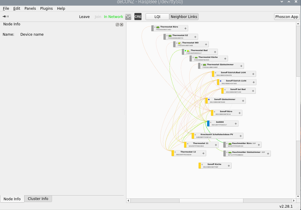

                                        Habe mich ev etwas falsch ausgedrückt.
                                        Am RPI hängt ein RaspBee 2 (ZigBee Adapter). Um diese GUI zu erhalten
                                        habe ich keine Lösung gefunden, bei welcher die GUI per http im Browser angeschaut/editiert werden kann.
                                        Natürlich hat man sonst auf den Servern keine GUI. Das hab ich auf meinen externen Servern auch nirgends drauf 😉

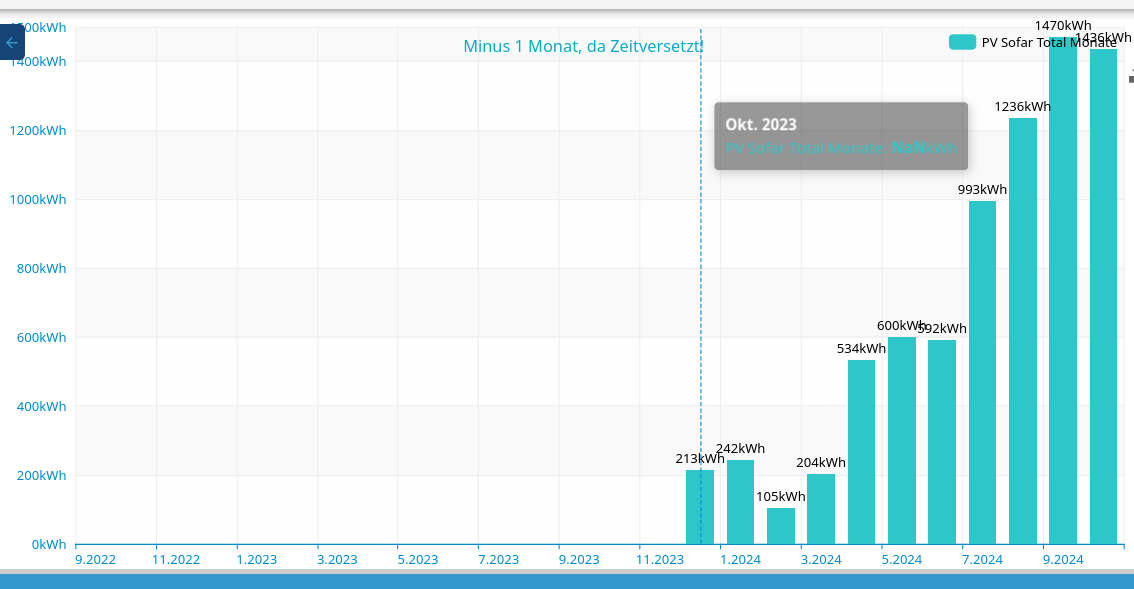

                                          Jetzt wird's interessant. eCharts funktioniert und es kommen auch keine Fehler mehr im Log.
                                          Aber bei den Instanzen steht:
                                            Dann mache ich doch besser keine Updates mehr... ist eigentlich Irrsinn.
                                            Du sollst es ja auch nicht updaten sondern NEUinstallieren.
