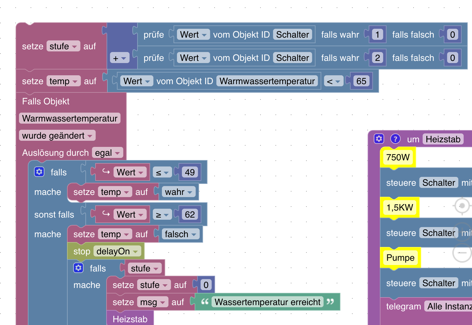

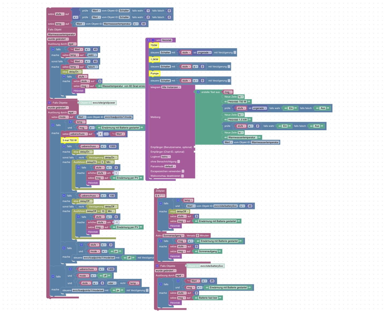

        <variables>
          <variable id="#ZO}puq!byH)d[RA8.u~">stufe</variable>
          <variable id="SXNPrFdTCWx5V%N:sTKY">temp</variable>
          <variable id="k{nMf[SMX?gF-mm8]|=G">mode</variable>
          <variable id="S`Q7El*S8|6o7zjVveF`">ueberschuss</variable>
          <variable type="timeout" id="delayOn">delayOn</variable>
          <variable type="timeout" id="delayOff">delayOff</variable>
        </variables>
        <block type="variables_set" id="V88W|+Iln7v+rgj)=Zch" x="-87" y="37">
          <field name="VAR" id="#ZO}puq!byH)d[RA8.u~">stufe</field>
            <block type="math_arithmetic" id="UPGMM~b*V$d-a*#;tS[D" inline="false">
              <field name="OP">ADD</field>
                <shadow type="math_number" id="~wy?L?:xH(Ni)}x,PFCD">
                  <field name="NUM">1</field>
                <block type="logic_ternary" id="*J#=-SvRj,t10JsQT^g)" inline="true">
                  <value name="IF">
                    <block type="get_value" id="Di]!Es+iNie7c[+9)*;x">
                      <field name="OID">shelly.0.shellyplus1pm#d4d4da094ad0#1.Relay0.Switch</field>
                  <value name="THEN">
                    <block type="math_number" id="e=$;Dm*Kdv-Y8so-i~0#">
                  <value name="ELSE">
                    <block type="math_number" id="`O}G]nrYU1J(u^B(cJ4D">
                      <field name="NUM">0</field>
                <shadow type="math_number" id="};}!|b@GbaTL{Y_1M4mO">
                <block type="logic_ternary" id=";LD9IL!$vH=aILt*01D]" inline="true">
                  <value name="IF">
                    <block type="get_value" id="UP`ZrOpZ0?YW7(BPAKu=">
                      <field name="OID">shelly.0.shellyplus1pm#a0a3b34d7024#1.Relay0.Switch</field>
                  <value name="THEN">
                    <block type="math_number" id="_#[$Y6bW6I=KD6W@i8-H">
                      <field name="NUM">2</field>
                  <value name="ELSE">
                    <block type="math_number" id="a`){P].I3sR02/vH?$|t">
            <block type="variables_set" id="7R`M9}=u-yZAG[5j@K)$">
              <field name="VAR" id="SXNPrFdTCWx5V%N:sTKY">temp</field>
                <block type="logic_compare" id="6[ohhz;+P4G2[.od]ImC">
                  <field name="OP">LT</field>
                    <block type="get_value" id="4Pb~v{Xo!`=Cczx2o0)l">
                      <field name="OID">0_userdata.0.Warmwassertemperatur</field>
                    <block type="math_number" id="m_`#qRy{mdN;8Wkutd}Z">
                      <field name="NUM">70</field>
                <block type="on" id="LXkRS$m9ymaz|AU}(3D-">
                    <block type="controls_if" id="/*xJA|RfsBE6jL/y4RMv">
                        <block type="logic_compare" id="abt~D((tU./KQf)r!P5_">
                          <field name="OP">LTE</field>
                            <block type="on_source" id="jxvpxN@GG/Fr3.@{p*Qg">
                            <block type="math_number" id="KTT4cWRD*14oOM_eHEM-">
                              <field name="NUM">40</field>
                        <block type="variables_set" id="B@|!KIBBsgKl%wMaLLMA">
                            <block type="logic_boolean" id="~FL/KuNy;B%E^dbEM2~)">
                      <value name="IF1">
                        <block type="logic_compare" id="0W8i1Y/4aj=@g}9EL)5f">
                          <field name="OP">GTE</field>
                            <block type="on_source" id="Wk:dm:!%FN!b-M}J8DT~">
                            <block type="math_number" id="#L~Z[Ph@qd5Au:Y/Rxx/">
                              <field name="NUM">55</field>
                      <statement name="DO1">
                        <block type="variables_set" id="r+q`|M)Cmk#0{Z*?(tGl">
                            <block type="logic_boolean" id="yU:Uu{8YwH%(u[JY_z|5">
                            <block type="timeouts_cleartimeout" id="-#-ZoUoJJzOWm:bymT4$">
                              <field name="NAME">delayOn</field>
                                <block type="controls_if" id="/hND@SJrrY?d.QSbT5g.">
                                    <block type="variables_get" id="uu`Y?^o}1M0kt)2+}PL/">
                                    <block type="variables_set" id="8V4C*+}E*6rfG:n8v%9j">
                                        <block type="math_number" id="c49%ZEXt|0rJ)c3%]Bg7">
                                        <block type="procedures_callnoreturn" id="B/^8#Eh:a=a,b;reJ%$U">
                                          <mutation name="Heizstab"></mutation>
                    <block type="on_ext" id="^=k13pGi`kMjtE||vY.J">
                      <value name="OID0">
                        <shadow type="field_oid" id="n:wY~I3GQO$7,0:+.oY=">
                          <field name="oid">evcc.0.status.gridPower</field>
                        <block type="variables_set" id="eS.8I`Cbj?X+,h#Ii[CO">
                          <field name="VAR" id="k{nMf[SMX?gF-mm8]|=G">mode</field>
                            <block type="get_value" id="{R{!vXhV35!~PTT}Y^p%">
                              <field name="OID">evcc.0.loadpoint.1.status.mode</field>
                            <block type="controls_if" id="hmYi@K1![q7IP+`oD|(i">
                                <block type="variables_get" id="MZl)|}gNS^ERpHs!P3{^">
                                <block type="variables_set" id="U0g[6)DF7XBr6PjSBC1%">
                                  <field name="VAR" id="S`Q7El*S8|6o7zjVveF`">ueberschuss</field>
                                    <block type="math_arithmetic" id="fF$hk1tVi-R05oeMt;V%">
                                        <shadow type="math_number" id="ixiYq]/$A+RSmijBZE[,">
                                        <shadow type="math_number" id="Cs,pKE7(!7+1jmwBW.2/">
                                        <block type="on_source" id="f=2?mi+jttya*Yya7dG.">
                                    <block type="comment" id="9X:XKXRgH!xZ!=zZbThm">
                                      <field name="COMMENT">3 mal 750 W</field>
                                        <block type="controls_if" id="?{[99~rn+X@-!776Gil$">
                                            <block type="logic_compare" id="d%IZlzT50i(a7nefKk6]">
                                                <block type="variables_get" id="lg4*^=8|`oo@q1o#)S/S">
                                                <block type="math_number" id="vP_iZf?M;`@RCY1gD^i:">
                                                  <field name="NUM">1000</field>
                                            <block type="timeouts_cleartimeout" id="|#WysqWLOkMz:?pQ*-CZ">
                                          <value name="IF1">
                                            <block type="logic_negate" id="dch2(fx(/ykyn#X-R`9x">
                                              <value name="BOOL">
                                                <block type="timeouts_gettimeout" id="xJVx:Mi5[U_(t*bw(Yq$">
                                            <block type="timeouts_settimeout" id="=EI:`22NaF],y?uV^b1B">
                                              <field name="DELAY">5</field>
                                                <block type="controls_if" id="L^8:G3aDU.xP#v0K7^n[">
                                                    <block type="logic_compare" id="rRm-_cjXetCm)~hcAE~}">
                                                        <block type="variables_get" id="k?Bzt4RS=S!C{E%~JKR%">
                                                        <block type="math_number" id="?UTjTS/9I`U;T!+,CaMi">
                                                          <field name="NUM">3</field>
                                                    <block type="math_change" id="j%wz0Z;.Z9l}/YcJ|u@O">
                                                      <value name="DELTA">
                                                        <shadow type="math_number" id="*QTjL.s^?cd[t)LK(x*L">
                                                        <block type="procedures_callnoreturn" id="toS^1+[sVXvM12+04n~j">
                                                            <block type="timeouts_cleartimeout" id="WJ?t^mxt0H|jM5A2zX=v">
                                            <block type="controls_if" id="U^YFuAk{|bn.*b{Ep;B=">
                                                <block type="logic_compare" id="GddE`U/xj*}WZ:OC-j_5">
                                                  <field name="OP">GT</field>
                                                    <block type="variables_get" id="Ji]v?2~|pv5`v!eeLtH`">
                                                    <block type="math_number" id=":{IrB{m-gbX@X2|pVyXZ">
                                                      <field name="NUM">100</field>
                                                <block type="timeouts_cleartimeout" id="_N.QOqsujv5EzF,e1:^`">
                                                  <field name="NAME">delayOff</field>
                                              <value name="IF1">
                                                <block type="logic_negate" id="0(6[M7amQ.RY*S4wPkX3">
                                                  <value name="BOOL">
                                                    <block type="timeouts_gettimeout" id="pTQJfLPne.dmqq!4K#Q.">
                                                <block type="timeouts_settimeout" id="b(4T]c7c@_xcR0^(IJQ#">
                                                  <field name="DELAY">10</field>
                                                    <block type="controls_if" id="N`KrOVa}E?2GEgP!,hnz">
                                                        <block type="logic_compare" id="!!K9CK;|;n]ddqB#Sv9x">
                                                            <block type="variables_get" id="(BxBl^T0kZqo1s{{@q2;">
                                                            <block type="math_number" id="aJaeQbM-4{Urt]DVf9Q.">
                                                        <block type="math_change" id="Sq6c}B`kReZUISESR)FH">
                                                            <shadow type="math_number" id="!F{}xNQ_117l8Vz1)Bw-">
                                                              <field name="NUM">-1</field>
                                                            <block type="procedures_callnoreturn" id="$}C4r;1}f|vwd?j_@rJ*">
                                                        <block type="timeouts_cleartimeout" id="`D+24l9JDFvo/:O-kz6]">
                                                <block type="controls_if" id="C.Q,;pb(q@xOpG/(t]/h">
                                                    <block type="logic_multi_and" id="2GfeB4yC2kzQT#8ReZ}=">
                                                      <value name="AND0">
                                                        <block type="logic_compare" id="U8WSk0}eP|gz:_.8;6n-">
                                                            <block type="variables_get" id="oO(C6Q[/P,)5tJ1A6zn{">
                                                            <block type="math_number" id="cO:.k%]nbyqdZZKwR:p1">
                                                      <value name="AND1">
                                                        <block type="logic_compare" id="]!,y-!oG5N#LXvZNyy8/">
                                                          <field name="OP">EQ</field>
                                                            <block type="variables_get" id="wwHeMiuZ`bFf[KL7,Cte">
                                                            <block type="text" id="=.QVc$;/f^Kv6Y{u@QTF">
                                                              <field name="TEXT">pv</field>
                                                    <block type="control" id="^s0@1#IZw/Jcv!hTb%Uz">
                                                      <field name="OID">evcc.0.loadpoint.1.control.off</field>
                                                        <block type="logic_boolean" id=".gM(n78-Gvt7U(D7mB,%">
                                <block type="controls_if" id="@6yDcOCFSz44R_a#Xe+H">
                                    <block type="logic_multi_and" id=";kLlWo4Z^KkbyE{9]G_f">
                                      <mutation xmlns="http://www.w3.org/1999/xhtml" items="3"></mutation>
                                      <value name="AND0">
                                        <block type="logic_compare" id="!Vuk__O@p;-zFN$AS_.@">
                                            <block type="variables_get" id="W4}91]k0.ZkPVRWjM7N1">
                                            <block type="math_number" id="BrAU7P|Y`C`QT}o]S:PP">
                                              <field name="NUM">1400</field>
                                      <value name="AND1">
                                        <block type="logic_compare" id="z522o`OY#!eqiKC1j@Ka">
                                            <block type="variables_get" id="9LUmxN=bd,~;kRla7c;@">
                                            <block type="text" id="dy^QGNHQbY/Pn.0cW~)N">
                                              <field name="TEXT">off</field>
                                      <value name="AND2">
                                        <block type="logic_operation" id="SlR}uwy|,^$g5U~MDZl]">
                                          <field name="OP">OR</field>
                                            <block type="logic_compare" id="zf6iV]]vm#lHfATR9[9+">
                                                <block type="variables_get" id="-J{q##33fYxWc6yfWd6N">
                                                <block type="math_number" id="go.d99LEa_QI6qjodvI)">
                                            <block type="logic_negate" id="2LBj0zx0][PVJA`+Qrjo">
                                              <value name="BOOL">
                                                <block type="variables_get" id="JN-*;$0!:X~p0j5d.Q*H">
                                    <block type="control" id=",L!7S7M.4W~]iB%(Z7|X">
                                      <field name="OID">evcc.0.loadpoint.1.control.pv</field>
                                        <block type="logic_boolean" id="5Ee$xi7FS%+{f|7I?4hm">
        <block type="procedures_defnoreturn" id="Q6,+1QdD4Bq`#0DA-`[=" x="412" y="213">
          <field name="NAME">Heizstab</field>
          <statement name="STACK">

        paul53 @jwedenig last edited by paul53
        @jwedenig sagte: ob diese Anforderung eventuell in dein für mich geschriebenes Blockly integrierbar wäre oder es besser ist, separat zu behandeln
        Es ist besser, die zusätzlich Anforderung in das vorhandene Skript zu integrieren, da sonst die gegenseitige Beeinflussung kaum zu überschauen ist.
        Ich habe das ursprüngliche Skript um die Variable msg ergänzt und die drei Trigger rechts unten realisieren die zusätzliche Anforderung.

            jwedenig Most Active @jwedenig last edited by
            bin schon sehr gespannt! Danke wieder einmal, hoffe, ich habe alles richtig!
              @jwedenig sagte: hoffe, ich habe alles richtig!
              Sieht gut aus.
              Damit nach einem Skriptstart mitten am Tag die Variable msg nicht undefined bleibt, setze sie besser auch beim Runterschalten der Stufe.
              Da seit JS-Version 7.0.5 Blockly bei Ablauf der Verzögerung die Timer-Variable automatisch auf null setzt, können die "stop delay" innerhalb der Timeout-Blöcke entfallen.
                jwedenig Most Active @paul53 last edited by jwedenig
                So?
                  @jwedenig sagte: So?
                  Ja.
