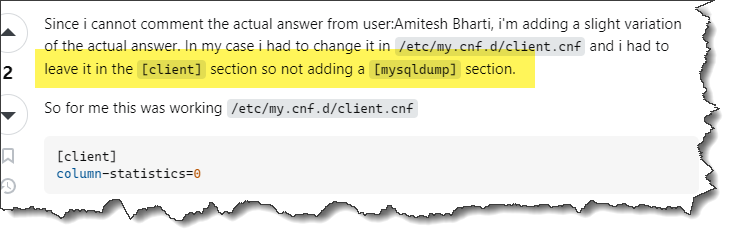

            @simatec ich habe soeben deinen Link durchgelesen, hoffentlich richtig verstanden und umgesetzt.
            "/etc/mysql/my.cnf" editiert
            # The MariaDB configuration file
            # The MariaDB/MySQL tools read configuration files in the following order:
            # 0. "/etc/mysql/my.cnf" symlinks to this file, reason why all the rest is read.
            # 1. "/etc/mysql/mariadb.cnf" (this file) to set global defaults,
            # 2. "/etc/mysql/conf.d/*.cnf" to set global options.
            # 3. "/etc/mysql/mariadb.conf.d/*.cnf" to set MariaDB-only options.
            # 4. "~/.my.cnf" to set user-specific options.
            # If the same option is defined multiple times, the last one will apply.
            # One can use all long options that the program supports.
            # Run program with --help to get a list of available options and with
            # --print-defaults to see which it would actually understand and use.
            # If you are new to MariaDB, check out https://mariadb.com/kb/en/basic-mariadb-articles/
            # This group is read both by the client and the server
            # use it for options that affect everything
            [client-server]
            # Port or socket location where to connect
            # port = 3306
            socket = /run/mysqld/mysqld.sock
            # Import all .cnf files from configuration directory
            !includedir /etc/mysql/conf.d/
            !includedir /etc/mysql/mariadb.conf.d/
            [mysqldump]
            column-statistics=0
            Leider keine Verbesserung, nur das Log liest sich etwas anders:

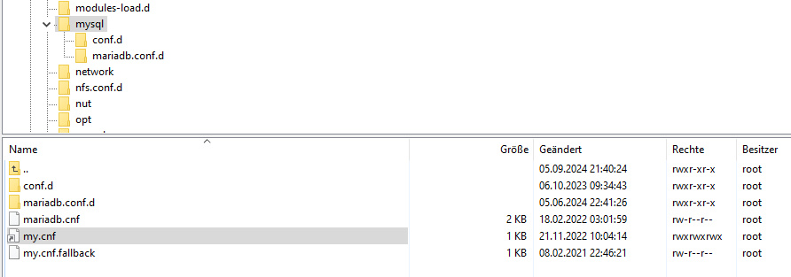

            • Codierknecht
              Codierknecht Developer Most Active @metaxa last edited by
              @metaxa
              Das hast Du auch mal probiert?
              metaxa 1 Reply Last reply Reply Quote 0
              • metaxa
                metaxa @Codierknecht last edited by

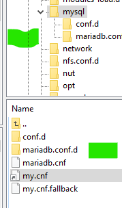

                @codierknecht Ja gelesen, aber dieses File gibt es bei mir nicht:

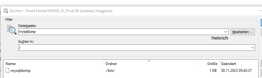

                        Und nochwas, dein Bild:
                        348b29fd-c803-47b6-ba7f-59d1be9ef255-1725569958953-026f2c8a-bb8f-4740-b404-e13fc1eef476-image.png
                        Zeigt aus meiner Sicht, dass es eine mysqldump in /bin gibt, du rufst aber die in /usr/bin auf. Zwei Versionen?
                        Edit: wohl doch eher ein Link.

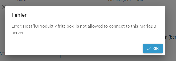

                                          @Marc-Berg neues Problem:
                                          Hat jemand eine Idee?
                                          metaxa Codierknecht 2 Replies Last reply Reply Quote 0
