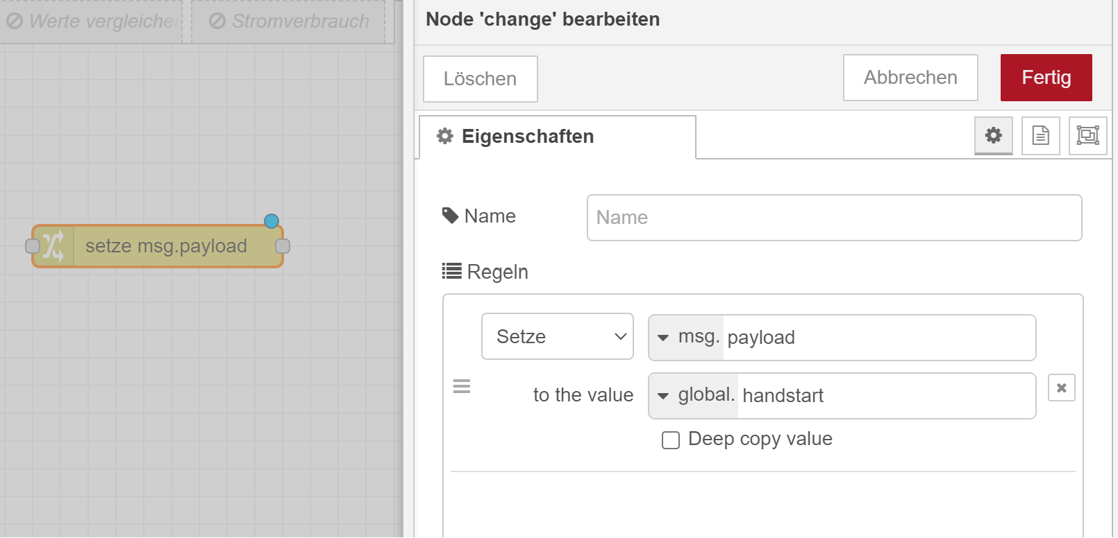

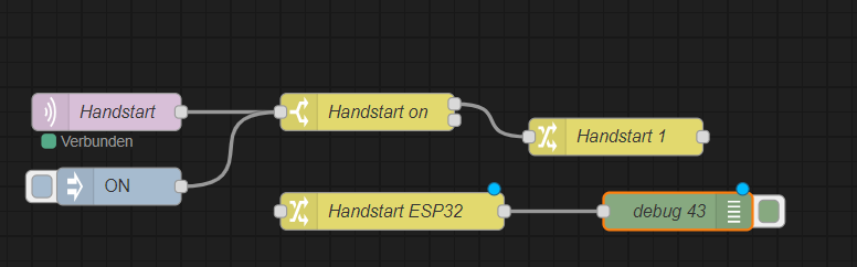

      Ich möchte einen Payload aus einem Flow in einem anderen Flow benutzen. Das funktioniert so weit ich weiß mit einer *.global (Variablen).
      Ich habe das hier mal versucht, aber ich bekomme den Payload nicht an der Debug Node ausgegeben. Wo liegt der Fehler?
      [{"id":"5c4848b5cbcb4807","type":"tab","label":"Flow 2","disabled":false,"info":"","env":[]},{"id":"7927957d53784ef9","type":"mqtt in","z":"5c4848b5cbcb4807","name":"Handstart","topic":"mansteuerung/binary_sensor/handstart/state","qos":"0","datatype":"auto","broker":"d0d69da0d3c24301","nl":false,"rap":true,"rh":0,"inputs":0,"x":100,"y":100,"wires":[["0e1fec3129616b24"]]},{"id":"97ecb4ff335391f1","type":"inject","z":"5c4848b5cbcb4807","name":"","props":[{"p":"payload"},{"p":"topic","vt":"str"}],"repeat":"","crontab":"","once":false,"onceDelay":0.1,"topic":"","payload":"ON","payloadType":"str","x":110,"y":160,"wires":[["0e1fec3129616b24"]]},{"id":"0e1fec3129616b24","type":"switch","z":"5c4848b5cbcb4807","name":"Handstart on","property":"payload","propertyType":"msg","rules":[{"t":"eq","v":"ON","vt":"str"},{"t":"eq","v":"OFF","vt":"str"}],"checkall":"true","repair":false,"outputs":2,"x":310,"y":100,"wires":[["f9479f1f3382de62"],[]]},{"id":"f9479f1f3382de62","type":"change","z":"5c4848b5cbcb4807","name":"Handstart 1","rules":[{"t":"set","p":"handstart","pt":"global","to":"payload","tot":"msg"}],"action":"","property":"","from":"","to":"","reg":false,"x":510,"y":100,"wires":[[]]},{"id":"d319d7659d50330b","type":"change","z":"5c4848b5cbcb4807","name":"Handstart ESP32","rules":[{"t":"set","p":"handstart","pt":"global","to":"payoad","tot":"msg"}],"action":"","property":"","from":"","to":"","reg":false,"x":330,"y":180,"wires":[["8e405ca916549aa3"]]},{"id":"8e405ca916549aa3","type":"debug","z":"5c4848b5cbcb4807","name":"debug 43","active":true,"tosidebar":true,"console":false,"tostatus":false,"complete":"false","statusVal":"","statusType":"auto","x":560,"y":180,"wires":[]},{"id":"d0d69da0d3c24301","type":"mqtt-broker","name":"","broker":"192.168.10.9","port":"1883","clientid":"","autoConnect":true,"usetls":false,"protocolVersion":"4","keepalive":"60","cleansession":true,"autoUnsubscribe":true,"birthTopic":"","birthQos":"0","birthRetain":"false","birthPayload":"","birthMsg":{},"closeTopic":"","closeQos":"0","closeRetain":"false","closePayload":"","closeMsg":{},"willTopic":"","willQos":"0","willRetain":"false","willPayload":"","willMsg":{},"userProps":"","sessionExpiry":""}]

                @derklotz Na in Handstart1 setzt Du die globale Variable richtig.

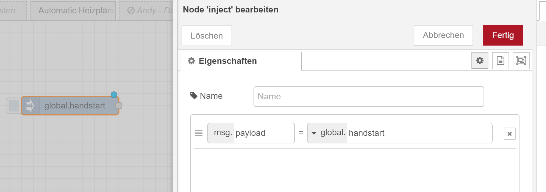

                Im Zielflow musst du dann aber die payload wieder auf die globale Variable setzen,
                aber eine ChangeNode kann nicht triggern. Also entweder holst Du globale Variable über einen Flow mit vorhandenem Trigger oder Du nutzt eine Inject Node oder Scheduler Node.
                Sobald Du aber den anderen Flow auch über den Flow des Quellflows triggern willst ist immer eine Link Node die Wahl.
