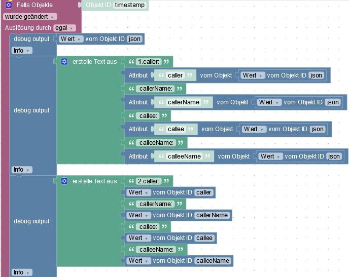

      Also habe ich ein paar Testausgaben ein Blockly eingefügt und den Debug Modus aktiviert.
      Dann habe ich von der Nummer xxxx945 die Nummer xxxx408 angerufen.
      Die FritzBox selber schickt mir eine Email: Anruf von xxxx945 an xxxx408 (richtig)
      In den Debug Ausgaben sind die Rufnummern richtig, nur in den Testausgaben von Blockly sind die Nummern falsch (Zeilen mit "Info")
      debug: tr-064.0 (349569) Callmonitor Raw: 06.10.24 15:50:15;RING;0;xxxx945;xxxx408;SIP5;
      debug: tr-064.0 (349569) New Call data inbound: {"caller":"xxxx945","callee":"xxxx408","timestamp":"06.10.24 15:50:15","id":0}
      debug: tr-064.0 (349569) Search number 0049xxxx945 in phonebook: {"name":"Name945","normalizedName":"name_945","number":"0049xxxx945","id":"96","phonebookId":"0"}
      debug: tr-064.0 (349569) Search number 0049xxxx408 in phonebook: {"name":"Name408","normalizedName":"name_408","number":"0049xxxx408","id":"88","phonebookId":"0"}
      debug: tr-064.0 (349569) callMonitor.set: type=inbound caller=xxxx945 callee=xxxx408 callerName=Name945 calleeName=Name408
      debug: tr-064.0 (349569) State changed: tr-064.0.callmonitor.ringing = {"val":true,"ack":true,"ts":1728222615899,"q":0,"from":"system.adapter.tr-064.0","user":"system.user.admin","lc":1728222615899}
      debug: tr-064.0 (349569) State changed: tr-064.0.callmonitor.inbound.caller = {"val":"xxxx945","ack":true,"ts":1728222615900,"q":0,"from":"system.adapter.tr-064.0","user":"system.user.admin","lc":1728222615900}
      debug: tr-064.0 (349569) State changed: tr-064.0.callmonitor.inbound.callee = {"val":"xxxx408","ack":true,"ts":1728222615900,"q":0,"from":"system.adapter.tr-064.0","user":"system.user.admin","lc":1728222615900}
      debug: tr-064.0 (349569) State changed: tr-064.0.callmonitor.inbound.timestamp = {"val":"06.10.24 15:50:15","ack":true,"ts":1728222615902,"q":0,"from":"system.adapter.tr-064.0","user":"system.user.admin","lc":1728222615902}
      debug: tr-064.0 (349569) State changed: tr-064.0.callmonitor.inbound.id = {"val":0,"ack":true,"ts":1728222615902,"q":0,"from":"system.adapter.tr-064.0","user":"system.user.admin","lc":1728222615902}
      *****bis hier hin sind die Nummern richtig*****
      info: javascript.0 (2478949) script.js.Allgemein.Telefonanruf: {"caller":"xxxx187","callee":"xxxx395","timestamp":"06.10.24 14:53:51","id":2,"_type":"inbound","callerName":"Name187","calleeName":"Name395"}
      info: javascript.0 (2478949) script.js.Allgemein.Telefonanruf: 1.caller:xxxx187 callerName:Name187 callee:xxxx395 calleeName:Name395
      info: javascript.0 (2478949) script.js.Allgemein.Telefonanruf: 2.caller:xxxx945 callerName:Name187 callee:xxxx408 calleeName:Name395
      debug: tr-064.0 (349569) State changed: tr-064.0.callmonitor.inbound.callerName = {"val":"Name945","ack":true,"ts":1728222615906,"q":0,"from":"system.adapter.tr-064.0","user":"system.user.admin","lc":1728222615906}
      debug: tr-064.0 (349569) State changed: tr-064.0.callmonitor.inbound.calleeName = {"val":"Name408","ack":true,"ts":1728222615914,"q":0,"from":"system.adapter.tr-064.0","user":"system.user.admin","lc":1728222615914}

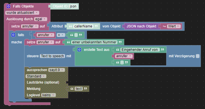

        @martinsu dann wird wohl etwas nicht aktualisiert, probier es mal so

          Ich hatte bei dem Falls Objekte auf den tr-064.0.callmonitor.inbound.timestamp getriggert.
          Aber es macht natürlich Sinn auf die Aktualisierung des json zu triggern, besonders weil man mit dem Übergabewert die frischen Werte von Anrufer und Angerufenen erhält.Wert.jpg

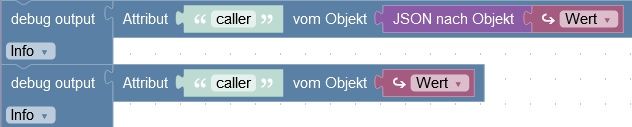

          Ich vermute, dass bei mir die tr-064.0.callmonitor.inbound.callee/calleeName/caller/callerName noch nicht schnell genug aktualisiert wurden.
          Wenn ich jetzt die Werte aus dem übergebenen json auslese, stimmen die Namen und Nummern des Anrufers und des Angerufenen.
          Komischerweise stimmen jetzt auch immer die Werte für tr-064.0.callmonitor.inbound.callee/calleeName/caller/callerName. Wurden die jetzt automatisch mit aktualisiert?
          Nur etwas verstehe ich nicht, warum Du den JSON nach Objekt einfügst?
          Ich sehe das gleiche Ergebnis für

            @martinsu sagte in TR-064 falsche Anrufer Anzeige [gelöst]:
            Weils trigger Objekt ein json ist. Hatte es mal so aus dem Forum.
