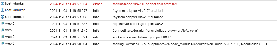

      Hallo, was ist das für eine Fehlermeldung? Was kann ich da machen?
      2024-11-03 11:32:53.538 - debug: homeconnect.0 (151169) Set event state
      2024-11-03 11:33:41.833 - info: host.iobroker "system.adapter.vis-2.0" enabled
      2024-11-03 11:33:42.628 - error: host.iobroker startInstance vis-2.0: cannot find start file!
      2024-11-03 11:33:45.359 - info: solax.0 (1115) State value to set for "solax.0.data.json" has to be type "string" but received type "number"
      2024-11-03 11:33:52.985 - debug: homeconnect.0 (151169) event: {"type":"NOTIFY","data":"{\"haId\":\"SIEMENS-WM14VG93-68A40E9041F2\",\"items\":[{\"handling\":\"none\",\"key\":\"BSH.Common.Option.ProgramProgress\",\"level\":\"hint\",\"timestamp\":1730630032,\"unit\":\"%\",\"uri\":\"/api/homeappliances/SIEMENS-WM14VG93-68A40E9041F2/programs/active/options/BSH.Common.Option.ProgramProgress\",\"value\":12}]}","lastEventId":"SIEMENS-WM14VG93-68A40E9041F2","origin":"https://api.home-connect.com"}
      2024-11-03 11:33:52.985 - debug: homeconnect.0 (151169) SIEMENS-WM14VG93-68A40E9041F2.programs.active.options.BSH_Common_Option_ProgramProgress:12
      2024-11-03 11:33:52.986 - debug: homeconnect.0 (151169) Set event state
      2024-11-03 11:33:53.531 - debug: homeconnect.0 (151169) event: {"type":"NOTIFY","data":"{\"haId\":\"SIEMENS-WM14VG93-68A40E9041F2\",\"items\":[{\"handling\":\"none\",\"key\":\"BSH.Common.Option.RemainingProgramTime\",\"level\":\"hint\",\"timestamp\":1730630033,\"unit\":\"seconds\",\"uri\":\"/api/homeappliances/SIEMENS-WM14VG93-68A40E9041F2/programs/active/options/BSH.Common.Option.RemainingProgramTime\",\"value\":2520}]}","lastEventId":"SIEMENS-WM14VG93-68A40E9041F2","origin":"https://api.home-connect.com"}
      2024-11-03 11:33:53.532 - debug: homeconnect.0 (151169) SIEMENS-WM14VG93-68A40E9041F2.programs.active.options.BSH_Common_Option_RemainingProgramTime:2520
      2024-11-03 11:33:53.533 - debug: homeconnect.0 (151169) Set event state

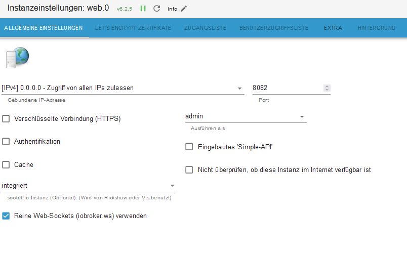

        Adapter Grün? WEB Adapter installiert und konfiguriert?
          TimoWald @sigi234 last edited by
          @sigi234 Adapter wird nicht grün.
          • sigi234
            sigi234 Forum Testing Most Active @TimoWald last edited by
            @timowald
            Haken bei Reine Web-Sockets verwenden mal raus
              @sigi234 Wird auch nicht grün.

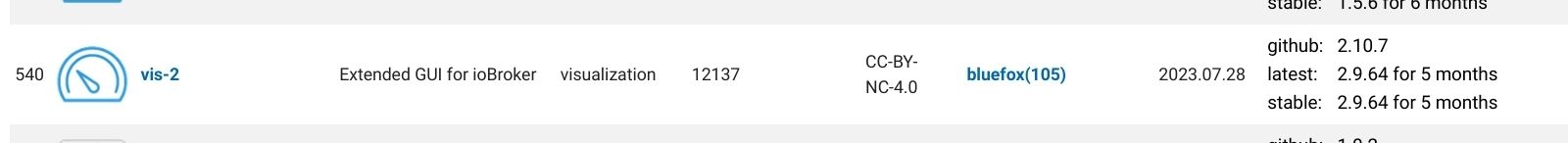

                  @sigi234 Version ist noch die v2.9.44. Bekomme keine andere drauf. Cache wurde schon geleert. Was ist mit Vis2 Uload gemeint?
                    Homoran Global Moderator Administrators @TimoWald last edited by Homoran
                    @timowald sagte in Vis2 Adapter macht Probleme.:
                    warum nicht?
                    erfüllst du irgendwelche Voraussetzungen nicht?

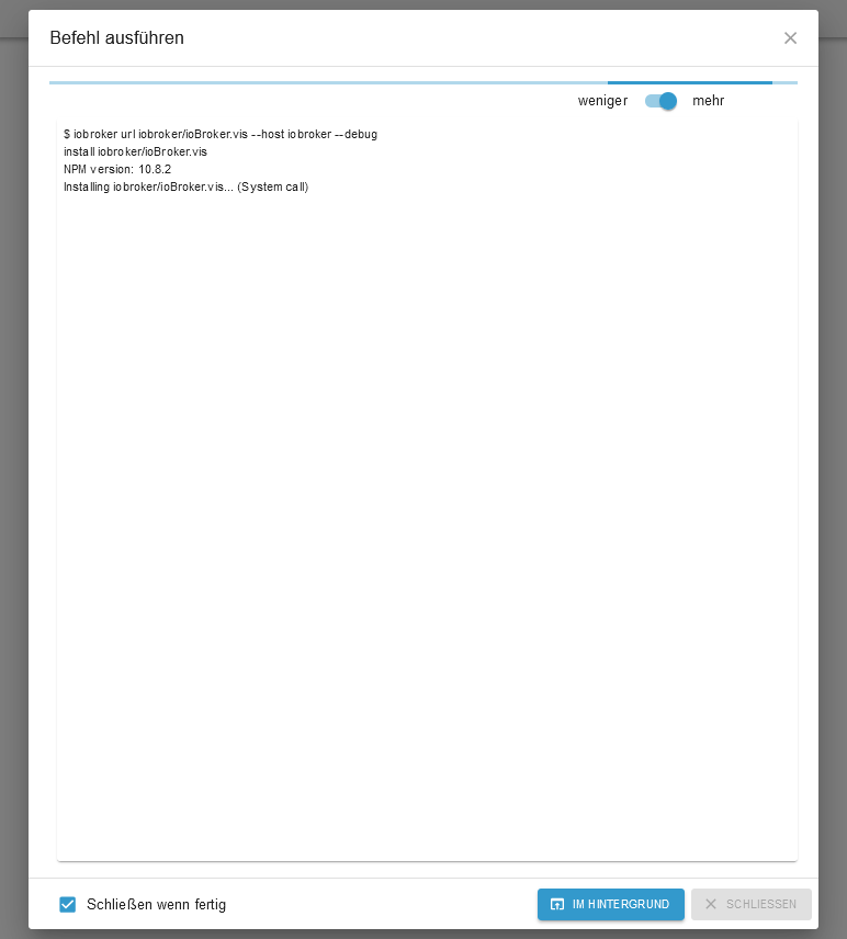

                      TimoWald @Homoran last edited by TimoWald
                      @homoran Wie soll ich sie am besten installieren? Mit Github URL, NMP, etc?
                      An dieser stelle bleibt er stundenlang stehen.

                            Thomas Braun Most Active @TimoWald last edited by
                            Debian 'bullseye' is the current oldstable version. Please upgrade to the latest stable release 'bookworm' in due time!
                            Beizeiten den Container mit Bookkworm / Debian 12 betreiben. Bullseye ist tot.
                            Setz den User 'wald' in die Gruppe 'adm' und 'iobroker' rein.
                            sudo usermod -a -G adm,iobroker wald
                            exit
                            js-controller is not running
                            Warum nicht?
                            +-- iobroker.vis-2@ (git+ssh://git@github.com/ioBroker/ioBroker.vis-2.git#cabeca3a63207dc71df3504865eccfcef2f22097)
                            Warum hantierst du da mit einer Alpha-Version von vis-2 herum?
                            Gleiche gilt für vis1:
                            +-- iobroker.vis@1.5.6 (git+ssh://git@github.com/iobroker/ioBroker.vis.git#8518f7fbadf76519b3c6bceb5a34e298b9257c0a)
                            Pending Updates: 20
                            System auf Stand bringen.
                            iob stop
                            sudo apt update && sudo apt full-upgrade
                            Dann Container neustarten und die stabilen Versionen von vis2 und vis1 installieren.
                                  Und wie installiere ich die stabilen Versionen von Vis2?
                                  iob update
                                  iob upgrade vis@1.5.6
                                  iob upgrade vis-2@2.9.64
                                    TimoWald @Thomas Braun last edited by
                                    @thomas-braun said in Vis2 Adapter macht Probleme.:
                                    Mit diesen Befehlen ist der VIS2 schonmal grün und aktuell.
                                    Jetzt mus ich nur noch rausbekommen wie ich den Container Update.
