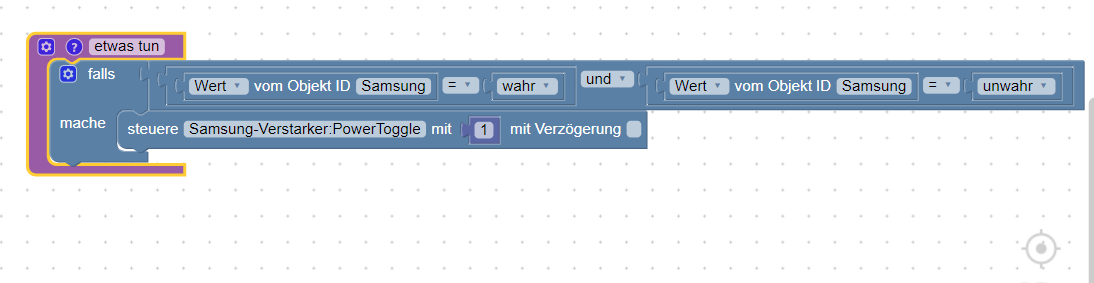

      bin noch etwas unerfahren und versuche mich an Blockly…
      Ein paar Regeln habe ich schon und die funktionieren sogar, nur hier habe ich ein paar Probleme:
      14:00:03.774	[error]	javascript.0 ReferenceError: e is not defined at Request. (script.js.common.Aktion_aus_wenn_nicht_gebraucht:4:116) at emitOne (events.js:96:13) at Request.emit (events.js:188:7) at Request.onRequestError (/opt/iobroker/node_modules/iobroker.javascript/node_modules/request/request.js:878:8) at emitOne (events.js:96:13) at ClientRequest.emit (events.js:188:7) at Socket.socketErrorListener (_http_client.js:309:9) at emitOne (events.js:96:13) at Socket.emit (events.js:188:7) at emitErrorNT (net.js:1277:8)
      14:00:03.774	[error]	javascript.0 ReferenceError: e is not defined at Request. (script.js.common.Aktion_aus_wenn_nicht_gebraucht:4:116) at emitOne (events.js:96:13) at Request.emit (events.js:188:7) at Request.onRequestError (/opt/iobroker/node_modules/iobroker.javascript/node_modules/request/request.js:878:8) at emitOne (events.js:96:13) at ClientRequest.emit (events.js:188:7) at Socket.socketCloseListener (_http_client.js:285:9) at emitOne (events.js:101:20) at Socket.emit (events.js:188:7) at TCP._handle.close [as _onclose] (net.js:497:12)
      14:00:38.603	[info]	javascript.0 Start javascript script.js.common.Aktion_aus_wenn_nicht_gebraucht
      14:00:38.604	[info]	javascript.0 script.js.common.Aktion_aus_wenn_nicht_gebraucht: registered 0 subscriptions and 1 schedule
      14:05:03.772	[error]	javascript.0 ReferenceError: e is not defined at Request. (script.js.common.Aktion_aus_wenn_nicht_gebraucht:4:116) at emitOne (events.js:96:13) at Request.emit (events.js:188:7) at Request.onRequestError (/opt/iobroker/node_modules/iobroker.javascript/node_modules/request/request.js:878:8) at emitOne (events.js:96:13) at ClientRequest.emit (events.js:188:7) at Socket.socketErrorListener (_http_client.js:309:9) at emitOne (events.js:96:13) at Socket.emit (events.js:188:7) at emitErrorNT (net.js:1277:8)
      14:05:03.773	[error]	javascript.0 ReferenceError: e is not defined at Request. (script.js.common.Aktion_aus_wenn_nicht_gebraucht:4:116) at emitOne (events.js:96:13) at Request.emit (events.js:188:7) at Request.onRequestError (/opt/iobroker/node_modules/iobroker.javascript/node_modules/request/request.js:878:8) at emitOne (events.js:96:13) at ClientRequest.emit (events.js:188:7) at Socket.socketCloseListener (_http_client.js:285:9) at emitOne (events.js:101:20) at Socket.emit (events.js:188:7) at TCP._handle.close [as _onclose] (net.js:497:12)
      und noch eine Frage….
      Wenn ich sehr viele Bedingungen habe die abgeprüft werden sollen, klappt das nur wenn ich alles nur in einem String klicke oder kann ich es auch untereinander machen?
      Wenn ich jetzt hier noch 3 Bedingungen mehr habe, wird es für mich was unübersichtlich….

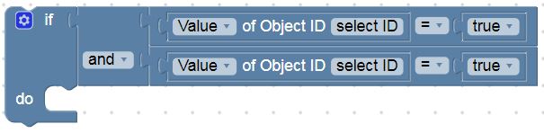

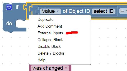

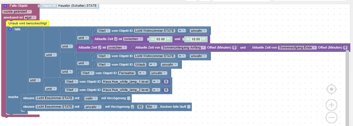

        zur 2ten frage, geht auch so (rechter mausklik auf die abfrage und dan externe eingaenge):

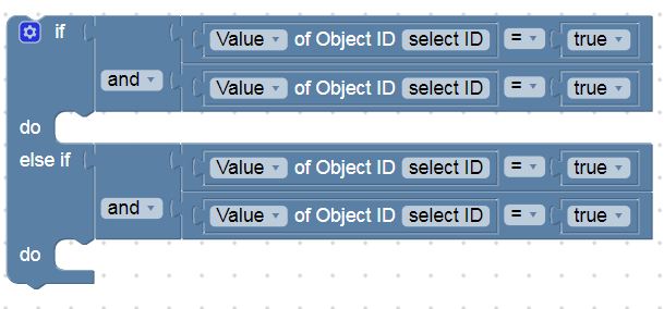

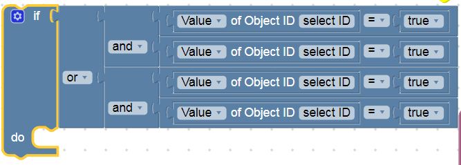

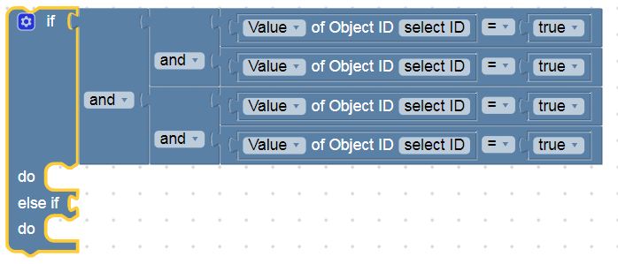

            komt drauf af was du meinst es gehen soviele bedinungen wie du willst, sowas z.b.
            oder so
            sonst wen gibts aber auch ?
