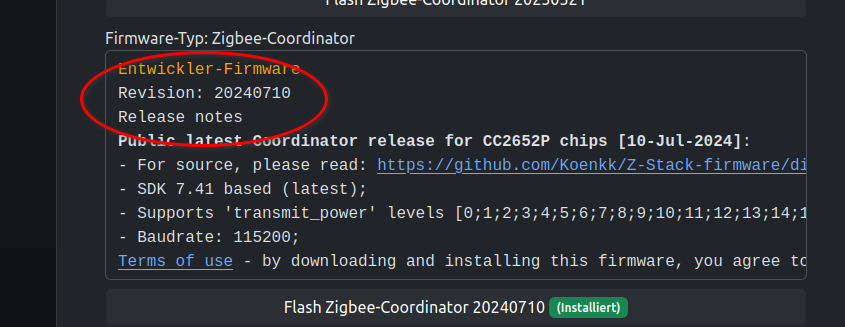

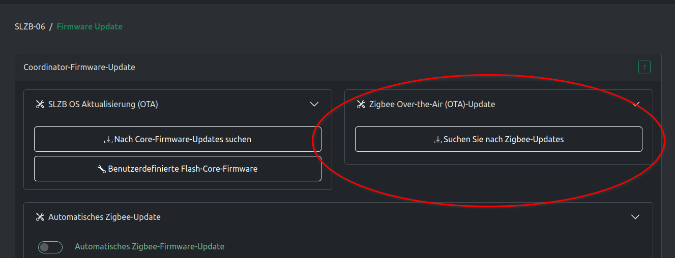

      • I
        iobroker2001 last edited by
        @iobroker2001 sagte in SLZB-06 Kein Update möglich "REQ error: http_code -1":
                                                                                                                                    [00:00:00] setup | Starting firmware: v2.7.1                                                                                                                                                                            [00:00:00] setup | FS mounted                                                                                                                                                                            [00:00:01] ConfigHelper | load config                                                                                                                                                                            [00:00:01] ConfigHelper | config open: Ok                                                                                                                                                                            [00:00:01] setup | Reboot reason: POWERON                                                                                                                                                                            [00:00:01] setup | Coordinator mode: LAN                                                                                                                                                                            [00:00:01] setup | Device type: SLZB-06                                                                                                                                                                            [00:00:01] setup | Radio mode: "ZB COORD" Radio FW version: 20221226 Radio FW CH: PROD                                                                                                                                                                            [00:00:01] Network | init                                                                                                                                                                            [00:00:01] [LEDs init] | status: 1                                                                                                                                                                            [00:00:02] [LEDs init] | done                                                                                                                                                                            [00:00:02] Network | EVENT: 1 - ETH_START                                                                                                                                                                            [00:00:02] Network | EVENT: 3 - ETH_CONNECTED                                                                                                                                                                            [00:00:02] Network | EVENT: 5 - ETH_GOT_IP                                                                                                                                                                            [00:00:02] Network | [MDNS] Started                                                                                                                                                                            [00:00:02] Network | ETH init: OK                                                                                                                                                                            [00:00:02] Network | ETH MAC: 20:43:A8:65:B9:7B IPv4: 192.168.178.75 GW: 192.168.178.1 Speed: 100Mbps DNS1: 192.168.178.21 DNS2: 0.0.0.0                                                                                                                                                                            [00:00:02] Network | fireNetworkUp                                                                                                                                                                            [00:00:02] taskZB | Starting server on port: 6638                                                                                                                                                                            [00:00:02] EventSender | [_handleTask] start task                                                                                                                                                                            [00:00:02] Web | Webserver init done                                                                                                                                                                            [00:00:02] time | time sync start                                                                                                                                                                            [00:00:02] setup | Filesystem size: 3456                                                                                                                                                                            [00:00:02] setup | Filesystem used: 184                                                                                                                                                                            [00:00:02] setup | done                                                                                                                                                                            [00:00:02] internet | connected                                                                                                                                                                            [00:00:04] Network | EVENT: 7 - ETH_GOT_IP6                                                                                                                                                                            [00:00:04] Network | ETH IPv6 - Link-local IPv6: fe80::2243:a8ff:fe65:b97b Global: :: DNS1: 192.168.178.21 DNS2: 0.0.0.0                                                                                                                                                                            [11:01:21] time | timezone: CET-1CEST,M3.5.0,M10.5.0/3                                                                                                                                                                            [11:01:21] time | Monday, February 03 2025 11:01:21                                                                                                                                                                            [11:01:21] zbSelfOta | start task                                                                                                                                                                            [11:01:21] taskTimeSync | Heap: 1148                                                                                                                                                                            [11:01:21] time | stop task                                                                                                                                                                            [11:01:22] EventSender | [_handleNewClient] new client: 192.168.178.20                                                                                                                                                                            [11:01:24] Network | EVENT: 7 - ETH_GOT_IP6                                                                                                                                                                            [11:01:24] Network | ETH IPv6 - Link-local IPv6: fe80::2243:a8ff:fe65:b97b Global: 2001:9e8:4b01:9b00:2243:a8ff:fe65:b97b DNS1: 2001:9e8:4b23:6600:7695:bd9a:4575:d126 DNS2: 0.0.0.0                                                                                                                                                                            [11:01:24] Network | EVENT: 7 - ETH_GOT_IP6                                                                                                                                                                            [11:01:24] Network | ETH IPv6 - Link-local IPv6: fe80::2243:a8ff:fe65:b97b Global: 2001:9e8:4b01:9b00:2243:a8ff:fe65:b97b DNS1: 2001:9e8:4b23:6600:7695:bd9a:4575:d126 DNS2: 0.0.0.0                                                                                                                                                                            [11:01:35] ConfigHelper | write config                                                                                                                                                                            [11:01:35] ConfigHelper | config saved                                                                                                                                                                            [11:01:40] zb ota task | Starting OTA | local: 0 fwBaud: 115200 zbVer: 20240710 zbType: 0 zbChip: 0 zbChipNum: -1 fwUrl: https://updates.smlight.tech/firmware/slzb06x/zigbee/slzb06/CC1352P2_CC2652P_other_coordinator_20240710.bin                                                                                                                                                                            [11:01:58] zb ota task | OTA task failed!                                                                                                                                                                            [11:01:58] zb ota task | Heap: 3272                                                                                                                                                                            [11:05:03] ConfigHelper | write config                                                                                                                                                                            [11:05:03] ConfigHelper | config saved                                                                                                                                                                            [11:05:07] zb ota task | Starting OTA | local: 0 fwBaud: 115200 zbVer: 20240710 zbType: 0 zbChip: 0 zbChipNum: -1 fwUrl: https://updates.smlight.tech/firmware/slzb06x/zigbee/slzb06/CC1352P2_CC2652P_other_coordinator_20240710.bin                                                                                                                                                                            [11:05:26] zb ota task | OTA task failed!                                                                                                                                                                            [11:05:26] zb ota task | Heap: 3448                                                                                                                                                                            [11:08:25] EventSender | [_handleNewClient] new client: 192.168.178.20                                                                                                                                                                            [11:11:06] ConfigHelper | write config                                                                                                                                                                            [11:11:06] ConfigHelper | config saved                                                                                                                                                                            [11:11:17] zb ota task | Starting OTA | local: 0 fwBaud: 115200 zbVer: 20240710 zbType: 0 zbChip: 0 zbChipNum: -1 fwUrl: https://updates.smlight.tech/firmware/slzb06x/zigbee/slzb06/CC1352P2_CC2652P_other_coordinator_20240710.bin                                                                                                                                                                            [11:11:36] zb ota task | OTA task failed!                                                                                                                                                                            [11:11:36] zb ota task | Heap: 3496                                                                                                                                                                            [11:11:54] ConfigHelper | write config                                                                                                                                                                            [11:11:54] ConfigHelper | config saved                                                                                                                                                                            [11:11:57] zb ota task | Starting OTA | local: 0 fwBaud: 115200 zbVer: 20240710 zbType: 0 zbChip: 0 zbChipNum: -1 fwUrl: https://updates.smlight.tech/firmware/slzb06x/zigbee/slzb06/CC1352P2_CC2652P_other_coordinator_20240710.bin                                                                                                                                                                            [11:12:16] zb ota task | OTA task failed!                                                                                                                                                                            [11:12:16] zb ota task | Heap: 3416
        Problem hat sich erledigt, habe eine OTA.bin-Datei heruntergeladen und neu geflasht.

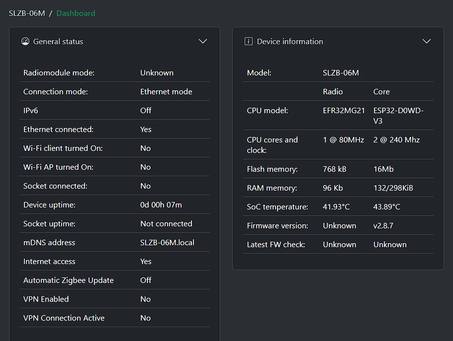

          Markus 7 @iobroker2001 last edited by
          @iobroker2001
          Grüß dich,
          ich habe mit dem SLZB-06M Stick das gleiche Problem. Den Status "Internet" zeigt er wohl an, nach dem Updateversuch der FW kommt jedoch nach ein paar Sekunden auch der Fehler "REQ error: http_code -1". Uhrzeitaktualisierung funzt bei mir auch nicht.
          Habe schon einiges ausprobiert, die Core-SLZB-FW über USB auf die aktuelle Version v2.8.7 aktualisiert, nur finde ich nirgends eine Download-Quelle für die "Radio [EFR32MG21] Mode" Firmware für den Betrieb als Zigbee Coordinator.
          Kannst du mir sagen, wo die die Firmware heruntergeladen hast?
          Viele Grüße
          Markus
          • I
            iobroker2001 @Markus 7 last edited by
            @markus-7 sagte in [gelöst]SLZB-06 Kein Update möglich "REQ error: ....":
            Ich hoffe, ich erinnere mich noch richtig, aber diesen Teil konnte ich (so meine ich) über OTA machen:
            In der dann folgenden Liste ziemlich weit nach unten scrollen, bis Du das siehst und das dann installieren:
              @iobroker2001
              Danke dir, bei mir sieht die Liste inzwischen anders aus, auch sind keine verlinkten Seiten mehr enthalten.
              Ich konnte jetzt den Fehler dadurch umgehen, indem ich mich ins Gast-WLAN eingeloggt habe. Komischerweise habe ich dort direkt das FW-Update durchführen können.
              In meinen LAN-NW habe ich schon alles Mögliche und Unmögliche probiert, eigene und offen DNS -Server probiert, unterschiedliche Switches, Mit POE und Strom über USB ... alles nicht erfolgreich.
