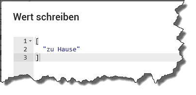

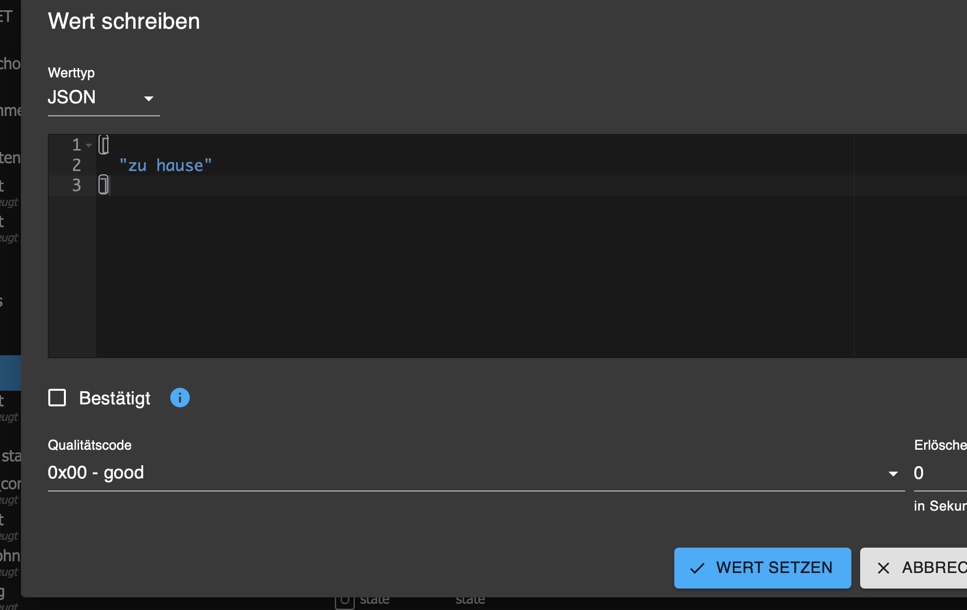

                        ticaki Developer @Ben1983 last edited by
                        @ben1983
                        und wenn du das editieren willst im State schaut es so aus?
                        Ben1983 1 Reply Last reply Reply Quote 0
                        • Ben1983
                          Ben1983 @ticaki last edited by
                          @ticaki Ganz genau.

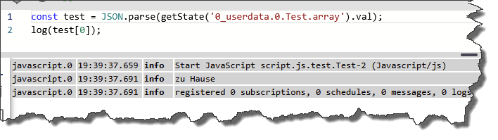

                              • Codierknecht
                                Codierknecht Developer Most Active @Ben1983 last edited by
                                @ben1983
                                Geht auch mit string:
                                  "common": {
                                    "name": "array",
                                    "desc": "Manuell erzeugt",
                                    "role": "json",
                                    "type": "string",
                                    "read": true,
                                    "write": true
                                  "type": "state",
                                  "native": {},
                                  "_id": "0_userdata.0.Test.array",
                                  "acl": {
                                    "object": 1636,
                                    "state": 1636,
                                    "owner": "system.user.admin",
                                    "ownerGroup": "system.group.administrator"
                                  "from": "system.adapter.admin.0",
                                  "user": "system.user.admin",
                                  "ts": 1740681459150
