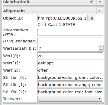

          pix last edited by
          Hallo Drao,
          Du kannst ein Basic HTML valuelist 8- Widget nehmen. Unter 0 dann den zu Zustand "designen"
          Dann bei 1 das gleich mit rot und Zustand zu Icon eintragen. Oid ist der türfensterkontakt. Bei einem RHS sind es die Zustände 0 1 und 2\.
          Sorry, etwas holprig mit Tapatalk auf dem iPhone.

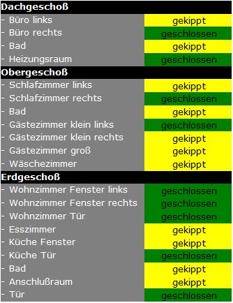

              tesso last edited by
              Bei mir sieht es so aus:
                          Die "Tabelle" habe ich händisch erstellt.
                          Hier der Code
                          [{"tpl":"tplValueListHtml8","data":{"oid":"hm-rpc.0.LEQ1249340.1.STATE","visibility-cond":"==","visibility-val":1,"count":"2","value0":"geschlossen","value1":"gekippt","value2":"offen","style0":"background-color:green; color:black; padding:1px","style1":"background-color:yellow; color:black; padding:1px","style2":"background-color:red; color:black; padding:1px","test_list":null},"style":{"left":"315px","top":"210px","height":"15px","text-align":"center","font-weight":"","font-size":"x-small","font-variant":"","font-style":"","font-family":"Verdana, Geneva, sans-serif"},"widgetSet":"basic"},{"tpl":"tplHtmlNav","data":{"visibility-cond":"==","visibility-val":1,"html":"Dachgeschoß"},"style":{"left":"150px","top":"195px","width":"265px","height":"15px","font-style":"","font-family":"Verdana, Geneva, sans-serif","font-size":"x-small","font-weight":"bolder","background":"black","color":"white"},"widgetSet":"basic"},{"tpl":"tplHtmlNav","data":{"visibility-cond":"==","visibility-val":1,"html":"- Büro links"},"style":{"left":"150px","top":"210px","height":"15px","font-style":"","font-family":"Verdana, Geneva, sans-serif","font-size":"x-small","width":"165px","background":"grey","color":"white"},"widgetSet":"basic"},{"tpl":"tplHtmlNav","data":{"visibility-cond":"==","visibility-val":1,"html":"- Büro rechts"},"style":{"left":"150px","top":"225px","height":"15px","font-style":"","font-family":"Verdana, Geneva, sans-serif","font-size":"x-small","width":"165px","color":"white","background":"grey"},"widgetSet":"basic"},{"tpl":"tplHtmlNav","data":{"visibility-cond":"==","visibility-val":1,"html":"- Bad"},"style":{"left":"150px","top":"240px","height":"15px","font-style":"","font-family":"Verdana, Geneva, sans-serif","font-size":"x-small","width":"165px","color":"white","background":"grey"},"widgetSet":"basic"},{"tpl":"tplHtmlNav","data":{"visibility-cond":"==","visibility-val":1,"html":"- Heizungsraum"},"style":{"left":"150px","top":"255px","height":"15px","font-style":"","font-family":"Verdana, Geneva, sans-serif","font-size":"x-small","width":"165px","color":"white","background":"grey"},"widgetSet":"basic"},{"tpl":"tplHtmlNav","data":{"visibility-cond":"==","visibility-val":1,"html":"- Gästezimmer klein links"},"style":{"left":"150px","top":"330px","height":"15px","font-style":"","font-family":"Verdana, Geneva, sans-serif","font-size":"x-small","width":"165px","color":"white","background":"grey"},"widgetSet":"basic"},{"tpl":"tplHtmlNav","data":{"visibility-cond":"==","visibility-val":1,"html":"Obergeschoß"},"style":{"left":"150px","top":"270px","width":"265px","height":"15px","font-style":"","font-family":"Verdana, Geneva, sans-serif","font-size":"x-small","font-weight":"bolder","background":"black","color":"white"},"widgetSet":"basic"},{"tpl":"tplHtmlNav","data":{"visibility-cond":"==","visibility-val":1,"html":"- Schlafzimmer links"},"style":{"left":"150px","top":"285px","height":"15px","font-style":"","font-family":"Verdana, Geneva, sans-serif","font-size":"x-small","width":"165px","color":"white","background":"grey"},"widgetSet":"basic"},{"tpl":"tplHtmlNav","data":{"visibility-cond":"==","visibility-val":1,"html":"- Schlafzimmer rechts"},"style":{"left":"150px","top":"300px","height":"15px","font-style":"","font-family":"Verdana, Geneva, sans-serif","font-size":"x-small","width":"165px","color":"white","background":"grey"},"widgetSet":"basic"},{"tpl":"tplHtmlNav","data":{"visibility-cond":"==","visibility-val":1,"html":"- Bad"},"style":{"left":"150px","top":"315px","height":"15px","font-style":"","font-family":"Verdana, Geneva, sans-serif","font-size":"x-small","width":"165px","color":"white","background":"grey"},"widgetSet":"basic"},{"tpl":"tplHtmlNav","data":{"visibility-cond":"==","visibility-val":1,"html":"- Wäschezimmer"},"style":{"left":"150px","top":"375px","height":"15px","font-style":"","font-family":"Verdana, Geneva, sans-serif","font-size":"x-small","width":"165px","color":"white","background":"grey"},"widgetSet":"basic"},{"tpl":"tplHtmlNav","data":{"visibility-cond":"==","visibility-val":1,"html":"- Gästezimmer klein rechts"},"style":{"left":"150px","top":"345px","height":"15px","font-style":"","font-family":"Verdana, Geneva, sans-serif","font-size":"x-small","width":"165px","color":"white","background":"grey"},"widgetSet":"basic"},{"tpl":"tplHtmlNav","data":{"visibility-cond":"==","visibility-val":1,"html":"- Gästezimmer groß"},"style":{"left":"150px","top":"360px","height":"15px","font-style":"","font-family":"Verdana, Geneva, sans-serif","font-size":"x-small","width":"165px","color":"white","background":"grey"},"widgetSet":"basic"},{"tpl":"tplHtmlNav","data":{"visibility-cond":"==","visibility-val":1,"html":"Erdgeschoß"},"style":{"left":"150px","top":"390px","height":"15px","font-style":"","font-family":"Verdana, Geneva, sans-serif","font-size":"x-small","width":"265px","font-weight":"bolder","background":"black","color":"white"},"widgetSet":"basic"},{"tpl":"tplHtmlNav","data":{"visibility-cond":"==","visibility-val":1,"html":"- Wohnzimmer Tür"},"style":{"left":"150px","top":"435px","height":"15px","font-style":"","font-family":"Verdana, Geneva, sans-serif","font-size":"x-small","width":"165px","color":"white","background":"grey"},"widgetSet":"basic"},{"tpl":"tplHtmlNav","data":{"visibility-cond":"==","visibility-val":1,"html":"- Wohnzimmer Fenster links"},"style":{"left":"150px","top":"405px","height":"15px","font-style":"","font-family":"Verdana, Geneva, sans-serif","font-size":"x-small","width":"165px","color":"white","background":"grey"},"widgetSet":"basic"},{"tpl":"tplHtmlNav","data":{"visibility-cond":"==","visibility-val":1,"html":"- Esszimmer"},"style":{"left":"150px","top":"450px","height":"15px","font-style":"","font-family":"Verdana, Geneva, sans-serif","font-size":"x-small","width":"165px","color":"white","background":"grey"},"widgetSet":"basic"},{"tpl":"tplHtmlNav","data":{"visibility-cond":"==","visibility-val":1,"html":"- Küche Fenster"},"style":{"left":"150px","top":"465px","height":"15px","font-style":"","font-family":"Verdana, Geneva, sans-serif","font-size":"x-small","width":"165px","color":"white","background":"grey"},"widgetSet":"basic"},{"tpl":"tplHtmlNav","data":{"visibility-cond":"==","visibility-val":1,"html":"- Wohnzimmer Fenster rechts"},"style":{"left":"150px","top":"420px","height":"15px","font-style":"","font-family":"Verdana, Geneva, sans-serif","font-size":"x-small","width":"165px","color":"white","background":"grey"},"widgetSet":"basic"},{"tpl":"tplHtmlNav","data":{"visibility-cond":"==","visibility-val":1,"html":"- Küche Tür"},"style":{"left":"150px","top":"480px","height":"15px","font-style":"","font-family":"Verdana, Geneva, sans-serif","font-size":"x-small","width":"165px","color":"white","background":"grey"},"widgetSet":"basic"},{"tpl":"tplHtmlNav","data":{"visibility-cond":"==","visibility-val":1,"html":"- Bad"},"style":{"left":"150px","top":"495px","height":"15px","font-style":"","font-family":"Verdana, Geneva, sans-serif","font-size":"x-small","width":"165px","color":"white","background":"grey"},"widgetSet":"basic"},{"tpl":"tplHtmlNav","data":{"visibility-cond":"==","visibility-val":1,"html":"- Anschlußraum"},"style":{"left":"150px","top":"510px","height":"15px","font-style":"","font-family":"Verdana, Geneva, sans-serif","font-size":"x-small","width":"165px","color":"white","background":"grey"},"widgetSet":"basic"},{"tpl":"tplHtmlNav","data":{"visibility-cond":"==","visibility-val":1,"html":"- Tür"},"style":{"left":"150px","top":"525px","height":"15px","font-style":"","font-family":"Verdana, Geneva, sans-serif","font-size":"x-small","width":"165px","color":"white","background":"grey"},"widgetSet":"basic"},{"tpl":"tplValueListHtml8","data":{"oid":"hm-rpc.0.LEQ1249341.1.STATE","visibility-cond":"==","visibility-val":1,"count":"2","value0":"geschlossen","value1":"gekippt","value2":"offen","style0":"background-color:green; color:black; padding:1px","style1":"background-color:yellow; color:black; padding:1px","test_list":"","style2":"background-color:red; color:black; padding:1px"},"style":{"left":"315px","top":"225px","height":"15px","text-align":"center","font-weight":"","font-size":"x-small","font-variant":"","font-style":"","font-family":"Verdana, Geneva, sans-serif","width":"100px"},"widgetSet":"basic"},{"tpl":"tplValueListHtml8","data":{"oid":"hm-rpc.0.LEQ0629760.1.STATE","visibility-cond":"==","visibility-val":1,"count":"2","value0":"geschlossen","value1":"gekippt","value2":"offen","style0":"background-color:green; color:black; padding:1px","style1":"background-color:yellow; color:black; padding:1px","test_list":null,"style2":"background-color:red; color:black; padding:1px"},"style":{"left":"315px","top":"240px","height":"15px","text-align":"center","font-weight":"","font-size":"x-small","font-variant":"","font-style":"","font-family":"Verdana, Geneva, sans-serif"},"widgetSet":"basic"},{"tpl":"tplValueListHtml8","data":{"oid":"hm-rpc.0.LEQ1467052.1.STATE","visibility-cond":"==","visibility-val":1,"count":"1","value0":"geschlossen","value1":"offen","value2":"offen","style0":"background-color:green; color:black; padding:1px","style1":"background-color:red; color:black; padding:1px","test_list":null,"style2":"background-color:red; color:black; padding:1px"},"style":{"left":"315px","top":"255px","height":"15px","text-align":"center","font-weight":"","font-size":"x-small","font-variant":"","font-style":"","font-family":"Verdana, Geneva, sans-serif"},"widgetSet":"basic"},{"tpl":"tplValueListHtml8","data":{"oid":"hm-rpc.0.LEQ1249117.1.STATE","visibility-cond":"==","visibility-val":1,"count":"2","value0":"geschlossen","value1":"gekippt","value2":"offen","style0":"background-color:green; color:black; padding:1px","style1":"background-color:yellow; color:black; padding:1px","test_list":null,"style2":"background-color:red; color:black; padding:1px"},"style":{"left":"315px","top":"285px","height":"15px","text-align":"center","font-weight":"","font-size":"x-small","font-variant":"","font-style":"","font-family":"Verdana, Geneva, sans-serif"},"widgetSet":"basic"},{"tpl":"tplValueListHtml8","data":{"oid":"hm-rpc.0.LEQ1249306.1.STATE","visibility-cond":"==","visibility-val":1,"count":"2","value0":"geschlossen","value1":"gekippt","value2":"offen","style0":"background-color:green; color:black; padding:1px","style1":"background-color:yellow; color:black; padding:1px","test_list":null,"style2":"background-color:red; color:black; padding:1px"},"style":{"left":"315px","top":"300px","height":"15px","text-align":"center","font-weight":"","font-size":"x-small","font-variant":"","font-style":"","font-family":"Verdana, Geneva, sans-serif"},"widgetSet":"basic"},{"tpl":"tplValueListHtml8","data":{"oid":"hm-rpc.0.LEQ1249438.1.STATE","visibility-cond":"==","visibility-val":1,"count":"2","value0":"geschlossen","value1":"gekippt","value2":"offen","style0":"background-color:green; color:black; padding:1px","style1":"background-color:yellow; color:black; padding:1px","test_list":null,"style2":"background-color:red; color:black; padding:1px"},"style":{"left":"315px","top":"345px","height":"15px","text-align":"center","font-weight":"","font-size":"x-small","font-variant":"","font-style":"","font-family":"Verdana, Geneva, sans-serif"},"widgetSet":"basic"},{"tpl":"tplValueListHtml8","data":{"oid":"hm-rpc.0.LEQ1248740.1.STATE","visibility-cond":"==","visibility-val":1,"count":"2","value0":"geschlossen","value1":"gekippt","value2":"offen","style0":"background-color:green; color:black; padding:1px","style1":"background-color:yellow; color:black; padding:1px","test_list":null,"style2":"background-color:red; color:black; padding:1px"},"style":{"left":"315px","top":"330px","height":"15px","text-align":"center","font-weight":"","font-size":"x-small","font-variant":"","font-style":"","font-family":"Verdana, Geneva, sans-serif"},"widgetSet":"basic"},{"tpl":"tplValueListHtml8","data":{"oid":"hm-rpc.0.LEQ1249122.1.STATE","visibility-cond":"==","visibility-val":1,"count":"2","value0":"geschlossen","value1":"gekippt","value2":"offen","style0":"background-color:green; color:black; padding:1px","style1":"background-color:yellow; color:black; padding:1px","test_list":null,"style2":"background-color:red; color:black; padding:1px"},"style":{"left":"315px","top":"315px","height":"15px","text-align":"center","font-weight":"","font-size":"x-small","font-variant":"","font-style":"","font-family":"Verdana, Geneva, sans-serif"},"widgetSet":"basic"},{"tpl":"tplValueListHtml8","data":{"oid":"hm-rpc.0.LEQ0630717.1.STATE","visibility-cond":"==","visibility-val":1,"count":"2","value0":"geschlossen","value1":"gekippt","value2":"offen","style0":"background-color:green; color:black; padding:1px","style1":"background-color:yellow; color:black; padding:1px","test_list":null,"style2":"background-color:red; color:black; padding:1px"},"style":{"left":"315px","top":"405px","height":"15px","text-align":"center","font-weight":"","font-size":"x-small","font-variant":"","font-style":"","font-family":"Verdana, Geneva, sans-serif"},"widgetSet":"basic"},{"tpl":"tplValueListHtml8","data":{"oid":"hm-rpc.0.LEQ1249006.1.STATE","visibility-cond":"==","visibility-val":1,"count":"2","value0":"geschlossen","value1":"gekippt","value2":"offen","style0":"background-color:green; color:black; padding:1px","style1":"background-color:yellow; color:black; padding:1px","test_list":null,"style2":"background-color:red; color:black; padding:1px"},"style":{"left":"315px","top":"375px","height":"15px","text-align":"center","font-weight":"","font-size":"x-small","font-variant":"","font-style":"","font-family":"Verdana, Geneva, sans-serif"},"widgetSet":"basic"},{"tpl":"tplValueListHtml8","data":{"oid":"hm-rpc.0.LEQ1248500.1.STATE","visibility-cond":"==","visibility-val":1,"count":"2","value0":"geschlossen","value1":"gekippt","value2":"offen","style0":"background-color:green; color:black; padding:1px","style1":"background-color:yellow; color:black; padding:1px","test_list":null,"style2":"background-color:red; color:black; padding:1px"},"style":{"left":"315px","top":"360px","height":"15px","text-align":"center","font-weight":"","font-size":"x-small","font-variant":"","font-style":"","font-family":"Verdana, Geneva, sans-serif"},"widgetSet":"basic"},{"tpl":"tplValueListHtml8","data":{"oid":"hm-rpc.0.KEQ0848388.1.STATE","visibility-cond":"==","visibility-val":1,"count":"2","value0":"geschlossen","value1":"gekippt","value2":"offen","style0":"background-color:green; color:black; padding:1px","style1":"background-color:yellow; color:black; padding:1px","test_list":null,"style2":"background-color:red; color:black; padding:1px"},"style":{"left":"315px","top":"450px","height":"15px","text-align":"center","font-weight":"","font-size":"x-small","font-variant":"","font-style":"","font-family":"Verdana, Geneva, sans-serif"},"widgetSet":"basic"},{"tpl":"tplValueListHtml8","data":{"oid":"hm-rpc.0.LEQ1249372.1.STATE","visibility-cond":"==","visibility-val":1,"count":"2","value0":"geschlossen","value1":"gekippt","value2":"offen","style0":"background-color:green; color:black; padding:1px","style1":"background-color:yellow; color:black; padding:1px","test_list":null,"style2":"background-color:red; color:black; padding:1px"},"style":{"left":"315px","top":"435px","height":"15px","text-align":"center","font-weight":"","font-size":"x-small","font-variant":"","font-style":"","font-family":"Verdana, Geneva, sans-serif"},"widgetSet":"basic"},{"tpl":"tplValueListHtml8","data":{"oid":"hm-rpc.0.LEQ1249315.1.STATE","visibility-cond":"==","visibility-val":1,"count":"2","value0":"geschlossen","value1":"gekippt","value2":"offen","style0":"background-color:green; color:black; padding:1px","style1":"background-color:yellow; color:black; padding:1px","test_list":null,"style2":"background-color:red; color:black; padding:1px"},"style":{"left":"315px","top":"420px","height":"15px","text-align":"center","font-weight":"","font-size":"x-small","font-variant":"","font-style":"","font-family":"Verdana, Geneva, sans-serif"},"widgetSet":"basic"},{"tpl":"tplValueListHtml8","data":{"oid":"hm-rpc.0.LEQ1249569.1.STATE","visibility-cond":"==","visibility-val":1,"count":"2","value0":"geschlossen","value1":"gekippt","value2":"offen","style0":"background-color:green; color:black; padding:1px","style1":"background-color:yellow; color:black; padding:1px","test_list":null,"style2":"background-color:red; color:black; padding:1px"},"style":{"left":"315px","top":"465px","height":"15px","text-align":"center","font-weight":"","font-size":"x-small","font-variant":"","font-style":"","font-family":"Verdana, Geneva, sans-serif"},"widgetSet":"basic"},{"tpl":"tplValueListHtml8","data":{"oid":"hm-rpc.0.LEQ1254226.1.STATE","visibility-cond":"==","visibility-val":1,"count":"2","value0":"geschlossen","value1":"gekippt","value2":"offen","style0":"background-color:green; color:black; padding:1px","style1":"background-color:yellow; color:black; padding:1px","test_list":null,"style2":"background-color:red; color:black; padding:1px"},"style":{"left":"315px","top":"510px","height":"15px","text-align":"center","font-weight":"","font-size":"x-small","font-variant":"","font-style":"","font-family":"Verdana, Geneva, sans-serif"},"widgetSet":"basic"},{"tpl":"tplValueListHtml8","data":{"oid":"hm-rpc.0.LEQ1253267.1.STATE","visibility-cond":"==","visibility-val":1,"count":"2","value0":"geschlossen","value1":"gekippt","value2":"offen","style0":"background-color:green; color:black; padding:1px","style1":"background-color:yellow; color:black; padding:1px","test_list":null,"style2":"background-color:red; color:black; padding:1px"},"style":{"left":"315px","top":"495px","height":"15px","text-align":"center","font-weight":"","font-size":"x-small","font-variant":"","font-style":"","font-family":"Verdana, Geneva, sans-serif"},"widgetSet":"basic"},{"tpl":"tplValueListHtml8","data":{"oid":"hm-rpc.0.LEQ1250064.1.STATE","visibility-cond":"==","visibility-val":1,"count":"2","value0":"geschlossen","value1":"gekippt","value2":"offen","style0":"background-color:green; color:black; padding:1px","style1":"background-color:yellow; color:black; padding:1px","test_list":null,"style2":"background-color:red; color:black; padding:1px"},"style":{"left":"315px","top":"480px","height":"15px","text-align":"center","font-weight":"","font-size":"x-small","font-variant":"","font-style":"","font-family":"Verdana, Geneva, sans-serif"},"widgetSet":"basic"},{"tpl":"tplValueListHtml8","data":{"oid":"hm-rpc.0.MEQ0175436.1.STATE","visibility-cond":"==","visibility-val":1,"count":"1","value0":"geschlossen","value1":"offen","value2":"offen","style0":"background-color:green; color:black; padding:1px","style1":"background-color:red; color:black; padding:1px","test_list":null,"style2":"background-color:red; color:black; padding:1px"},"style":{"left":"315px","top":"525px","height":"15px","text-align":"center","font-weight":"","font-size":"x-small","font-variant":"","font-style":"","font-family":"Verdana, Geneva, sans-serif"},"widgetSet":"basic"}]

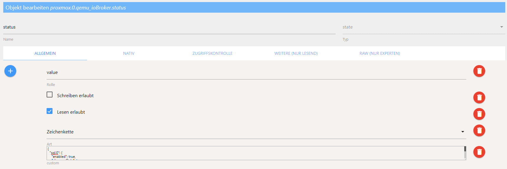

                                          Homoran Global Moderator Administrators @Segway last edited by
                                          @Segway
                                          Wie sieht der dazugehörige Datenpunkt aus?
                                          Rainer
                                          • Segway
                                            Ich denke mal du meinst diesen Datenpunkt oder ?
