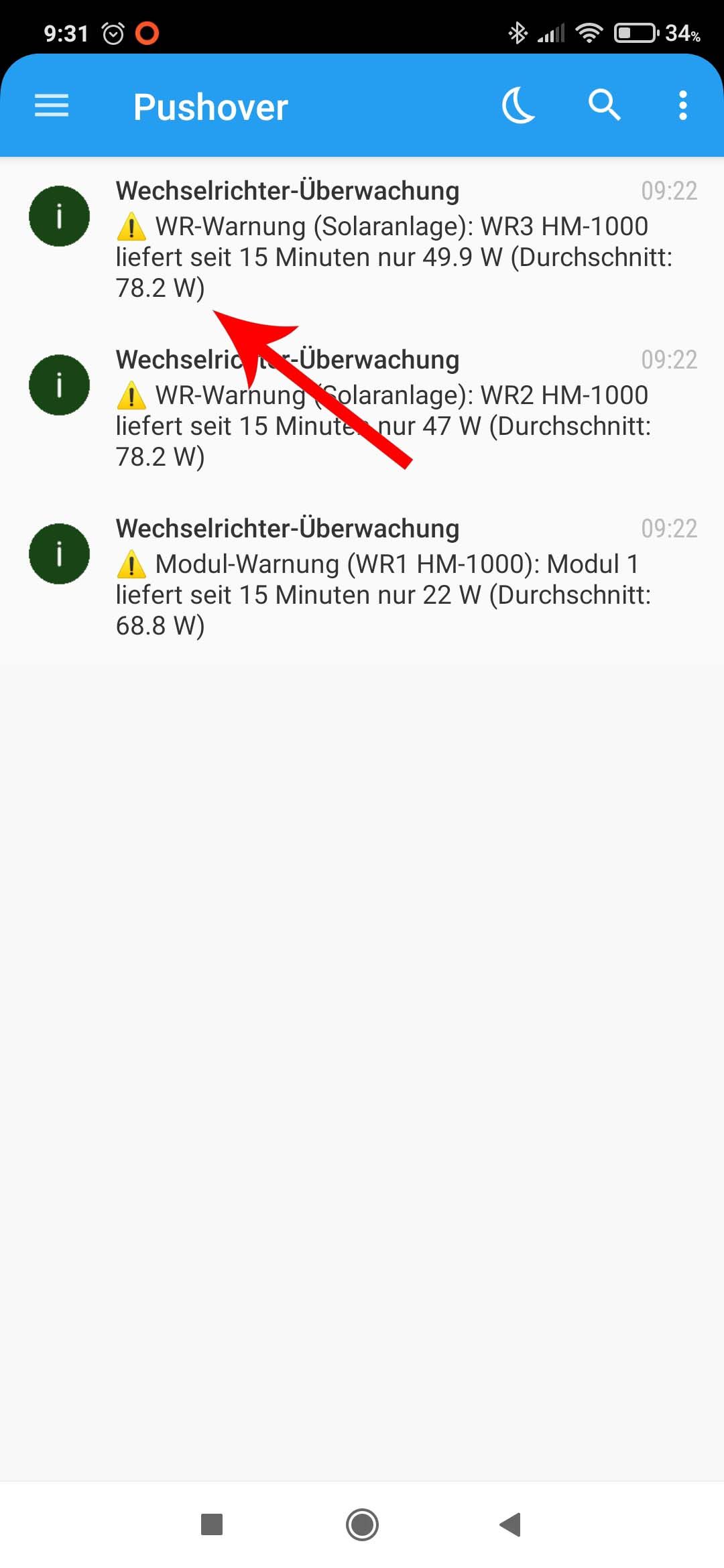

                      Wo kommen diese 78,2 W her? Wo wird das berechnet?
                            Hi, ja wird berechnet aus den Werten der anderen Module.

                                        status.warnSince = null;
                                        status.warned = false;
                                      globalThis.wrStatus[wr.name] = status;
                                  activeWRs.forEach(wr => {
                                    let modulePowers = [];
                                    for (let m = 1; m <= wr.moduleCount; m++) {
                                      let modPower = getState(`opendtu.0.${wr.id}.dc.input_${m}.power`).val;
                                      modulePowers[m - 1] = modPower;
                                    let avgModule = modulePowers.reduce((a, b) => a + b, 0) / wr.moduleCount;
                                    modulePowers.forEach((mp, idx) => {
                                      const modKey = `${wr.name}_modul${idx + 1}`;
                                      let status = globalThis.wrStatus[modKey] || { warnSince: null, warned: false };
                                      // Modulstatus schreiben
                                      const modStatus = mp > 0 ? "✅ OK" : "❌ Kein Ertrag";
                                      setState(`0_userdata.0.WR_Status.${wr.name}.Modul${idx + 1}`, { val: modStatus, ack: true });
                                      if (mp < avgModule * moduleThreshold) {
                                        if (!status.warnSince) status.warnSince = now;
                                        if (!status.warned && (now - status.warnSince) >= warnDelay) {
                                          sendPushoverMessage(`⚠️ Modul-Warnung (${wr.name}): Modul ${idx + 1} liefert seit 15 Minuten nur ${mp} W (Durchschnitt: ${avgModule.toFixed(1)} W)`);
                                          status.warned = true;
                                      } else {
                                        if (status.warned) {
                                          sendPushoverMessage(`✅ Entwarnung (${wr.name}): Modul ${idx + 1} liefert wieder ausreichend Leistung.`);
                                      globalThis.wrStatus[modKey] = status;
                                  group.wrs.forEach((wr, i) => {
                                    const producingState = getState(`opendtu.0.${wr.id}.producing`).val;
                                    const isProducing = producingState === true || producingState === 'true';
                                    let status = globalThis.wrStatus[wr.name + "_prod"] || { warnSince: null, warned: false };
                                    if (!isProducing) {
                                      let anyOtherProducing = group.wrs.some((otherWr, idx) => {
                                        if (idx !== i) {
                                          const otherState = getState(`opendtu.0.${otherWr.id}.producing`).val;
                                          return otherState === true || otherState === 'true';
                                        return false;
                                      if (anyOtherProducing) {
                                          sendPushoverMessage(`🔴 Ausfall (${group.name}): ${wr.name} produziert seit 15 Minuten nichts, obwohl andere laufen!`);
                                      } else {
                                    } else {
                                        sendPushoverMessage(`✅ Entwarnung (${group.name}): ${wr.name} produziert wieder!`);
                                    globalThis.wrStatus[wr.name + "_prod"] = status;
                              schedule('*/2 * * * *', checkWRs);
