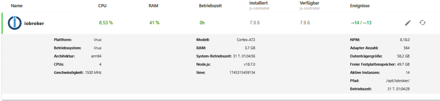

      Das ist das Setup:
      Hat jemend nen Tipp?

            + system.adapter.mqtt.0                   : mqtt                  : iobroker                                 -  enabled, port: 1883, bind: 0.0.0.0
            + system.adapter.renault.0                : renault               : iobroker                                 -  enabled
            + system.adapter.shelly.0                 : shelly                : iobroker                                 -  enabled, port: 1884, bind: 0.0.0.0
            + system.adapter.sonoff.0                 : sonoff                : iobroker                                 -  enabled, port: 1885, bind: 0.0.0.0
              system.adapter.tr-064.0                 : tr-064                : iobroker                                 - disabled
            + system.adapter.viessmannapi.0           : viessmannapi          : iobroker                                 -  enabled
              system.adapter.vis-icontwo.0            : vis-icontwo           : iobroker                                 -  enabled
            + system.adapter.vis-inventwo.0           : vis-inventwo          : iobroker                                 -  enabled
              system.adapter.vis-jqui-mfd.0           : vis-jqui-mfd          : iobroker                                 -  enabled
              system.adapter.vis-material-advanced.0  : vis-material-advanced : iobroker                                 -  enabled
              system.adapter.vis-timeandweather.0     : vis-timeandweather    : iobroker                                 -  enabled
              system.adapter.vis.0                    : vis                   : iobroker                                 -  enabled
            + system.adapter.web.0                    : web                   : iobroker                                 -  enabled, port: 8082, bind: 0.0.0.0, run as: admin
            + instance is alive
            + system.adapter.admin.0                  : admin                 : iobroker                                 -  enabled, port: 8081, bind: 0.0.0.0, run as: admin
            + system.adapter.influxdb.0               : influxdb              : iobroker                                 -  enabled, port: 8086
            + system.adapter.influxdb.1               : influxdb              : iobroker                                 -  enabled, port: 8086
            + system.adapter.influxdb.2               : influxdb              : iobroker                                 -  enabled, port: 8086
            ioBroker-Repositories
            │ (index) │   name   │                           url                           │ auto upgrade │
            │    0    │ 'stable' │    'http://download.iobroker.net/sources-dist.json'     │    false     │
            │    1    │  'beta'  │ 'http://download.iobroker.net/sources-dist-latest.json' │    false     │
            Active repo(s): stable
            Upgrade policy: none
            Installed ioBroker-Adapters
            Used repository: stable
            Adapter    "admin"        : 7.6.3    , installed 7.6.3
            Adapter    "backitup"     : 3.0.31   , installed 3.0.31
            Adapter    "discovery"    : 5.0.0    , installed 5.0.0
            Adapter    "fb-checkpresence": 1.3.1 , installed 1.3.1
            Adapter    "influxdb"     : 4.0.2    , installed 4.0.2
            Adapter    "javascript"   : 8.8.3    , installed 8.8.3
            Controller "js-controller": 7.0.6    , installed 7.0.6
            Adapter    "material"     : 1.3.1    , installed 1.3.1
            Adapter    "mqtt"         : 6.1.2    , installed 6.1.2
            Adapter    "shelly"       : 9.2.0    , installed 8.5.1  [Updatable]
            Adapter    "simple-api"   : 2.8.0    , installed 2.8.0
            Adapter    "socketio"     : 6.7.1    , installed 6.7.1
            Adapter    "sonoff"       : 3.1.2    , installed 3.1.2
            Adapter    "tr-064"       : 4.3.0    , installed 4.3.0
            Adapter    "viessmannapi" : 2.3.0    , installed 2.3.0
            Adapter    "vis-icontwo"  : 1.11.0   , installed 0.96.0 [Updatable]
            Adapter    "vis-inventwo" : 3.3.4    , installed 3.3.4
            Adapter    "vis-jqui-mfd" : 1.1.1    , installed 1.1.1
            Adapter    "web"          : 7.0.8    , installed 7.0.8
            Adapter    "ws"           : 2.6.2    , installed 2.6.2
            Objects and States
            Objects:        6114
            States:         4961
            E: The repository 'http://mirrors.aliyun.com/ubuntu lunar Release' does not have a Release file.
            E: The repository 'http://mirrors.aliyun.com/ubuntu lunar-security Release' does not have a Release file.
            E: The repository 'http://mirrors.aliyun.com/ubuntu lunar-updates Release' does not have a Release file.
            E: The repository 'http://mirrors.aliyun.com/ubuntu lunar-proposed Release' does not have a Release file.
            E: The repository 'http://mirrors.aliyun.com/ubuntu lunar-backports Release' does not have a Release file.
            Pending Updates: 0

              Thomas Braun Most Active @ps1304 last edited by Thomas Braun
              @ps1304 sagte in BackitUp Fehler:
              Ubuntu Release codenamed 'kinetic' reached its END OF LIFE and needs to be updated to the latest LTS release 'jammy' NOW!
              Muss aktualisiert werden. Und zwar KOMPLETT.
              Auf einem Raspberry würde ich auch kein Ubuntu fahren sondern RaspberryOS Lite -> Neuinstallation von RaspberryOS 'Bookworm'.
              Dann kommt da auch die korrekte nodejs-Version automatisch mit.
                ps1304 @Thomas Braun last edited by
                @thomas-braun habe ich befürchtet - hab den so übernommen zur "Betreuung"
                  @ps1304
                  Der ist aber nie 'betreut' worden. Sonst wäre die Kiste nicht so abgesoffen.
                    Hat in der Kategorie Forum nichts verloren.
                    Auch wenn backitup im Threadtitel steht, denke ich es ist hier besser aufgehoben
                      @thomas-braun korrekt, deshalb jetzt neu - hätte aber gerne das Backup eingespielt wegen den ganzen Einstellungen der Adapter.
                        @ps1304
                        Dann bring das jetzt noch soweit es geht auf den aktuellsten Stand, zieh dann davon ein Backup und spiel das im neuen System ein.
                        iob update
                        iob stop
                        iob fix
                        iob nodejs-update 20
