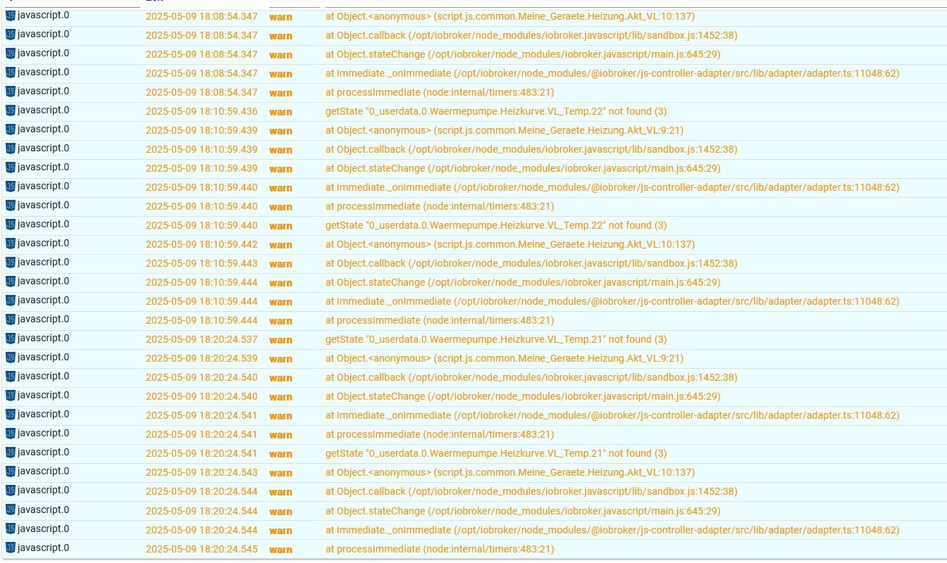

      ich habe ich Log wiederkehrende Einträge:
      javascript.0 	2025-05-09 14:51:51.910	warn	at processImmediate (node:internal/timers:483:21)
      javascript.0 	2025-05-09 14:51:51.909	warn	at Immediate._onImmediate (/opt/iobroker/node_modules/@iobroker/js-controller-adapter/src/lib/adapter/adapter.ts:11048:62)
      javascript.0 	2025-05-09 14:51:51.909	warn	at Object.stateChange (/opt/iobroker/node_modules/iobroker.javascript/main.js:645:29)
      javascript.0 	2025-05-09 14:51:51.909	warn	at Object.callback (/opt/iobroker/node_modules/iobroker.javascript/lib/sandbox.js:1452:38)
      javascript.0 	2025-05-09 14:51:51.907	warn	at processImmediate (node:internal/timers:483:21)
      Was bedeuten die ? Sind markiert als "warn"

            wenn ich das Log herunterlade dann erscheint die Chronologie so herum:
            2025-05-09 18:08:54.344 - warn: javascript.0 (788) getState "0_userdata.0.Waermepumpe.Heizkurve.VL_Temp.23" not found (3)
            2025-05-09 18:08:54.345 - warn: javascript.0 (788) at Object. (script.js.common.Meine_Geraete.Heizung.Akt_VL:9:21)
            2025-05-09 18:08:54.345 - warn: javascript.0 (788) at Object.callback (/opt/iobroker/node_modules/iobroker.javascript/lib/sandbox.js:1452:38)
            2025-05-09 18:08:54.345 - warn: javascript.0 (788) at Object.stateChange (/opt/iobroker/node_modules/iobroker.javascript/main.js:645:29)
            2025-05-09 18:08:54.345 - warn: javascript.0 (788) at Immediate._onImmediate (/opt/iobroker/node_modules/@iobroker/js-controller-adapter/src/lib/adapter/adapter.ts:11048:62)
            2025-05-09 18:08:54.346 - warn: javascript.0 (788) at processImmediate (node:internal/timers:483:21)
            2025-05-09 18:08:54.346 - warn: javascript.0 (788) getState "0_userdata.0.Waermepumpe.Heizkurve.VL_Temp.23" not found (3)
            2025-05-09 18:08:54.347 - warn: javascript.0 (788) at Object. (script.js.common.Meine_Geraete.Heizung.Akt_VL:10:137)
            2025-05-09 18:08:54.347 - warn: javascript.0 (788) at Object.callback (/opt/iobroker/node_modules/iobroker.javascript/lib/sandbox.js:1452:38)
            2025-05-09 18:08:54.347 - warn: javascript.0 (788) at Object.stateChange (/opt/iobroker/node_modules/iobroker.javascript/main.js:645:29)
            2025-05-09 18:08:54.347 - warn: javascript.0 (788) at Immediate._onImmediate (/opt/iobroker/node_modules/@iobroker/js-controller-adapter/src/lib/adapter/adapter.ts:11048:62)
            2025-05-09 18:08:54.347 - warn: javascript.0 (788) at processImmediate (node:internal/timers:483:21)
            2025-05-09 18:10:59.436 - warn: javascript.0 (788) getState "0_userdata.0.Waermepumpe.Heizkurve.VL_Temp.22" not found (3)
            2025-05-09 18:10:59.439 - warn: javascript.0 (788) at Object. (script.js.common.Meine_Geraete.Heizung.Akt_VL:9:21)
            2025-05-09 18:10:59.439 - warn: javascript.0 (788) at Object.callback (/opt/iobroker/node_modules/iobroker.javascript/lib/sandbox.js:1452:38)
            2025-05-09 18:10:59.439 - warn: javascript.0 (788) at Object.stateChange (/opt/iobroker/node_modules/iobroker.javascript/main.js:645:29)
            2025-05-09 18:10:59.440 - warn: javascript.0 (788) at Immediate._onImmediate (/opt/iobroker/node_modules/@iobroker/js-controller-adapter/src/lib/adapter/adapter.ts:11048:62)
            2025-05-09 18:10:59.440 - warn: javascript.0 (788) at processImmediate (node:internal/timers:483:21)
            2025-05-09 18:10:59.440 - warn: javascript.0 (788) getState "0_userdata.0.Waermepumpe.Heizkurve.VL_Temp.22" not found (3)
            2025-05-09 18:10:59.442 - warn: javascript.0 (788) at Object. (script.js.common.Meine_Geraete.Heizung.Akt_VL:10:137)
            2025-05-09 18:10:59.443 - warn: javascript.0 (788) at Object.callback (/opt/iobroker/node_modules/iobroker.javascript/lib/sandbox.js:1452:38)
            2025-05-09 18:10:59.444 - warn: javascript.0 (788) at Object.stateChange (/opt/iobroker/node_modules/iobroker.javascript/main.js:645:29)
            2025-05-09 18:10:59.444 - warn: javascript.0 (788) at Immediate._onImmediate (/opt/iobroker/node_modules/@iobroker/js-controller-adapter/src/lib/adapter/adapter.ts:11048:62)
            2025-05-09 18:10:59.444 - warn: javascript.0 (788) at processImmediate (node:internal/timers:483:21)
            2025-05-09 18:20:24.537 - warn: javascript.0 (788) getState "0_userdata.0.Waermepumpe.Heizkurve.VL_Temp.21" not found (3)
            2025-05-09 18:20:24.539 - warn: javascript.0 (788) at Object. (script.js.common.Meine_Geraete.Heizung.Akt_VL:9:21)
            2025-05-09 18:20:24.540 - warn: javascript.0 (788) at Object.callback (/opt/iobroker/node_modules/iobroker.javascript/lib/sandbox.js:1452:38)
            2025-05-09 18:20:24.540 - warn: javascript.0 (788) at Object.stateChange (/opt/iobroker/node_modules/iobroker.javascript/main.js:645:29)
            2025-05-09 18:20:24.541 - warn: javascript.0 (788) at Immediate._onImmediate (/opt/iobroker/node_modules/@iobroker/js-controller-adapter/src/lib/adapter/adapter.ts:11048:62)
            2025-05-09 18:20:24.541 - warn: javascript.0 (788) at processImmediate (node:internal/timers:483:21)
            2025-05-09 18:20:24.541 - warn: javascript.0 (788) getState "0_userdata.0.Waermepumpe.Heizkurve.VL_Temp.21" not found (3)
            2025-05-09 18:20:24.543 - warn: javascript.0 (788) at Object. (script.js.common.Meine_Geraete.Heizung.Akt_VL:10:137)
            2025-05-09 18:20:24.544 - warn: javascript.0 (788) at Object.callback (/opt/iobroker/node_modules/iobroker.javascript/lib/sandbox.js:1452:38)
            2025-05-09 18:20:24.544 - warn: javascript.0 (788) at Object.stateChange (/opt/iobroker/node_modules/iobroker.javascript/main.js:645:29)
            2025-05-09 18:20:24.544 - warn: javascript.0 (788) at Immediate._onImmediate (/opt/iobroker/node_modules/@iobroker/js-controller-adapter/src/lib/adapter/adapter.ts:11048:62)
            2025-05-09 18:20:24.545 - warn: javascript.0 (788) at processImmediate (node:internal/timers:483:21)

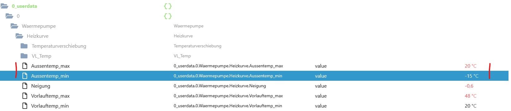

            Und die Einträge
            sind komisch weil die Heizkurve von -15 bis +20 Grad geht, weiß nicht was da nach Temperaturen oberhalb von 20 Grad sucht.

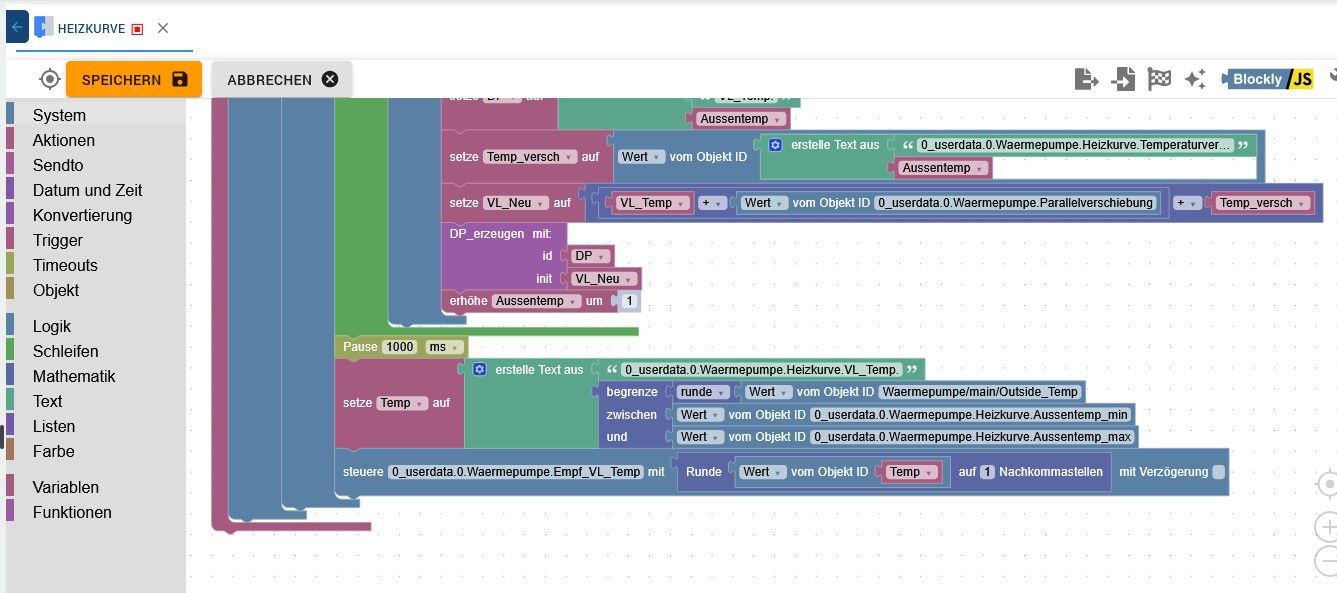

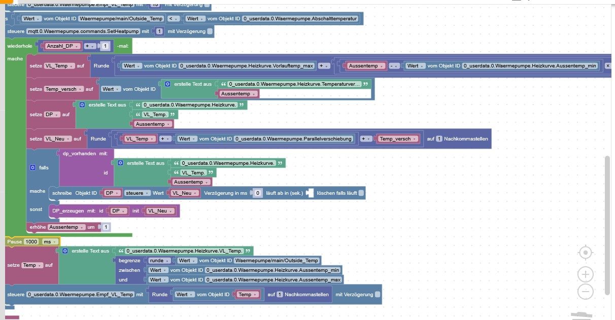

              paul53 @dogfight76 last edited by paul53
              @dogfight76 sagte: weiß nicht was da nach Temperaturen oberhalb von 20 Grad sucht.
              Dann prüfe mal die Schleife im Skript.

              dogfight76 1 Reply Last reply Reply Quote 0

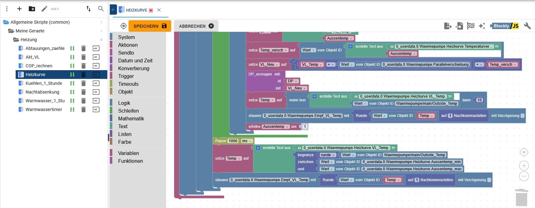

                dogfight76 @paul53 last edited by

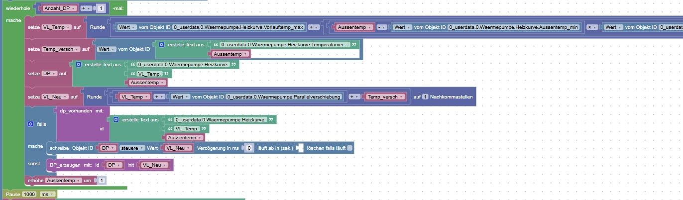

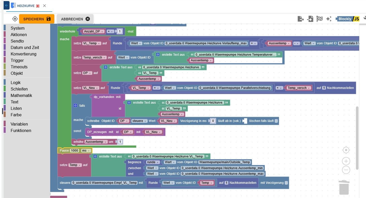

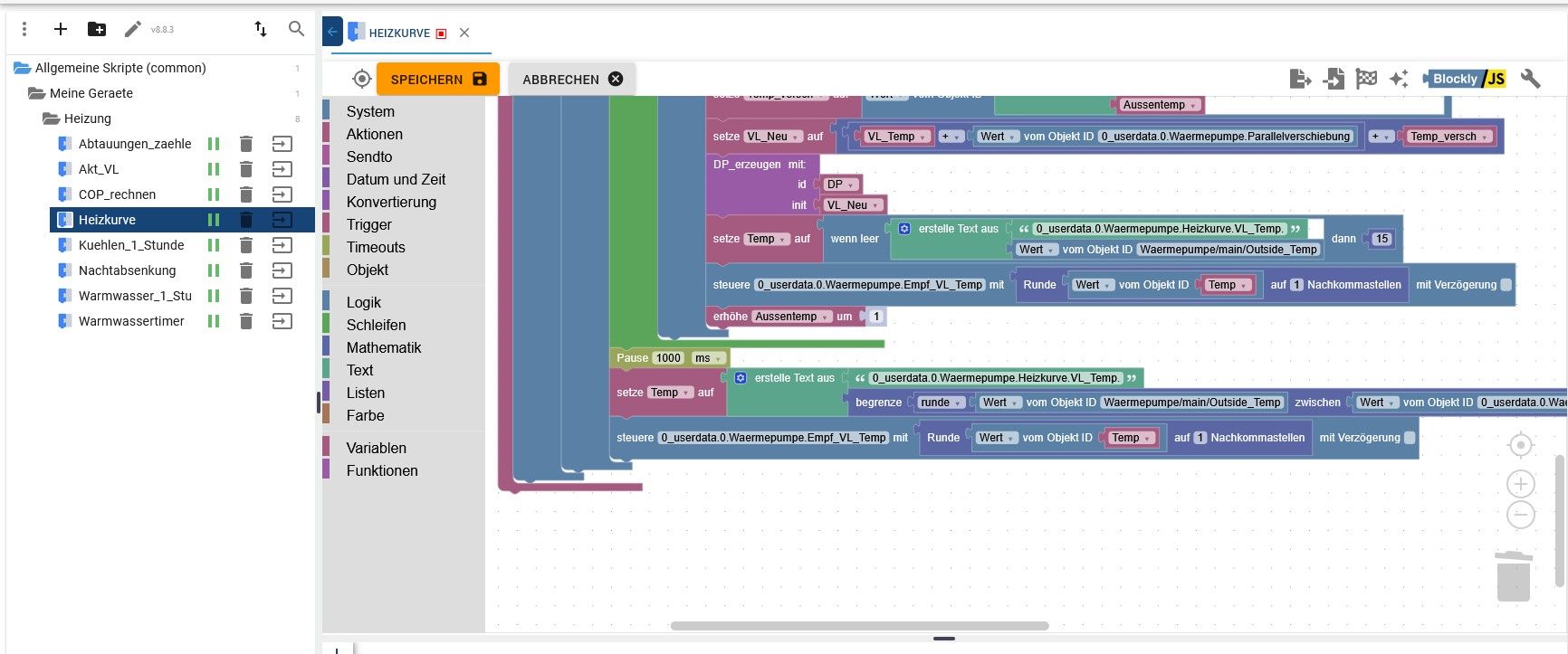

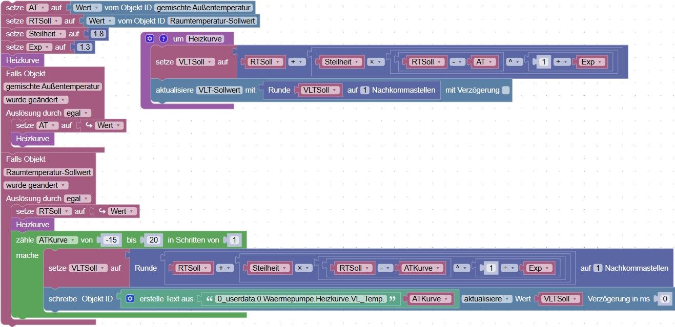

                Das Script der Heizkurve ist das:
                Heizkurve.txt

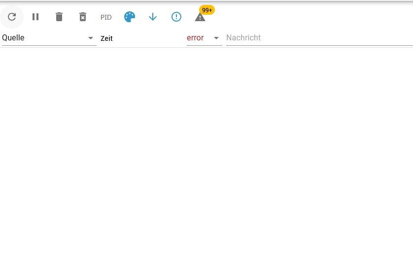

                  @dogfight76 da muss vorher ein ERROR stehen
                  • dogfight76
                    dogfight76 @Homoran last edited by
                    @homoran Ist kein "Error" Eintrag im Protokoll, nur die "normalen" Meldungen und die "warn"
                      Homoran Global Moderator Administrators @dogfight76 last edited by
                      @dogfight76 sagte in Warnungen im Log - was bedeuten die ?:
                      gar keiner, oder nur nicht bei javascript?

                        • dogfight76
                          Kein einziger Error !
                          Aber immer die gleichen warn:

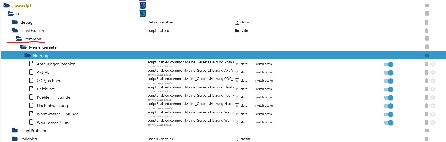

                          Der Eintrag verweist auf das Script: Akt_VL , richtig ?

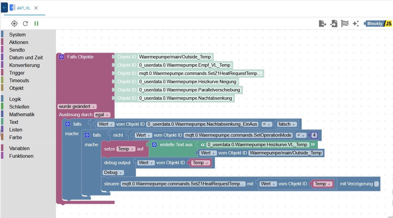

                          2025-05-09 18:20:24.539 warn at Object.<anonymous> (script.js.common.Meine_Geraete.Heizung.Akt_VL:9:21)
                          Auf die Zeile 9 in dem Script ?
                          var Temp;
                          on({ id: [].concat(['mqtt.0.Waermepumpe.main.Outside_Temp']).concat(['0_userdata.0.Waermepumpe.Empf_VL_Temp']).concat(['mqtt.0.Waermepumpe.commands.SetZ1HeatRequestTemperature']).concat(['0_userdata.0.Waermepumpe.Heizkurve.Neigung']).concat(['0_userdata.0.Waermepumpe.Parallelverschiebung']).concat(['0_userdata.0.Waermepumpe.Nachtabsenkung']), change: 'ne' }, async (obj) => {
                            if (getState('0_userdata.0.Waermepumpe.Nachtabsenkung_EinAus').val == false) {
                              if (!(getState('mqtt.0.Waermepumpe.commands.SetOperationMode').val == 4)) {
                                Temp = '0_userdata.0.Waermepumpe.Heizkurve.VL_Temp.' + String(getState('mqtt.0.Waermepumpe.main.Outside_Temp').val);
                                console.debug(getState(Temp).val);
                                setState('mqtt.0.Waermepumpe.commands.SetZ1HeatRequestTemperature' /* mqtt.0.Waermepumpe.commands.SetZ1HeatRequestTemperature */, getState(Temp).val);
                          Da steht:
                          Aber was hat das (wenn ich überhaupt richtig liege mit meiner Vermutung) mit dem Ordner der VL-Temperaturen in dem Pfad 0_userdat_0........... zu tun ?

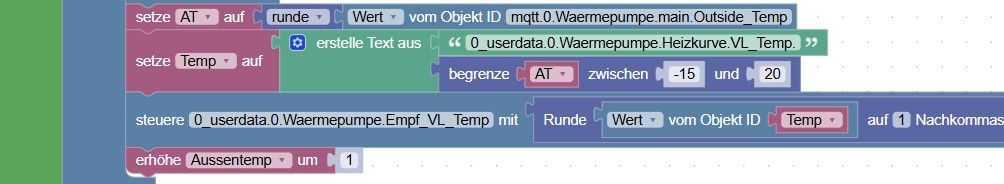

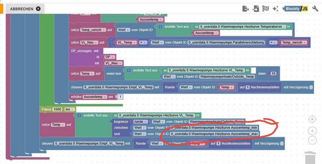

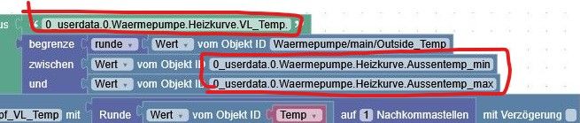

                                      @dogfight76 sagte: Das Script der Heizkurve ist das:
                                      Die Variable Temp, die eine ID enthält, hat keine Begrenzung, sondern verwendet direkt den Wert der Außentemperatur, die zudem auch noch in ganzen Grad auflösen muss.
                                      dogfight76 1 Reply Last reply Reply Quote 1
                                      • dogfight76
                                        dogfight76 @mcm1957 last edited by
                                        @mcm1957 said in Warnungen im Log - was bedeuten die ?:
                                        Oder du musst die Außentemperatur begrenzen ...
                                        Ok, weil ich für die Steuerung über die Heizkurve nur die Temp von -15 bis +20 Grad benötige, (weil ab 21 Grad Aussentemp schaltet die Wärmepumpoe ja ab) würde die Begrenzung ab 21 Grad ja helfen damit die Warn-Meldung nicht mehr erscheinen, weil im Pfad:
                                        dann nicht mehr nach Temp oberhalb von 20 Grad gesucht werden, Korrekt ?
                                        Und die warn-Meldungen tauchen nicht mehr auf ?!
                                        • dogfight76

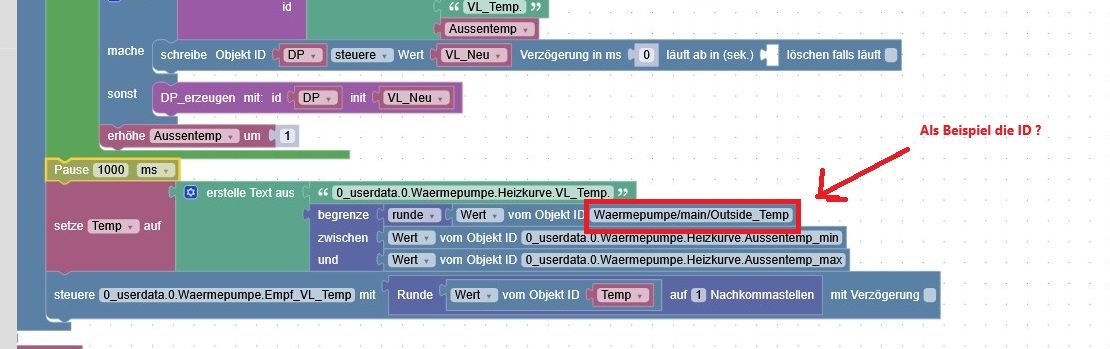

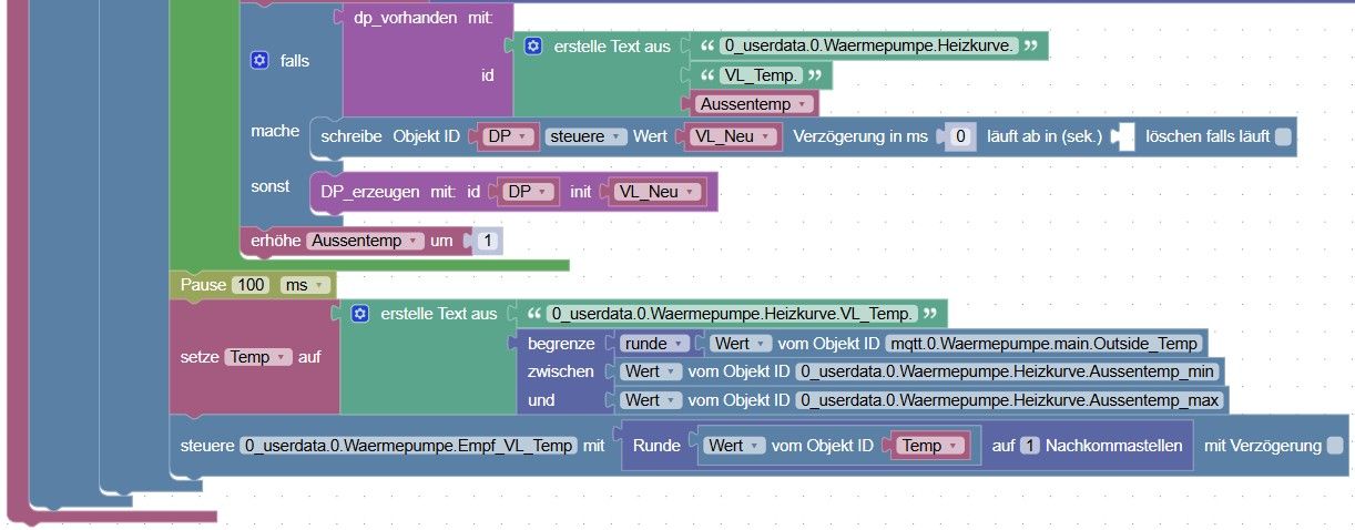

                                          @paul53 said in Warnungen im Log - was bedeuten die ?:
                                          Wie bekomme ich das Script die Begrnezung rein ?

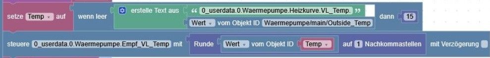

                                          • mcm1957
                                            mcm1957 @dogfight76 last edited by
                                            @dogfight76
                                            Die (Einzahl) Warnmeldung besagt dass du versuchst einen State zu lesen den es nicht gibt. Die Zeilen mit at sind untrennbare Fortsetzungszeilen der Warnmeldung ohne 'at' die dazu dienen die betreffende Codezeile zu identifizieren.
                                            Wenn du dein Script so korrigierts dass es keine nicht existenten State versucht zu lsene ist die getStte Warnung und die nachfolgenden at's weg.
                                            813
