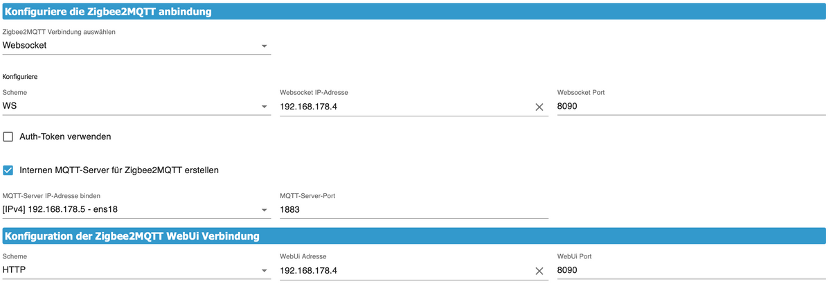

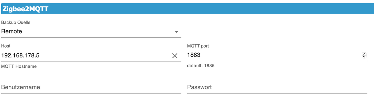

                              21:45:49.323 DEBUG zigbee2mqttConnected to MQTT broker, sending Zigbee2MQTT backup request...
                              21:45:59.303 ERROR zigbee2mqttError: Timeout waiting for Zigbee2MQTT response
                              Hier die Konfigurationen
                              Backitup V3.2.2
                              Zigbee2Mqtt Adapter V3.0.6
                              • simatec
                                simatec Developer Most Active @MichMein last edited by
                                @michmein stelle mal die Bindung vom z2m Adapter auf alle IP‘s
