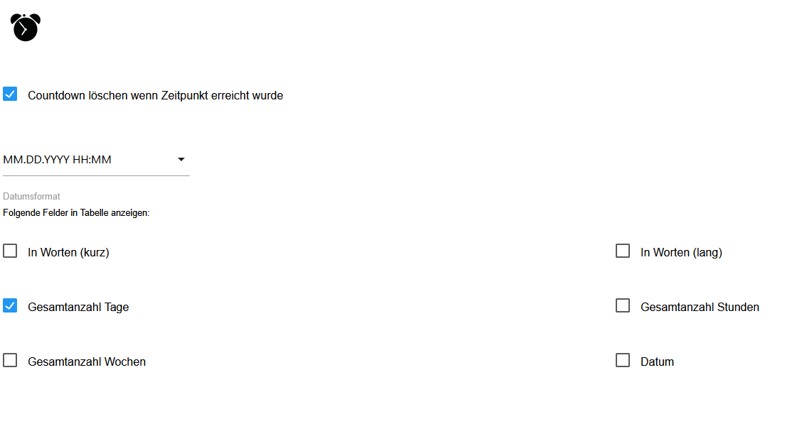

                        • haselchen
                          haselchen Most Active @OliverIO last edited by haselchen
                          @oliverio
                          @mcm1957
                          Okay. Alle Schritte nochmnal von Anfang an.
                          System:
                          Container in einer Synology
                          Admin 7.7.1
                          NodeJS 20.19.4
                          JS-Controller 7.0.7
                          Die Meldungen gibs dann gleich nach dem Speichern.
                          countdown.0	2025-07-22 00:43:24.457	error	[localCreateState] error: Could not check object existence of countdown.0.countdowns.Urlaub.years: Cannot check object existence of "countdown.0.countdowns.Urlaub.years": Connection is closed., stack: Error: Could not check object existence of countdown.0.countdowns.Urlaub.years: Cannot check object existence of "countdown.0.countdowns.Urlaub.years": Connection is closed. at Object.maybeCallbackWithError (/opt/iobroker/node_modules/@iobroker/js-controller-common-db/build/cjs/lib/common/maybeCallback.js:36:13) at AdapterClass._setObjectNotExists (/opt/iobroker/node_modules/@iobroker/js-controller-adapter/build/cjs/lib/adapter/adapter.js:3105:48) at async /opt/iobroker/node_modules/@iobroker/js-controller-common-db/build/cjs/lib/common/tools.js:1582:9
                          countdown.0	2025-07-22 00:43:24.452	error	Cannot check object existence of "countdown.0.countdowns.Urlaub.years": Connection is closed.
                          countdown.0	2025-07-22 00:43:24.447	error	[localCreateState] error: Connection is closed., stack: Error: Connection is closed. at close (/opt/iobroker/node_modules/ioredis/built/redis/event_handler.js:184:25) at Socket.<anonymous> (/opt/iobroker/node_modules/ioredis/built/redis/event_handler.js:151:20) at Object.onceWrapper (node:events:639:26) at Socket.emit (node:events:524:28) at TCP.<anonymous> (node:net:343:12)
                          countdown.0	2025-07-22 00:43:24.439	warn	get state error: Connection is closed.
                          Die Objekte werden anscheinend dann doch angelegt.
                          Allerdings, wenn man mal Enddate anguckt, steht da 10:08Uhr.
                          Ich hab 10:10Uhr eingegeben. Es sind zwar "nur" 2 min, aber es ist halt falsch.
                          Und deshalb nicht vertrauenswürdig und für mich unbrauchbar.

                              • mcm1957
                                mcm1957 @OliverIO last edited by mcm1957
                                @oliverio
                                Ja ich versteh nur nicht warum bei mir und dir immer englisch kommt und im screenshot deutsch zu sehn ist. Das widerspricht urgendwie dem Problem dass admin materialize nicht richtig anzeigt ...
                                Und das ursprüngliche Problem könnte mit sprachspezifischen Formstierungen des Datums zu tun haben.
                                haselchen OliverIO 2 Replies Last reply Reply Quote 0
                                • haselchen
                                  haselchen Most Active @mcm1957 last edited by haselchen
                                  @mcm1957
                                  @OliverIO
                                  Kein Übersetzungstool / Erweiterung und Firefox 140.0.4 und Google Chrome 138.0.7204.101 (Offizieller Build) (64-Bit)
