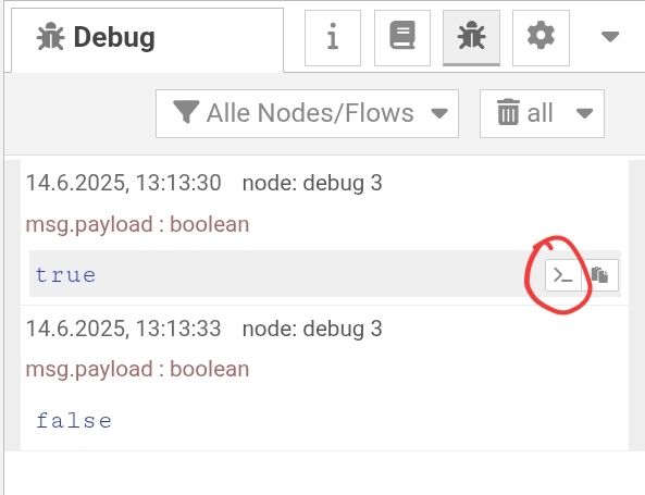

        @aphofis Das sollte dann unter msg.payload.motion liegen.
        Edit: Die Infos aus der Seitenleiste lassen sich nach dem Markieren mit der Maus nutzen. Ich meine die Zwischenablage sollte da nutzbar sein. Ich bin derzeit nur am Tablet unterwegs und habe da keine Maus und co.

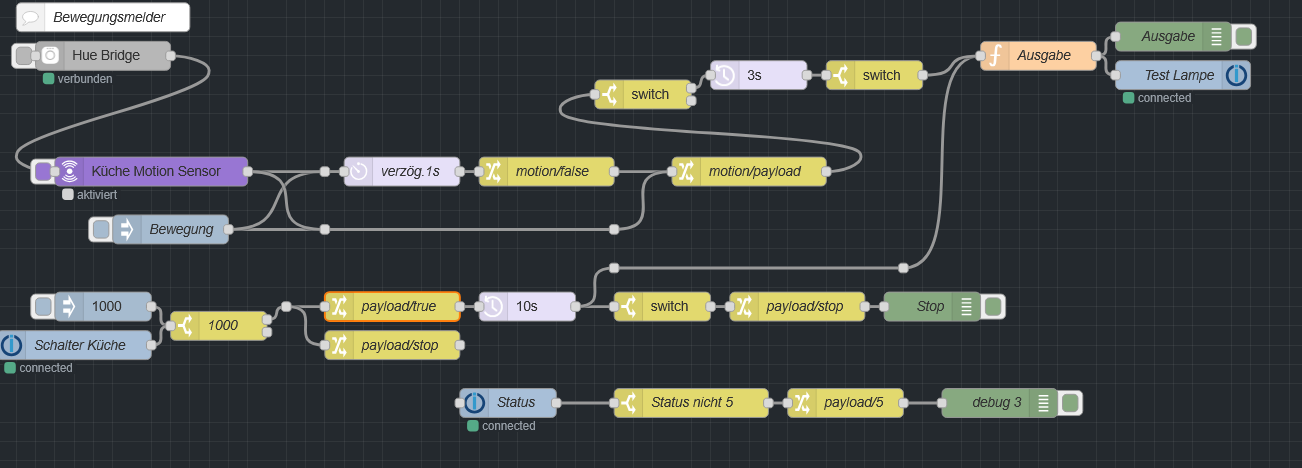

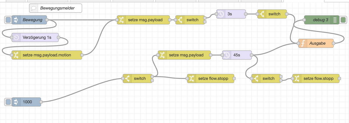

                peterfido @Aphofis last edited by peterfido
                @aphofis Ich habe keinen Hue Bewegungsmelder.
                Mein Entwurf mit 3 und 45 Sekunden:
                        "id": "a42b83181f07f8d0",
                        "type": "tab",
                        "label": "Flow 8",
                        "disabled": false,
                        "info": "",
                        "env": []
                        "id": "1c8c0acba7c2bff2",
                        "type": "inject",
                        "z": "a42b83181f07f8d0",
                        "name": "Bewegung",
                        "props": [
                                "p": "payload.motion",
                                "v": "true",
                                "vt": "bool"
                                "p": "topic",
                                "vt": "str"
                        "repeat": "",
                        "crontab": "",
                        "once": false,
                        "onceDelay": 0.1,
                        "topic": "",
                        "x": 100,
                        "y": 60,
                        "wires": [
                                "8bf1e5067a6f0ad2",
                                "6adb99e531920623"
                        "id": "d1f2c8393ea7f683",
                        "type": "debug",
                        "name": "debug 3",
                        "active": true,
                        "tosidebar": true,
                        "console": false,
                        "tostatus": false,
                        "complete": "payload",
                        "targetType": "msg",
                        "statusVal": "",
                        "statusType": "auto",
                        "x": 1100,
                        "y": 60,
                        "wires": []
                        "id": "8bf1e5067a6f0ad2",
                        "type": "delay",
                        "name": "",
                        "pauseType": "delay",
                        "timeout": "1",
                        "timeoutUnits": "seconds",
                        "rate": "1",
                        "nbRateUnits": "1",
                        "rateUnits": "second",
                        "randomFirst": "1",
                        "randomLast": "5",
                        "randomUnits": "seconds",
                        "drop": false,
                        "allowrate": false,
                        "outputs": 1,
                        "x": 120,
                        "y": 120,
                        "wires": [
                                "a9f9b30b4f8999d0"
                        "id": "a9f9b30b4f8999d0",
                        "type": "change",
                        "name": "",
                        "rules": [
                                "t": "set",
                                "pt": "msg",
                                "to": "false",
                                "tot": "bool"
                        "action": "",
                        "property": "",
                        "from": "",
                        "to": "",
                        "reg": false,
                        "x": 160,
                        "y": 180,
                        "wires": [
                                "6adb99e531920623"
                        "id": "7a509a8587332f14",
                        "type": "switch",
                        "name": "",
                        "property": "payload",
                        "propertyType": "msg",
                        "rules": [
                                "t": "true"
                                "t": "false"
                        "checkall": "true",
                        "repair": false,
                        "outputs": 2,
                        "x": 650,
                        "y": 60,
                        "wires": [
                                "c1952bc66da5a348"
                        "id": "c1952bc66da5a348",
                        "type": "timeouttrigger",
                        "OnTimeoutType": "bool",
                        "OnTimeoutVal": "false",
                        "duration": "3",
                        "units": "s",
                        "passthrough": true,
                        "sendTimeoutValue": "once",
                        "interval": "",
                        "IntervalUnits": "s",
                        "name": "",
                        "x": 790,
                        "y": 40,
                        "wires": [
                                "4d146d05efbc5d35"
                        "id": "6adb99e531920623",
                        "type": "change",
                        "name": "",
                        "rules": [
                                "t": "set",
                                "p": "payload",
                                "pt": "msg",
                                "to": "payload.motion",
                                "tot": "msg"
                        "action": "",
                        "property": "",
                        "from": "",
                        "to": "",
                        "reg": false,
                        "x": 490,
                        "y": 60,
                        "wires": [
                                "7a509a8587332f14"
                        "id": "9f83e7917ef2d8e2",
                        "type": "comment",
                        "name": "Bewegungsmelder",
                        "info": "",
                        "x": 190,
                        "y": 20,
                        "wires": []
                        "id": "302a07cea50da337",
                        "duration": "45",
                        "units": "s",
                        "interval": "",
                        "name": "",
                        "x": 810,
                        "y": 180,
                        "wires": [
                                "2871643160dfcc7c",
                                "550905a564f09176"
                        "id": "0762e0ad3da83f0d",
                        "type": "inject",
                        "name": "",
                        "props": [
                                "p": "payload"
                                "p": "topic",
                                "vt": "str"
                        "repeat": "",
                        "crontab": "",
                        "once": false,
                        "onceDelay": 0.1,
                        "topic": "",
                        "payload": "1000",
                        "payloadType": "num",
                        "x": 90,
                        "y": 340,
                        "wires": [
                                "d1051390faa881a3"
                        "id": "bd795708de32c118",
                        "type": "change",
                        "name": "",
                        "rules": [
                                "t": "set",
                                "p": "payload",
                                "pt": "msg",
                                "to": "true",
                                "tot": "bool"
                        "action": "",
                        "property": "",
                        "from": "",
                        "to": "",
                        "reg": false,
                        "x": 630,
                        "y": 180,
                        "wires": [
                                "302a07cea50da337"
                        "id": "d1051390faa881a3",
                        "type": "switch",
                        "name": "",
                        "rules": [
                                "t": "eq",
                                "v": "1000",
                                "vt": "num"
                                "t": "eq",
                                "v": "",
                                "vt": "num"
                        "checkall": "true",
                        "repair": false,
                        "outputs": 2,
                        "x": 470,
                        "y": 260,
                        "wires": [
                                "bd795708de32c118",
                                "32b9213c2fe970b0"
                        "id": "4d146d05efbc5d35",
                        "type": "switch",
                        "name": "",
                        "property": "stopp",
                        "propertyType": "flow",
                        "rules": [
                                "t": "false"
                        "checkall": "true",
                        "repair": false,
                        "outputs": 1,
                        "x": 930,
                        "y": 40,
                        "wires": [
                                "550905a564f09176"
                        "id": "32b9213c2fe970b0",
                        "type": "change",
                        "name": "",
                        "rules": [
                                "t": "set",
                                "p": "stopp",
                                "pt": "flow",
                                "to": "true",
                                "tot": "bool"
                        "action": "",
                        "property": "",
                        "from": "",
                        "to": "",
                        "reg": false,
                        "x": 720,
                        "y": 260,
                        "wires": [
                        "id": "0439088d7ec73749",
                        "type": "change",
                        "name": "",
                        "rules": [
                                "t": "set",
                                "p": "stopp",
                                "pt": "flow",
                                "to": "false",
                                "tot": "bool"
                        "action": "",
                        "property": "",
                        "from": "",
                        "to": "",
                        "reg": false,
                        "x": 1080,
                        "y": 260,
                        "wires": [
                        "id": "2871643160dfcc7c",
                        "type": "switch",
                        "name": "",
                        "rules": [
                                "t": "eq",
                                "v": "1000",
                                "vt": "num"
                                "t": "eq",
                                "v": "",
                                "vt": "num"
                        "checkall": "true",
                        "repair": false,
                        "outputs": 2,
                        "x": 910,
                        "y": 260,
                        "wires": [
                                "0439088d7ec73749"
                        "id": "550905a564f09176",
                        "type": "function",
                        "name": "Ausgabe",
                        "func": "node.status({ text: msg.payload });\n\nreturn msg;",
                        "outputs": 1,
                        "timeout": 0,
                        "noerr": 0,
                        "initialize": "// Der Code hier wird ausgeführt,\n// wenn der Node gestartet wird\nflow.set(\"stopp\", false);",
                        "finalize": "",
                        "libs": [],
                        "x": 1080,
                        "y": 140,
                        "wires": [
                                "d1f2c8393ea7f683"
                Beachte auch in der Funktion den Reiter Start, welcher die Variable stopp initialisiert.

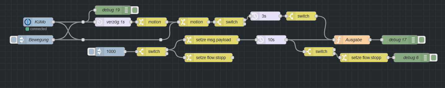

                • Aphofis
                  Aphofis @peterfido last edited by
                  @peterfido

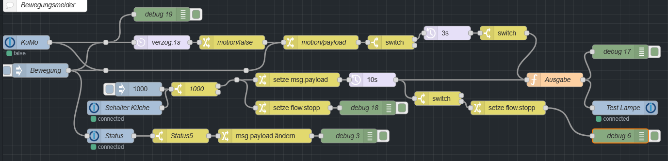

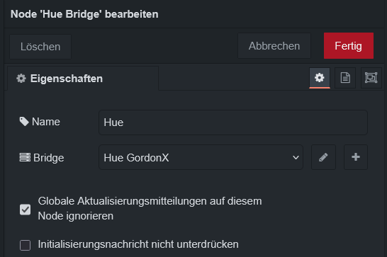

                  Verstehe ich noch nicht ganz wie wird die iob in node eingestellt, wo kommt der Roboter Sauger ins spiel und wie meinst du das mit beachte stop reiter !?
                    @aphofis In den Funktionen gibt es mehrere Reiter / Tabs. Da drin kann man andere Skripte für Start und Stopp des Flows anlegen. Z.B. Variablen für den Flow anlegen. Den Roboter habe ich nicht berücksichtigt. Das ist nur ein Grundgerüst, um einen Weg zu zeigen, wie man es machen könnte.
                    Aphofis 1 Reply Last reply Reply Quote 0
                    • Aphofis
                      Aphofis @peterfido last edited by Aphofis
                      @peterfido

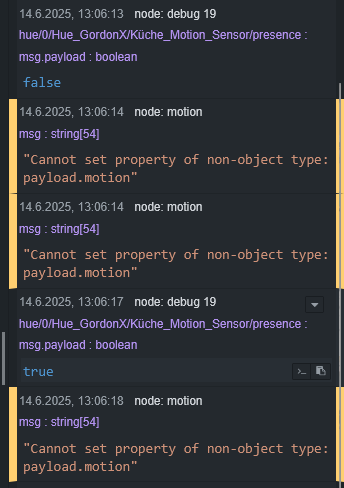

                      Wenn der Bewegungsmelder auslöst, passiert das
                      Die Steuerung wird nicht ausgelöst.
                      Egal wie ich die Attribute von der In Node benenne reagiert die steuerung nicht.
                      motion, payload.motion oder nur payload kommt nichts bei raus.
                      Ich weiß nicht wie ich den BM In Node einstellen soll.
                        @aphofis Der genaue Pfad wird in die Zwischenablage kopiert, wenn du da drauf klickst.
                        • Aphofis
                          @peterfido
                          Da kommt nur payload bei raus.
                          Der BM kommt nicht über motion/false Node hinweg.
                            @aphofis Ich gehe von Deinem Flow aus dem ersten Post aus. Den Wert aus "Motion" dann direkt ins Payload schieben und den Rest von meinem Entwurf damit füttern.
                            Ich habe da nur versucht, den Hue Bewegungsmelder, bzw. dessen Ausgabe, nachzubauen. Ich habe da keinen, um das zuverlässig nachzubauen.
                            Mein Beispiel läuft autark und blockiert den Bewegungsmelder eine Zeit lang, wenn die 1000 auf dem zweiten Pfad eintrudelt. In meinem Beispiel wird die Flow-Variable "stopp" dafür genutzt.
                            Robi und Hue Bewegungungsmelder sind von dir zu ergänzen. Für den Robi könntest du z.B. eine zweite Flow-Variable nutzen.
                            • Aphofis
                              Aphofis last edited by Aphofis
                              @peterfido sagte in HUE Bewegungsmelder Roborock integr.:
                              Dazu fehlt mir wohl das wissen wie man das zusammen schustert.
                              Ich weiß nicht wie man die Inject node durch eine Iobroker In Node ersetzt.
                              Da anscheinend der true zustand der Inject und der Iob In node unteerschiedlich ist.
                              und wo man nun den Sauger dran hängt verstehe ich auch nicht.
                              Die wege sind mir noch nicht klar. Auch wenn ich überall eine Debug node dran hänge, verstehe ich den Weg noch nicht.
                              Habe die Original Hue Node vom BM genommen dort kommt ja motion: ergebnis raus
                              damit funktioniert es. nur wo ich nun den Roboter dran hänge das die Steuerung
                              dann nur per Schalter ausgelöst werden kann und der BM bei nicht Roboter Status 5 deaktiviert ist.

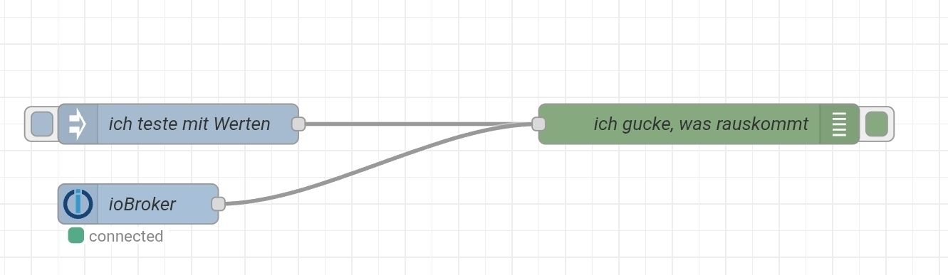

                                @aphofis Einfach stattdessen, bzw. zum Testen von Werten, parallel.
                                Einfach bissel probieren. Ich selbst sitze auf der Terrasse mit einem Tablet und gucke bissel durchs Forum.
                                Der Robi schickt seinen Status, diesen in einer Flow Variable, welche idealerweise in einer Functionsnode unter Start initialisiert wird, speichern. (Status 5 = BWM true, sonst false). Inwieweit die 1000 mit dem Robi konkurrieren, bzw. welcher da gewinnt, ist mir nicht ganz klar.
                                Meine Ausgabe-Function zeigt nur true, wenn die Lampe an ist, und false, wenn die aus ist. Da kann auch stattdessen eine ioBroker Out Node dran, parallel oder dahinter.

                                  Hatte ja jetzt die BWM Node von Hue eingebaut nur wo der Roboter dran gehängt wird verstehe ich noch nicht.
                                  Bin momentan so weit:

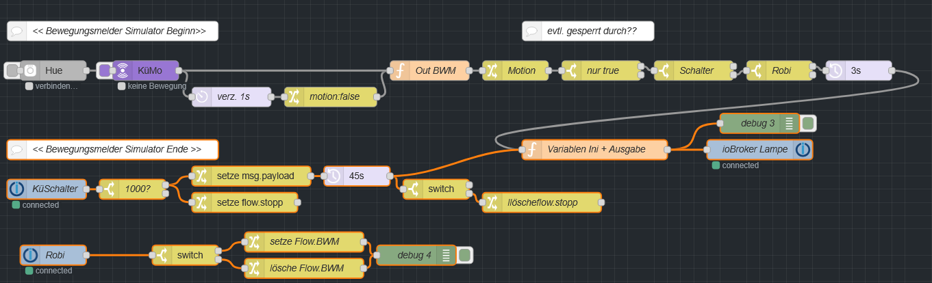

                                  Da hast du es aber gemütlich.
                                  Fehlt wohl nur noch ein Kaffee!

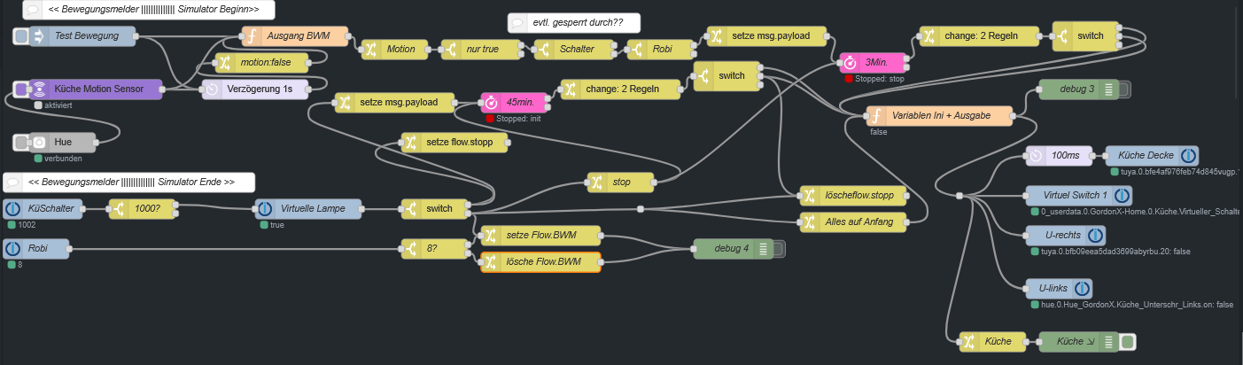

                                    @aphofis Probier mal das:

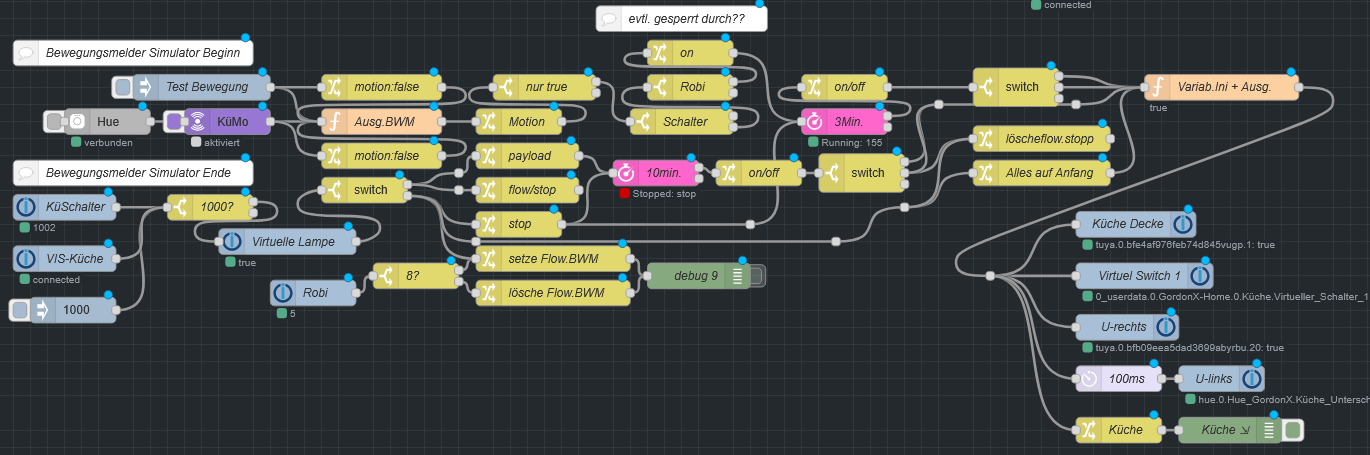

                                            "type": "tab",
                                            "label": "Flow 8",
                                            "disabled": false,
                                            "info": "",
                                            "env": []
                                            "type": "inject",
                                            "name": "Test Bewegung",
                                            "props": [
                                                    "v": "true",
                                                    "vt": "bool"
                                                    "p": "topic",
                                                    "vt": "str"
                                            "repeat": "",
                                            "crontab": "",
                                            "once": false,
                                            "onceDelay": 0.1,
                                            "topic": "Bewegungsmelder",
                                            "x": 120,
                                            "y": 60,
                                            "wires": [
                                                    "8bf1e5067a6f0ad2",
                                                    "b0410acfcad1b37e"
                                            "type": "debug",
                                            "name": "debug 3",
                                            "active": true,
                                            "tosidebar": true,
                                            "console": false,
                                            "tostatus": false,
                                            "complete": "true",
                                            "targetType": "full",
                                            "statusVal": "",
                                            "x": 1560,
                                            "y": 40,
                                            "wires": []
                                            "type": "delay",
                                            "name": "",
                                            "timeout": "1",
                                            "rate": "1",
                                            "nbRateUnits": "1",
                                            "randomFirst": "1",
                                            "randomLast": "5",
                                            "drop": false,
                                            "allowrate": false,
                                            "outputs": 1,
                                            "x": 120,
                                            "y": 120,
                                            "wires": [
                                                    "a9f9b30b4f8999d0"
                                            "type": "change",
                                            "name": "motion:false",
                                            "rules": [
                                                    "t": "set",
                                                    "pt": "msg",
                                                    "to": "false",
                                                    "tot": "bool"
                                            "action": "",
                                            "property": "",
                                            "from": "",
                                            "to": "",
                                            "reg": false,
                                            "x": 170,
                                            "y": 160,
                                            "wires": [
                                                    "b0410acfcad1b37e"
                                            "type": "switch",
                                            "name": "Schalter",
                                            "rules": [
                                                    "t": "true"
                                                    "t": "false"
                                            "checkall": "true",
                                            "repair": false,
                                            "outputs": 2,
                                            "x": 820,
                                            "y": 80,
                                            "wires": [
                                                    "4d146d05efbc5d35"
                                            "duration": "3",
                                            "units": "s",
                                            "interval": "",
                                            "name": "",
                                            "x": 1130,
                                            "y": 60,
                                            "wires": [
                                                    "550905a564f09176"
                                            "type": "change",
                                            "name": "Motion",
                                            "rules": [
                                                    "t": "set",
                                                    "p": "payload",
                                                    "pt": "msg",
                                                    "tot": "msg"
                                            "action": "",
                                            "property": "",
                                            "from": "",
                                            "to": "",
                                            "reg": false,
                                            "x": 500,
                                            "y": 60,
                                            "wires": [
                                                    "9f0c88dad82d8633"
                                            "type": "comment",
                                            "name": "<< Bewegungsmelder |||||||||||||| Simulator  Beginn>>",
                                            "info": "",
                                            "x": 220,
                                            "y": 20,
                                            "wires": []
                                            "duration": "45",
                                            "units": "s",
                                            "interval": "",
                                            "name": "",
                                            "x": 710,
                                            "y": 180,
                                            "wires": [
                                                    "2871643160dfcc7c",
                                                    "550905a564f09176"
                                            "type": "inject",
                                            "name": "Test 1000",
                                            "props": [
                                                    "p": "payload"
                                                    "p": "topic",
                                                    "vt": "str"
                                            "repeat": "",
                                            "crontab": "",
                                            "once": false,
                                            "onceDelay": 0.1,
                                            "topic": "Schalter_1000",
                                            "payload": "1000",
                                            "x": 120,
                                            "y": 280,
                                            "wires": [
                                                    "d1051390faa881a3"
                                            "type": "change",
                                            "name": "",
                                            "rules": [
                                                    "t": "set",
                                                    "p": "payload",
                                                    "pt": "msg",
                                                    "to": "true",
                                                    "tot": "bool"
                                            "action": "",
                                            "property": "",
                                            "from": "",
                                            "to": "",
                                            "reg": false,
                                            "x": 530,
                                            "y": 240,
                                            "wires": [
                                                    "302a07cea50da337"
                                            "type": "switch",
                                            "name": "1000?",
                                            "rules": [
                                                    "t": "eq",
                                                    "v": "1000",
                                                    "vt": "num"
                                                    "t": "eq",
                                                    "v": "",
                                                    "vt": "num"
                                            "checkall": "true",
                                            "repair": false,
                                            "outputs": 2,
                                            "x": 290,
                                            "y": 300,
                                            "wires": [
                                                    "bd795708de32c118",
                                                    "32b9213c2fe970b0"
                                            "type": "switch",
                                            "name": "Robi",
                                            "property": "BWM",
                                            "rules": [
                                                    "t": "true"
                                                    "t": "false"
                                            "checkall": "true",
                                            "repair": false,
                                            "outputs": 2,
                                            "x": 950,
                                            "y": 80,
                                            "wires": [
                                                    "c1952bc66da5a348"
                                            "type": "change",
                                            "name": "",
                                            "rules": [
                                                    "t": "set",
                                                    "p": "stopp",
                                                    "pt": "flow",
                                                    "to": "true",
                                                    "tot": "bool"
                                            "action": "",
                                            "property": "",
                                            "from": "",
                                            "to": "",
                                            "reg": false,
                                            "x": 520,
                                            "y": 280,
                                            "wires": [
                                            "type": "change",
                                            "name": "llöscheflow.stopp",
                                            "rules": [
                                                    "t": "set",
                                                    "p": "stopp",
                                                    "pt": "flow",
                                                    "to": "false",
                                                    "tot": "bool"
                                            "action": "",
                                            "property": "",
                                            "from": "",
                                            "to": "",
                                            "reg": false,
                                            "x": 1030,
                                            "y": 260,
                                            "wires": [
                                            "type": "switch",
                                            "name": "",
                                            "rules": [
                                                    "t": "eq",
                                                    "v": "1000",
                                                    "vt": "num"
                                                    "t": "eq",
                                                    "v": "",
                                                    "vt": "num"
                                            "checkall": "true",
                                            "repair": false,
                                            "outputs": 2,
                                            "x": 830,
                                            "y": 260,
                                            "wires": [
                                                    "0439088d7ec73749"
                                            "type": "function",
                                            "name": "Variablen Ini + Ausgabe",
                                            "outputs": 1,
                                            "timeout": 0,
                                            "noerr": 0,
                                            "initialize": "// Der Code hier wird ausgeführt,\n// wenn der Node gestartet wird\nflow.set(\"stopp\", false);\nflow.set(\"BWM\", true);\n",
                                            "finalize": "",
                                            "libs": [],
                                            "x": 1330,
                                            "y": 120,
                                            "wires": [
                                                    "d1f2c8393ea7f683",
                                                    "e2721e4056e942e3"
                                            "id": "d7bd1efc606cfcad",
                                            "type": "ioBroker in",
                                            "name": "ioB Robi",
                                            "attrname": "payload",
                                            "topic": "*",
                                            "payloadType": "value",
                                            "onlyack": "",
                                            "func": "all",
                                            "gap": "",
                                            "fireOnStart": "false",
                                            "outFormat": "MQTT",
                                            "x": 120,
                                            "y": 560,
                                            "wires": [
                                                    "b2f36db79c165583"
                                            "id": "b0410acfcad1b37e",
                                            "type": "function",
                                            "name": "Ausgang BWM",
                                            "func": "\nreturn msg;",
                                            "outputs": 1,
                                            "timeout": 0,
                                            "noerr": 0,
                                            "initialize": "",
                                            "finalize": "",
                                            "libs": [],
                                            "x": 320,
                                            "y": 60,
                                            "wires": [
                                                    "6adb99e531920623"
                                            "id": "e2721e4056e942e3",
                                            "type": "ioBroker out",
                                            "name": "ioBroker Lampe",
                                            "topic": "",
                                            "ack": "false",
                                            "autoCreate": "false",
                                            "stateName": "",
                                            "role": "",
                                            "payloadType": "",
                                            "readonly": "",
                                            "stateUnit": "",
                                            "stateMin": "",
                                            "stateMax": "",
                                            "x": 1640,
                                            "y": 160,
                                            "wires": []
                                            "id": "7cfd7f7fba2e2d7a",
                                            "name": "ioB Schalter",
                                            "topic": "*",
                                            "onlyack": "",
                                            "func": "all",
                                            "gap": "",
                                            "x": 110,
                                            "y": 340,
                                            "wires": [
                                                    "d1051390faa881a3"
                                            "id": "91ef09f531fcc27b",
                                            "type": "inject",
                                            "name": "Test Robi = 5",
                                            "props": [
                                                    "p": "payload"
                                                    "p": "topic",
                                                    "vt": "str"
                                            "repeat": "",
                                            "crontab": "",
                                            "once": false,
                                            "onceDelay": 0.1,
                                            "topic": "",
                                            "payload": "5",
                                            "x": 130,
                                            "y": 440,
                                            "wires": [
                                                    "b2f36db79c165583"
                                            "id": "6db2cc2617ad5707",
                                            "type": "inject",
                                            "name": "Test Robi <> 5",
                                            "props": [
                                                    "p": "payload"
                                                    "p": "topic",
                                                    "vt": "str"
                                            "repeat": "",
                                            "crontab": "",
                                            "once": false,
                                            "onceDelay": 0.1,
                                            "topic": "",
                                            "payload": "6",
                                            "x": 130,
                                            "y": 500,
                                            "wires": [
                                                    "b2f36db79c165583"
                                            "id": "b2f36db79c165583",
                                            "type": "switch",
                                            "name": "",
                                            "rules": [
                                                    "t": "eq",
                                                    "v": "5",
                                                    "vt": "num"
                                                    "t": "neq",
                                                    "v": "5",
                                                    "vt": "num"
                                            "checkall": "true",
                                            "repair": false,
                                            "outputs": 2,
                                            "x": 310,
                                            "y": 500,
                                            "wires": [
                                                    "407e2e376c0ee370"
                                                    "5061312f43733426"
                                            "id": "407e2e376c0ee370",
                                            "type": "change",
                                            "name": "setze Flow.BWM",
                                            "rules": [
                                                    "t": "set",
                                                    "p": "BWM",
                                                    "pt": "flow",
                                                    "to": "true",
                                                    "tot": "bool"
                                            "action": "",
                                            "property": "",
                                            "from": "",
                                            "to": "",
                                            "reg": false,
                                            "x": 500,
                                            "y": 460,
                                            "wires": [
                                                    "0650a4ab7aec40a1"
                                            "id": "5061312f43733426",
                                            "type": "change",
                                            "name": "lösche Flow.BWM",
                                            "rules": [
                                                    "t": "set",
                                                    "p": "BWM",
                                                    "pt": "flow",
                                                    "to": "false",
                                                    "tot": "bool"
                                            "action": "",
                                            "property": "",
                                            "from": "",
                                            "to": "",
                                            "reg": false,
                                            "x": 490,
                                            "y": 520,
                                            "wires": [
                                                    "0650a4ab7aec40a1"
                                            "id": "879b9060efcd163b",
                                            "type": "comment",
                                            "name": "evtl. gesperrt durch??",
                                            "info": "",
                                            "x": 880,
                                            "y": 40,
                                            "wires": []
                                            "id": "9f0c88dad82d8633",
                                            "type": "switch",
                                            "name": "nur true",
                                            "rules": [
                                                    "t": "true"
                                                    "t": "false"
                                            "checkall": "true",
                                            "repair": false,
                                            "outputs": 2,
                                            "x": 640,
                                            "y": 80,
                                            "wires": [
                                                    "7a509a8587332f14"
                                            "id": "0650a4ab7aec40a1",
                                            "type": "debug",
                                            "name": "debug 4",
                                            "active": true,
                                            "tosidebar": true,
                                            "console": false,
                                            "tostatus": false,
                                            "complete": "true",
                                            "statusVal": "",
                                            "x": 720,
                                            "y": 500,
                                            "wires": []
                                            "id": "f144b6f8b998c7f5",
                                            "type": "comment",
                                            "name": "<< Bewegungsmelder |||||||||||||| Simulator Ende >>",
                                            "info": "",
                                            "x": 220,
                                            "y": 220,
                                            "wires": []
                                    Edit: Die Verzögerung von einer Sekunde hinter dem BWM braucht es nicht unbedingt. Die setzt nur meinen simulierten BWM zurück.
                                    • Aphofis
                                      @peterfido

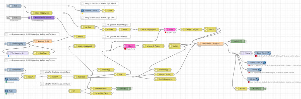

                                      Das funktioniert.

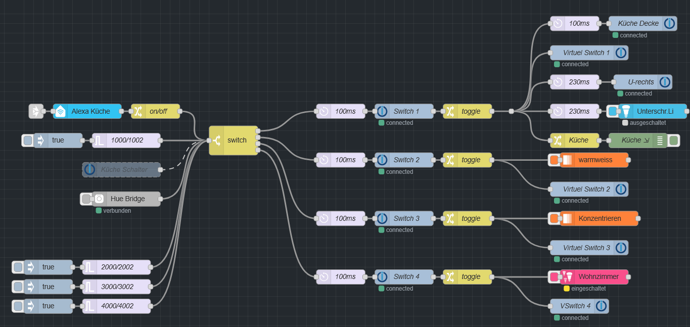

                                      Habe da jetzt die normale Küchen Schaltung die es jetzt zu integrieren gilt.

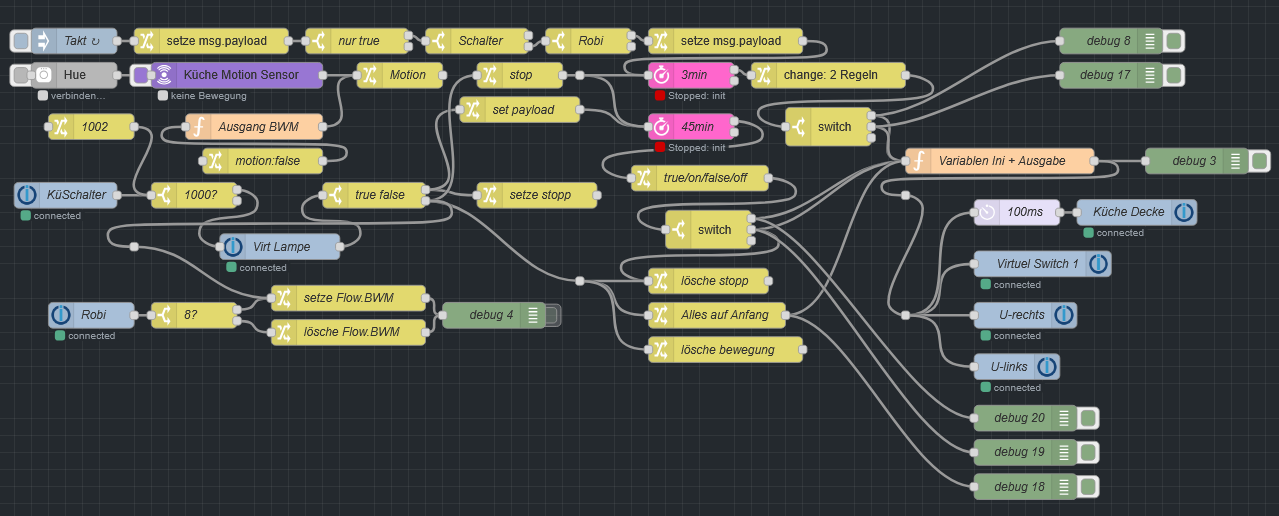

                                      So funktioniert die Steuerung von dir prima nur muss diese in die standard schalter schaltung integriert werden.
                                              "type": "tab",
                                              "label": "Flow 8",
                                              "disabled": false,
                                              "info": "",
                                              "env": []
                                              "type": "debug",
                                              "name": "debug 3",
                                              "active": true,
                                              "tosidebar": true,
                                              "console": false,
                                              "tostatus": false,
                                              "complete": "true",
                                              "statusVal": "",
                                              "x": 1160,
                                              "y": 520,
                                              "wires": []
                                              "type": "delay",
                                              "name": "verz. 1s",
                                              "timeout": "1",
                                              "rate": "1",
                                              "nbRateUnits": "1",
                                              "randomFirst": "1",
                                              "randomLast": "5",
                                              "drop": false,
                                              "allowrate": false,
                                              "outputs": 1,
                                              "x": 360,
                                              "y": 480,
                                              "wires": [
                                                      "a9f9b30b4f8999d0"
                                              "type": "change",
                                              "rules": [
                                                      "t": "set",
                                                      "pt": "msg",
                                                      "to": "false",
                                                      "tot": "bool"
                                              "action": "",
                                              "property": "",
                                              "from": "",
                                              "to": "",
                                              "reg": false,
                                              "x": 510,
                                              "y": 480,
                                              "wires": [
                                                      "b0410acfcad1b37e"
                                              "type": "switch",
                                              "name": "Schalter",
                                              "rules": [
                                                      "t": "true"
                                                      "t": "false"
                                              "checkall": "true",
                                              "repair": false,
                                              "outputs": 2,
                                              "x": 1060,
                                              "y": 440,
                                              "wires": [
                                                      "4d146d05efbc5d35"
                                              "duration": "3",
                                              "units": "s",
                                              "interval": "",
                                              "name": "",
                                              "x": 1310,
                                              "y": 440,
                                              "wires": [
                                                      "550905a564f09176"
                                              "type": "change",
                                              "name": "Motion",
                                              "rules": [
                                                      "t": "set",
                                                      "p": "payload",
                                                      "pt": "msg",
                                                      "tot": "msg"
                                              "action": "",
                                              "property": "",
                                              "from": "",
                                              "to": "",
                                              "reg": false,
                                              "x": 790,
                                              "y": 440,
                                              "wires": [
                                                      "9f0c88dad82d8633"
                                              "type": "comment",
                                              "name": "<< Bewegungsmelder Simulator  Beginn>>",
                                              "info": "",
                                              "x": 180,
                                              "y": 380,
                                              "wires": []
                                              "duration": "45",
                                              "units": "s",
                                              "interval": "",
                                              "name": "",
                                              "x": 550,
                                              "y": 600,
                                              "wires": [
                                                      "2871643160dfcc7c",
                                                      "550905a564f09176"
                                              "type": "change",
                                              "name": "",
                                              "rules": [
                                                      "t": "set",
                                                      "p": "payload",
                                                      "pt": "msg",
                                                      "to": "true",
                                                      "tot": "bool"
                                              "action": "",
                                              "property": "",
                                              "from": "",
                                              "to": "",
                                              "reg": false,
                                              "x": 390,
                                              "y": 600,
                                              "wires": [
                                                      "302a07cea50da337"
                                              "type": "switch",
                                              "name": "1000?",
                                              "rules": [
                                                      "t": "eq",
                                                      "v": "1000",
                                                      "vt": "num"
                                                      "t": "eq",
                                                      "v": "",
                                                      "vt": "num"
                                              "checkall": "true",
                                              "repair": false,
                                              "outputs": 2,
                                              "x": 210,
                                              "y": 620,
                                              "wires": [
                                                      "bd795708de32c118",
                                                      "32b9213c2fe970b0"
                                              "type": "switch",
                                              "name": "Robi",
                                              "property": "BWM",
                                              "rules": [
                                                      "t": "true"
                                                      "t": "false"
                                              "checkall": "true",
                                              "repair": false,
                                              "outputs": 2,
                                              "x": 1190,
                                              "y": 440,
                                              "wires": [
                                                      "c1952bc66da5a348"
                                              "type": "change",
                                              "name": "",
                                              "rules": [
                                                      "t": "set",
                                                      "p": "stopp",
                                                      "pt": "flow",
                                                      "to": "true",
                                                      "tot": "bool"
                                              "action": "",
                                              "property": "",
                                              "from": "",
                                              "to": "",
                                              "reg": false,
                                              "x": 380,
                                              "y": 640,
                                              "wires": [
                                              "type": "change",
                                              "rules": [
                                                      "t": "set",
                                                      "p": "stopp",
                                                      "pt": "flow",
                                                      "to": "false",
                                                      "tot": "bool"
                                              "action": "",
                                              "property": "",
                                              "from": "",
                                              "to": "",
                                              "reg": false,
                                              "x": 830,
                                              "y": 640,
                                              "wires": [
                                              "type": "switch",
                                              "name": "",
                                              "rules": [
                                                      "t": "eq",
                                                      "v": "1000",
                                                      "vt": "num"
                                                      "t": "eq",
                                                      "v": "",
                                                      "vt": "num"
                                              "checkall": "true",
                                              "repair": false,
                                              "outputs": 2,
                                              "x": 670,
                                              "y": 620,
                                              "wires": [
                                                      "0439088d7ec73749"
                                              "type": "function",
                                              "outputs": 1,
                                              "timeout": 0,
                                              "noerr": 0,
                                              "finalize": "",
                                              "libs": [],
                                              "x": 910,
                                              "y": 560,
                                              "wires": [
                                                      "d1f2c8393ea7f683",
                                                      "e2721e4056e942e3"
                                              "name": "Robi",
                                              "topic": "0_userdata.0.GordonX-Home.0.Test_Status_Robi",
                                              "onlyack": "",
                                              "func": "all",
                                              "gap": "",
                                              "x": 90,
                                              "y": 720,
                                              "wires": [
                                                      "b2f36db79c165583"
                                              "type": "function",
                                              "name": "Out BWM",
                                              "outputs": 1,
                                              "timeout": 0,
                                              "noerr": 0,
                                              "initialize": "",
                                              "finalize": "",
                                              "libs": [],
                                              "x": 660,
                                              "y": 440,
                                              "wires": [
                                                      "6adb99e531920623"
                                              "topic": "0_userdata.0.GordonX-Home.0.Test_Gerät",
                                              "ack": "false",
                                              "stateName": "",
                                              "role": "",
                                              "payloadType": "",
                                              "readonly": "",
                                              "stateUnit": "",
                                              "stateMin": "",
                                              "stateMax": "",
                                              "x": 1160,
                                              "y": 560,
                                              "wires": []
                                              "name": "KüSchalter",
                                              "topic": "hue.0.Hue_GordonX.Küche_Schalter.buttonevent",
                                              "onlyack": "",
                                              "func": "all",
                                              "gap": "",
                                              "x": 80,
                                              "y": 620,
                                              "wires": [
                                                      "d1051390faa881a3"
                                              "type": "switch",
                                              "name": "",
                                              "rules": [
                                                      "t": "eq",
                                                      "v": "5",
                                                      "vt": "num"
                                                      "t": "neq",
                                                      "v": "5",
                                                      "vt": "num"
                                              "checkall": "true",
                                              "repair": false,
                                              "outputs": 2,
                                              "x": 290,
                                              "y": 720,
                                              "wires": [
                                                      "407e2e376c0ee370"
                                                      "5061312f43733426"
                                              "type": "change",
                                              "rules": [
                                                      "t": "set",
                                                      "p": "BWM",
                                                      "pt": "flow",
                                                      "to": "true",
                                                      "tot": "bool"
                                              "action": "",
                                              "property": "",
                                              "from": "",
                                              "to": "",
                                              "reg": false,
                                              "x": 470,
                                              "y": 700,
                                              "wires": [
                                                      "0650a4ab7aec40a1"
                                              "type": "change",
                                              "rules": [
                                                      "t": "set",
                                                      "p": "BWM",
                                                      "pt": "flow",
                                                      "to": "false",
                                                      "tot": "bool"
                                              "action": "",
                                              "property": "",
                                              "from": "",
                                              "to": "",
                                              "reg": false,
                                              "x": 470,
                                              "y": 740,
                                              "wires": [
                                                      "0650a4ab7aec40a1"
                                              "type": "comment",
                                              "info": "",
                                              "x": 900,
                                              "y": 380,
                                              "wires": []
                                              "type": "switch",
                                              "name": "nur true",
                                              "rules": [
                                                      "t": "true"
                                                      "t": "false"
                                              "checkall": "true",
                                              "repair": false,
                                              "outputs": 2,
                                              "x": 920,
                                              "y": 440,
                                              "wires": [
                                                      "7a509a8587332f14"
                                              "type": "debug",
                                              "name": "debug 4",
                                              "active": true,
                                              "tosidebar": true,
                                              "console": false,
                                              "tostatus": false,
                                              "complete": "true",
                                              "statusVal": "",
                                              "x": 640,
                                              "y": 720,
                                              "wires": []
                                              "type": "comment",
                                              "name": "<< Bewegungsmelder Simulator Ende >>",
                                              "info": "",
                                              "x": 180,
                                              "y": 560,
                                              "wires": []
                                              "id": "f74d0c3a0bc11bfd",
                                              "type": "hue-bridge-node",
                                              "name": "Hue",
                                              "bridge": "cbd54dbabf6f65be",
                                              "autoupdates": true,
                                              "skipglobalevents": false,
                                              "initevents": false,
                                              "x": 90,
                                              "y": 440,
                                              "wires": [
                                                      "b6564cd395bbd771"
                                              "id": "b6564cd395bbd771",
                                              "type": "hue-motion",
                                              "name": "KüMo",
                                              "sensorid": "7529c8d8-9f5c-451d-ba56-70cacda84564",
                                              "skipevents": false,
                                              "x": 230,
                                              "y": 440,
                                              "wires": [
                                                      "b0410acfcad1b37e",
                                                      "8bf1e5067a6f0ad2"
                                              "id": "cbd54dbabf6f65be",
                                              "type": "hue-bridge",
                                              "name": "Hue GordonX",
                                              "bridge": "192.168.0.8",
                                              "key": "SlfyXwpcaEvRN0d1DU2JrrOlwrm9Debhhm9A4E-d",
                                              "worker": "10",
                                              "disableupdates": false
                                      Da der HUE Schalter nur befehle sendet wie auf Kanal 1 für die Küche
                                      1000 und 100ms später 1002 muss die Steuerung nun die virtuellen schalter haben um mit einem klick das Licht ein und mit einem weiteren klick die lampen wieder ausschaltet. damit muss dann auch die 45 Sekunden (45min.) Schaltung deaktiviert werden.
                                      Wenn ich das integriere läuft der 45sek. Timer weiter.
                                      P 2 Replies Last reply Reply Quote 0

                                          @aphofis mit myTimeout könnte das so aussehen.
                                          Mehr mag ich auf dem Mäusekino nicht probieren, zumal Samsung oder Google die Stiftbedienung seit einigen Updates vermurkst haben.

                                                  "once": false,
                                                  "onceDelay": 0.1,
                                                  "x": 120,
                                                  "y": 60,
                                                  "wires": [
                                                          "8bf1e5067a6f0ad2",
                                                          "b0410acfcad1b37e"
                                                  "type": "debug",
                                                  "name": "debug 3",
                                                  "active": false,
                                                  "tosidebar": true,
                                                  "console": false,
                                                  "tostatus": false,
                                                  "complete": "true",
                                                  "statusVal": "",
                                                  "x": 1640,
                                                  "y": 180,
                                                  "wires": []
                                                  "type": "delay",
                                                  "name": "",
                                                  "timeout": "1",
                                                  "rate": "1",
                                                  "nbRateUnits": "1",
                                                  "randomFirst": "1",
                                                  "randomLast": "5",
                                                  "drop": false,
                                                  "allowrate": false,
                                                  "outputs": 1,
                                                  "x": 120,
                                                  "y": 120,
                                                  "wires": [
                                                          "a9f9b30b4f8999d0"
                                                  "type": "change",
                                                  "rules": [
                                                          "t": "set",
                                                          "pt": "msg",
                                                          "to": "false",
                                                          "tot": "bool"
                                                  "action": "",
                                                  "property": "",
                                                  "from": "",
                                                  "to": "",
                                                  "reg": false,
                                                  "x": 170,
                                                  "y": 160,
                                                  "wires": [
                                                          "b0410acfcad1b37e"
                                                  "type": "switch",
                                                  "name": "Schalter",
                                                  "rules": [
                                                          "t": "true"
                                                          "t": "false"
                                                  "checkall": "true",
                                                  "repair": false,
                                                  "outputs": 2,
                                                  "x": 820,
                                                  "y": 80,
                                                  "wires": [
                                                          "4d146d05efbc5d35"
                                                  "type": "change",
                                                  "name": "Motion",
                                                  "rules": [
                                                          "t": "set",
                                                          "p": "payload",
                                                          "pt": "msg",
                                                          "tot": "msg"
                                                  "action": "",
                                                  "property": "",
                                                  "from": "",
                                                  "to": "",
                                                  "reg": false,
                                                  "x": 500,
                                                  "y": 60,
                                                  "wires": [
                                                          "9f0c88dad82d8633"
                                                  "type": "comment",
                                                  "info": "",
                                                  "x": 220,
                                                  "y": 20,
                                                  "wires": []
                                                  "type": "inject",
                                                  "props": [
                                                          "p": "payload"
                                                          "p": "topic",
                                                          "vt": "str"
                                                  "repeat": "",
                                                  "crontab": "",
                                                  "once": false,
                                                  "onceDelay": 0.1,
                                                  "payload": "1000",
                                                  "x": 120,
                                                  "y": 280,
                                                  "wires": [
                                                          "d1051390faa881a3"
                                                  "type": "change",
                                                  "name": "",
                                                  "rules": [
                                                          "t": "set",
                                                          "p": "payload",
                                                          "pt": "msg",
                                                          "to": "on",
                                                          "tot": "str"
                                                  "action": "",
                                                  "property": "",
                                                  "from": "",
                                                  "to": "",
                                                  "reg": false,
                                                  "x": 570,
                                                  "y": 200,
                                                  "wires": [
                                                          "a6a847c390a23b20"
                                                  "type": "switch",
                                                  "name": "1000?",
                                                  "rules": [
                                                          "t": "eq",
                                                          "v": "1000",
                                                          "vt": "num"
                                                          "t": "eq",
                                                          "v": "",
                                                          "vt": "num"
                                                  "checkall": "true",
                                                  "repair": false,
                                                  "outputs": 2,
                                                  "x": 290,
                                                  "y": 300,
                                                  "wires": [
                                                          "91fb51e7bf3d65f7"
                                                  "type": "switch",
                                                  "name": "Robi",
                                                  "property": "BWM",
                                                  "rules": [
                                                          "t": "true"
                                                          "t": "false"
                                                  "checkall": "true",
                                                  "repair": false,
                                                  "outputs": 2,
                                                  "x": 950,
                                                  "y": 80,
                                                  "wires": [
                                                          "9cf97a8724bea369"
                                                  "type": "change",
                                                  "name": "",
                                                  "rules": [
                                                          "t": "set",
                                                          "p": "stopp",
                                                          "pt": "flow",
                                                          "to": "true",
                                                          "tot": "bool"
                                                  "action": "",
                                                  "property": "",
                                                  "from": "",
                                                  "to": "",
                                                  "reg": false,
                                                  "x": 820,
                                                  "y": 300,
                                                  "wires": [
                                                  "type": "change",
                                                  "name": "löscheflow.stopp",
                                                  "rules": [
                                                          "t": "set",
                                                          "p": "stopp",
                                                          "pt": "flow",
                                                          "to": "false",
                                                          "tot": "bool"
                                                  "action": "",
                                                  "property": "",
                                                  "from": "",
                                                  "to": "",
                                                  "reg": false,
                                                  "x": 1330,
                                                  "y": 340,
                                                  "wires": [
                                                  "type": "function",
                                                  "outputs": 1,
                                                  "timeout": 0,
                                                  "noerr": 0,
                                                  "finalize": "",
                                                  "libs": [],
                                                  "x": 1490,
                                                  "y": 260,
                                                  "wires": [
                                                          "d1f2c8393ea7f683",
                                                          "e2721e4056e942e3"
                                                  "name": "ioB Robi",
                                                  "topic": "*",
                                                  "onlyack": "",
                                                  "func": "all",
                                                  "gap": "",
                                                  "x": 120,
                                                  "y": 560,
                                                  "wires": [
                                                          "b2f36db79c165583"
                                                  "type": "function",
                                                  "outputs": 1,
                                                  "timeout": 0,
                                                  "noerr": 0,
                                                  "initialize": "",
                                                  "finalize": "",
                                                  "libs": [],
                                                  "x": 320,
                                                  "y": 60,
                                                  "wires": [
                                                          "6adb99e531920623"
                                                  "topic": "0_userdata.0.tests.Lampekueche",
                                                  "ack": "false",
                                                  "autoCreate": "true",
                                                  "stateName": "Lampe_Kueche",
                                                  "role": "light",
                                                  "payloadType": "boolean",
                                                  "readonly": "false",
                                                  "stateUnit": "",
                                                  "stateMin": "",
                                                  "stateMax": "",
                                                  "x": 1720,
                                                  "y": 300,
                                                  "wires": []
                                                  "topic": "*",
                                                  "onlyack": "",
                                                  "func": "all",
                                                  "gap": "",
                                                  "x": 110,
                                                  "y": 320,
                                                  "wires": [
                                                          "d1051390faa881a3"
                                                  "type": "inject",
                                                  "props": [
                                                          "p": "payload"
                                                          "p": "topic",
                                                          "vt": "str"
                                                  "repeat": "",
                                                  "crontab": "",
                                                  "once": false,
                                                  "onceDelay": 0.1,
                                                  "topic": "",
                                                  "payload": "5",
                                                  "x": 130,
                                                  "y": 440,
                                                  "wires": [
                                                          "b2f36db79c165583"
                                                  "type": "inject",
                                                  "props": [
                                                          "p": "payload"
                                                          "p": "topic",
                                                          "vt": "str"
                                                  "repeat": "",
                                                  "crontab": "",
                                                  "once": false,
                                                  "onceDelay": 0.1,
                                                  "topic": "",
                                                  "payload": "6",
                                                  "x": 130,
                                                  "y": 500,
                                                  "wires": [
                                                          "b2f36db79c165583"
                                                  "type": "switch",
                                                  "name": "5?",
                                                  "rules": [
                                                          "t": "eq",
                                                          "v": "5",
                                                          "vt": "num"
                                                          "t": "neq",
                                                          "v": "5",
                                                          "vt": "num"
                                                  "checkall": "true",
                                                  "repair": false,
                                                  "outputs": 2,
                                                  "x": 310,
                                                  "y": 500,
                                                  "wires": [
                                                          "407e2e376c0ee370"
                                                          "5061312f43733426"
                                                  "type": "change",
                                                  "rules": [
                                                          "t": "set",
                                                          "p": "BWM",
                                                          "pt": "flow",
                                                          "to": "true",
                                                          "tot": "bool"
                                                  "action": "",
                                                  "property": "",
                                                  "from": "",
                                                  "to": "",
                                                  "reg": false,
                                                  "x": 680,
                                                  "y": 480,
                                                  "wires": [
                                                          "0650a4ab7aec40a1"
                                                  "type": "change",
                                                  "rules": [
                                                          "t": "set",
                                                          "p": "BWM",
                                                          "pt": "flow",
                                                          "to": "false",
                                                          "tot": "bool"
                                                  "action": "",
                                                  "property": "",
                                                  "from": "",
                                                  "to": "",
                                                  "reg": false,
                                                  "x": 690,
                                                  "y": 520,
                                                  "wires": [
                                                          "0650a4ab7aec40a1"
                                                  "type": "comment",
                                                  "info": "",
                                                  "x": 880,
                                                  "y": 40,
                                                  "wires": []
                                                  "type": "switch",
                                                  "name": "nur true",
                                                  "rules": [
                                                          "t": "true"
                                                          "t": "false"
                                                  "checkall": "true",
                                                  "repair": false,
                                                  "outputs": 2,
                                                  "x": 640,
                                                  "y": 80,
                                                  "wires": [
                                                          "7a509a8587332f14"
                                                  "type": "debug",
                                                  "name": "debug 4",
                                                  "active": false,
                                                  "tosidebar": true,
                                                  "console": false,
                                                  "tostatus": false,
                                                  "complete": "true",
                                                  "statusVal": "",
                                                  "x": 900,
                                                  "y": 500,
                                                  "wires": []
                                                  "type": "comment",
                                                  "info": "",
                                                  "x": 220,
                                                  "y": 220,
                                                  "wires": []
                                                  "id": "a6a847c390a23b20",
                                                  "type": "mytimeout",
                                                  "name": "45 sec",
                                                  "outtopic": "",
                                                  "outsafe": "on",
                                                  "outwarning": "Warning",
                                                  "outunsafe": "off",
                                                  "warning": "5",
                                                  "timer": "45",
                                                  "debug": false,
                                                  "ndebug": false,
                                                  "ignoreCase": false,
                                                  "repeat": false,
                                                  "again": false,
                                                  "x": 730,
                                                  "y": 180,
                                                  "wires": [
                                                          "25e12cdd5eeefe18"
                                                  "id": "442af76f7b9f1d0a",
                                                  "name": "3 sec",
                                                  "outtopic": "",
                                                  "outsafe": "on",
                                                  "outunsafe": "off",
                                                  "warning": "1",
                                                  "timer": "3",
                                                  "debug": false,
                                                  "ndebug": false,
                                                  "repeat": false,
                                                  "again": false,
                                                  "x": 1290,
                                                  "y": 120,
                                                  "wires": [
                                                          "01e10f79b058e94d"
                                                  "id": "25e12cdd5eeefe18",
                                                  "type": "change",
                                                  "name": "",
                                                  "rules": [
                                                          "t": "change",
                                                          "p": "payload",
                                                          "pt": "msg",
                                                          "from": "on",
                                                          "fromt": "str",
                                                          "to": "true",
                                                          "tot": "bool"
                                                          "t": "change",
                                                          "p": "payload",
                                                          "pt": "msg",
                                                          "from": "off",
                                                          "fromt": "str",
                                                          "to": "false",
                                                          "tot": "bool"
                                                  "action": "",
                                                  "property": "",
                                                  "from": "",
                                                  "to": "",
                                                  "reg": false,
                                                  "x": 890,
                                                  "y": 180,
                                                  "wires": [
                                                          "d5e9baf2e985c341"
                                                  "id": "d5e9baf2e985c341",
                                                  "type": "switch",
                                                  "name": "",
                                                  "rules": [
                                                          "t": "true"
                                                          "t": "false"
                                                          "t": "eq",
                                                          "v": "",
                                                          "vt": "str"
                                                  "checkall": "true",
                                                  "repair": false,
                                                  "outputs": 3,
                                                  "x": 1150,
                                                  "y": 260,
                                                  "wires": [
                                                          "550905a564f09176"
                                                          "550905a564f09176",
                                                          "0439088d7ec73749"
                                                  "id": "d7c7e0bfb963466c",
                                                  "type": "switch",
                                                  "name": "",
                                                  "rules": [
                                                          "t": "true"
                                                          "t": "false"
                                                          "t": "eq",
                                                          "v": "",
                                                          "vt": "str"
                                                  "checkall": "true",
                                                  "repair": false,
                                                  "outputs": 3,
                                                  "x": 1550,
                                                  "y": 40,
                                                  "wires": [
                                                          "550905a564f09176"
                                                          "550905a564f09176"
                                                  "id": "01e10f79b058e94d",
                                                  "type": "change",
                                                  "name": "",
                                                  "rules": [
                                                          "t": "change",
                                                          "p": "payload",
                                                          "pt": "msg",
                                                          "from": "on",
                                                          "fromt": "str",
                                                          "to": "true",
                                                          "tot": "bool"
                                                          "t": "change",
                                                          "p": "payload",
                                                          "pt": "msg",
                                                          "from": "off",
                                                          "fromt": "str",
                                                          "to": "false",
                                                          "tot": "bool"
                                                  "action": "",
                                                  "property": "",
                                                  "from": "",
                                                  "to": "",
                                                  "reg": false,
                                                  "x": 1370,
                                                  "y": 40,
                                                  "wires": [
                                                          "d7c7e0bfb963466c"
                                                  "id": "9cf97a8724bea369",
                                                  "type": "change",
                                                  "name": "",
                                                  "rules": [
                                                          "t": "set",
                                                          "p": "payload",
                                                          "pt": "msg",
                                                          "to": "on",
                                                          "tot": "str"
                                                  "action": "",
                                                  "property": "",
                                                  "from": "",
                                                  "to": "",
                                                  "reg": false,
                                                  "x": 1130,
                                                  "y": 80,
                                                  "wires": [
                                                          "442af76f7b9f1d0a"
                                                  "id": "91fb51e7bf3d65f7",
                                                  "type": "ioBroker get",
                                                  "name": "Lampe ist?",
                                                  "errOnInvalidState": "nothing",
                                                  "x": 430,
                                                  "y": 300,
                                                  "wires": [
                                                          "e1bc32d82926ab1a"
                                                  "id": "e1bc32d82926ab1a",
                                                  "type": "switch",
                                                  "name": "",
                                                  "rules": [
                                                          "t": "false"
                                                          "t": "true"
                                                  "checkall": "true",
                                                  "repair": false,
                                                  "outputs": 2,
                                                  "x": 570,
                                                  "y": 360,
                                                  "wires": [
                                                          "32b9213c2fe970b0",
                                                          "bd795708de32c118"
                                                          "407e2e376c0ee370",
                                                          "0439088d7ec73749",
                                                          "f8efa184517f5926",
                                                          "5ff36fd59f9b86a7"
                                                  "id": "f8efa184517f5926",
                                                  "type": "change",
                                                  "name": "Alles auf Anfang",
                                                  "rules": [
                                                          "t": "set",
                                                          "p": "payload",
                                                          "pt": "msg",
                                                          "to": "false",
                                                          "tot": "bool"
                                                  "action": "",
                                                  "property": "",
                                                  "from": "",
                                                  "to": "",
                                                  "reg": false,
                                                  "x": 880,

                                          • Aphofis
                                            @peterfido
                                            Also vielleicht mal die ganze Steuerung
                                            Philips Hue Schalter schaltet nur 1000/2000/3000/4000
                                            Dieses wird per virtuellen Schaltern realisiert
                                            Damit das überhaupt klappt mit an aus mit einem Befehl
                                            Sprich Schalter hat nicht true/false sondern nur 1000
                                            Wobei der Wert nach 200ms ca umschaltet auf 1002 was aber ignoriert wird.
                                            Die anderen drei Button werden für andere hue Lampen genutzt.
                                            Die Bewegungsmelder sollen die küchenbeleuchtung einschalten und nach 3 min. Ausschalten ist der Roboter unterwegs sprich nicht auf der ladestation sollen die BWM abgeschaltet werden. Wenn ich den Lichtschalter betätige soll dieser nach 45 min. Abgeschaltet werden sollte ich das Licht mal vergessen.
                                            Ist schon im Bad passiert und ist ja unnötig Strom Verbrauch. Weil wenn ich den Lichtschalter benutze soll das Licht schon an bleiben. Wäre nicht nötig wenn der BWM bei Wiederbewegung funktionieren würde
                                            Dazu muss denke ich aber die True/false Schaltung
                                            Träge gemacht werden. Dann würde die 45 min. Schaltung unnötig
                                            1.1k
                                            81.1k
                                            34
                                            1990
