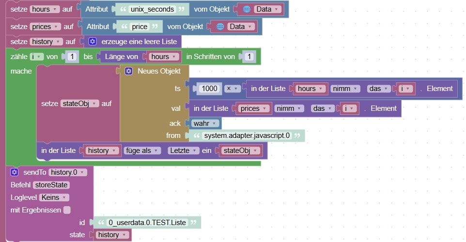

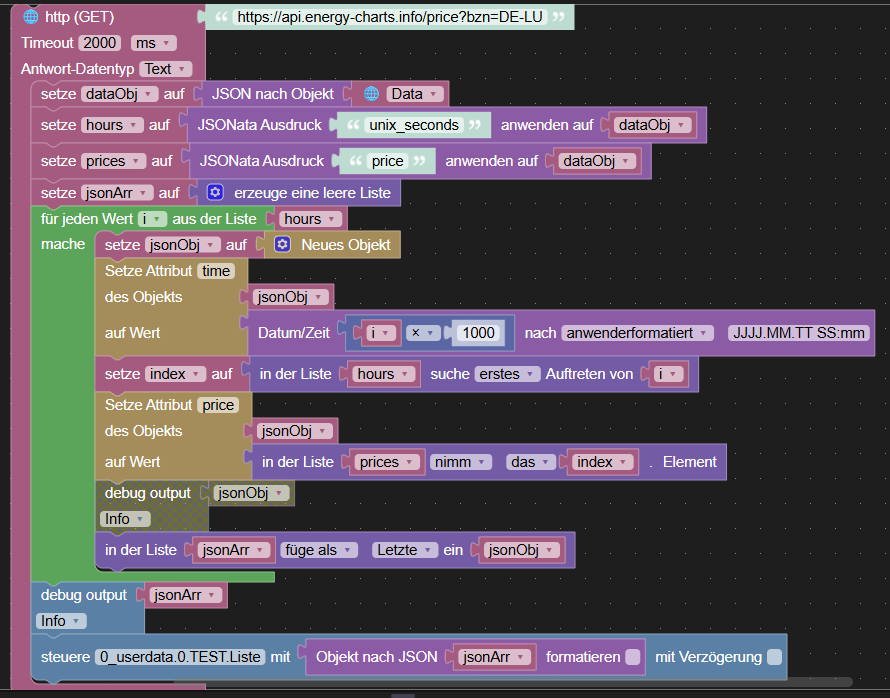

        MCU @BertDerKleine last edited by MCU

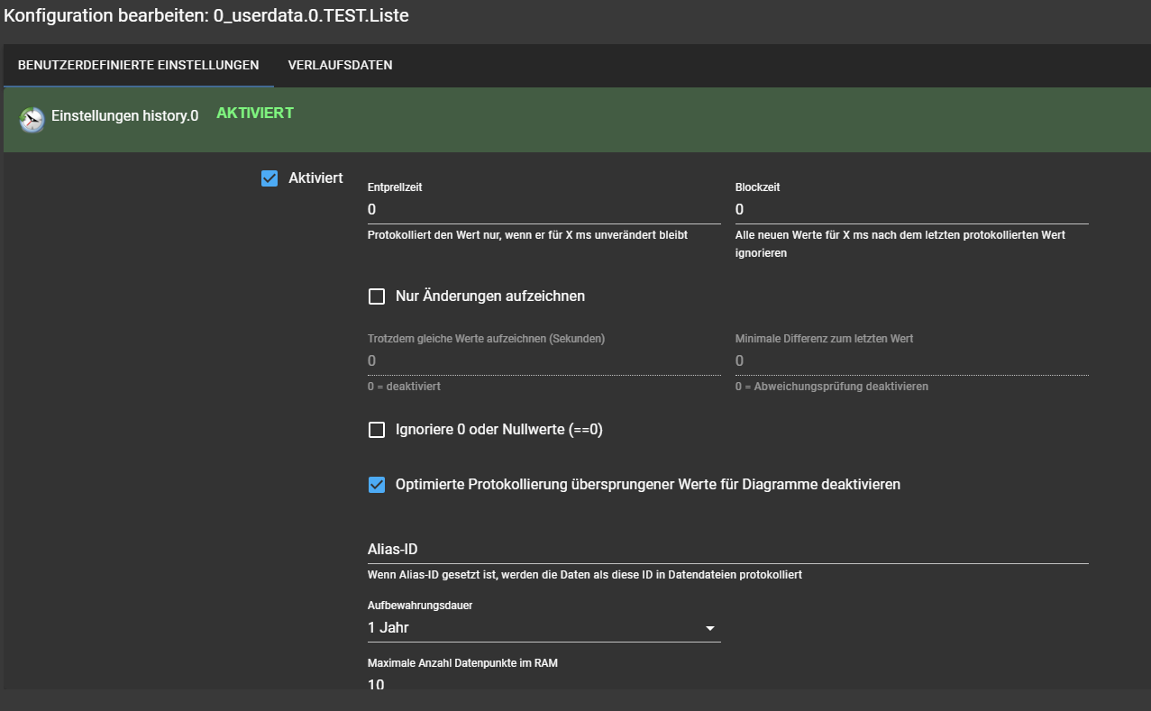

        @bertderkleine Beispiel zu 1)
        History für den verwenten DP anlegen hier:
        BILD passt nicht zum xml! Im xml ist die history mit eingebaut!
        Muss man dann 1x am Tag laufen lassen. nachts um 02.15 Uhr?
        <block xmlns="https://developers.google.com/blockly/xml" type="http_get" id="WubA_q?t^rOVN1Qzf(Ud" x="113" y="-62">
          <field name="TIMEOUT">2000</field>
          <field name="UNIT">ms</field>
          <field name="TYPE">text</field>
          <value name="URL">
            <shadow type="text" id="4n@aW9Eu_!6v]UX7vbJm">
              <field name="TEXT">https://api.energy-charts.info/price?bzn=DE-LU</field>
            <block type="variables_set" id="q(GI;H3H-6Gil%ZUUD`l">
              <field name="VAR" id="s{f!+[6b0uoiRp2^:zs2">dataObj</field>
                <block type="convert_json2object" id="/zI_a;?wL~s8b7-7=p^%">
                    <block type="http_response" id="O8b*b@wX2,l!5gn1vi@8">
                      <field name="ATTR">response.data</field>
                <block type="variables_set" id="pP_KB8dY8EAJ6}SH|N!^">
                  <field name="VAR" id="hw`M0@4ZK75sNU-wQ2mf">hours</field>
                    <block type="convert_jsonata" id="9f:nExdLo|@_S*bTX%jU">
                      <value name="EXPRESSION">
                        <shadow type="text" id="T{/k0+_i)?BrRa+ctWj9">
                          <field name="TEXT">unix_seconds</field>
                      <value name="TARGET">
                        <block type="variables_get" id="`wjbX)ltT92Z|_L]jG?^">
                    <block type="variables_set" id="#H~JJ{T%hi(L,{bVPy2m">
                      <field name="VAR" id="}FsWP+@#u}VQ4b8/)[:2">prices</field>
                        <block type="convert_jsonata" id="+%.|9$bdl_L,c;*u*Z]B">
                            <shadow type="text" id="ahs)t9X?Lc2;)Lf%:9rC">
                              <field name="TEXT">price</field>
                            <block type="variables_get" id="p![zq{K(pdd4RjP-I_$r">
                        <block type="variables_set" id="Ufji]:CBub6Yx.p`pN]f">
                          <field name="VAR" id="-~EO+XWJ9wY?!@R]0*O0">jsonArr</field>
                            <block type="lists_create_with" id="sC8Q#FVhcGi4,I7=}+E+">
                            <block type="controls_forEach" id="n26vmw#_)b5{trnAGfc7">
                              <field name="VAR" id="=Qe9w_-NZI=gDuyX-(P5">i</field>
                              <value name="LIST">
                                <block type="variables_get" id="sm~GA,g2oL+3!l9jYTl5">
                              <statement name="DO">
                                <block type="variables_set" id="5}~g_j@kMkiDr0]9HKsW">
                                  <field name="VAR" id="p7{GR]:*s^iRm(nY{IvA">jsonObj</field>
                                    <block type="object_new" id="ISQw{,1JAT4![hq_-M=m"></block>
                                    <block type="object_set_attr" id=";Gya@c}:d(ZAI`A%-jC+">
                                      <field name="ATTR">time</field>
                                      <value name="OBJECT">
                                        <block type="variables_get" id="9Mz7qy+`}dhOQzk7#[g#">
                                        <shadow type="text" id=")(n@S]MtpbL2|Sinc,X7">
                                          <field name="TEXT">value</field>
                                        <block type="convert_from_date" id="Rfw_YWIq_Gw_qVT!BMzK">
                                          <mutation xmlns="http://www.w3.org/1999/xhtml" format="true" language="false"></mutation>
                                          <field name="OPTION">custom</field>
                                          <field name="FORMAT">JJJJ.MM.TT SS:mm</field>
                                            <block type="math_arithmetic" id="gP9fa|N|L-pF(vr])T.)">
                                                <shadow type="math_number" id="z-jQmlOX2PAXg4RGdxz%">
                                                  <field name="NUM">1</field>
                                                <block type="variables_get" id="DiGj~c~W_f0}BIMRilb}">
                                                <shadow type="math_number" id="K[q*QXm49MYKtM=^3Bc#">
                                                  <field name="NUM">1000</field>
                                        <block type="variables_set" id="WoCf2a]I:C!mMl]5db$8">
                                          <field name="VAR" id="7yD2B-Fh1eiNM4@%(o#L">index</field>
                                            <block type="lists_indexOf" id="mi8o*!].|#Mra~*L42pS">
                                              <field name="END">FIRST</field>
                                                <block type="variables_get" id="TMcw]-Im7Qc`b]%S[TtL">
                                              <value name="FIND">
                                                <block type="variables_get" id="7/mmHa?[x:#!1xS$g{fZ">
                                            <block type="object_set_attr" id="GJ|V8v!Z:d)lU4YMK?+.">
                                              <field name="ATTR">price</field>
                                                <block type="variables_get" id="Y?qxVFM~FfK(%rJfZ8?4">
                                                <block type="lists_getIndex" id="_vy%IV*TmroOP-ingTl]">
                                                    <block type="variables_get" id="Y$l|0JcFGeGyvVuRM/WA">
                                                  <value name="AT">
                                                    <block type="variables_get" id="wp^p=VsN6+N$7=sU3rw1">
                                                <block type="debug" id="1fXlv.R`oXW1BIX)M;*." disabled-reasons="MANUALLY_DISABLED">
                                                  <field name="Severity">info</field>
                                                  <value name="TEXT">
                                                    <shadow type="text" id="#pSP=w|D(c$3Bc9eebs6">
                                                    <block type="variables_get" id="4SW_o82zc$9Q_[Vb+B%~">
                                                    <block type="variables_set" id="a.c=E|.h$wUjC.J^}7Z$">
                                                      <field name="VAR" id="jfV6^g`UsKLujK;PHL/W">stateObj</field>
                                                        <block type="object_new" id="N;!Ww6QA@n%g?w^F^}-L"></block>
                                                        <block type="object_set_attr" id=",%tBt=kGnMNY|bp_!kh7">
                                                          <field name="ATTR">ts</field>
                                                            <block type="variables_get" id="1DJ?Qi*+VLV^un;Eu={W">
                                                            <shadow type="text" id="XzylIx4bS8xB.XgY_Kt(">
                                                            <block type="math_arithmetic" id="8wgh#GuDMg1WU2bOTpoP">
                                                                <block type="variables_get" id="ojk6B+s6pV1T?#1X)0Os">
                                                                <shadow type="math_number" id="8ARPoQj#;4K44B)#)Bou">
                                                            <block type="object_set_attr" id=")U%21t7I9U*(c__RNT[=">
                                                                <block type="variables_get" id="3X5P!lZ1|t8kLnwg,w4^">
                                                                <block type="lists_getIndex" id="S-Qly;Ry*Nc{Q2UX*?RZ">
                                                                    <block type="variables_get" id="oj7h_e5hu)XV!1.oT=4d">
                                                                  <value name="AT">
                                                                    <block type="variables_get" id="`^l(!S1VHNq1SK/bL=u$">
                                                                <block type="sendto_custom" id="0FheG9#v?h8VK`A4gi8l">
                                                                  <mutation xmlns="http://www.w3.org/1999/xhtml" items="id,state"></mutation>
                                                                  <field name="INSTANCE">history.0</field>
                                                                  <field name="COMMAND">storeState</field>
                                                                  <field name="LOG"></field>
                                                                  <field name="WITH_STATEMENT">FALSE</field>
                                                                  <value name="ARG0">
                                                                    <shadow type="text" id="2S33q,Osc00],b?TvJ!_">
                                                                      <field name="TEXT">0_userdata.0.TEST.Liste</field>
                                                                  <value name="ARG1">
                                                                    <shadow type="text" id="m4yjk`fQkP^ktB27|_=f">
                                                                      <field name="TEXT"></field>
                                                                    <block type="variables_get" id="4z2RRH(}DDHVe?citK`9">
                                                                    <block type="lists_setIndex" id="`DNvt75jK}w1q{:maX][">
                                                                      <mutation at="false"></mutation>
                                                                      <field name="WHERE">LAST</field>
                                                                      <value name="LIST">
                                                                        <block type="variables_get" id="L0}f1xt(EQPGbUL,PQz=">
                                                                      <value name="TO">
                                                                        <block type="variables_get" id="fC%H$s`7M:IlEv`tip?7">
                                <block type="debug" id="K_qdH~gw%dG#qfG;5xJw" disabled-reasons="MANUALLY_DISABLED">
                                  <value name="TEXT">
                                    <shadow type="text" id="w8H|}@7vFQ3~Hef1#s+{">
                                    <block type="variables_get" id="u`_,D/K8E5enHcI3PWn$">
                                    <block type="control" id="mc%$a]6G7qobV=)]SDR(" disabled-reasons="MANUALLY_DISABLED">
                                      <field name="OID">0_userdata.0.TEST.Liste</field>
                                        <block type="convert_object2json" id="e4;%Ua.FJ-=H8@|[!9iV">
                                          <field name="PRETTIFY">FALSE</field>
                                            <block type="variables_get" id="`!a!zwUKn4!huvf9i/I(">

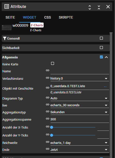

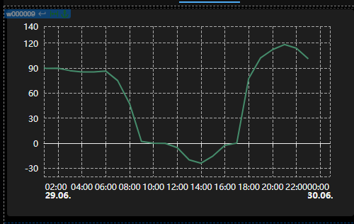

        zu 2)
        evtl legt man auch ein Preset in echarts an und wählt bar als Kurvenform aus.
        echarts Widget (VIS 2)
        Bar scheint dort nicht zu funktionieren?
        EDIT: Die Werte werden nicht um 00:00 aktualisiert? Auch um 01:00 keine neue Daten!
        Man muss die Zeit (start, end) mitgeben damit man die Werte erhält.
        paul53 1 Reply Last reply Reply Quote 2
          paul53 @MCU last edited by paul53
          @mcu sagte: history mit eingebaut!
          Man kann an History auch ein Array of states übergeben; etwa so:
          Anmerkung: Wenn man die Elemente aus korrespondieren Listen auswertet, ist die for-Schleife besser geeignet.
          BertDerKleine 1 Reply Last reply Reply Quote 3
