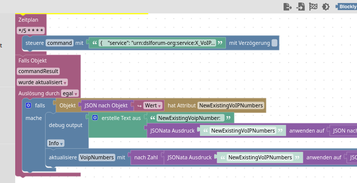

      Ich habe mir ein Blockly Script geschrieben, um über den TR-064 Adapter die Anzahl angemeldeter VOIP-Nummern auszulesen...
      Das scheint aber nicht zu klappen

      Mein Blockly Script meldet für die Zeit alle 3 Nummern als Verfügbar
      2025-07-18 01:45:00.142  - info: tr-064.0 (610760) {"NewExistingVoIPNumbers":"3"}
      2025-07-18 01:50:00.131  - info: tr-064.0 (610760) {"NewExistingVoIPNumbers":"3"}
      2025-07-18 01:55:00.074  - info: tr-064.0 (610760) {"NewExistingVoIPNumbers":"3"}
      2025-07-18 02:00:00.761  - info: tr-064.0 (610760) {"NewExistingVoIPNumbers":"3"}
      2025-07-18 02:05:00.090  - info: tr-064.0 (610760) {"NewExistingVoIPNumbers":"3"}
      2025-07-18 02:10:00.068  - info: tr-064.0 (610760) {"NewExistingVoIPNumbers":"3"}
      2025-07-18 02:15:00.095  - info: tr-064.0 (610760) {"NewExistingVoIPNumbers":"3"}
      2025-07-18 02:20:00.125  - info: tr-064.0 (610760) {"NewExistingVoIPNumbers":"3"}
      2025-07-18 02:25:00.143  - info: tr-064.0 (610760) {"NewExistingVoIPNumbers":"3"}
      2025-07-18 02:30:00.201  - info: tr-064.0 (610760) {"NewExistingVoIPNumbers":"3"}
      2025-07-18 02:35:00.137  - info: tr-064.0 (610760) {"NewExistingVoIPNumbers":"3"}
      2025-07-18 02:40:00.098  - info: tr-064.0 (610760) {"NewExistingVoIPNumbers":"3"}
      2025-07-18 02:45:00.197  - info: tr-064.0 (610760) {"NewExistingVoIPNumbers":"3"}
      2025-07-18 02:50:00.099  - info: tr-064.0 (610760) {"NewExistingVoIPNumbers":"3"}
      2025-07-18 02:55:00.278  - info: tr-064.0 (610760) {"NewExistingVoIPNumbers":"3"}
      2025-07-18 03:00:00.220  - info: tr-064.0 (610760) {"NewExistingVoIPNumbers":"3"}
      2025-07-18 03:05:00.078  - info: tr-064.0 (610760) {"NewExistingVoIPNumbers":"3"}
      2025-07-18 03:10:00.132  - info: tr-064.0 (610760) {"NewExistingVoIPNumbers":"3"}
      2025-07-18 03:15:00.120  - info: tr-064.0 (610760) {"NewExistingVoIPNumbers":"3"}
      2025-07-18 03:20:00.072  - info: tr-064.0 (610760) {"NewExistingVoIPNumbers":"3"}
      In "command" lege ich folgendes ab:
      {    "service": "urn:dslforum-org:service:X_VoIP:1",    "action": "GetExistingVoIPNumbers",    "params": {}  }
      Die "3" für den Normalbetrieb stimmt, aber im Fehlerfall sollte sich doch die gemeldete Anzahl verändern?
      Muss man da vielleicht statt "GetExisting...." etwas anderes abfragen?
