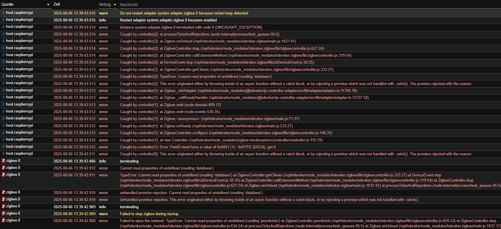

      ich hoffe ihr könnt mir weiterhelfen, leider startet mein Zigbee Adapter nicht mehr.
      Anbei das Protokoll
      Viele Grüße
      René

            @asgothian ```
            Gerne, hier ist der von dir bereitgestellte Log-Auszug, formatiert als Code-Block:
            2025-08-06 14:02:51.362  - error: zigbee.0 (3971) Serial port not selected! Go to settings page.
            2025-08-06 14:02:51.556  - info: zigbee.0 (3971)   --> transmitPower : normal
            2025-08-06 14:02:51.567  - error: zigbee.0 (3971) Unhandled promise rejection. This error originated either by throwing inside of an async function without a catch block, or by rejecting a promise which was not handled with .catch().
            2025-08-06 14:02:51.569  - error: zigbee.0 (3971) unhandled promise rejection: PanID must have a value of 0x0001 (1) - 0xFFFE (65534), got 121012.
            2025-08-06 14:02:51.601  - error: zigbee.0 (3971) Error: PanID must have a value of 0x0001 (1) - 0xFFFE (65534), got 121012.

            • Asgothian
              Asgothian Developer @Rene 5 last edited by
              @rene-5 sagte in iobroker Zigbee Adapter startet nicht:
              Das ist dein Fehler. Die Konfiguration hat eine falsche PanID
              A.
                Rene 5 @Asgothian last edited by
                @asgothian
                habe ich geändert, leider nichts gebracht

                2025-08-06 14:39:01.590  - error: zigbee.0 (19584) Unhandled promise rejection. This error originated either by throwing inside of an async function without a catch block, or by rejecting a promise which was not handled with .catch().
                2025-08-06 14:39:01.591  - error: zigbee.0 (19584) unhandled promise rejection: undefined
                2025-08-06 14:39:01.592  - error: zigbee.0 (19584) undefined
                2025-08-06 14:39:01.614  - info: zigbee.0 (19584) cleaned everything up...
                2025-08-06 14:39:01.615  - info: zigbee.0 (19584) local config saved
                2025-08-06 14:39:01.617  - info: zigbee.0 (19584) Saved local configuration data
                2025-08-06 14:39:01.618  - info: zigbee.0 (19584) terminating
                2025-08-06 14:39:01.619  - warn: zigbee.0 (19584) Terminated (UNCAUGHT_EXCEPTION): Without reason
                2025-08-06 14:39:01.979  - error: zigbee.0 (19584) Failed to open the network: TypeError: Cannot read properties of undefined (reading 'permitJoin')
                    at Controller.permitJoin (/opt/iobroker/node_modules/zigbee-herdsman/src/controller/controller.ts:315:35)
                    at ZigbeeController.permitJoin (/opt/iobroker/node_modules/iobroker.zigbee/lib/zigbeecontroller.js:659:33)
                    at ZigbeeController.stop (/opt/iobroker/node_modules/iobroker.zigbee/lib/zigbeecontroller.js:634:24)
                    at processTicksAndRejections (node:internal/process/task_queues:95:5)
                    at Zigbee.onUnload (/opt/iobroker/node_modules/iobroker.zigbee/main.js:1037:17)
                2025-08-06 14:39:01.991  - warn: zigbee.0 (19584) Failed to stop zigbee during startup
                2025-08-06 14:39:02.004  - info: zigbee.0 (19584) terminating
                2025-08-06 14:39:02.008  - warn: zigbee.0 (19584) Device 0x00158d00049ddc62 "RTCGQ01LM" not found.
                2025-08-06 14:39:02.009  - warn: zigbee.0 (19584) Device 0x00158d0006fe3c6b "MCCGQ11LM" not found.
                2025-08-06 14:39:02.009  - warn: zigbee.0 (19584) Device 0x00158d00079b4ae2 "RTCGQ01LM" not found.
                2025-08-06 14:39:02.010  - warn: zigbee.0 (19584) Device 0x00158d0007e62e89 "MCCGQ11LM" not found.
                2025-08-06 14:39:02.011  - warn: zigbee.0 (19584) Device 0x00158d000705d22a "MCCGQ11LM" not found.
                2025-08-06 14:39:02.011  - warn: zigbee.0 (19584) Device 0x00158d0007105f70 "MCCGQ11LM" not found.
                2025-08-06 14:39:02.012  - warn: zigbee.0 (19584) Device 0x00158d0008647c37 "MCCGQ11LM" not found.
                2025-08-06 14:39:02.013  - warn: zigbee.0 (19584) Device 0x00158d000839178d "MCCGQ11LM" not found.
                2025-08-06 14:39:02.014  - warn: zigbee.0 (19584) Device 0x00158d0008391686 "MCCGQ11LM" not found.
                2025-08-06 14:39:02.014  - warn: zigbee.0 (19584) Device 0x00158d00083911cb "MCCGQ11LM" not found.
                2025-08-06 14:39:02.015  - warn: zigbee.0 (19584) Device 0x00158d0008647d3a "MCCGQ11LM" not found.
                2025-08-06 14:39:02.016  - warn: zigbee.0 (19584) Device 0x00158d0008647cc2 "MCCGQ11LM" not found.
                2025-08-06 14:39:02.017  - warn: zigbee.0 (19584) Device 0x00158d00079b4b30 "RTCGQ01LM" not found.
                2025-08-06 14:39:02.017  - warn: zigbee.0 (19584) Device 0x00158d000445eef5 "RTCGQ01LM" not found.
                2025-08-06 14:39:02.018  - warn: zigbee.0 (19584) Device 0x00158d0002249bc9 "RTCGQ01LM" not found.
                2025-08-06 14:39:02.018  - warn: zigbee.0 (19584) Device 0x00158d0007ec8e79 "MCCGQ11LM" not found.
                2025-08-06 14:39:02.031  - warn: zigbee.0 (19584) Device 0x00158d0002f046e0 "RTCGQ01LM" not found.
                2025-08-06 14:39:02.032  - warn: zigbee.0 (19584) Device 0xf4b3b1fffe51b415 "SWV" not found.
                2025-08-06 14:39:02.083  - warn: zigbee.0 (19584) Device 0xa4c138055725ef44 "ZWV-YC" not found.
                2025-08-06 14:39:02.097  - warn: zigbee.0 (19584) Device 0xa4c138af3c4215ae "809WZT" not found.
                2025-08-06 14:39:02.106  - warn: zigbee.0 (19584) Device 0xa4c138f559c67459 "A1Z" not found.
                2025-08-06 14:39:02.107  - warn: zigbee.0 (19584) Device 0xa4c13840ac5ea693 "A1Z" not found.
                2025-08-06 14:39:02.107  - warn: zigbee.0 (19584) Device 0xa4c138a48fbe67af "A1Z" not found.
                2025-08-06 14:39:02.108  - warn: zigbee.0 (19584) Device 0xa4c138f4953fb3f8 "A1Z" not found.
                2025-08-06 14:39:02.135  - info: zigbee.0 (19584) terminating
                2025-08-06 14:39:02.157  - warn: zigbee.0 (19584) redis get zigbee.0.info.debugmessages, error - DB closed
                2025-08-06 14:39:02.242  - warn: zigbee.0 (19584) get state error: Connection is closed.
                2025-08-06 14:39:02.243  - warn: zigbee.0 (19584) get state error: Connection is closed.
                2025-08-06 14:39:02.360  - error: host.raspberrypi Caught by controller[0]: This error originated either by throwing inside of an async function without a catch block, or by rejecting a promise which was not handled with .catch(). The promise rejected with the reason:
                2025-08-06 14:39:02.360  - error: host.raspberrypi Caught by controller[1]: Error herdsman start
                2025-08-06 14:39:02.361  - error: host.raspberrypi instance system.adapter.zigbee.0 terminated with code 6 (UNCAUGHT_EXCEPTION)
                2025-08-06 14:39:02.361  - info: host.raspberrypi Restart adapter system.adapter.zigbee.0 because enabled

                              Thomas Braun Most Active @Rene 5 last edited by
                              Error: Device or resource busy
                              Starte die Kiste mal neu. Läuft da vielleicht noch der deconz-Kram prallel?
                                Rene 5 @Thomas Braun last edited by
                                @thomas-braun
                                habe den deconz deinstalliert und jetzt läuft es, danke!
                                  @rene-5
                                  Auf serielle Geräte kann immer nur einer zugreifen.
                                  • Asgothian
                                    Asgothian Developer @Rene 5 last edited by Asgothian
                                    Starting zigbee-herdsman problem : Error while opening serialport 'Error: Error: Device or resource busy, cannot open /dev/serial/by-id/usb-dresden_elektronik_ingenieurtechnik_GmbH_ConBee_II_DE2448975-if00'
                                    Lesen scheint immer noch nicht Deins zu sein. Das Log sagt ganz deutlich warum es nicht geht.
                                    A.
