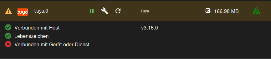

      Mein io-Broker läuft als Docker in einer Synology Nas.
      Der installierte Tuya Adapter zeigt folgendes:

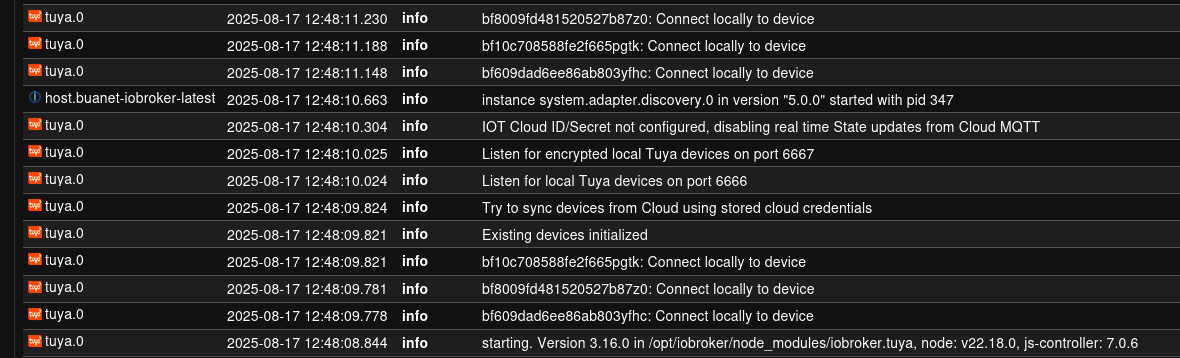

      Dbug Log:
      tuya.0
      	2025-08-15 17:47:41.337	info	bf10c708588fe2f665pgtk: Connect locally to device
      tuya.0
      	2025-08-15 17:47:41.294	info	bf8009fd481520527b87z0: Connect locally to device
      tuya.0
      	2025-08-15 17:47:40.384	info	bf609dad6ee86ab803yfhc: Connect locally to device
      tuya.0
      	2025-08-15 17:47:39.965	info	IOT Cloud ID/Secret not configured, disabling real time State updates from Cloud MQTT
      tuya.0
      	2025-08-15 17:47:39.739	info	Listen for encrypted local Tuya devices on port 6667
      tuya.0
      	2025-08-15 17:47:39.738	info	Listen for local Tuya devices on port 6666
      tuya.0
      	2025-08-15 17:47:39.532	info	Try to sync devices from Cloud using stored cloud credentials
      tuya.0
      	2025-08-15 17:47:39.529	info	Existing devices initialized
      tuya.0
      	2025-08-15 17:47:39.528	info	bf609dad6ee86ab803yfhc: Connect locally to device
      tuya.0
      	2025-08-15 17:47:39.527	info	bf10c708588fe2f665pgtk: Connect locally to device
      tuya.0
      	2025-08-15 17:47:39.487	info	bf8009fd481520527b87z0: Connect locally to device
      tuya.0
      	2025-08-15 17:47:38.552	info	starting. Version 3.16.0 in /opt/iobroker/node_modules/iobroker.tuya, node: v22.18.0, js-controller: 7.0.6
      host.buanet-iobroker
      	2025-08-15 17:47:36.414	info	instance system.adapter.tuya.0 in version "3.16.0" started with pid 11037
      	2025-08-15 17:47:28.621	info	instance system.adapter.tuya.0 terminated with code 11 (ADAPTER_REQUESTED_TERMINATION)
      tuya.0
      	2025-08-15 17:47:28.080	info	Terminated (ADAPTER_REQUESTED_TERMINATION): Without reason
      tuya.0
      	2025-08-15 17:47:28.079	info	terminating
      	2025-08-15 17:47:25.114	info	stopInstance system.adapter.tuya.0 send kill signal
      tuya.0
      	2025-08-15 17:47:25.076	info	Got terminate signal TERMINATE_YOURSELF
      	2025-08-15 17:47:25.073	info	stopInstance system.adapter.tuya.0 (force=false, process=true)
      tuya.0
      	2025-08-15 17:47:25.064	info	Set data for tuya.0 to appDeviceId=hwihbsdshylho8a4qt0dtjhfvi555113rux8psesml61 / sid=eu175033N2830543eq4dzkm3ddf409efd1973b2032d1820836b12d0b. Restart adapter now!
      tuya.0
      	2025-08-15 17:47:25.064	info	Cloud login successful. Adapter restarts in 5s
      tuya.0
      	2025-08-15 17:47:22.142	info	Listen for encrypted local Tuya devices on port 6667
      tuya.0
      	2025-08-15 17:47:22.141	info	Listen for local Tuya devices on port 6666
      tuya.0
      	2025-08-15 17:47:21.942	info	Try to sync devices from Cloud using stored cloud credentials
      tuya.0
      	2025-08-15 17:47:21.939	info	Existing devices initialized
      tuya.0
      	2025-08-15 17:47:21.938	info	bf609dad6ee86ab803yfhc: Connect locally to device
      tuya.0
      	2025-08-15 17:47:21.933	info	bf10c708588fe2f665pgtk: Connect locally to device
      tuya.0
      	2025-08-15 17:47:21.888	info	bf8009fd481520527b87z0: Connect locally to device
      tuya.0
      	2025-08-15 17:47:21.013	info	starting. Version 3.16.0 in /opt/iobroker/node_modules/iobroker.tuya, node: v22.18.0, js-controller: 7.0.6

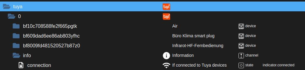

      die Daten werden im Objekt-bereich angezeigt:
      Frage:
      wie bekomm ich verbunden mit Gerät auf Grün, wenn doch Objekte angezeigt werden und lokal alles Verbunden ist?
      Was mach ich falsch??

        Thomas Braun Most Active @FS1567 last edited by
        @fs1567
        Dürfte damit zusammen hängen:

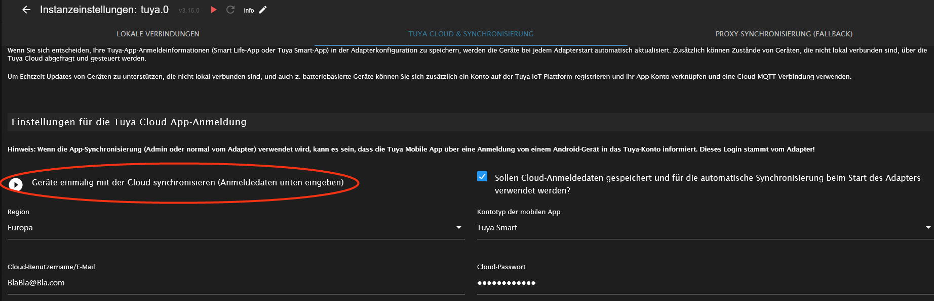

          CatShape @FS1567 last edited by CatShape
          @fs1567
          Ich würde Dir empfehlen, das zu machen, was in den Adapter-Instanzeinstellungen steht:
          Ich vermute, dass der Adapter den jeweiligen "localKey" Deiner Geräte nicht kennt, oder einen veralteten/ungültigen gespeichert hat. Um die aktuellen "localKeys" zu erhalten, musst Du eben in den Instanz-Einstellungen die Geräte einmalig mit der Cloud synchronisieren.
          Ich glaube der "localKey" von einem Tuya-Gerät ist nur solange gültig bis Du das Gerät resettest und/oder neu in die Tuya-App einbindest. Beim ausführen einer solchen Aktion bekommt das Gerät einen neuen "localKey". Und deshalb muss sich der Adapter nach einer solchen Aktion diesen neuen "localKey" auch erstmal wieder aus der Cloud besorgen.

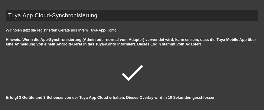

            FS1567 @CatShape last edited by
            @catshape
            Danke für die Antwort
            hab ich gemacht, mit Erfolg, aber keine Wirkung auf die Instanz!

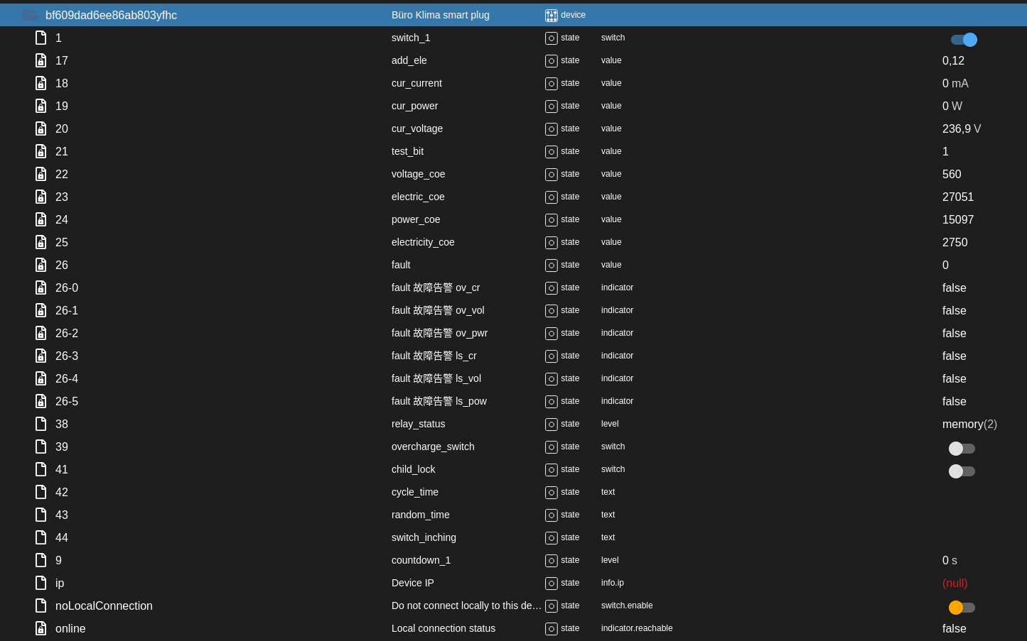

                  so hier die Objekt-Daten des smartPlugin Netzsteckers:
                  Local connect flase ist richtig, da ich die Ports im Docker nicht freigegeben habe. --> hilft das?
                  Zeigt er mir dehalb keine IP-Adresse an?

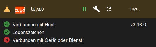

                      hab nen Neustart gemacht und bei Tuya bleibt alles beim alten:
