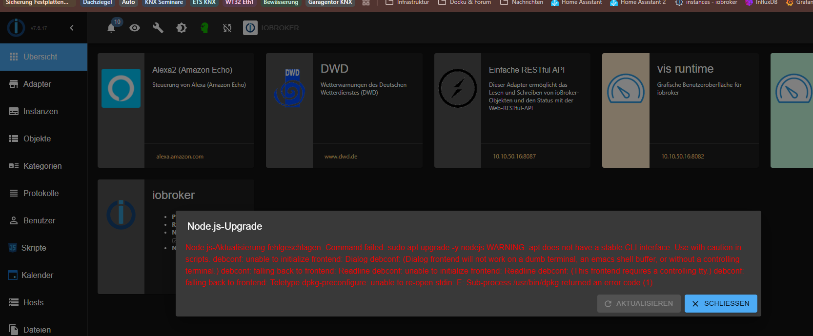

    4. js Controler auf 7.07 geht nicht Fehlermeldung iOb
    • marcel-drzal
      marcel-drzal last edited by marcel-drzal
      2025-08-22 15:13:55.721 - error: host.iobroker iobroker npm error code EBADENGINEnpm error engine Unsupported enginenpm error engine Not compatible with your version of node/npm: @homebridge/ciao@1.2.0npm error notsup Not compatible with your version of node/npm: @homebridge/ciao@1.2.0npm error notsup Required: {"node":"^18 || ^20"}npm error notsup Actual: {"npm":"10.9.3","node":"v22.18.0"}npm error A complete log of this run can be found in: /home/iobroker/.npm/_logs/2025-08-22T13_13_53_260Z-debug-0.log
      2025-08-22 15:13:55.721 - error: host.iobroker iobroker host.iobroker Cannot install iobroker.myuplink@0.8.4: 1
      2025-08-22 15:13:56.732 - info: host.iobroker iobroker exit 25
      2025-08-22 15:14:49.833 - info: influxdb.0 (24581) Do not store value "{"Time":"2025-08-22T14:14:48","Haus":{"Tariflos":0.0000,"Energy":332,"Power_p1":23,"Power_p2":95,"Power_p3":214},"Heizung":{"Tariflos":10418.5469,"Energy":0,"Power_p1":0,"Power_p2":0,"Power_p3":0}}" for StromHaus because no number
      2025-08-22 15:14:50.069 - info: host.iobroker Updating repository "Stable (default)" under "http://download.iobroker.net/sources-dist.json"
      2025-08-22 15:14:58.547 - info: host.iobroker iobroker upgrade yahka@1.1.5 --debug

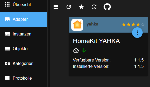

      2025-08-22 15:14:59.206 - info: host.iobroker iobroker Update yahka from @1.0.3 to @1.1.5
      2025-08-22 15:14:59.275 - info: host.iobroker iobroker NPM version: 10.9.3
      2025-08-22 15:14:59.275 - info: host.iobroker iobroker Installing iobroker.yahka@1.1.5... (System call)
      2025-08-22 15:15:05.132 - info: host.iobroker iobroker added 1 package, removed 1 package, and changed 19 packages in 6s408 packages are looking for funding run `npm fund` for details
      2025-08-22 15:15:06.399 - error: host.iobroker iobroker Cannot install "pam-devel": WARNING: apt does not have a stable CLI interface. Use with caution in scripts.E: Unable to locate package pam-devel
      2025-08-22 15:15:06.399 - error: host.iobroker iobroker The following apt packages could not be installed: pam-devel. Please install them manually.

        marcel-drzal 2 Replies Last reply Reply Quote 1
        • marcel-drzal
          marcel-drzal @Thomas Braun last edited by marcel-drzal
          @thomas-braun habe ich versucht aber nicht hin bekommen
          bleibt immer hängen

                              • mcm1957
                                mcm1957 @marcel-drzal last edited by mcm1957
                                @marcel-drzal
                                Zum Zeitpunkt der Fehlermeldung war yahka aber installiert.Bist du sicher, dass du den ADAPTER und nicht nur die INSTANZ gelöscht hast?
                                EDIT:
                                Lt iob diag in commentar https://forum.iobroker.net/topic/81995/js-controler-auf-7-07-geht-nicht-fehlermeldung-iob/12 hast du jetzt yahka 1.1.5 installiert - allerdings ohne aktive instanz.
                                Du hast also offensichtlich nur die Instanz gelöscht 🙂
                                @Thomas-Braun
                                Anregung für iob diag: Warnung bei Adaptern die installiert sind aber keine Instanz besitzen wär zu überlegen.
                                marcel-drzal Thomas Braun 3 Replies Last reply Reply Quote 0

                                  • mcm1957
                                    @marcel-drzal
                                    Yep ist installiert. Wenn du ihn nicht mehr benutzt solltest du ihn deinstallieren.

                                        • marcel-drzal
                                          marcel-drzal @mcm1957 last edited by marcel-drzal
                                          @mcm1957 Adapter habe ich gelöscht
                                          habe nun einen error:
                                          dpkg: error
                                          470 upgraded, 165 newly installed, 34 to remove and 0 not upgraded.
                                          Need to get 0 B/341 MB of archives.
                                          After this operation, 743 MB of additional disk space will be used.
                                          Do you want to continue? [Y/n] Y
                                          Reading changelogs... Done
                                          Extracting templates from packages: 100%
                                          Preconfiguring packages ...
                                          (Reading database ... 43860 files and directories currently installed.)
                                          Preparing to unpack .../base-files_13.8_amd64.deb ...
                                          * The base-files package cannot be installed because
                                          * /bin is a directory, but should be a symbolic link.
                                          * Please install the usrmerge package to convert this system to merged-/usr.
                                          * For more information please read https://wiki.debian.org/UsrMerge.
                                          dpkg: error processing archive /var/cache/apt/archives/base-files_13.8_amd64.deb               (--unpack):
                                           new base-files package pre-installation script subprocess returned error exit s              tatus 1
                                          Errors were encountered while processing:
                                          E: Sub-process /usr/bin/dpkg returned an error code (1)
                                            Thomas Braun Most Active @marcel-drzal last edited by
                                            @marcel-drzal
                                            dpkg ist aber das Paketmanagement auf OS-Ebene. Da ist also eine Etage tiefer schon was schief.
                                            sudo apt update
                                            sagt?
                                            marcel-drzal 1 Reply Last reply Reply Quote 0
