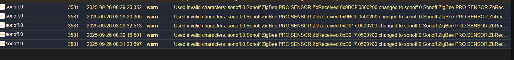

      Hallo Zusammen,
      ich habe auch seit einiger Zeit das Problem das ich Sonderzeichen von meinem Sonoff Zigbee Pro
      Tasmota bekomme.
      Da besschwert sich mein Sonoff Adapter und ich weis nicht wie ich das behebe, bitt um Hilfe.
      	3581	2025-09-26 08:29:20.352	warn	Used invalid characters: sonoff.0.Sonoff ZigBee PRO.SENSOR.ZbReceived.0x9BCF.0500?00 changed to sonoff.0.Sonoff ZigBee PRO.SENSOR.ZbReceived.0x9BCF.0500_00
      sonoff.0
      	3581	2025-09-26 08:29:20.365	warn	Used invalid characters: sonoff.0.Sonoff ZigBee PRO.SENSOR.ZbReceived.0x9BCF.0500?00 changed to sonoff.0.Sonoff ZigBee PRO.SENSOR.ZbReceived.0x9BCF.0500_00
      sonoff.0
      	3581	2025-09-26 08:29:32.513	warn	Used invalid characters: sonoff.0.Sonoff ZigBee PRO.SENSOR.ZbReceived.0xD017.0500?00 changed to sonoff.0.Sonoff ZigBee PRO.SENSOR.ZbReceived.0xD017.0500_00
      sonoff.0
      	3581	2025-09-26 08:30:16.581	warn	Used invalid characters: sonoff.0.Sonoff ZigBee PRO.SENSOR.ZbReceived.0xD017.0500?00 changed to sonoff.0.Sonoff ZigBee PRO.SENSOR.ZbReceived.0xD017.0500_00
      sonoff.0
      	3581	2025-09-26 08:31:23.697	warn	Used invalid characters: sonoff.0.Sonoff ZigBee PRO.SENSOR.ZbReceived.0xD017.0500?00 changed to sonoff.0.Sonoff ZigBee PRO.SENSOR.ZbReceiv
      MfG
      • haselchen
        haselchen Most Active @acidsubway last edited by
        @acidsubway
        Laut Log hat der Adapter den Datenpunkt korrigiert .
        Guck mal in den Objektbaum ob da neue DP angelegt oder geändert wurden.
