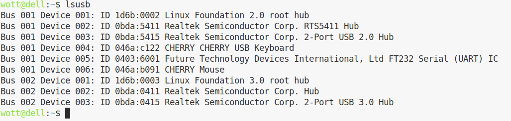

            root@dell:~# lsusb
            Bus 001 Device 001: ID 1d6b:0002 Linux Foundation 2.0 root hub
            Bus 001 Device 002: ID 0bda:5411 Realtek Semiconductor Corp. RTS5411 Hub
            Bus 001 Device 003: ID 0bda:5415 Realtek Semiconductor Corp. 2-Port USB 2.0 Hub
            Bus 001 Device 004: ID 046a:c122 CHERRY CHERRY USB Keyboard
            Bus 001 Device 005: ID 046a:b091 CHERRY Mouse
            Bus 001 Device 006: ID 0403:6001 Future Technology Devices International, Ltd FT232 Serial (UART) IC
            Bus 002 Device 001: ID 1d6b:0003 Linux Foundation 3.0 root hub
            Bus 002 Device 002: ID 0bda:0411 Realtek Semiconductor Corp. Hub
            Bus 002 Device 003: ID 0bda:0415 Realtek Semiconductor Corp. 2-Port USB 3.0 Hub
            root@dell:~#
            In Zeile 7 wird vom BS der NanoCUL V3 gelistet.

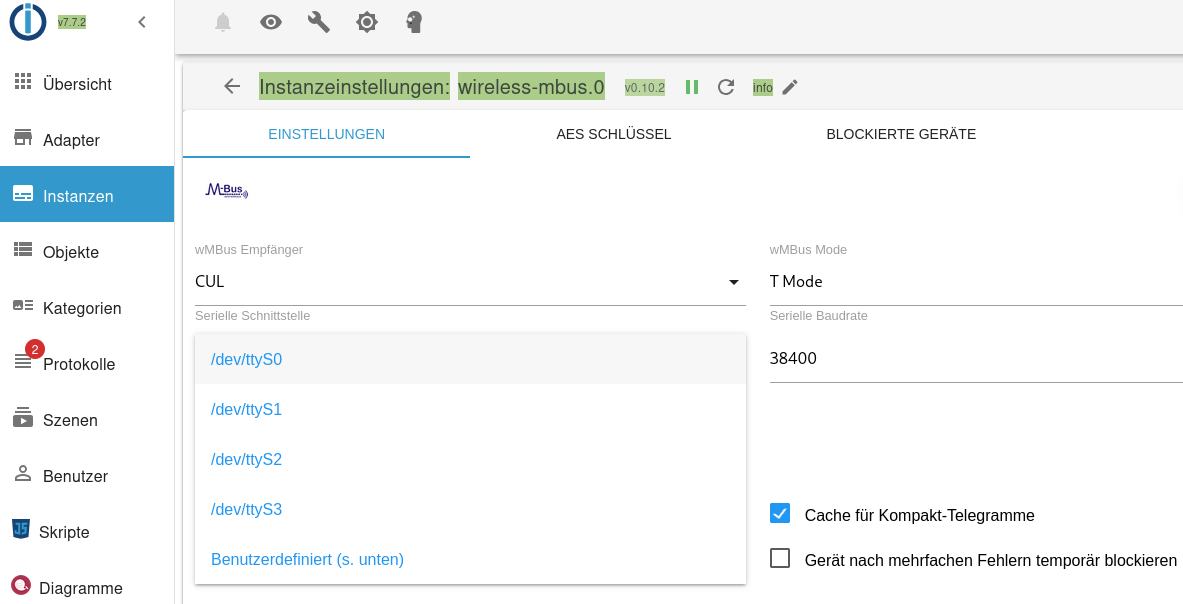

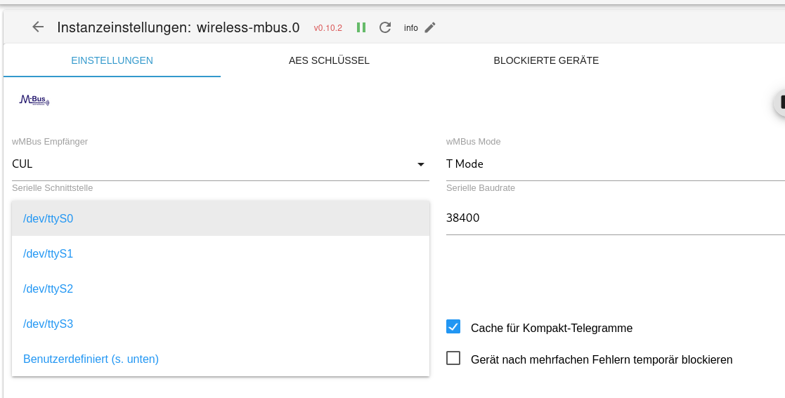

            Jedoch im Setting der Wireless Mbus Instanz fehlt die Auswahlmöglichkeit:

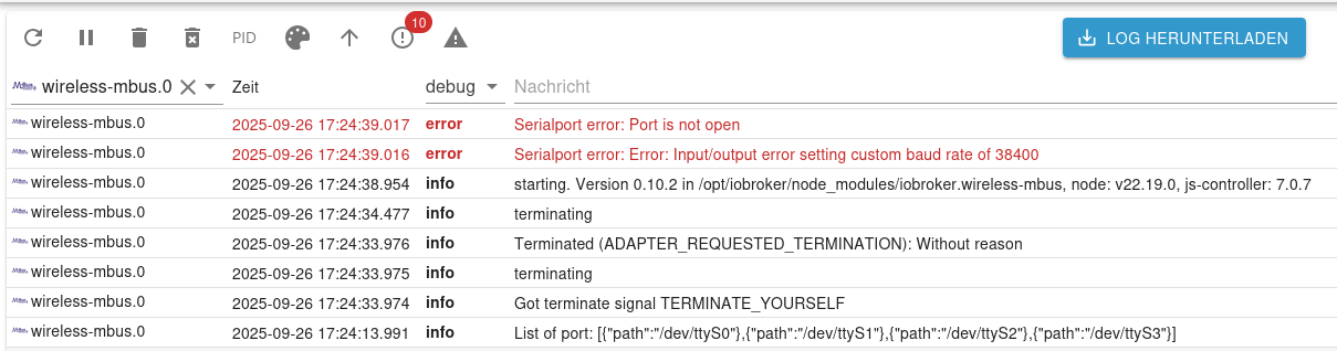

            	2025-09-27 08:40:15.808	error	Serialport error: Port is not open
            wireless-mbus.0
            	2025-09-27 08:40:15.807	error	Serialport error: Error: Input/output error setting custom baud rate of 38400
            wireless-mbus.0
            	2025-09-27 08:40:15.770	info	starting. Version 0.10.2 in /opt/iobroker/node_modules/iobroker.wireless-mbus, node: v22.20.0, js-controller: 7.0.7
            wireless-mbus.0
            	2025-09-27 08:40:11.149	info	terminating
            wireless-mbus.0
            	2025-09-27 08:40:10.648	info	Terminated (ADAPTER_REQUESTED_TERMINATION): Without reason
            wireless-mbus.0
            	2025-09-27 08:40:10.647	info	terminating
            wireless-mbus.0
            	2025-09-27 08:40:10.645	info	Got terminate signal TERMINATE_YOURSELF
            wireless-mbus.0
            	2025-09-27 08:32:39.873	info	List of port: [{"path":"/dev/ttyS0"},{"path":"/dev/ttyS1"},{"path":"/dev/ttyS2"},{"path":"/dev/ttyS3"}]
            Die List of port enthält leider keine Angabe ...path": ..... usb oder serial.

                  [Sa Sep 27 08:15:12 2025] ftdi_sio 1-6.2:1.0: FTDI USB Serial Device converter detected
                  [Sa Sep 27 08:15:12 2025] usb 1-6.2: Detected FT232R
                  [Sa Sep 27 08:15:12 2025] dcdbas dcdbas: Dell Systems Management Base Driver (version 5.6.0-3.4)
                  [Sa Sep 27 08:15:12 2025] usb 1-6.2: FTDI USB Serial Device converter now attached to ttyUSB0
