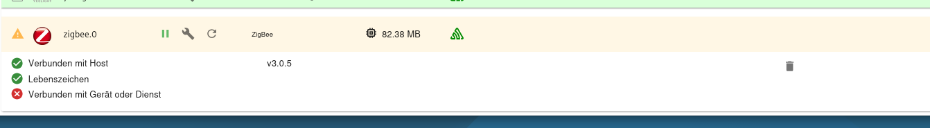

      iobroker läuft jetzt im dockercontainer im hostmodus, kann aber noch nicht auf den Zigbee-Stick zugreifen.
      Was muss noch anpasst werden?

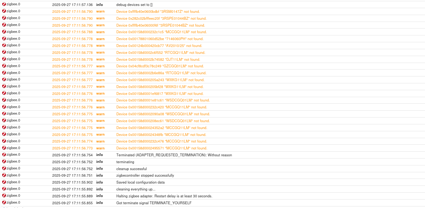

          hab nach dieser Anleitung eben noch das docker-compose-file
          angepasst: https://blog.buanet.de/posts/2023/03/02_usb-geraete_im_iobroker_docker_container/
          log sieht so aus:
            Homoran Global Moderator Administrators @xbow42 last edited by Homoran

              zigbee.0
              	2025-09-27 17:12:34.096	error	Error herdsman start
              zigbee.0
              	2025-09-27 17:12:34.095	error	Starting zigbee-herdsman problem : Error: No such file or directory, cannot open /dev/serial/by-id/usb-ITead_Sonoff_Zigbee_3.0_USB_Dongle_Plus_e8f9074b1a3bec11be179c957a0af07f-if00-port0
              zigbee.0
              	2025-09-27 17:12:34.064	info	Unable to obtain herdsman settings
              zigbee.0
              	2025-09-27 17:12:33.782	info	Starting Zigbee-Herdsman
              zigbee.0
              	2025-09-27 17:12:33.781	info	configured transmit power : normal
              zigbee.0
              	2025-09-27 17:12:33.779	info	Installed Version: iobroker.zigbee@3.0.5 (Converters 24.8.0 Herdsman 4.4.1)
              zigbee.0
              	2025-09-27 17:12:33.759	info	Starting Adapter npm ...
              zigbee.0
              	2025-09-27 17:12:33.758	info	Autostart Zigbee subsystem
              zigbee.0
              	2025-09-27 17:12:33.758	info	--- creating device debug ---
              zigbee.0
              	2025-09-27 17:12:33.704	info	init localConfig
              zigbee.0
              	2025-09-27 17:12:33.703	info	Adapter ready - starting subsystems. Adapter is running in info mode.
              zigbee.0
              	2025-09-27 17:12:33.673	info	starting. Version 3.0.5 in /opt/iobroker/node_modules/iobroker.zigbee, node: v22.19.0, js-controller: 7.0.7
              zigbee.0
              	2025-09-27 17:11:57.136	info	debug devices set to []
              zigbee.0
              	2025-09-27 17:11:56.790	warn	Device 0xffffb40e0600bdbf "3RSM0147Z" not found.
              zigbee.0
              	2025-09-27 17:11:56.790	warn	Device 0x282c02bfffeec20f "3RSPE01044BZ" not found.
              zigbee.0
              	2025-09-27 17:11:56.790	warn	Device 0xffffb40e06000f6f "3RSPE01044BZ" not found.
              zigbee.0
              	2025-09-27 17:11:56.788	warn	Device 0x00158d000232c1c5 "MCCGQ11LM" not found.
              zigbee.0
              	2025-09-27 17:11:56.778	warn	Device 0x00178801060d52be "7146060PH" not found.
              zigbee.0
              	2025-09-27 17:11:56.778	warn	Device 0x00124b000420cb77 "AV2010/25" not found.
              zigbee.0
              	2025-09-27 17:11:56.778	warn	Device 0x00158d0002c6f552 "RTCGQ11LM" not found.
              zigbee.0
              	2025-09-27 17:11:56.778	warn	Device 0x00158d0002b74582 "DJT11LM" not found.
              zigbee.0
              	2025-09-27 17:11:56.777	warn	Device 0x04cf8cdf3c78c249 "GZCGQ01LM" not found.
              zigbee.0
              	2025-09-27 17:11:56.777	warn	Device 0x00158d0002b6e86a "RTCGQ11LM" not found.
              zigbee.0
              	2025-09-27 17:11:56.777	warn	Device 0x00158d000205a243 "WXKG11LM" not found.
              zigbee.0
              	2025-09-27 17:11:56.777	warn	Device 0x00158d000205bf28 "WXKG11LM" not found.
              zigbee.0
              	2025-09-27 17:11:56.776	warn	Device 0x00158d0001ef6817 "WXKG11LM" not found.
              zigbee.0
              	2025-09-27 17:11:56.776	warn	Device 0x00158d0001e81c61 "WSDCGQ01LM" not found.
              zigbee.0
              	2025-09-27 17:11:56.776	warn	Device 0x00158d000232c420 "MCCGQ11LM" not found.
              zigbee.0
              	2025-09-27 17:11:56.775	warn	Device 0x00158d0002090a08 "WSDCGQ01LM" not found.
              zigbee.0
              	2025-09-27 17:11:56.775	warn	Device 0x00158d000208ec61 "WSDCGQ01LM" not found.
              zigbee.0
              	2025-09-27 17:11:56.775	warn	Device 0x00158d00024352a2 "MCCGQ11LM" not found.
              zigbee.0
              	2025-09-27 17:11:56.775	warn	Device 0x00158d00024348fb "MCCGQ11LM" not found.
              zigbee.0
              	2025-09-27 17:11:56.774	warn	Device 0x00158d000232c476 "MCCGQ11LM" not found.
              zigbee.0
              	2025-09-27 17:11:56.773	warn	Device 0x00158d0002495571 "MCCGQ11LM" not found.
              zigbee.0
              	2025-09-27 17:11:56.754	info	Terminated (ADAPTER_REQUESTED_TERMINATION): Without reason
              zigbee.0
              	2025-09-27 17:11:56.752	info	terminating
              zigbee.0
              	2025-09-27 17:11:56.752	info	cleanup successful
              zigbee.0
              	2025-09-27 17:11:56.751	info	zigbecontroller stopped successfully
              zigbee.0
              	2025-09-27 17:11:55.902	info	Saved local configuration data
              zigbee.0
              	2025-09-27 17:11:55.892	info	cleaning everything up...
              zigbee.0
              	2025-09-27 17:11:55.889	info	Halting zigbee adapter. Restart delay is at least 30 seconds.
              zigbee.0
              	2025-09-27 17:11:55.855	info	Got terminate signal TERMINATE_YOURSELF```

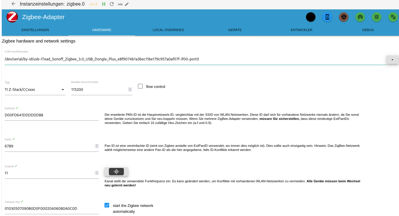

                Thomas Braun Most Active @xbow42 last edited by
                @xbow42 sagte in Zigbee-Stick-Zugriff für (iobroker-docker-container):
                Die Datei gibt es nicht.
                X 1 Reply Last reply Reply Quote 0
                • X
                  xbow42 @Thomas Braun last edited by xbow42
                  @thomas-braun
                  ich hab in der Adapterconfig bei COM-Anschlussname von /dev/serial/by-id... auf /dev/ttyUSB0 umgestellt. läuft.
                  Jetzt muss ich nur hoffen, dass beim Neustart der Alias-link für den Stick immer auf ttyUSB0 bleibt.
                  Kann man das mit irgend einer Einstellung erzwingen?
                  Thomas Braun haselchen 2 Replies Last reply Reply Quote 0
