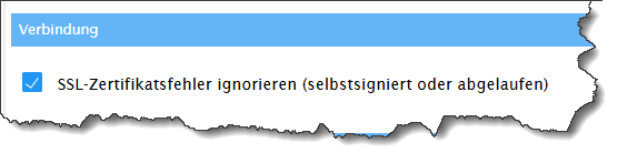

                  Stört er sich vielleicht am "self-signed-certificate"? Das kann man bei "originalen" Adapter ignorieren.
                  Scrounger 1 Reply Last reply Reply Quote 0
                  • Scrounger
                    Scrounger Developer @Codierknecht last edited by Scrounger
                    @codierknecht
                    Ssl fehler werden standardmößig ignoriert.
                    Bitte Adapter auf debug stellen und dann ein issue auf github mit allen relevanten Infos bereitstellen.

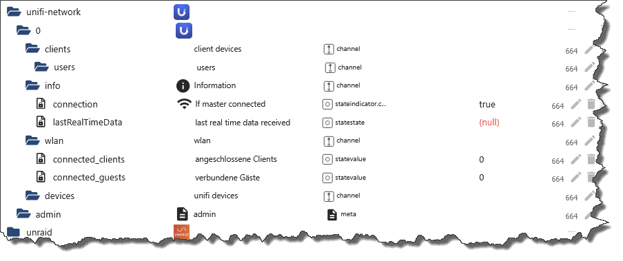

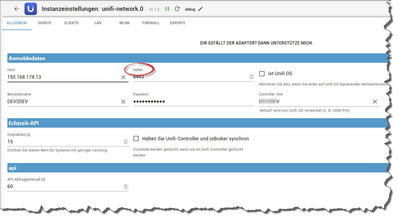

                                          • Codierknecht
                                            Codierknecht Developer Most Active @Scrounger last edited by Codierknecht
                                            @scrounger sagte in Test Adapter Unifi Network:
                                            teste mal die v1.1.3
                                            Die gute Nachricht: Die Instanz wird grün.
                                            Die schlechte: Ich erhalte keine Daten 😞
                                            FYI: Es läuft hier nur ein Unifi-AP-Pro. Also ausschließlich WLAN-Clients und kein Unifi-OS.
                                            unifi-network.0
                                            	2025-10-05 17:55:09.066	info	[onReady]: WebSocket listener to realtime API successfully started
                                            unifi-network.0
                                            	2025-10-05 17:55:09.058	debug	Search can't be optimized because wildcard not at the end, fallback to keys!: function(doc) { if (doc.type === 'state') emit(doc._id, doc) }
                                            unifi-network.0
                                            	2025-10-05 17:55:09.047	debug	Search can't be optimized because wildcard not at the end, fallback to keys!: function(doc) { if (doc.type === 'state') emit(doc._id, doc) }
                                            unifi-network.0
                                            	2025-10-05 17:55:09.020	debug	Search can't be optimized because wildcard not at the end, fallback to keys!: function(doc) { if (doc.type === 'state') emit(doc._id, doc) }
                                            unifi-network.0
                                            	2025-10-05 17:55:08.920	error	[NetworkApi._retrieve] Unable to connect to the Network controller. This is temporary and may occur during device reboots.
                                            unifi-network.0
                                            	2025-10-05 17:55:05.886	error	[NetworkApi._retrieve] Unable to connect to the Network controller. This is temporary and may occur during device reboots.
                                            unifi-network.0
                                            	2025-10-05 17:55:02.841	error	[NetworkApi._retrieve] Unable to connect to the Network controller. This is temporary and may occur during device reboots.
                                            unifi-network.0
                                            	2025-10-05 17:54:59.806	error	[NetworkApi._retrieve] Unable to connect to the Network controller. This is temporary and may occur during device reboots.
                                            unifi-network.0
                                            	2025-10-05 17:54:56.772	error	[NetworkApi._retrieve] Unable to connect to the Network controller. This is temporary and may occur during device reboots.
                                            unifi-network.0
                                            	2025-10-05 17:54:53.740	error	[NetworkApi._retrieve] Unable to connect to the Network controller. This is temporary and may occur during device reboots.
                                            unifi-network.0
                                            	2025-10-05 17:54:50.688	error	[NetworkApi._retrieve] Unable to connect to the Network controller. This is temporary and may occur during device reboots.
                                            unifi-network.0
                                            	2025-10-05 17:54:47.654	error	[NetworkApi._retrieve] Unable to connect to the Network controller. This is temporary and may occur during device reboots.
                                            unifi-network.0
                                            	2025-10-05 17:54:44.610	info	[login]: WebSocket connection to realtime API successfully established
                                            unifi-network.0
                                            	2025-10-05 17:54:44.587	debug	[NetworkApi.loginController] login to self hosted UniFi controller successful.
                                            unifi-network.0
                                            	2025-10-05 17:54:44.263	info	[login]: Logged in successfully to the Unifi-Network controller (host: 192.168.179.13:8443, site: D*****V, isUnifiOs: false)
                                            unifi-network.0
                                            	2025-10-05 17:54:44.262	debug	[NetworkApi.loginController] login to self hosted UniFi controller successful.
                                            unifi-network.0
                                            	2025-10-05 17:54:43.974	debug	[NetworkApi.logout] Logging out and clearing credentials.
                                            unifi-network.0
                                            	2025-10-05 17:54:43.957	info	starting. Version 1.1.3 (non-npm: Scrounger/ioBroker.unifi-network#fab63502974c2b23b621ebc96844f9d5bc0c61ef) in /opt/iobroker/node_modules/iobroker.unifi-network, node: v22.20.0, js-controller: 7.0.7
                                            unifi-network.0
                                            	2025-10-05 17:54:43.896	debug	States connected to redis: 0.0.0.0:9010
                                            unifi-network.0
                                            	2025-10-05 17:54:43.846	debug	States create User PubSub Client
                                            unifi-network.0
                                            	2025-10-05 17:54:43.846	debug	States create System PubSub Client
                                            unifi-network.0
                                            	2025-10-05 17:54:43.841	debug	Redis States: Use Redis connection: 0.0.0.0:9010
                                            unifi-network.0
                                            	2025-10-05 17:54:43.829	debug	Objects connected to redis: 0.0.0.0:9011
                                            unifi-network.0
                                            	2025-10-05 17:54:43.827	debug	Objects client initialize lua scripts
                                            unifi-network.0
                                            	2025-10-05 17:54:43.812	debug	Objects create User PubSub Client
                                            unifi-network.0
                                            	2025-10-05 17:54:43.812	debug	Objects create System PubSub Client
                                            unifi-network.0
                                            	2025-10-05 17:54:43.811	debug	Objects client ready ... initialize now
                                            unifi-network.0
                                            	2025-10-05 17:54:43.798	debug	Redis Objects: Use Redis connection: 0.0.0.0:9011
                                            host.iobroker
                                            	2025-10-05 17:54:43.193	info	instance system.adapter.unifi-network.0 in version "1.1.3" (non-npm: Scrounger/ioBroker.unifi-network#fab63502974c2b23b621ebc96844f9d5bc0c61ef) started with pid 3818642
                                            host.iobroker
                                            	2025-10-05 17:54:42.900	info	"system.adapter.unifi-network.0" enabled

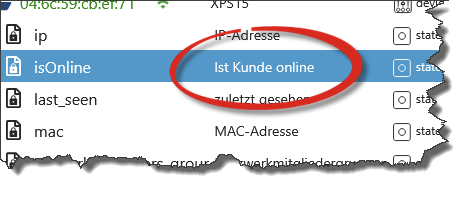

                                            Meine Einstellungen:
                                            Vielleicht korrigierts Du bei Gelegenheit auch den Fauxpas der automatischen Übersetzung 😁
